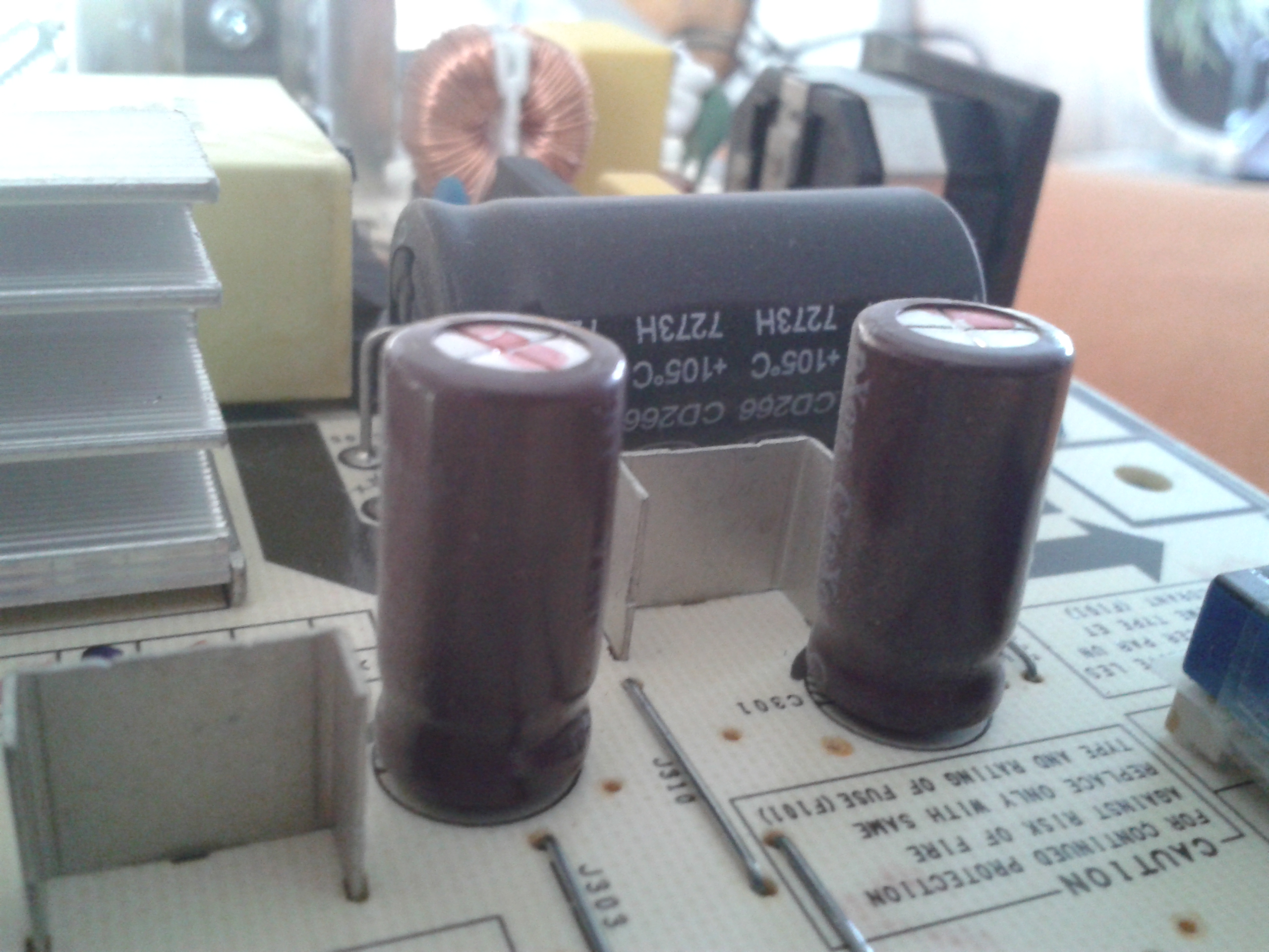

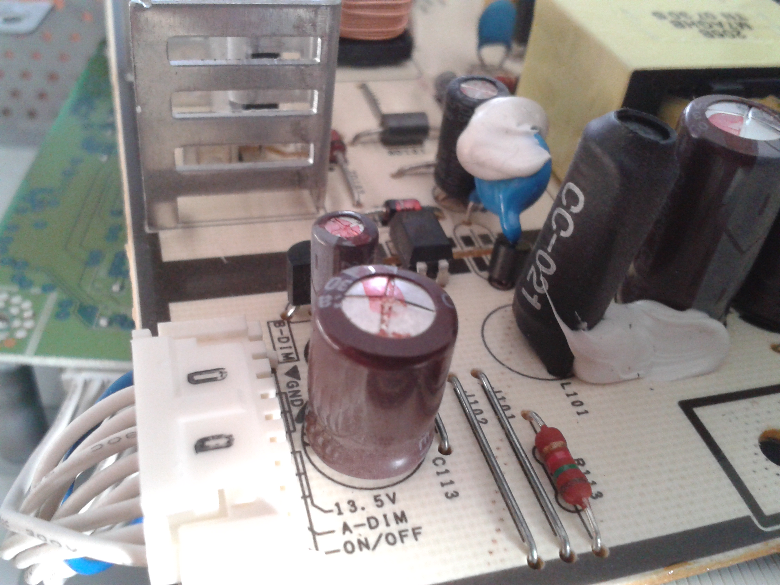

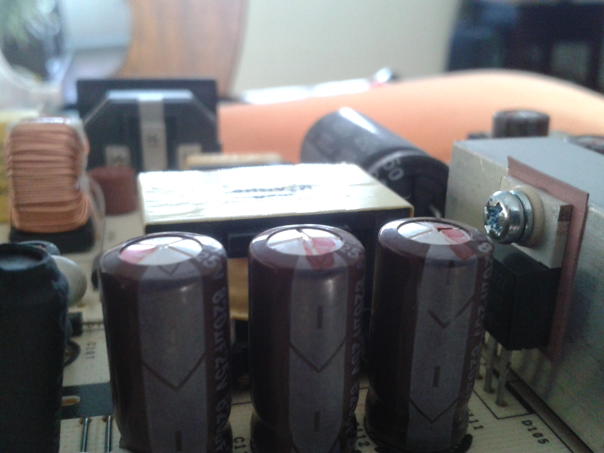

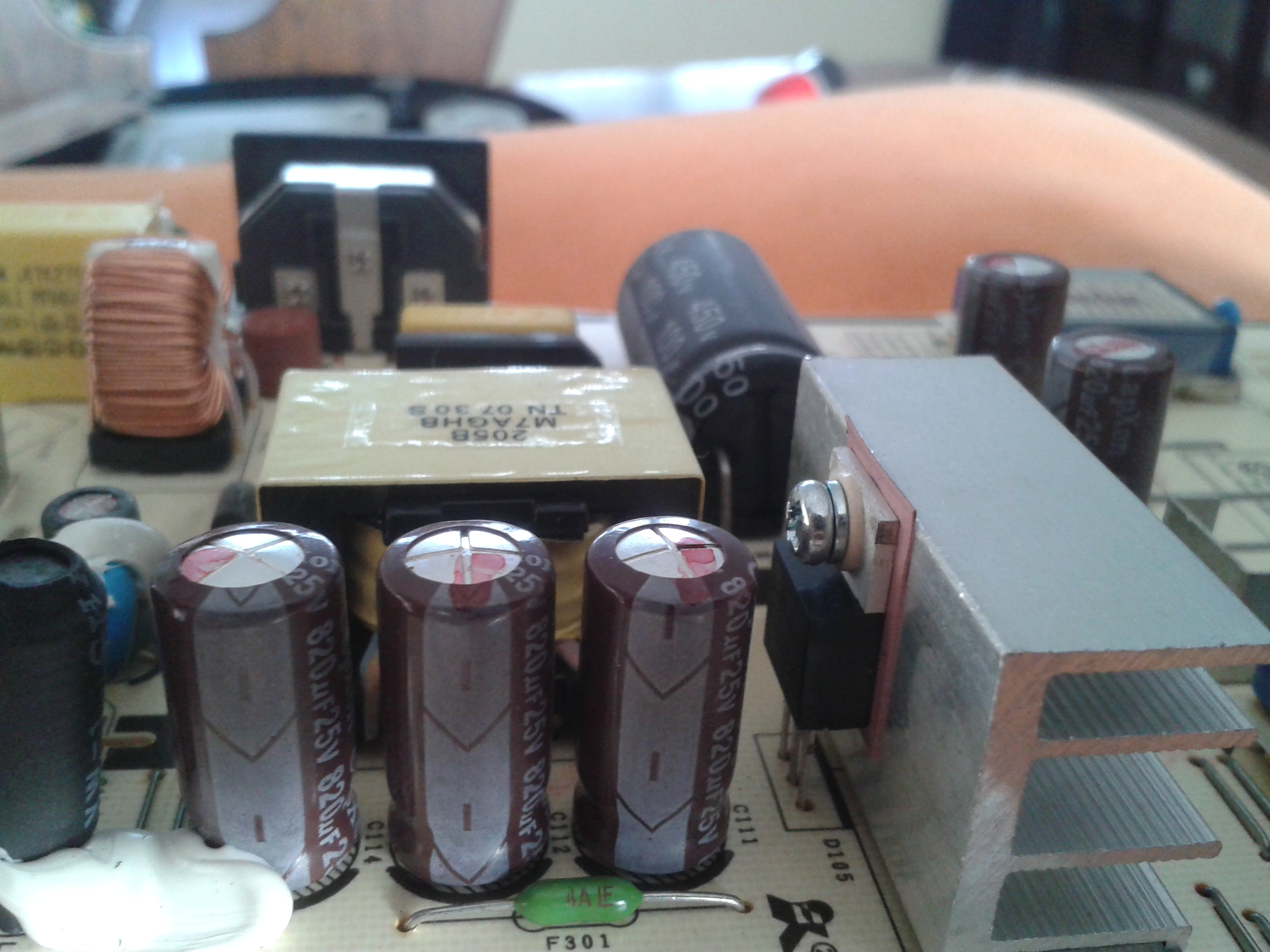

    Here are the other pics

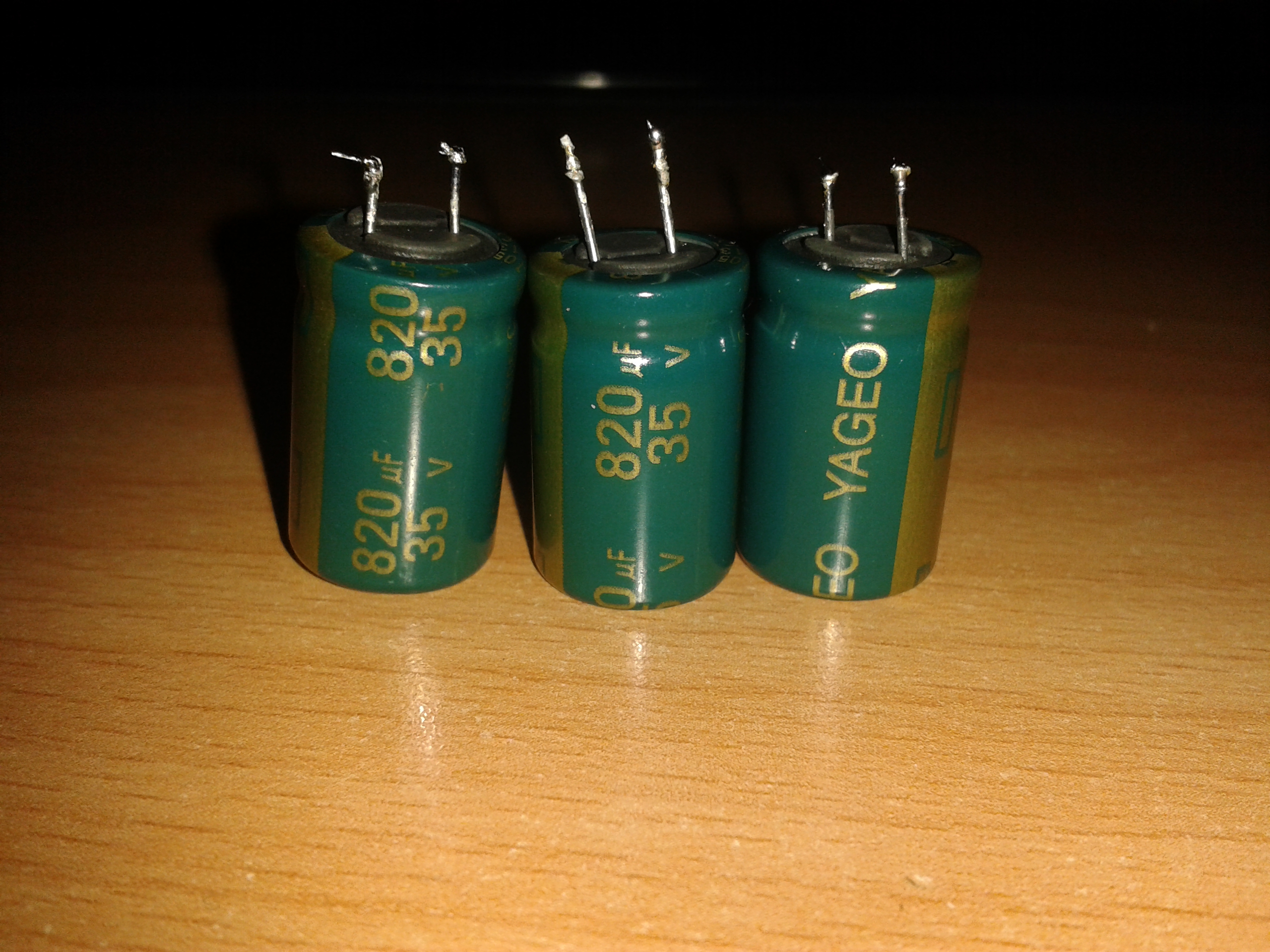

      Just a first quick question:
      Are you aware that capacitors have a polarity and you have to have them the right way round?
      I ask as in your picture the three green ones do not appear to be correct.

        I was totally unaware of this fact lol, i get new caps tommorow and install them the right way then see what happens, tnx for helping.

          Ok - They have a positive and negative side - the side with the stripe is negative and
          on a new capacitor is the shorter leg. The stripe is lined up with black side of the circle on the board ( Mostly but not always) Luckily I think you have pictures before you removed the caps so you replace the new ones the same way round as the old ones.
          If you have any your not sure about ask again.
          The C113 in the corner also seems to be wrong?

            well, this noob did it!, i bought two new caps today and this time i put them all the right way in and...no more flickering! im very happy that i tried it and by doing so saved my money buying a new monitor.

                Immediately checked power board, and confirmed: Every single capacitor is bulged, except big filter capacitor.
                All 820uF 25V, and I only had 820uF 6.3V ones - on the power section, they're 3 connected in parallel making combined 2460uF.

                In inverter section, again, two (in parallel) 820uF 25V (1640uF total) are gone bad. Still, I had no adequate replacement so I put what I had: Just one 2200uF 50V (close enough!).
                On 13.6V output, 330uf 25V required replacement, but since I had no adequate replacement (only 330uF 6.3V) I had to improvise again:
                2x 100uF 25V in parallel
