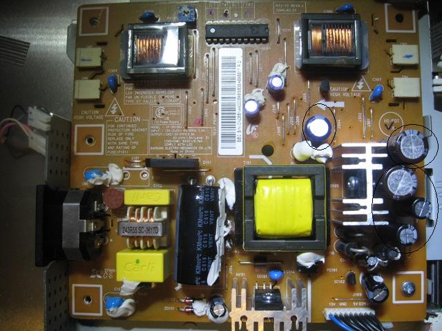

    I've got a samsung 713N with the IP-35135A power supply. Looks to be a common supply with Dells, etc. Initially I had no power indications, no led status,etc. I found some obviously bad caps on the PS and replaced them. The following were replaced (2) 820uf, (2) 1000uf and (1) 330uf.
    After replacement of the above caps the monitor status led is now rapidly blinking green. I checked for voltages and found I have only 1.4 VDC on both the 5VDC and 13VDC pins that come out of the PS going to the video board.
    Without a schematic I'm a little lost as to what to check next. I've attached a pic of the ps and have circled the caps I replaced.

    1.4 volts is unusual. The question is the SMPS current limiting, or is there another fault. The SMPS controller / switch is the 4 (5?) pin IC attached to the heat sink bottom center. Look up the part number and download the data sheet. CAREFULLY!! check the voltage across the large cap. That might give a clue. Check the voltages on the pins of the controller. Check for shorts in the load - in particular, shorted drivers in the inverter.

      @kckcap:
      Replace the other 3 small caps in the lower part of the picture.

        Voltage on the big cap = 161vdc From what I've read on this forum the voltages should be over 350vdc?
        The SMPS controllers part number is DM0565R, I'm trying to find a spec sheet on it now.

          I also can hear a very faint, steady 'snapping' sound from the ps. Probably about 4 or 5 'snaps' per second The room has to be absolutely quiet but I can definitely hear it. Its too faint to be able to tell what exact component is doing it and I'm not going to press my ear too close to the big cap.
            Good ears. It's a good chance that's the SMPS starting up. Follow Toasty's advice. If that fixes it, Toasty gets an 'Attaboy'.

              Voltage on the big cap = 161vdc From what I've read on this forum the voltages should be over 350vdc?...
              The voltage on the big cap comes from the rectified & smoothed mains voltage.
              If you are in a country with 120V mains you will get in the region of 165V, and around 330V in a country with 240V mains.

                  I replaced the three remaining caps with no luck. Still no 5VDC and the 'snapping' sound remains. Maybe replace the SMPS? But if its the component 'snapping' I think it may be working correctly and turning on/off due to another component 'overdriving' it.

                          sounds like a short on the secondary side somwehere..
                          PSU trying to start up, detects a short, shuts down, repeat
                          (would explain the "snapping" sound)
                          whenever i come across a monitor with these symptoms, i replace all caps except the 400-450V one, and check the diodes/diode packs on the secondary side for shorts..

                              i've checked all the diodes, all good, don't know what to do next...

                                One approach is to provide 5V and 12V to the outputs of the power supply. (Do this with the logic board disconnected). If you hook 3 AA penlight cells in series from ground (-) to the +5V output and read approximately 4.5 volts, there is no excessive load. You can use the same batteries to test the 12V output, or use a 9V battery.
                                If neither of these showed a problem, try testing the supply with no logic board connected.

                                  i plugged in with the logic board disconnected, and i started to see some smoke, and after i checked the psu board on the back i saw that the SP8M3 smd with 8 legs has a small ash in a corner. probably that smd was the problem from the start. now i have to search for a replacement.

                                    worked. replaced the two SP8M3 and it's good as new
