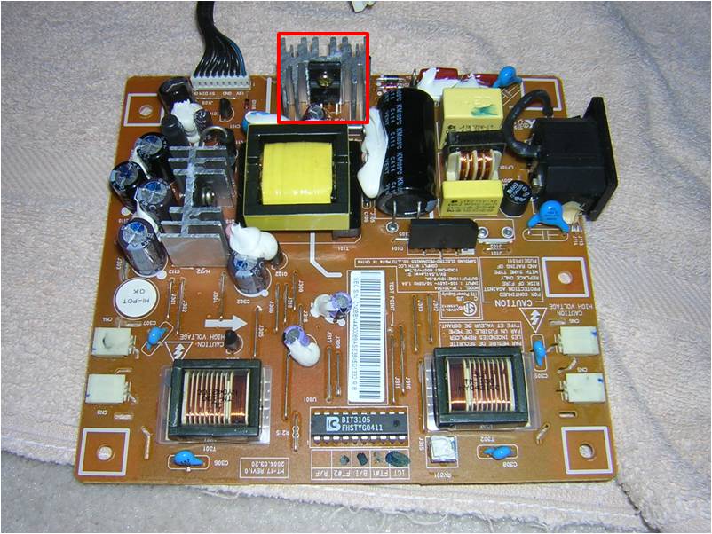

    I am working on an IBM monitor....6734-ABO.
    I replaced a few caps on the board that were "bad" but still does not power on. So i am trying to identify the different parts on the board and see what they are........
    I am trying to identify the part with a red box around it.

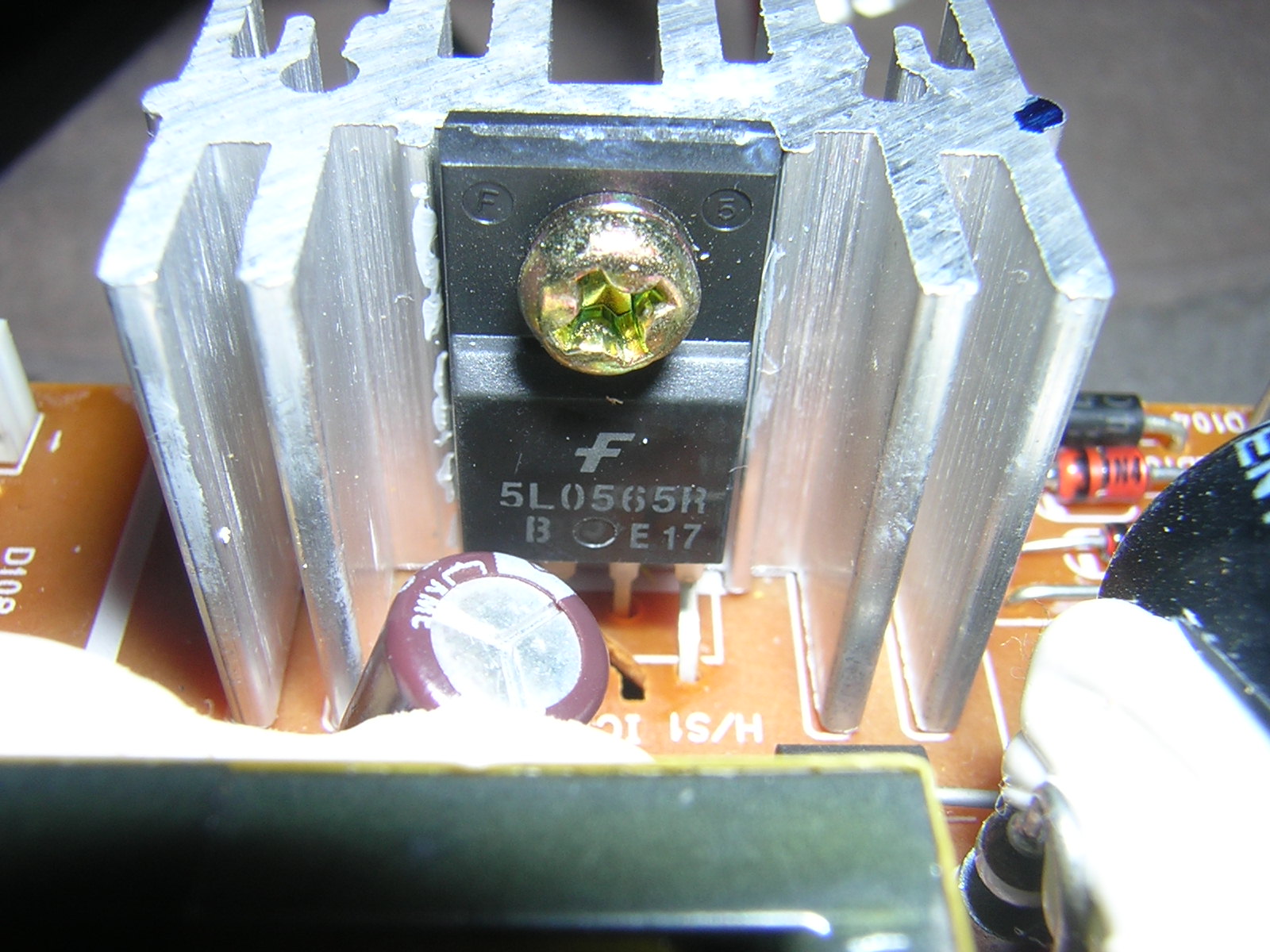

    I also took a close up.
    The part number seems to be 5L0565R.......but i cant find any info on this.
    Can somone help.

    KA5L0565R https://cdn.badcaps-static.com/pdfs/...02c1649c0a.pdf

      thanks bill! How did you find this? I searched and could not find anything.

        First clue: The Flying F is the Fairchild logo.
        Second clue: I Googled it, one of the hits was an eBay sale for 5L0565R / KA5L0565R. So I Googled KA5L0565R and got the site I referenced.
