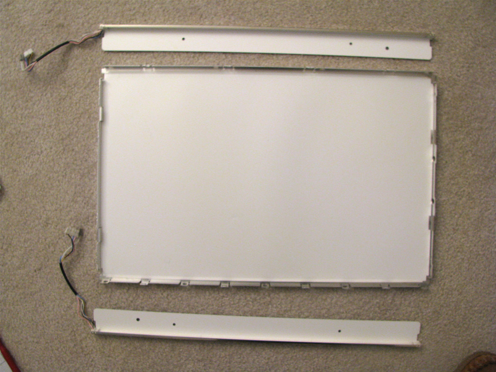

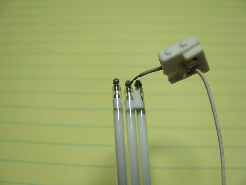

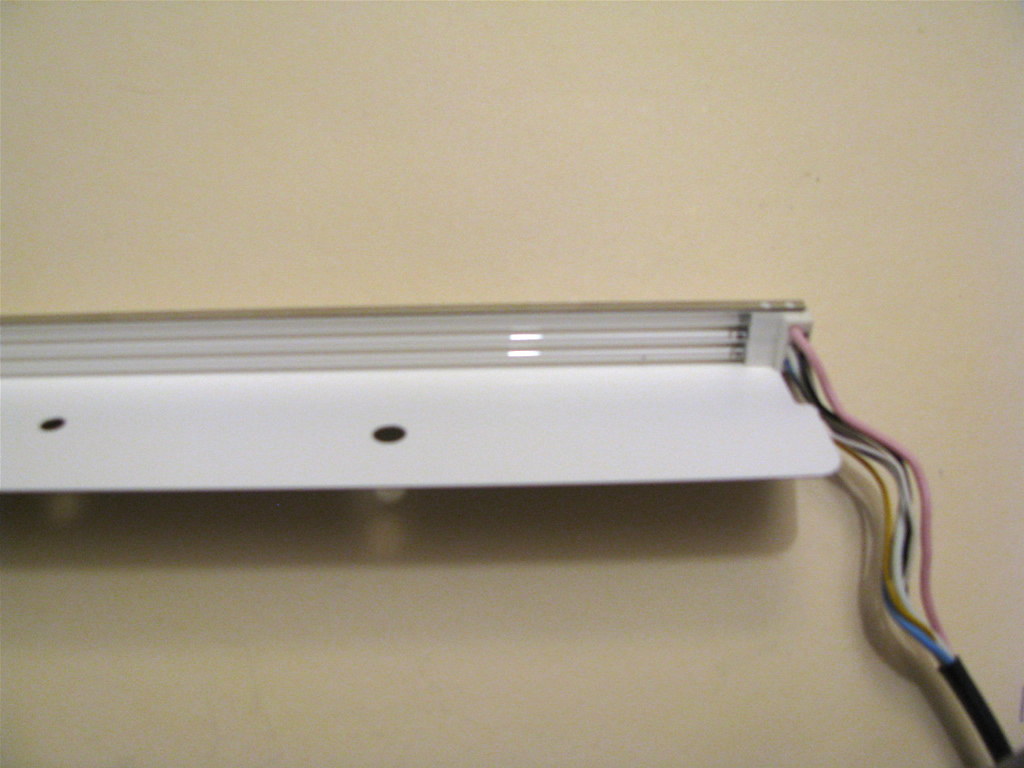

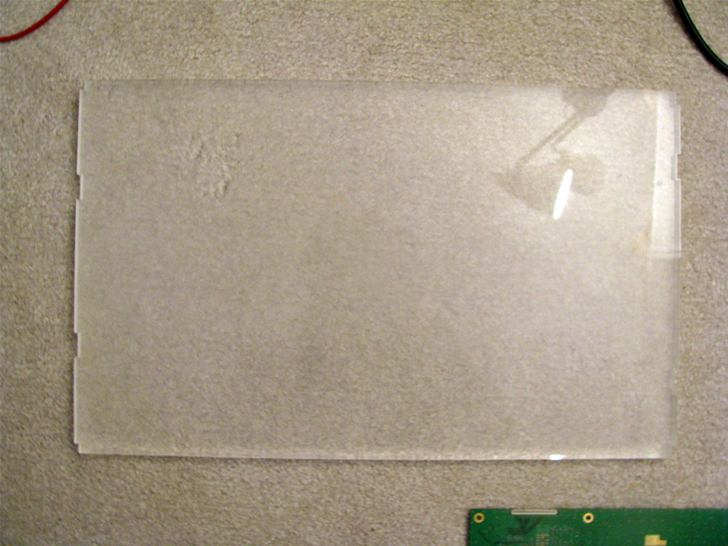

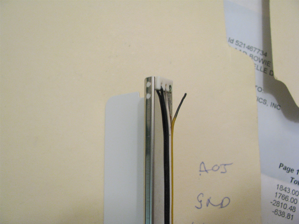

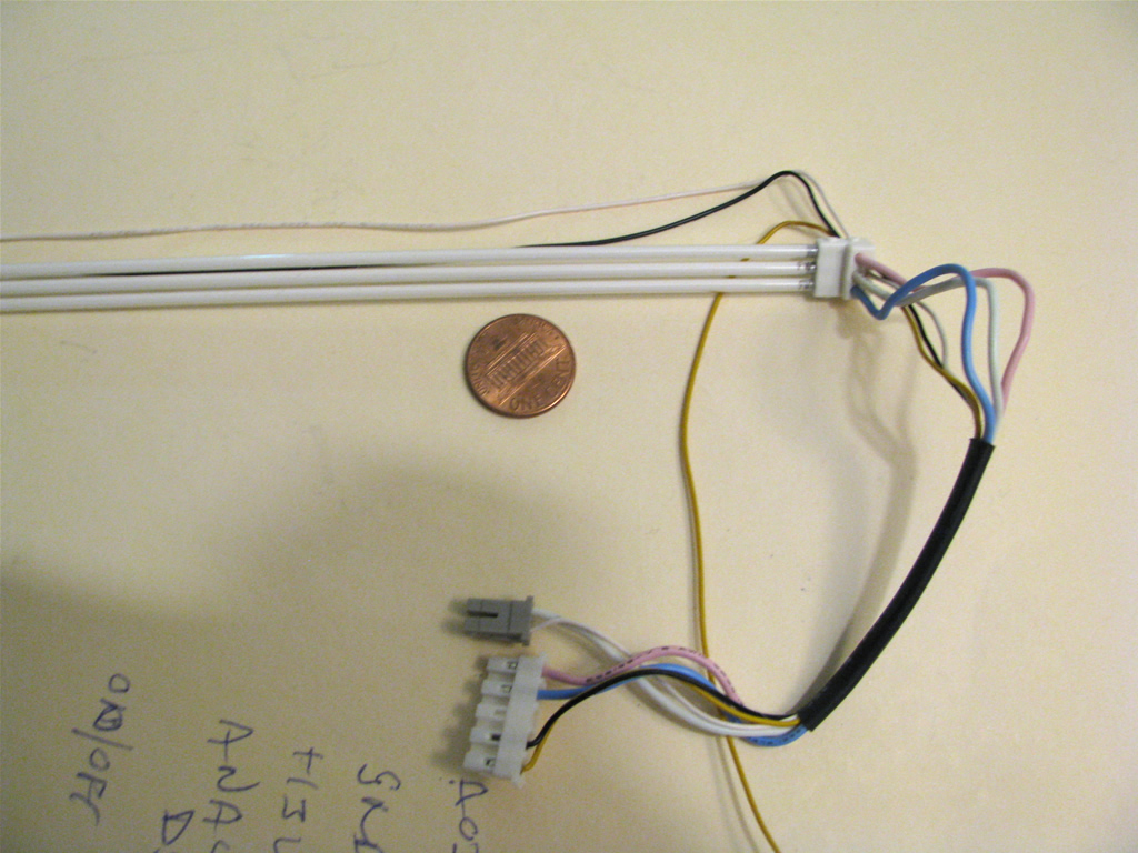

          Freelander, you are correct, exactly as you said, one of the solder joints at the end of one of the CCFL tubes had failed, presumably leading to arcing. Images are attached.
          For those who have never seen the guts of a panel here goes:
          Image 1: Essentially a metal tray with a sheet of white glossy plastic in the bottom. The angled pieces (wires attached) lying to the side each carry 3 CCFL tubes. These angled pieces slot in top and bottom in the tray creating a wall of light
          Image 2: One of the two angle pieces which carry the CCFLs
          Image 3: A 3/8 inch slab of clear plastic which sits in the main panel tray. On top of this sit 3 layers of plastic sheet (not shown). I guess they are polarizers, diffusers, or the like.
          Image 4: The failed CCFL return wiring
          Image 5: A bank of 3 CCFL tubes with wiring
          Image: 6 Closeup of CCFL ends with charring. White end piece is rubber and broken up somewhat with the charring.
          All the pieces are quite robust but I had to get my 17 year old daughter with her small hands to disassemble to CCFLs from the angle pieces. Have to go get some wire fine enough to rewire the CCFLs tomorrow, together with a can of compressed air and a microfiber cloth, the poor man's answer to a clean room.
          This is all very interesting but probably an uneconomic exercise. Plus the big question is whether I can put this thing back together in an acceptable state of cleanliness such that I get a usable monitor.
