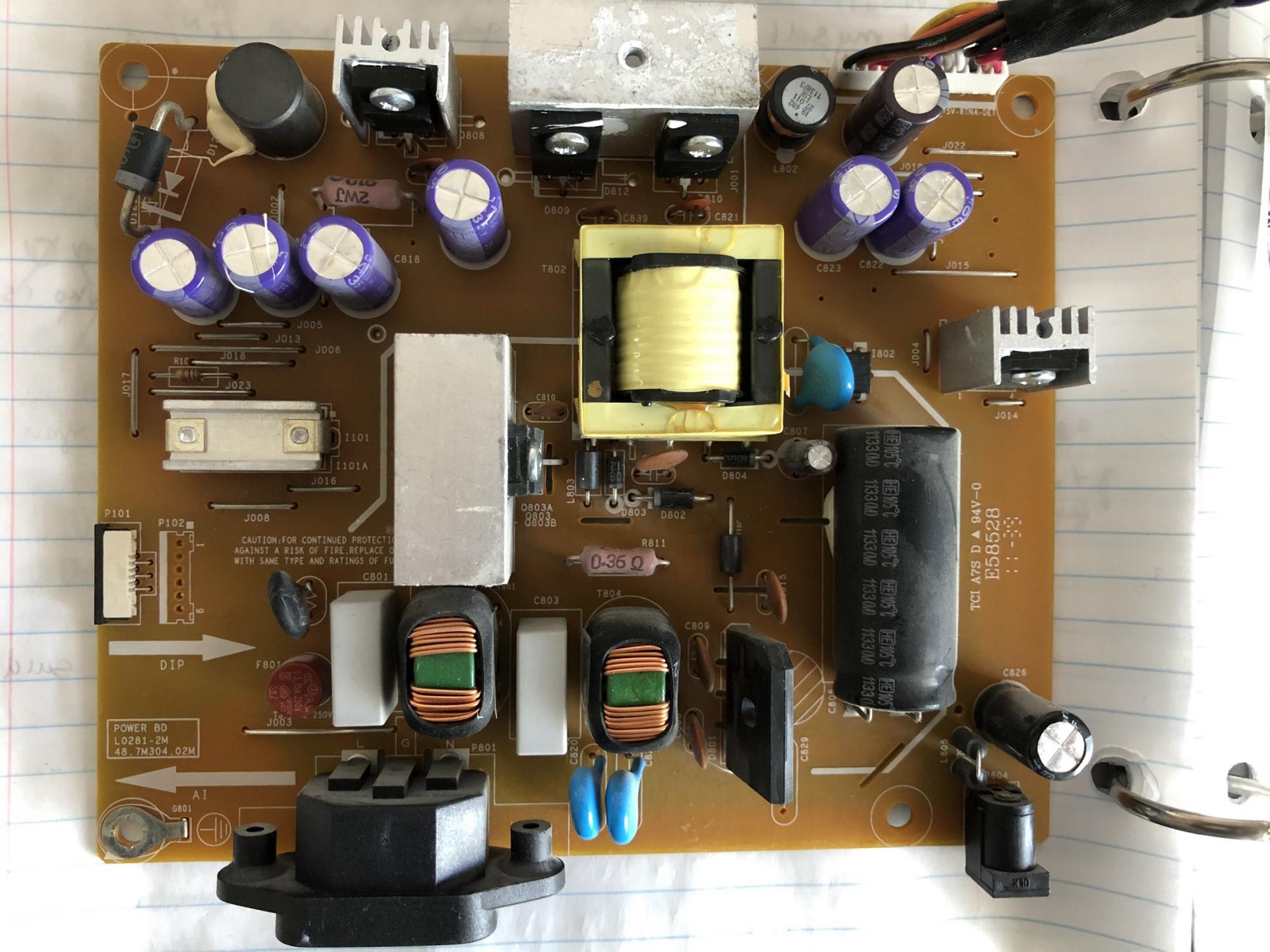

    I have 2 Dell U2312HM that won't turn on anymore. Both are completely unresponsive. The power went out a few months ago and took 1 monitor out, yesterday the power went out again and took the other out.

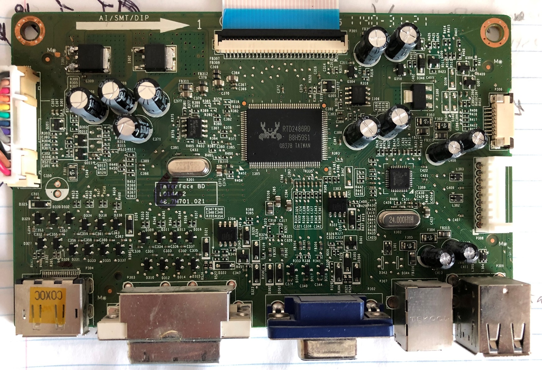

    I have taken 1 monitor apart and replaced some components on the signal board:
    • I301 (5V to 3.3V regulator but had 0V out)
    • all the electrolytic caps on the Signal board.
    When I supply external DC power supply 5V to I301, I get a constant 3.3V out. When I check the 5V pin of the Power Board when the Signal Board is disconnected I also get 5V. However with both of the signal board and power board connected through the wire cables I see a fluctuation in the 5V up and down to about 1V.

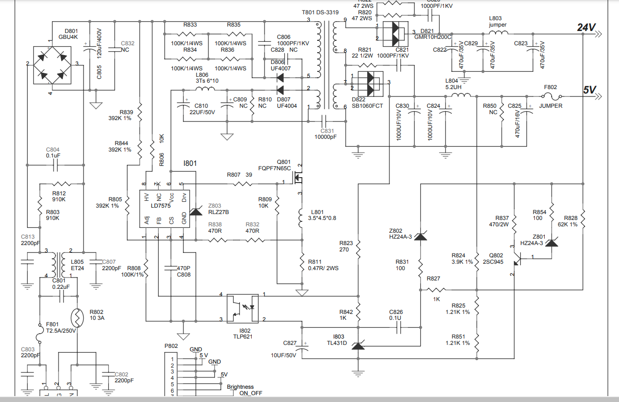

    I am not really sure where to go from here since I don't know much about power electronics. Does anyone have a schematic for the power board L0281-2M? I have taken a look at some other posts but I haven't been able to find anything to proceed further.

    I would replace C807, this is the startup/vcc cap. It could be weak and not charging to the full vcc to keep the primary circuit running.

      Thanks RJ. I tried connecting the signal board from bad monitor 1 to the good power board of bad monitor 2 and when I started it up the display had a 2 images side by side and the colors / resolution were messed up. I think something else is wrong w/ the monitor 1 signal board beyond that bad voltage regulator also.
      I'll try replacing that vcc cap.
      I was able to replace the bad 3.3V voltage regulator I301 on bad monitor #2 and it is working as expected now. https://youtu.be/tQVnBMDsqio

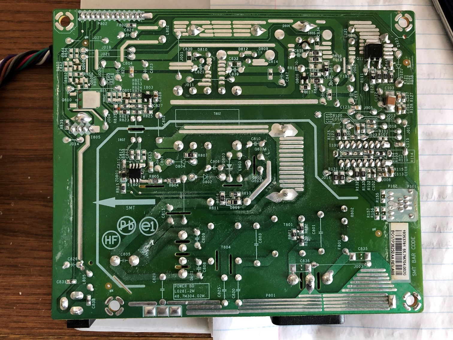

        While i was trying to repair this power board (L0281-2M) i realised fuse F802 was dead and moved my hand and piece of wire has fallen on I801 and it poped killing him and D806. Does anyone know what ic is that and the walue of diode?

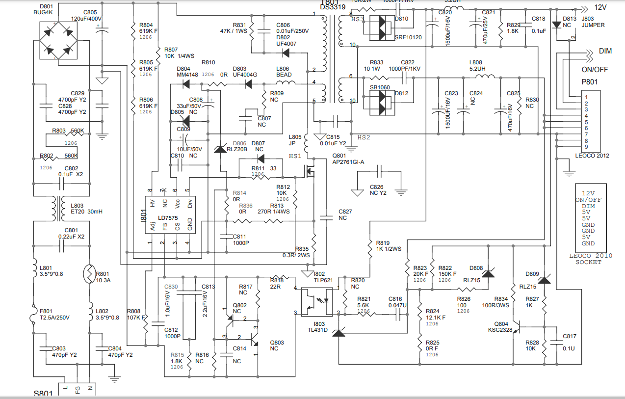

          Re: U2312HM will not turn on
          See which scheme is more suitable.
            Thx for schematics.
