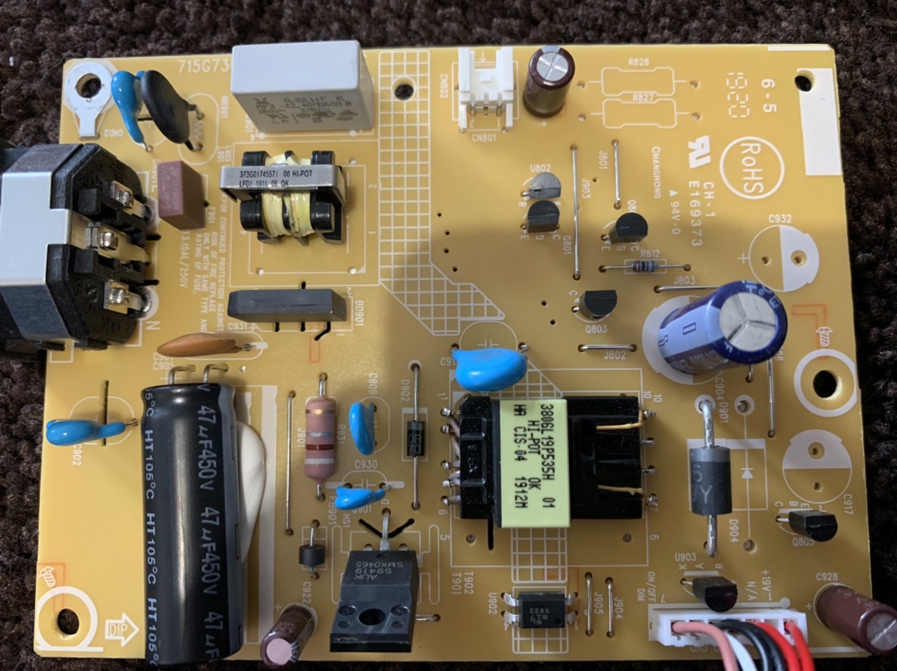

    I have this monitor, it doesnt power up.
    The voltage on the connector CN902 is only 4,5V instead of 19V.
    With a quick test I see the voltage on pin 6 of transformer T902 is going crazy from 150 to 250V (tested in DC mode).
    Diodes and Q901 seem ok. Any suggestions?

    Whatd dc voltage do you have between the two legs of the large 47uF 450V capacitor
    What is the part number on U901

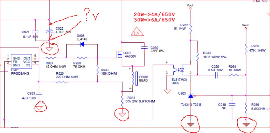

              Re: Aoc e2070s No power
              Here is a diagram that might help you figure it out.

                What voltage do you have across C922
                With your meter set to diode mode and the set switched off have you checked D901 and D904

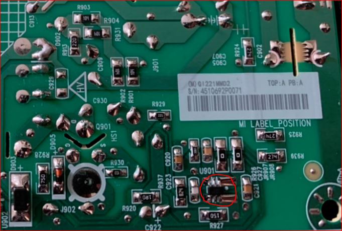

                  @lotas U901 well, it is AS358M, look at the photo.
                  C922 is jumping from 12,3V to 15,1V!
                    AS358M is U801 and U901 is PF6003AG (sot23-6).
                      Yes, sorry! You are totally right only that it’s PF6003AH

                        I found a reference on the internet that said the PF6003 can be a replacement for LD5532GS
                        The data sheet for the LD5532GS says that when capacitor C922 voltage reaches 16V then the IC starts to operate and drive the mosfet. This initial voltage to charge C922 comes from the resistor chain R924/925/939/937/926
                        When the voltage across C922 reaches 16 volts the mosfet is driven and the feedback winding on the transformer T902 maintains the voltage on C922 via R920 & D903
                        I would check those components especially C922
                        It also says on page 12 of the pdf that the IC can be turned off if the COMP pin of the LD5532 is taken below 1.5V. The Comp pin would be the FB pin on the PF6003

                          So, I checked with an LCR tester the cap C922 and is ok. ESR 2Ω for 4,7uF 50V.
                          Also all the diodes seem ok.
                          So I checked on voltage mode as many components as possible. The voltage between ground and C922 is steady -80V (black lead in ground). Everything looks steady in general except the drain, which ofc is attached also to the leg6 of the transformer, and it makes me wonder maybe Q901 is not working right and causing the fault...

                            80 volts is a lot.
                            The voltage on the C922 must be measured on the capacitor itself, this power supply has different gnd (one in the primary, another in the secondary).
