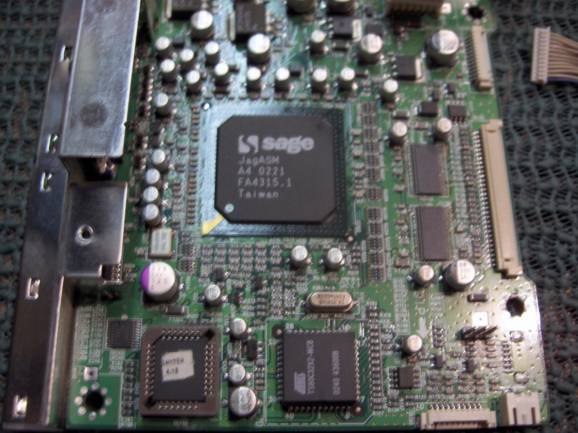

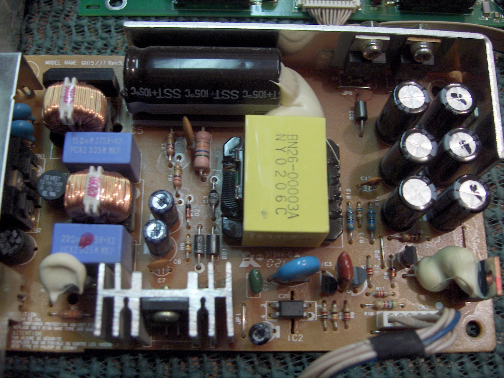

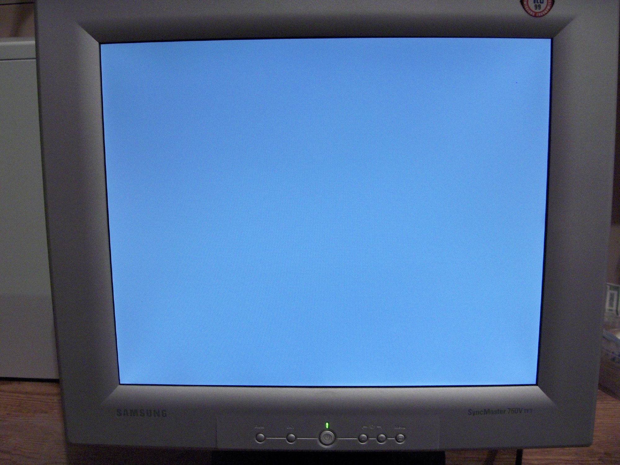

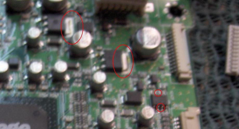

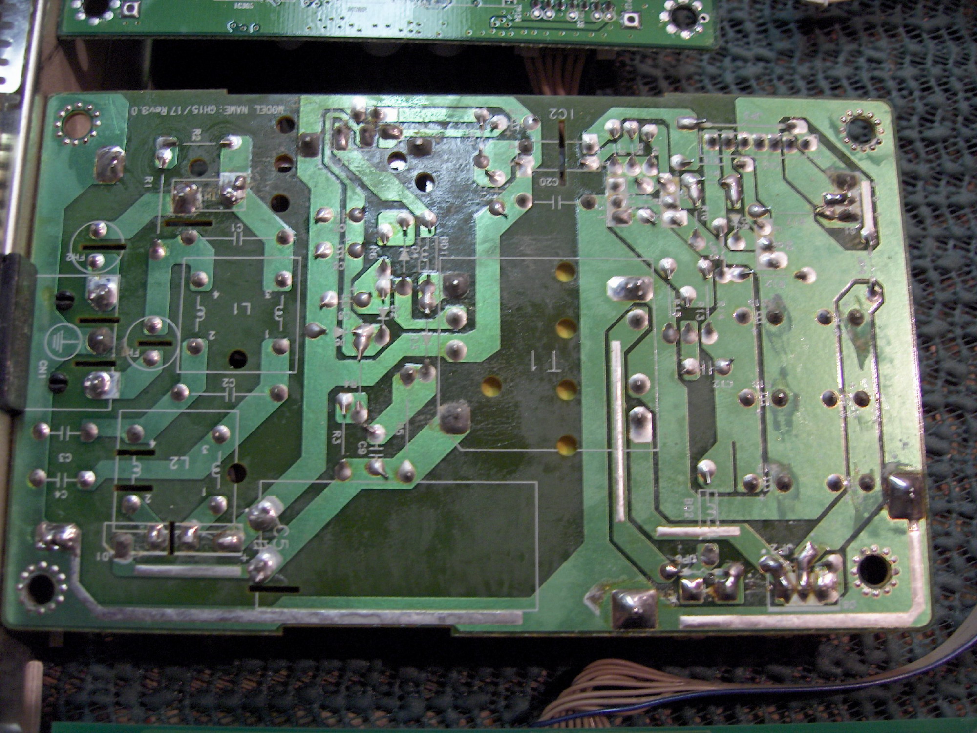

    Hello all and happy holidays. i have said item here today in hopes of repairing with any advise. it powers on to a blueish looking screen. power light stays green. no signal whatsoever. all power boards look good. caps look good. no bulge or leaks noticed. what would be the best place to start?

    Is this monitor going to stand-by mode (amber LED) after cca 10 sec?
    If yes, it looks, like no voltage is going to panel.
    Check voltages at circled places.

      sorry late reply.....the power led stays green. no yellow at all.
      added note.....
      i did replace all caps ((6 that are bunched together)) just to see if that would do it. no difference.
