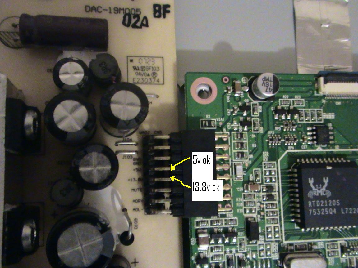

    I have a monitor that has exactly the same source and the same control card, as your Westinghouse 19" LCD Monitor , but mine does not turned on, I check the voltage of the source 13.8v and 5v are ok. what can I do.

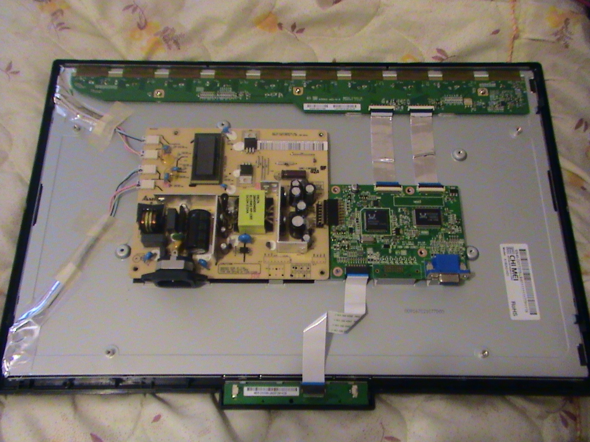

            This is my Acer

              Measurement of voltages as shown in the photo are fine.

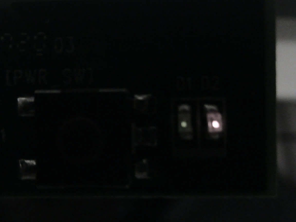

              with respect to the LEDs, turn on very little,
              only when you remove the power cord 5 seconds pass and shine more and turn off.

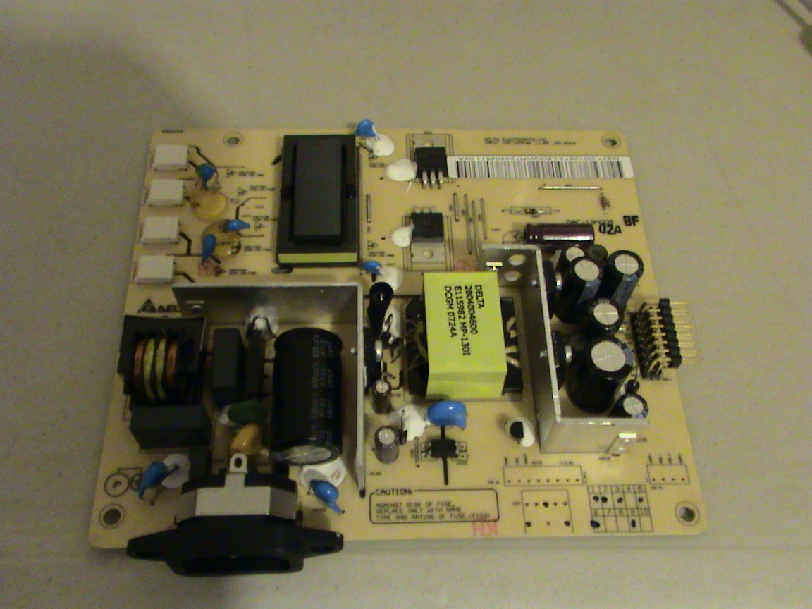

                  brand of capacitors are CapXon
                  • Nama
                    • May 2009
                    • 127
                    Re: Acer AL1916W A LCD Monitor
                    I would wait for conformation before proceeding. But,,, If I owned that monitor I would replace all 220uf, 470uf, and 1000uf Capacitors on the power board. 8 out of 10 monitors I see with those symptoms are repaired with cap replacement.

                        That would be my recommendation also. The 'unplugged for 5 seconds definitely represents a power supply problem. While bulging is a definite sign a cap is bad, most manufacturers now know how to build them well enough to fail without any obvious signs.

                                yes! 1000uf, 470uf, 220uf and I will change 100uf 400v too.

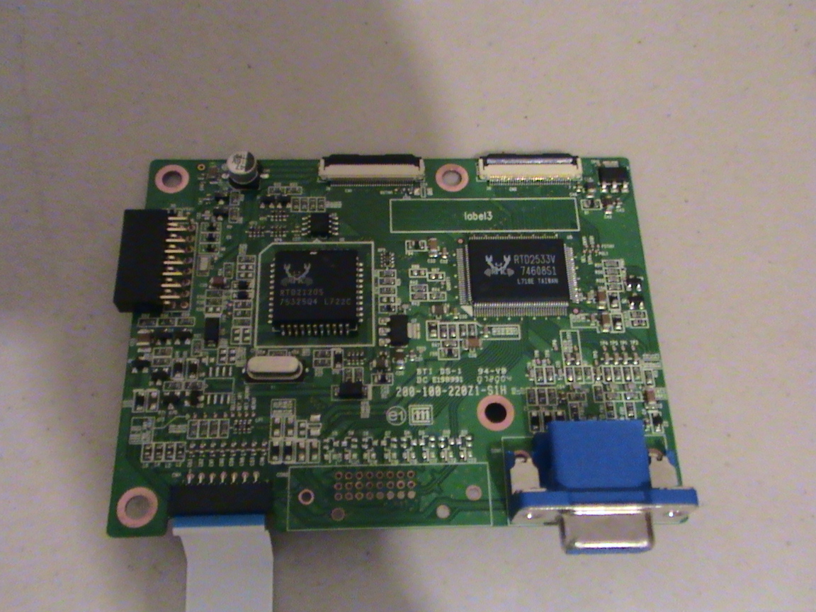

                                      i think you have a bad mainboard. I had the same problems and the power supply was oke. conclusion : bad mainboard. it happens often with Acer monitor

                                        Absolutely no green led?
