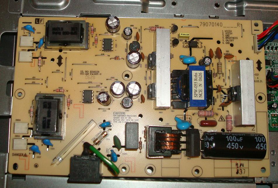

      Re: Emachines le1938
      Should I recap the inverter board as well?

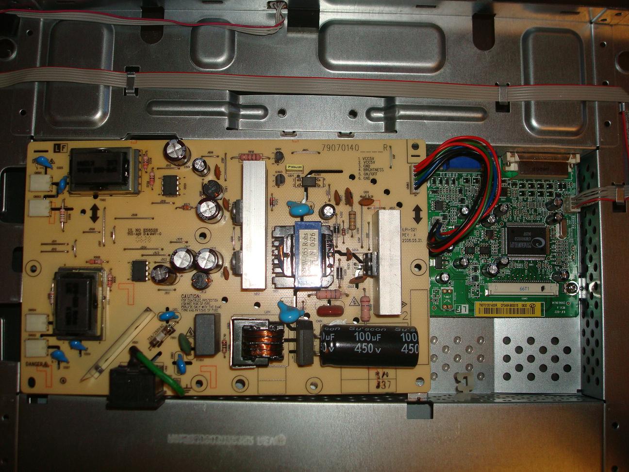

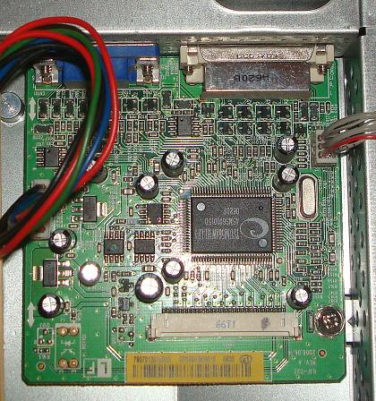

        Here are some pictures.
          Did you check if the noise was produced on the top or bottom of the LCD panel? Again, I think you have an arcing CCFL in that panel.
              I meant the logic board in this question.
                I observed the noise while the panel was apart, but I was listening from the top of the panel.
                I don't know if this applies to your case, but here I go .....
                I just repaired a Sony VAIO Laptop that had the following problem: It sometimes didn't have any problem, but sometimes it just turned off (backlight only). After further inspection I found out that a noise came from the bottom of the panel. It turned out that the CCFL was loose and the noise was producing by voltage arcing to the metal rail/shield that normally protects the lamp and reflect the light. The guy didn't allow me to change only the CCFL (why, I don't know...) and in the end changed the panel. But the problem could be your case too. Again, if the panel is apart, check if the sound come from the bottom or the top parts. If a CCFL arcs, the inverter will shut off.
                If you want to test if the lamps are the problem, take the panel from your Samsung on the other thread and connect it (lamps) to this inverter. If the boards are OK the panel should light without the noise.
                As for the all white screen, it may be the fuse at the input of the LCD panel.
