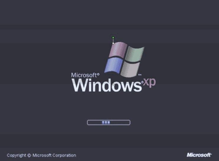

    I have samsung 591s color problem. when i turn ON ( VGA cable disconnected ) it show Self test mode and the color is ok. VGA card is OK, VGA cable is OK, i check all component in the RGB ( expect IC because i not know how ) and found nothing problem.
    Some illustration : turn on my computer and :

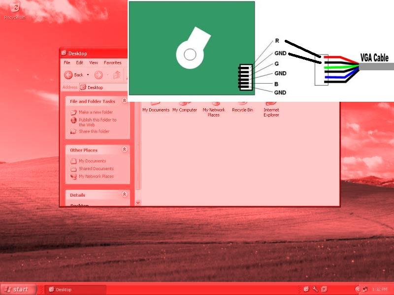

    2) Plug the red cable to RGB board and it show picture clearly with red color dominan

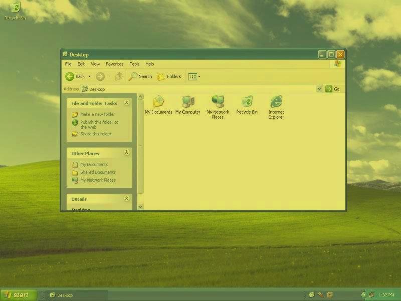

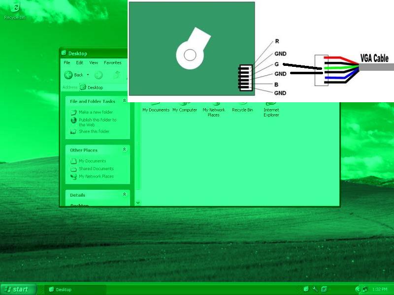

    3) Unplug red cable, and Plug green cable to RGB board, it show picture clearly with green color dominan

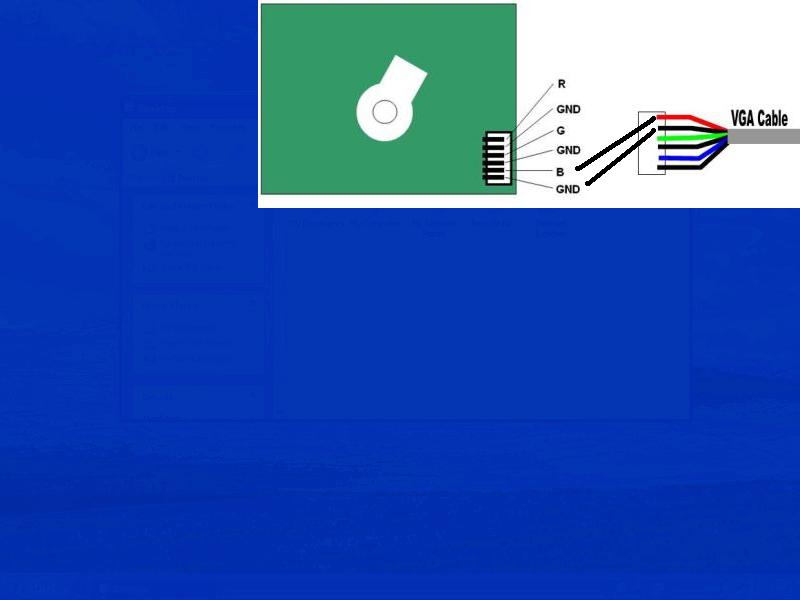

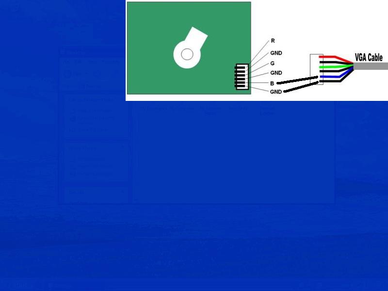

    4) Unplug red cable, and plug the blue cable to RGB board, it show BLUE SCREEN and i cannot see the picture, it's just BLUE SCREEN.

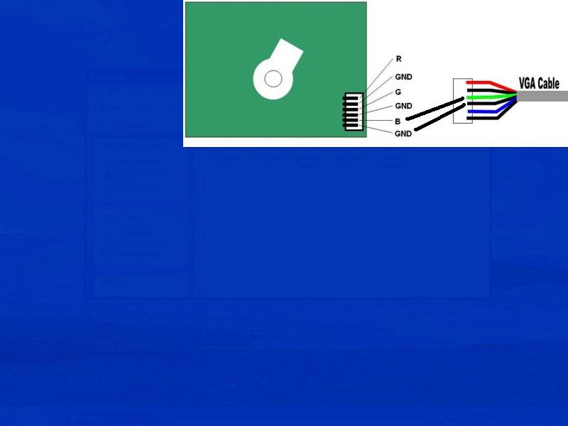

                    Sori, maybe we have some misconception, i mean that i'm plug the Blue Cable to the red or green pin ( at RGB Board ) and get picture clearly. Plug the green or red cable to the blue pin at RGB board and the result is BLUE SCREEN. I have been try this monitor with others computer and the result is same. So my prediction that the problem is at RGB board, please you all professional can tell me how repair the RGB board, what should i replace? Thanks...
                    • EGuevarae
                      • Nov 2008
                      • 1336
                      Re: Samsung 591S Clolor Problem
                      If you insist, post a pic to get the help you want. As I've told you, one of our senior members would jump in with some good idea after seeing a pic.

                      • joe6210
                        • Jun 2009
                        • 6
                        Screen shot :
                          did this happen suddenly?
                          the windows screen looks almost normal but it might be the pic.
                          if the self test looks good and shows all 3 colors and makes good white the issue is before the main video amps.
                          bad solder joints and dried out caps are high on the list of suspects.
                          if this has a blue label samsung crt just toss it now and save your time and parts.
                          between the bad crt's and the unobtanium calogic video amps these things were turds.

                            • Wizard
                              • Mar 2008
                              • 2296
                              Wow, you did a troubleshooting method, by swapping signals! That's awesome, we'd hire you on the spot.
                              Now, That TELLS us the blue section lost control most of voltage (full railed to 90V or so) on CRT board (particularly 90V supply for this to amp IC but anywhere in the blue circuit paths). Go there and check resistors and transistors. Also change capacitors if this is older design. Newer monitors use two ICs design (one to inject OSD and pass through signal to the main amp IC) to drive all 3 guns. But the usual process of checking resistance, transistor and measuring voltage applies with DMM.
                              Note the newer monitors microcontroller now talk to the IC and IC itself on the CRT generate the details to make OSD and pass to the amp IC is recent design in last 8 years. Not the older LM1203 style. It's found in junky monitors.

                                NOW I understand the 'RGB board' is the board on the monitor. And yes, I concur, very good job of troubleshooting.
                                Joe, what is the part number of the IC on the RGB board?
                                PlainBill
                                • joe6210
                                  • Jun 2009
                                  • 6
                                  there are 3 ic in the RGB board:
                                  1. LM1236 (RGB Preamplifier)
                                  2. LM2470 (Monolithic Triple 7.0 ns CRT Driver)
                                  3. LM2480 (80V Triple Bias Clamp)

                                    also you are dead wrong.yoke has nothing to do with a missing color.
                                    looks to me that the bias(dc level) is correct but the ac(video) is missing.
                                    since osd is fine its not the output stage.poking around with a scope i would find this fault in 30 seconds.
