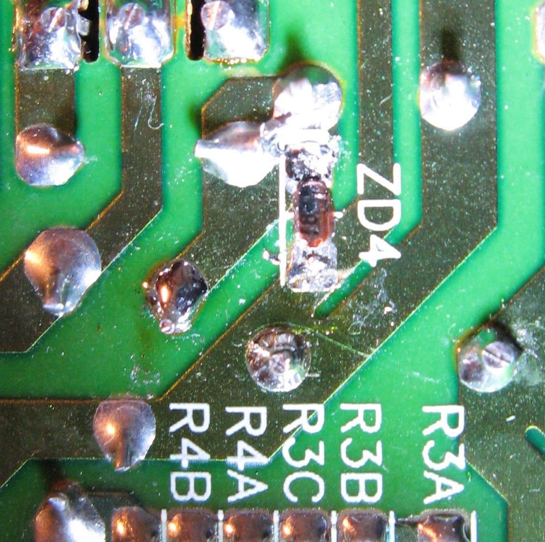

                  Hello.
                  I'm trying to fix monitor with the same power supply as mentioned in post #5 - DELTA ADP-58AF. I replaced all the capacitors and main MOSFET (Toshiba 2SK2843) but found out that Zener diode right next to it is shorted... And here's my problem, I don't know the value of this diode (ZD4). I can't find any schematic for this power supply, and the only information I have is the marking of the diode that remained on the glue after desoldering... I think it's either "81" or "18". Is it possible that this is a 18V Zener or is it some other marking?
                  Any help would be greatly appreciated, thank You.
                  Below are photos before and after desoldering.
