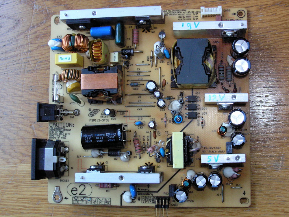

    I have switch the powerboard with another one and the monitor works. The problem is that i can't keep the powerboard so i want to repair it.

      Post top and bottom pictures of the power board. If you still have the good one, measure the same points on the connector to the inverter.

        I have been searching and when i put an external power at the three 19V pins at the connector of the inverter board and i turn on the power of the monitor the same time the backlight goes on and stays on even when i put away the external power. If iI turn the monitor off and turn it on the backlight stays off. I think its like a sort off current limiter.

          I believe you are correct. The area around the 19 Volt rectifier looks very unhealthy. This is also a very interesting design; I have never seen one of these with THREE transformers, and three smps controllers.
          I've marked up the top view of the power board. Check the value of the two resistors circled in red. They appear to be discolored, and could be the cause of the overheating. I have circled 5 capacitors in blue. One or two of those filters the supply for the 19V / 12V SMPS controller. If those are bad it MIGHT cause the problem you are seeing. And it is also possible the 19Volt rectifier (also circled in red) is defective. You could try replacing that.

            I've changed the five capacitors that you have circled in blue and it's working!!!!

                            My Acer X241W is suffering of something that I believe could be related to bad cap. I can switch the monitor on and get nice image but after a few seconds the screen would turn black (no image, no blacklight). Only way to get back to image is switch off then on, but after few seconds same problem.
                            The monitor uses the same PSU described on this thread (FSP112 3F01) and I believe I could find at least two caps that look bulged to me ( CS11 and CS12 both 25V 650uF). There is a third cap that looks different from all the other, CS13 - 25V 100uF). The top looks ok but the cap is actually higher from the ground and there is something that looks like black rubber underneath. Is that to be replaced too? What do you think?
                            I am attaching two pics. Thanks!

                              Yes, replace the three caps you mentioned, they are all bad. I would have replaced CS10 as well. It's the same brand and model as the others, and if it's not bad now, it will be shortly.

                                That CS13 is bulged downside - CS16 might be bad,too (the same voltage/capacitance).
                                I highly recommend to replace CS14 and CS15. They could fail in short time (see start of this thread).

                                  I have ordered replacements for CS10-13 and CS16 right after writing the post. Now that you mentioned it, I should have ordered 14 and 15 too :/

                                      Caps arrived today in the mail (digi-key); I replaced CS10-16 although only three were clearly bulged. $5 and I am back in business! Worked like a charm (at least so it seems, till now; let's keep fingers crossed). Thanks folks.
