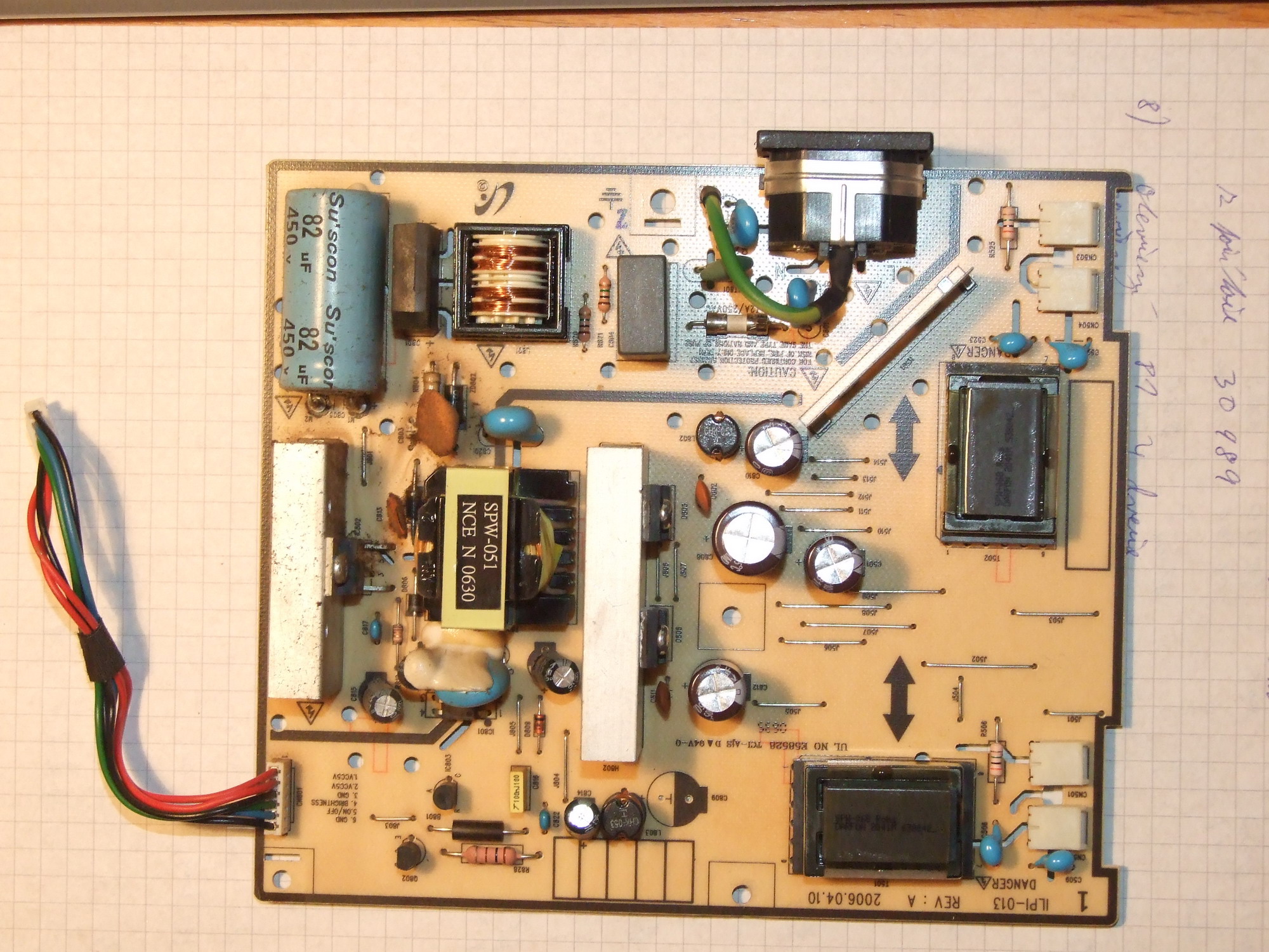

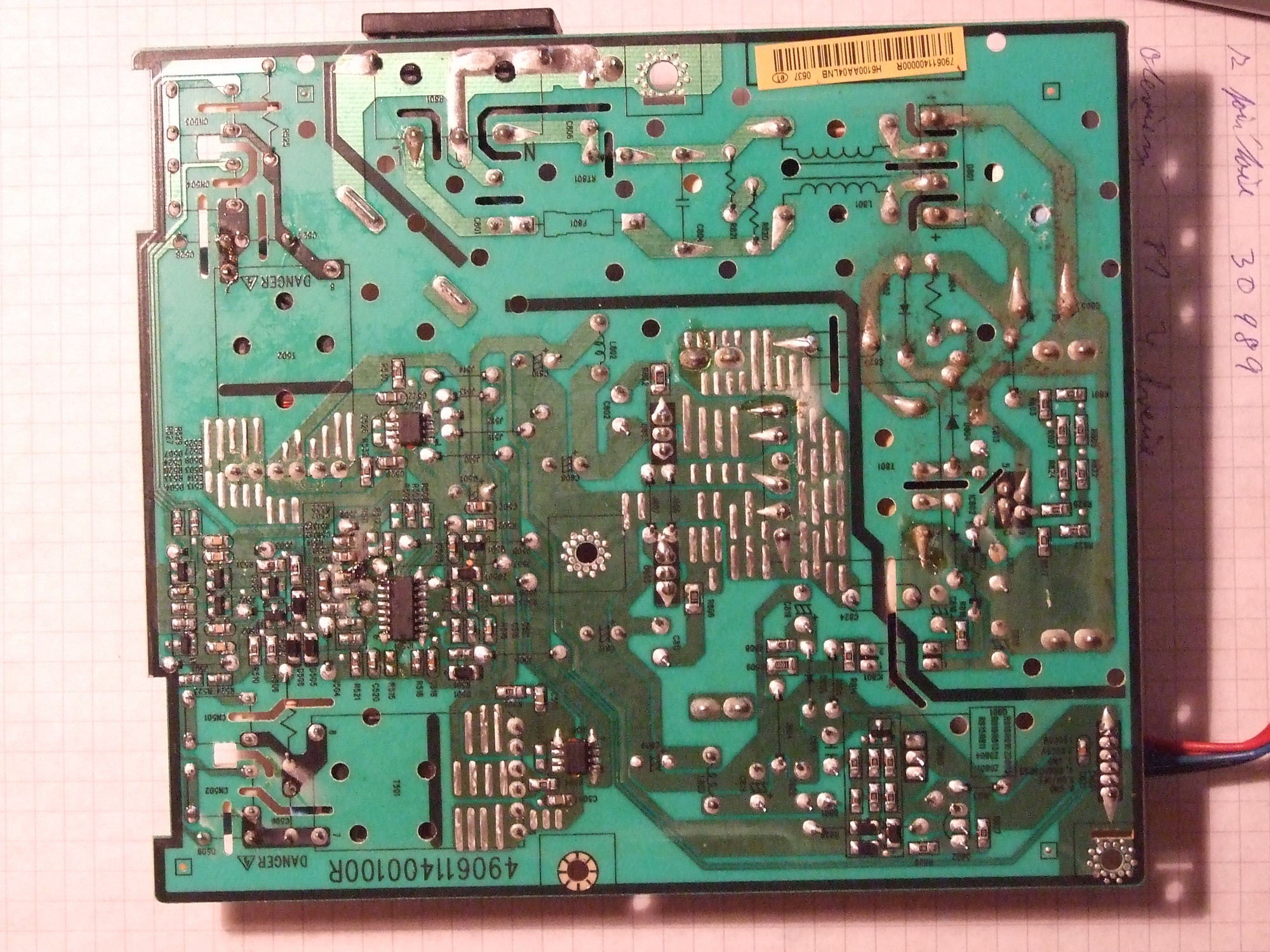

            I have measured the PSU. The main capacitor has voltage around 100V against ground, it was stable. I haven't measured output voltage to the CCFL because I'm not sure about the voltage - 2000V is too high for my equipment to measure. Once the CCFL went on for short time, I suppose, that they are good. During the measurement LED stopped blinking for a while. There was such a high buzzing noise. Then it stopped. LED wasn't shining any more since then. But the buzzing noise continued to appear every 2 minutes or so.
            Any ideas?

                    Check the voltage on the big cap across the legs of the cap. You can't get a meaningful reading to ground. If you're running the monitor on 120 VAC, the voltage across the cap should be 165 - 170 VDC.
                    Don't bother trying to read the voltage out of the inverter. It's a high frequency, high voltage signal. It takes a special meter to get an accurate reading.
                    EDIT. OK, you already did that. 340V is about right if you're running it at 240VAC. I assume you're in Europe where the use REAL electricity, not the wimpy stuff we have here in the USA.

                          A quick lesson. The power supply converts line voltage to DC, in this case it outputs 5VDC for the logic board and probably 12VDC for the inverter (which happens to be on the same board). The logic board feeds two signals back to the inverter - On/Off and Brightness. When the power LED starts blinking the logic board also instructs the inverter to turn off. That's why pin 5 dropped from 3.21V (On) to 0V (Off).
                          One question - was the VGA cable connected to a WORKING computer - one with an active output?

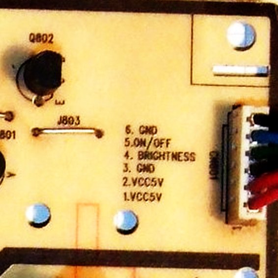

                                No, the signal is going in the opposite direction.
                                Pins 1 & 2 are 5V from the PSU to the signal (logic) board 5.08V is right for this.
                                Pins 3 & 6 are Ground
                                Pins 4 & 5 control the inverter (the power supply for the backlights). 4 is brightness, 5 is On / Off

                                  Exactly.
                                  Think of it like this :
                                  The PSU has the inverter on the same board, but it does not know when to turn the lamps on or off. It pumps out 5v (5.08v in your case) to the Video/Signal/Main board for it's components to work, and internally, via jumpers, delivers between 12 and 14v to the inverter part of the board.
                                  The VBoard process the signal input, and if there's valid signal, it send a signal (5v normally) back to the inverter to signal it that the Back Light should be turned ON (that's why normally this line is called BLON, BL_ON, or, in your case, ON/OFF). The line called BRI (Brightness) is used to control the intensity of the lamps when you modify the bright setting. It is variable.
                                  If you remove the signal, the VBoard removes the signal from the BL_ON line and the inverter shuts off. This is under normal conditions. If the VBoard has any fault, and the V on the BLON line cuts or varies, the lamps would be turned off.
                                  That's why I (tried to) told you in post #5. Now, with the readings you posted, it makes more sense. Nw we must give proper attention to the signal board. Post a picture and info on the caps present there, please, so we can continue the trip to the other side of the monitor.

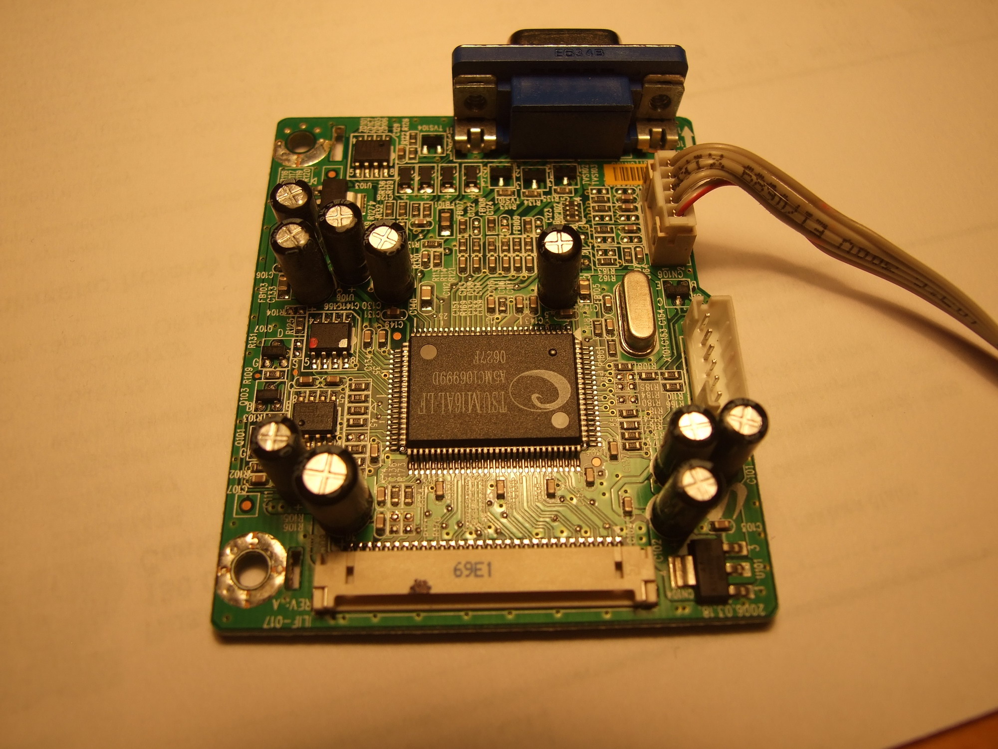

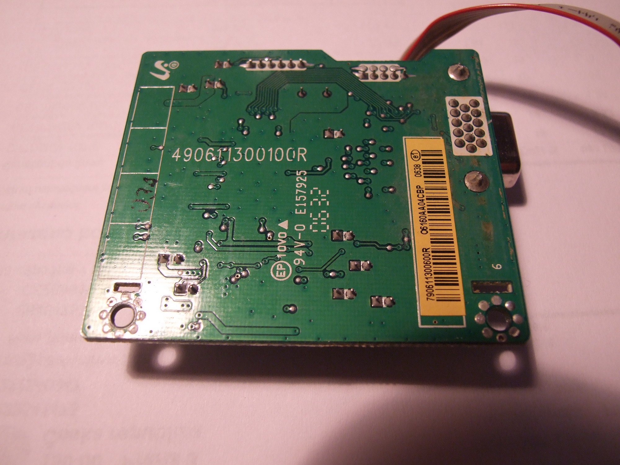

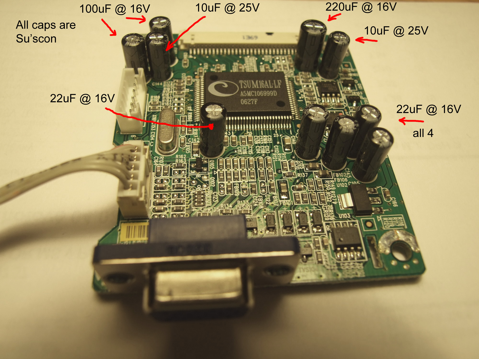

                                    I have taken some pictures of the Video Board. All caps are Su'scons. Although they are in good visual state, they may be faulty. Complete list and placement of the caps is attached.
                                    Is there chance, that the problem is in faulty caps?

                                      Well, in my case with the 568, they were G-Luxon, and I ended up changing all of them. Take a look at this thread
