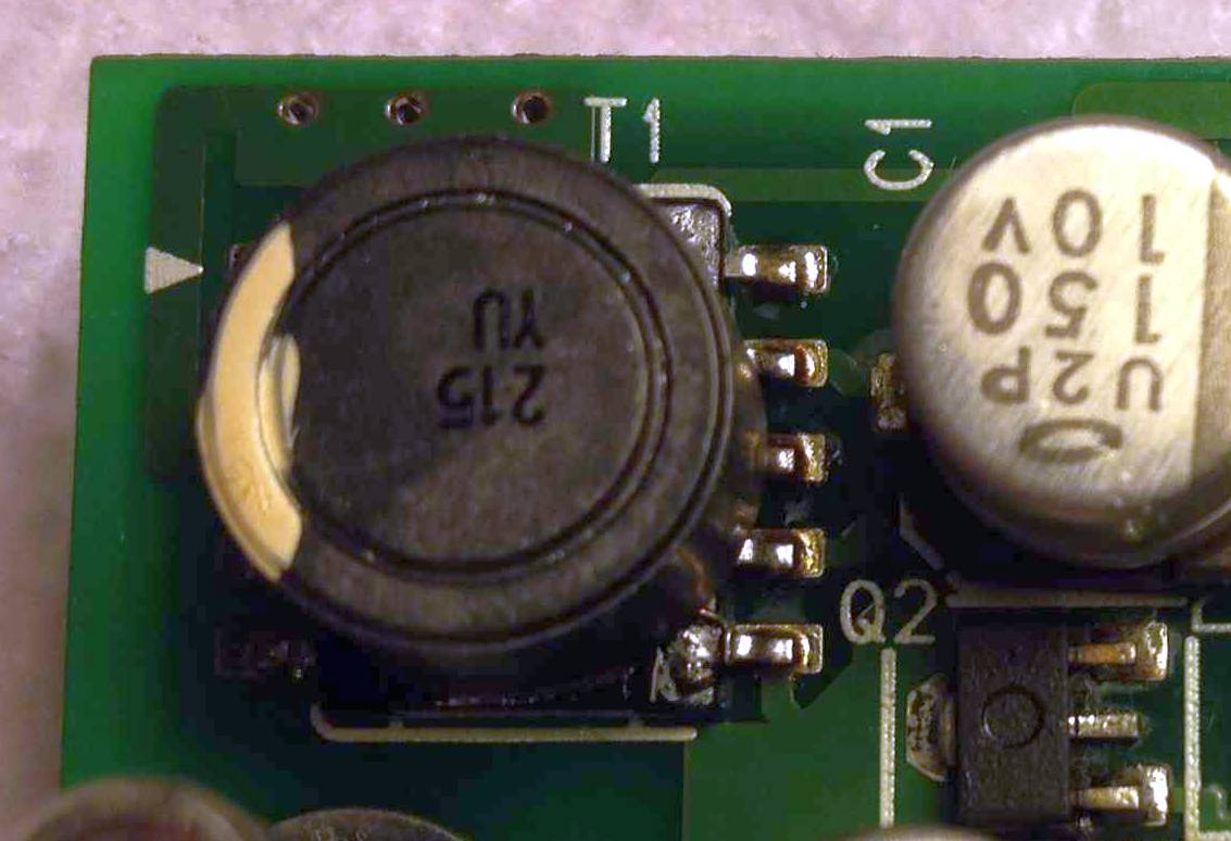

    i need some help to identify a failed part on a VFD Display.
    The wound wires of the coil are broken, maybe i can repair the coil inside.
    I would rather buy a new or similar pulse transformer.
    But i can´t get any Information about this pulse transformer, i mailed futaba in USA, JP, Europe. They don´t respond to customer requests.
    Has anyone a idea if this is a standard puls transformer or a custom one?
    It must be a SMT-10 type with 3 Connections left and 3 Connections rights.
    I think it´s used for the 5V and 30V DC/DC-AC Conversion of the VFD...
    Thanks in advance.
    Jürgen

    Might want to take a look at what this guy did:
    https://www.eeweb.com/member-project...cement-display
    Also, found a manual for your board, it is attached.
    You might find what you are looking for in this PCM80 service manual that uses the same display, attached.
    Lastly, you might take a look at this thread as they seem to be talking about a replacement board for you display:
    https://www.gearslutz.com/board/geek...d-display.html

      Thanks,
      i had found these information in the past.
      One ESP with OLED is on it´s way.
      But i would like to rebuild the DC-DC/AC part.
      The display draws way to much current.
      I already send mails to some futaba mail address, but they are not interrested in business relations...
      Mayby i try to repair the transformer (soldier some fine wire to the windings and use caption tape for isolation).
