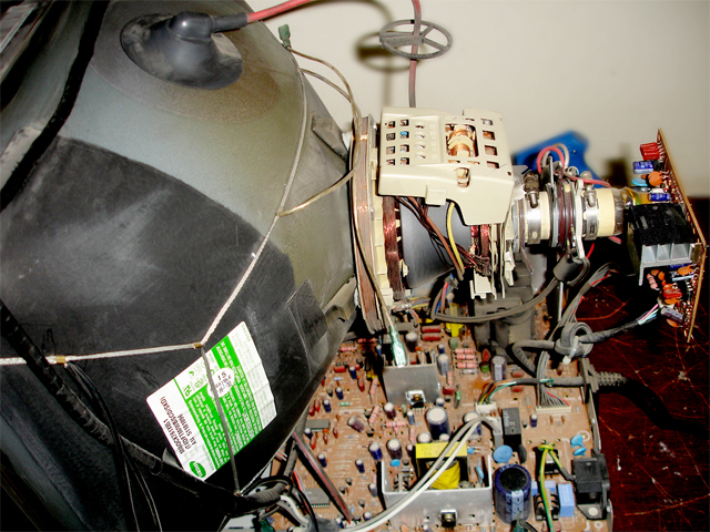

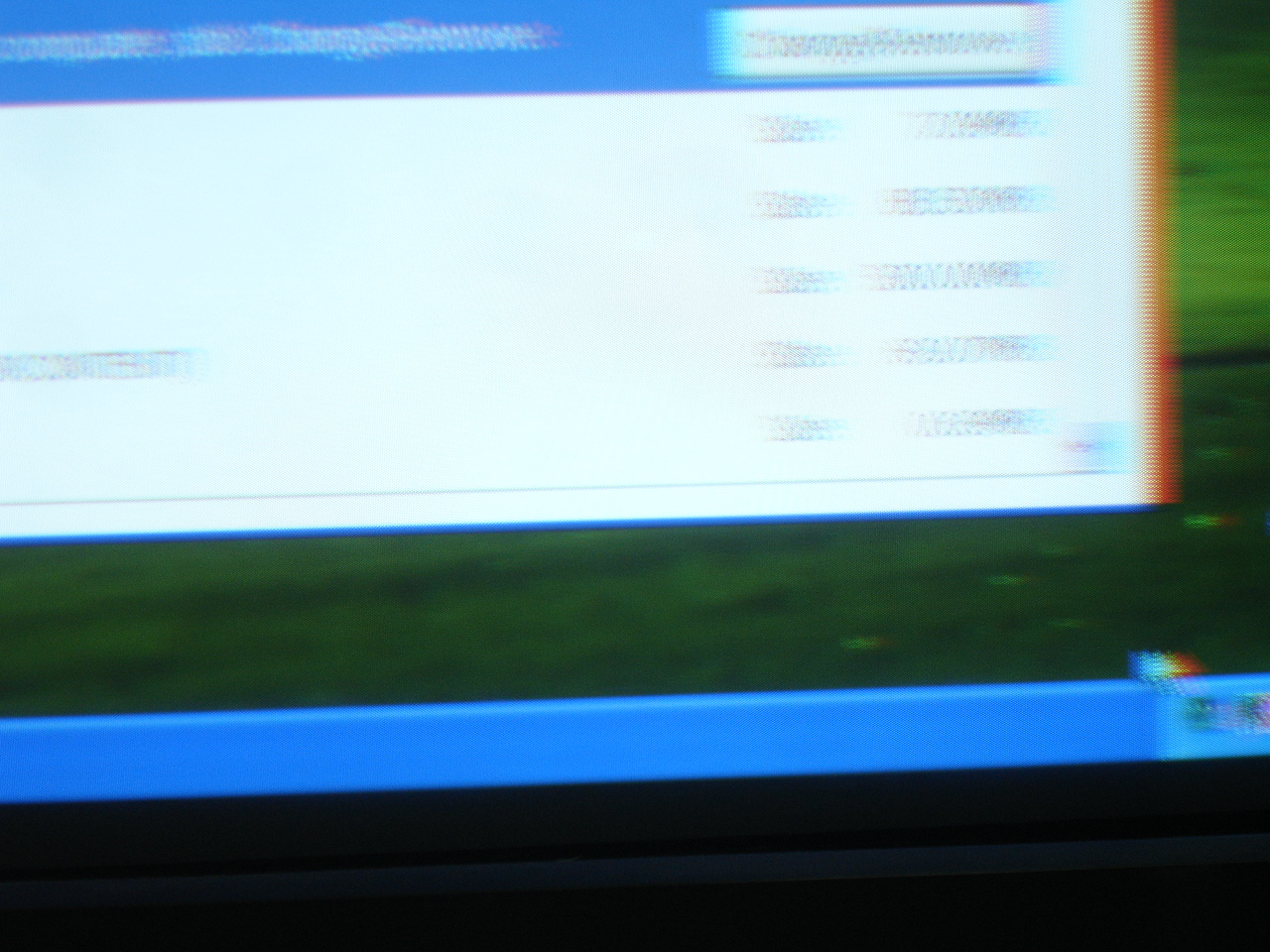

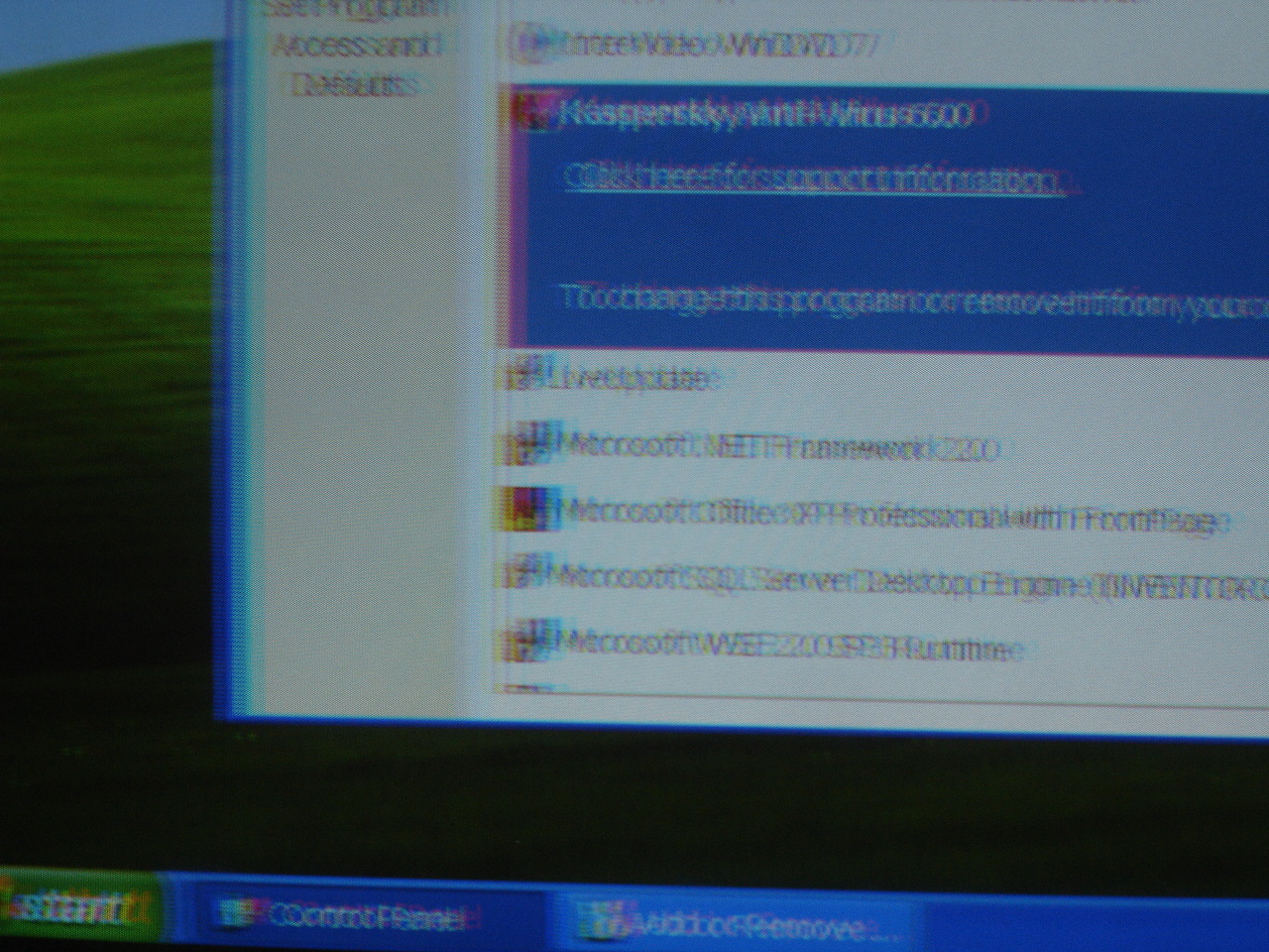

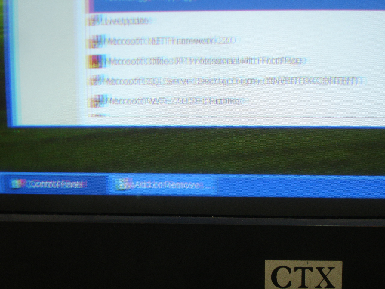

    I have this faulty monitor and I was thinking instead of disposing it maybe I can try my luck to repair it through some help from electronic enthusiast around here. Actually, this monitor is quite old a 19” CTX Flat Screen but unfortunately got trouble in the display which was blurry display. I was trying figured it before by re-adjusting the tune at the flyback but to no avail. I think it was the best shot from the flyback yet blurry output. I'm just crossing my fingers that someone could help me out. Thank you
    I also attached some actual shots from the display.

    Convergence. This usually means failed yoke, not replaceable on 1 RGB CRT. I had this happen often on philips TVs.
    Convergence are *not* adjusteable on 1 RGB CRT stuff, yes on some sony (especially high end) and any projection 3 CRT type.

        bad focus that far out will also have bad convergence.
        samsung crt says it all.recycle it its done.
        anything,even a chungwha is better than samsung when it comes to crt's.
        one last thing you can try is to ground a screwdriver with a cliplead.
        pull the socket.
        power up the monitor and while live ground the focus pins.they are walled off from the rest.if you get a nasty snap it means you may have cleared the leakage.you will have to readjust the focus.
        otherwise its junk.focus network in the fly will look like that too.

                  hi thanks, can you give me a proper procedure how to do it cause i'm bit confused. Better if some illustration please.. I'm afraid to mess out with 24KV

                    hi, can you make some steps how to do it. I attached photo for you to label with.. thanks

                              There are no convergence ampifier on 1 CRT color stuff. Rings on the neck is only for overall static convergence to get three electron beams lined up.
                              Like I said yoke does affect the convergence also. When a yoke fail in a way, convergence goes out the window. But most of time when a yoke goes bad, either vertical IC either smokes or fail with time or the horizontal transistor fail instantly. But convergence going out of adjustment via yoke does happen. I have seen this many times.
                              Sudden failure of this you have, just dispose of it. Not worth the time.
