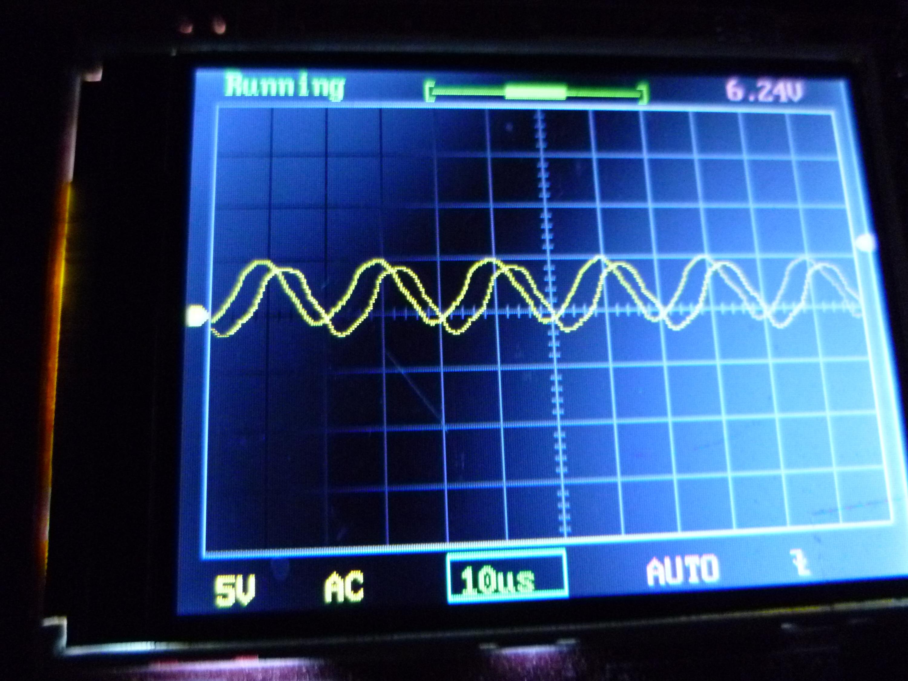

    Ok, here is the first tests.
    Originally posted by Dumah Brazorf View Post
    What measure pin 1 and 16 in this case?
    Dumah, you are going to see what I get on pin 1 and 16 in the photos.
    For Will:
    Lights come on nice and solid, no flickering no tint, just white light top and bottom.
    First I show you my setup, so you can admire
    Next are the photos for pin 1, then pin 2, 3 and 16 respectively. 1, 2 and 16 look smooth, but pin 3 is pretty spiky. I took 2 photos of pin 3 so you could see the amplitude, especially on photo 2.
    So what next, do I next, do I flip the board and do the tests, or is there something wrong with pin 3?
    Tks a million!

      Swap the lamps. If pin2 became spiky and pin3 smooth there's something wrong with a lamp.

              Ok, found my problem with the waves jumping...this oscilloscope has alligator clips so the ground is fine, but the probing wand I had to make out of a copper wire (solid) and I was holding the wire instead of the plastic covering the alligator clip, creating disturbance I guess.
              Here are the real pins 1, 2, 3 and 16, with the CFL's connected as original. I noticed that I have a hold function on the oscilloscope so I used it to take the pictures, hope that's ok.

                ok, redid all the tests CFL's inverted and CFL's in their original position and here are the photos of the scope.
                I noticed pin 16 was changing frequency quite a bit, so I took a little video (hope it's ok to post it here, if not I will remove it no problem - had to put it in a zip file because the extension is not allowed) to show the movement of the wave.
                  Re: Benq G2255 doesn't power on - amber power light when plugged in
                  Good job on the pics and video. Those voltages (min,max,pp) are all over the place, and not following the lamps to different connections. The waves also don't look like what is expected based on the datasheet (pic on post#114). Note that the "LI" waves center on 0V and the "OV" waves center on 6V. Keep in mind that we don't have the datasheet for MP10091ES. I am looking at the datasheet for MP1009. I have seen specs that refer to the 10091 as being from the 1009 series, but we already know they have different pin-outs, and they probably also have different internal parameters.
                  I wonder if some of the wave changes are related to when they were measured. We know that the chip is seeing something that it doesn't like in the first couple of seconds. Just to be sure, Can you please redo the tests, but start each test from power being off. Try to press hold as quickly as possible on each test. No need to take new pics, just give me min, max & pp for each pin at startup. If pin 16 is doing what you show in the video, I don't doubt that it is causing the shutdown. There's a couple of ways to check that, and we'll try those next.

                    Ok, here are the readings for pins 1, 2, 4 and 16 (I also jotted down the frequency):
                    Frequency Min Max PP
                    Pin1: 59.19Khz -37.58V 5.23V 42.52V
                    Pin2: 71.49Khz -37.58V 6.64V 44.23V
                    Pin3: 71.036Khz -37.58V 7.85V 45.44V
                    Pin16: 71.78Khz -37.58V 3.22V 42.81V
                    Hope these make sense. I put power on and as quickly as possible pressed the hold button on the scope.
