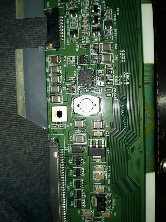

    This display has the similar problem like another post on this forum for the same model of display-- backlight on, but LCD black. Following through that post lead me to take out the LCD panel and check it. Only it seems that HP changed LCD panel providers or Samsung the maker of the panel changed the driver circuit, because what I have with the Samsung LTM190EP01 panel is a different set of components. But anyway, I found that the one fuse on the driver board (F1) is blown. I didn't find any shorted capacitors, and between the terminals of the two voltage regulators (LD33 and LD18) there is some resistance ~2k on one, 500 on another.
    I guess the best thing is to desolder them and test?
    I noticed some marks inside identifying which wires go where, so I'm not the first person to have opened up the display it seems, and as I just purchased it for 10€ ("display is dim" the seller said), I don't want to put too much time in, but if there's an easy fix, that would be cool.

    I couldn't get the two regulators unsoldered, so I just applied 5V to the input of the first, and got 3.3V out on it, 1.8V out on the next. So regulators don't seem to be bad.
    Is it ever possible that just "sh*t happens" and replacing the blown fuse things will work again?

      I got impatient, and just shorted out the fuse. so far its working . :-)
      If it fails, then at least it has a nice adjustable stand with a VESA mount. I guess I'll order some fuses off ebay though if it continues working the rest of the day.
        The picture you posted is of the T-con board (the board that is attached to the LCD TFT.) Just stating this for clarity.
        Rarely, but YES.
        Most blown T-con fuses are usually a result of shorted ceramic capacitors on the main and secondary boosted voltage rails. That said, I've seen two cases of blown fuses with no problem (both of them were from badcaps.net members).

        For the future suggestion, though - do NOT short fuses directly - ever! This can cause more damage (and sometimes make the device unrepairable). Not to mention that doing this on a mains/high-power fuse, that can be a fire hazard.
        If you don't have the right type of fuse, it's OKAY to use a lower-rated fuse. In this particular case with your T-con, you could have soldered some wires to a regular standard 5x20 mm fuse and soldered the other ends of the wires to the T-con board. I do that all the time when I don't have the right type of SMD fuse.
        Anyways, congrats on the repair!
        And yes, definitely get the correct replacement fuse.
