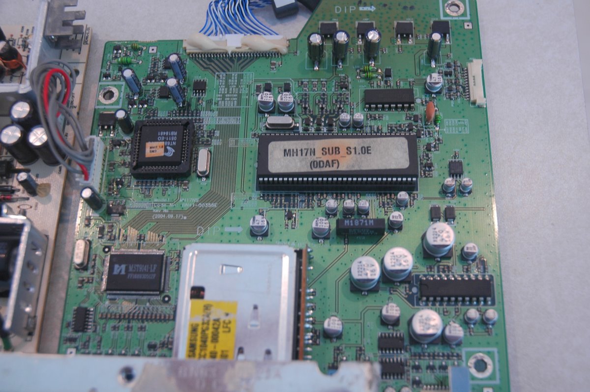

            Picture of video board from 710MP
            Here is the picture you requested
            • Wizard
              • Mar 2008
              • 2296
              Re: Samsung SyncMaster 710mp TV/Video fine, but on VGA goes dark

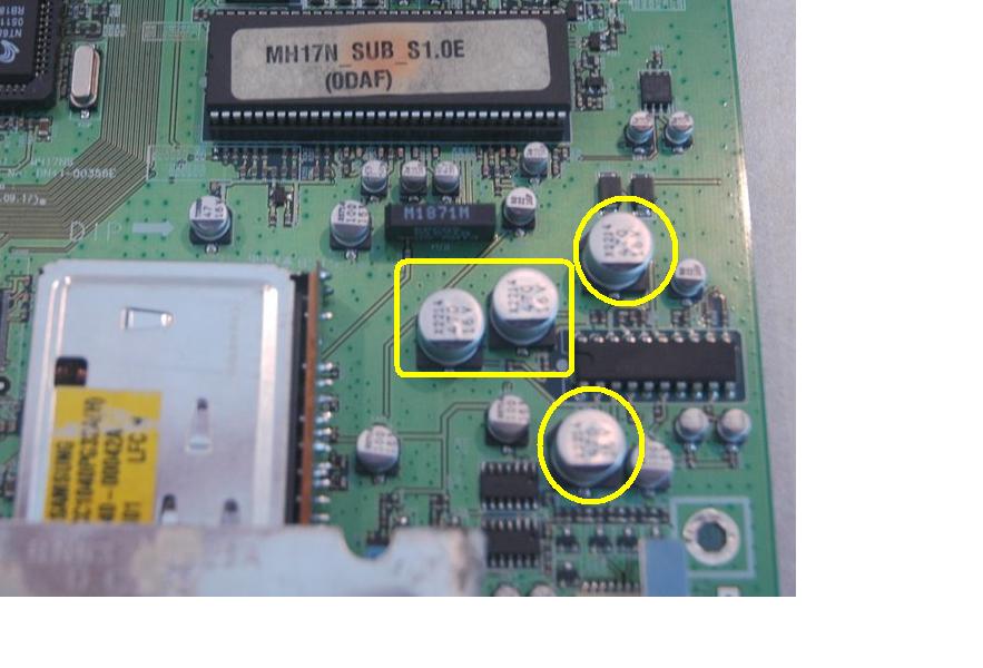

              Change caps in circled:
              http://www3.sympatico.ca/jpero/allpa...0MPcircled.jpg
              Do have enough height to use regular low ESR electrolytics with bent leads to the solder pads for the SMD electrolytic capacitors. I hate those as they are always bad on heat and ESR goes way up, simply grasp the cap with needle nose pliers and push down while twisting back and forth till leads breaks, flick off the remaining leads with your soldering iron.
              Cheers, Wizard

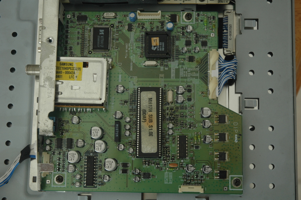

                            Well, I finished the video side. Turned it on and got flicker right away. Then it straightened out for a while, seemed o.k. then... dark. toggled thru inputs and it stays on vga for a longer time. we'll have to see.
                            Here is a pic of new caps on video side:
                            • chevelle_nut
                              • Dec 2008
                              • 62
                              whoa I could have sworn I shrunk that pic !!!
                              • PCBONEZ
                                Grumpy Old Fart
                                • Aug 2005
                                • 10661
                                The caps I circled in your photo are SMD electrolytic.
                                The vent stamp marking in the top is the give-away.
                                Can't tell manufacturer.
                                They are 470uF 16v and that's big enough to be of concern.

                                  This is audio ampifier/audio processing. Not so crtical.

                                    Day 2, it's still out of the case, but it's working. Nice and bright on vga, and still just as good as it's ever been as a Tivo monitor ! I haven't replaced any more components than the ones in my photo. The flickering on startup I haven't noticed. I'm almost afraid to repackage it.
                                    I looked at the X marked ones but the tops are still nice and flat, I think the lighting in that pic makes them look bulged.
                                    • PCBONEZ
                                      Grumpy Old Fart
                                      • Aug 2005
                                      • 10661
                                      I wasn't saying they looked bad.
                                      Just saying check 'em.
