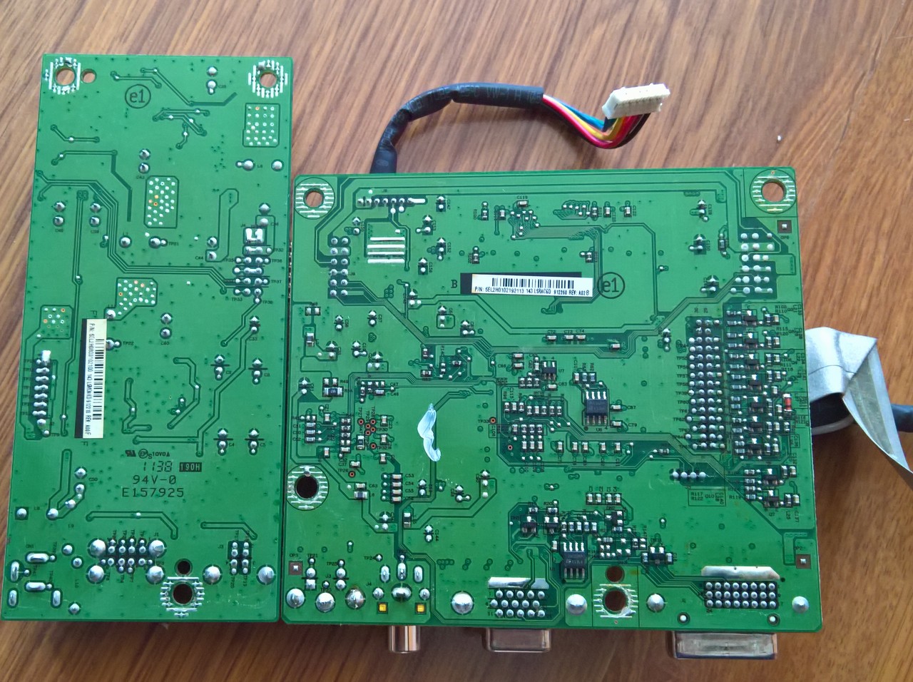

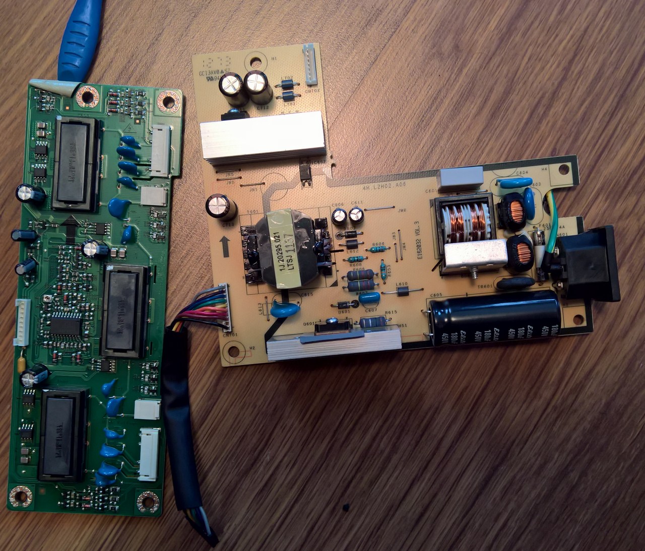

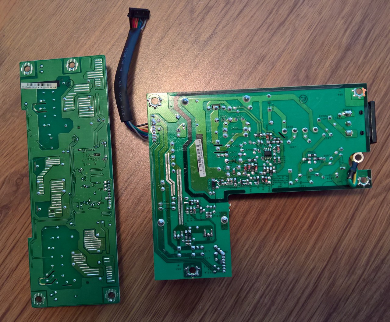

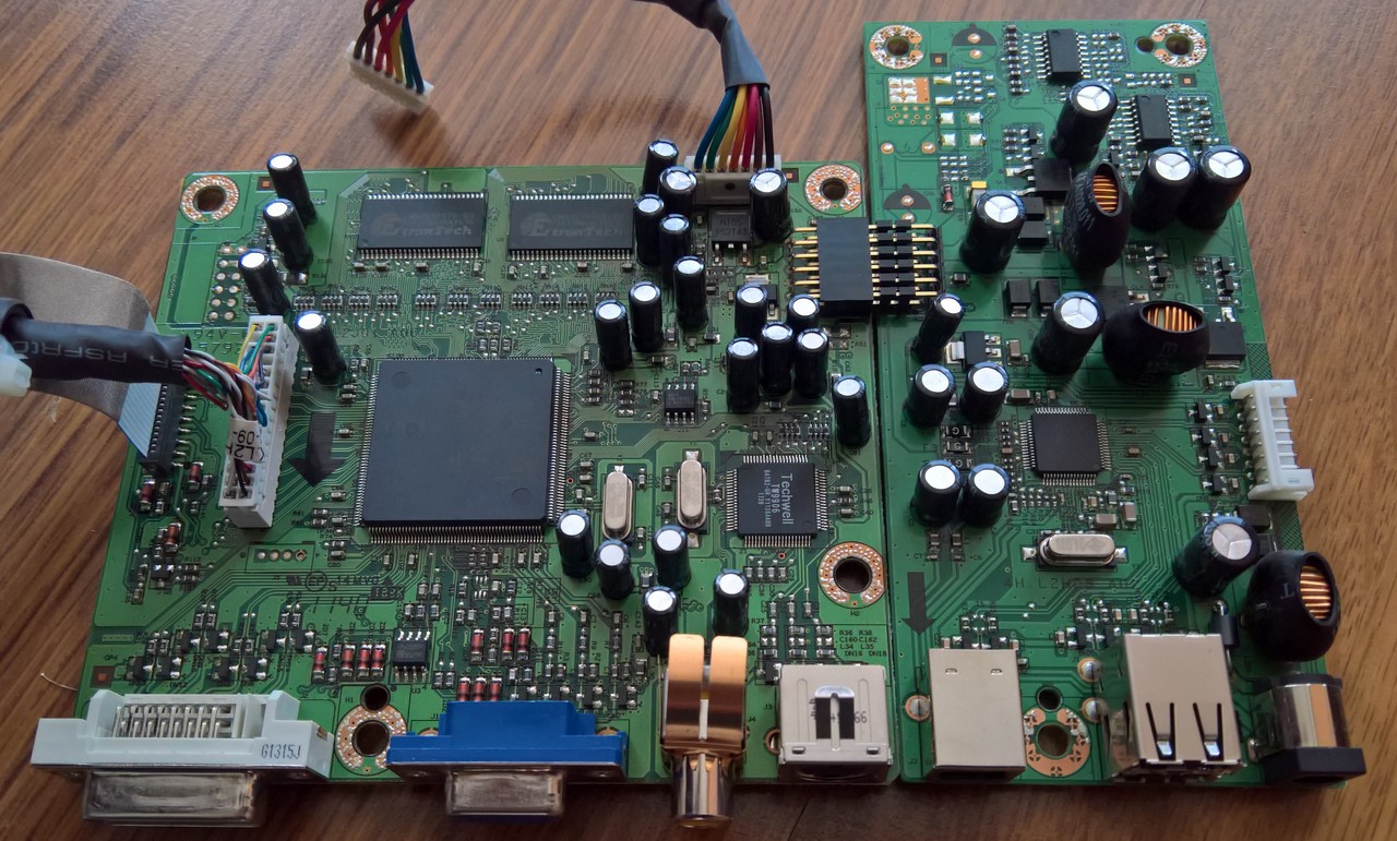

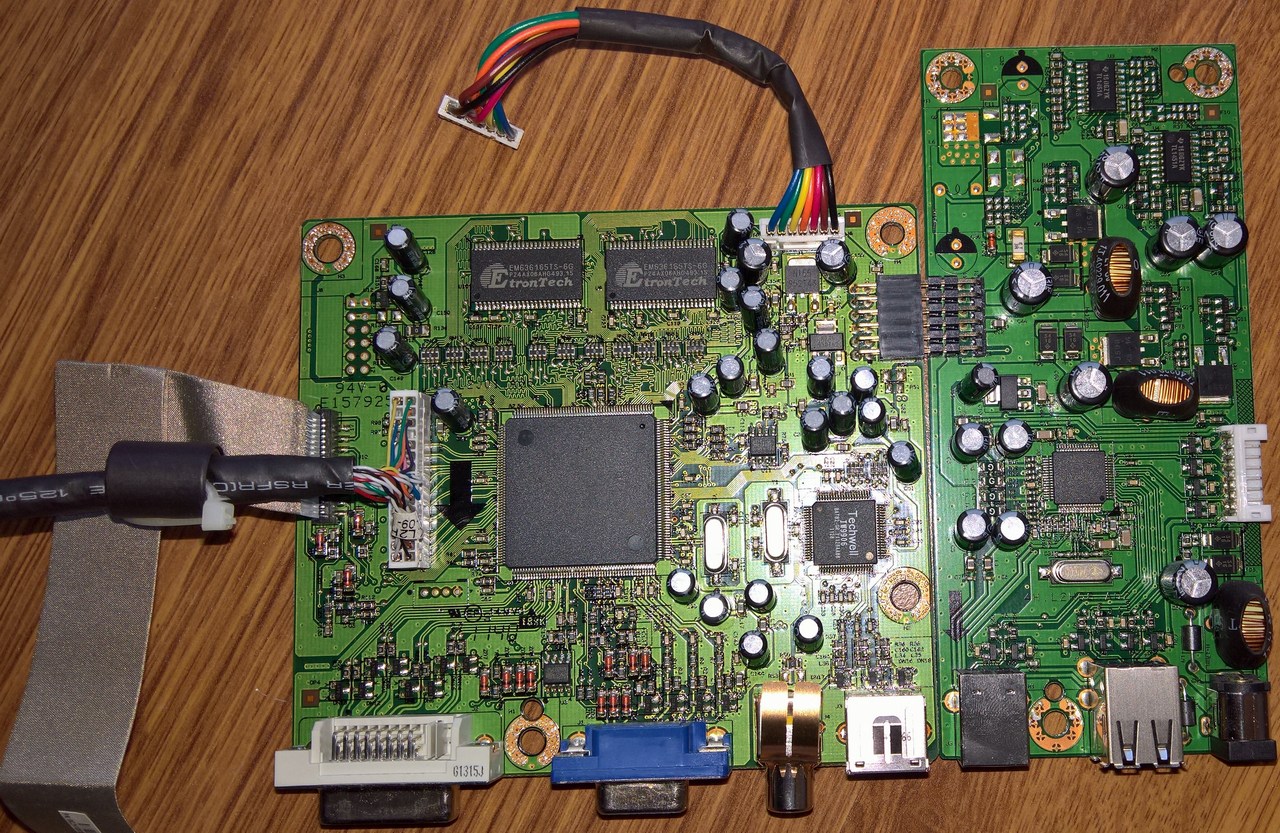

        Re: Vertical coloured bands on Dell 2007 FPu
        Sorry for the delay, I somehow forgot that I no longer had a working display back home
        Here are the photos, I also have much higher resolution available in case it makes any difference.
          My guess is your control board on you monitor is the problem maybe it's time for another monitor. unless someone else has a good thought.
