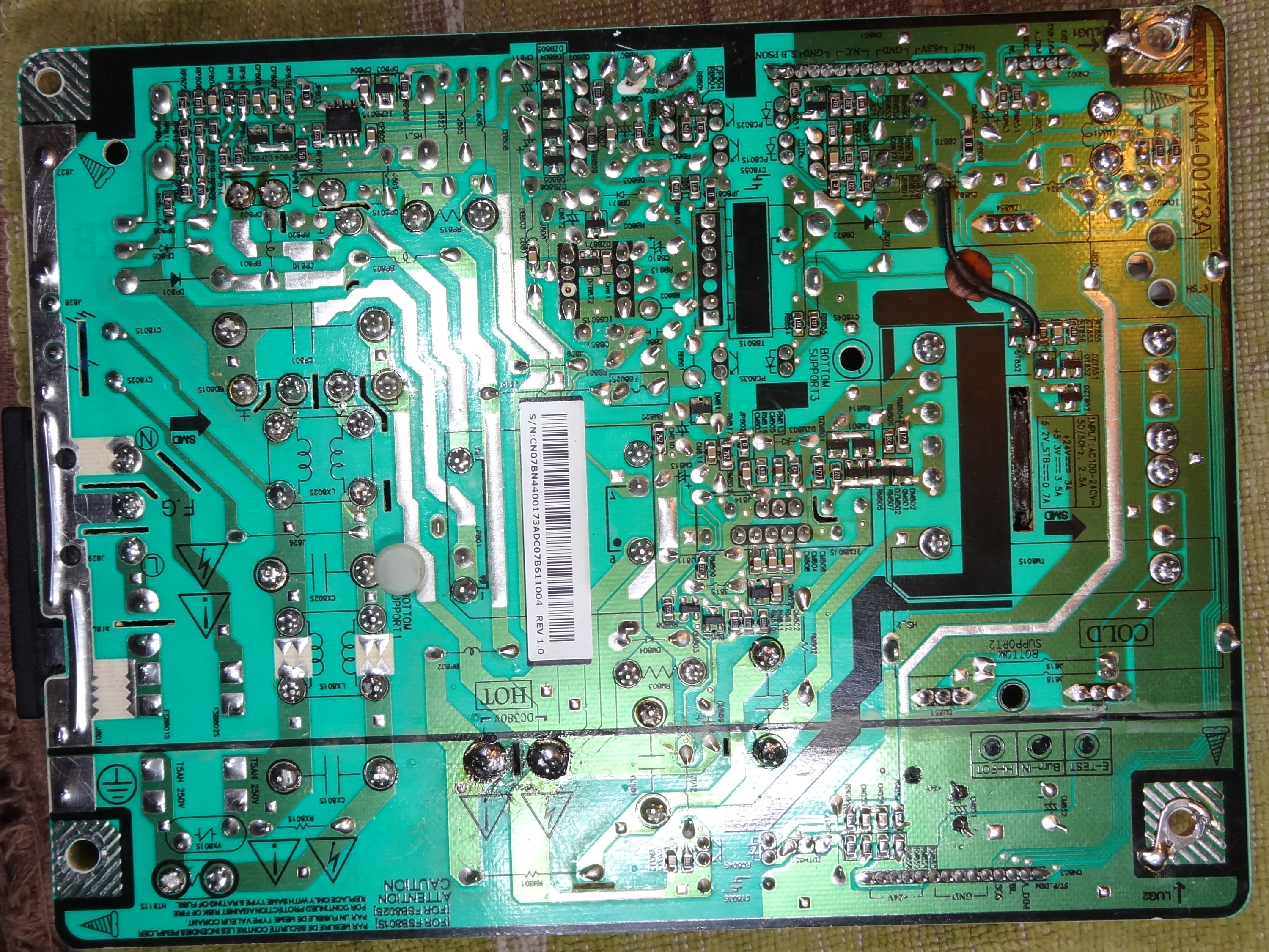

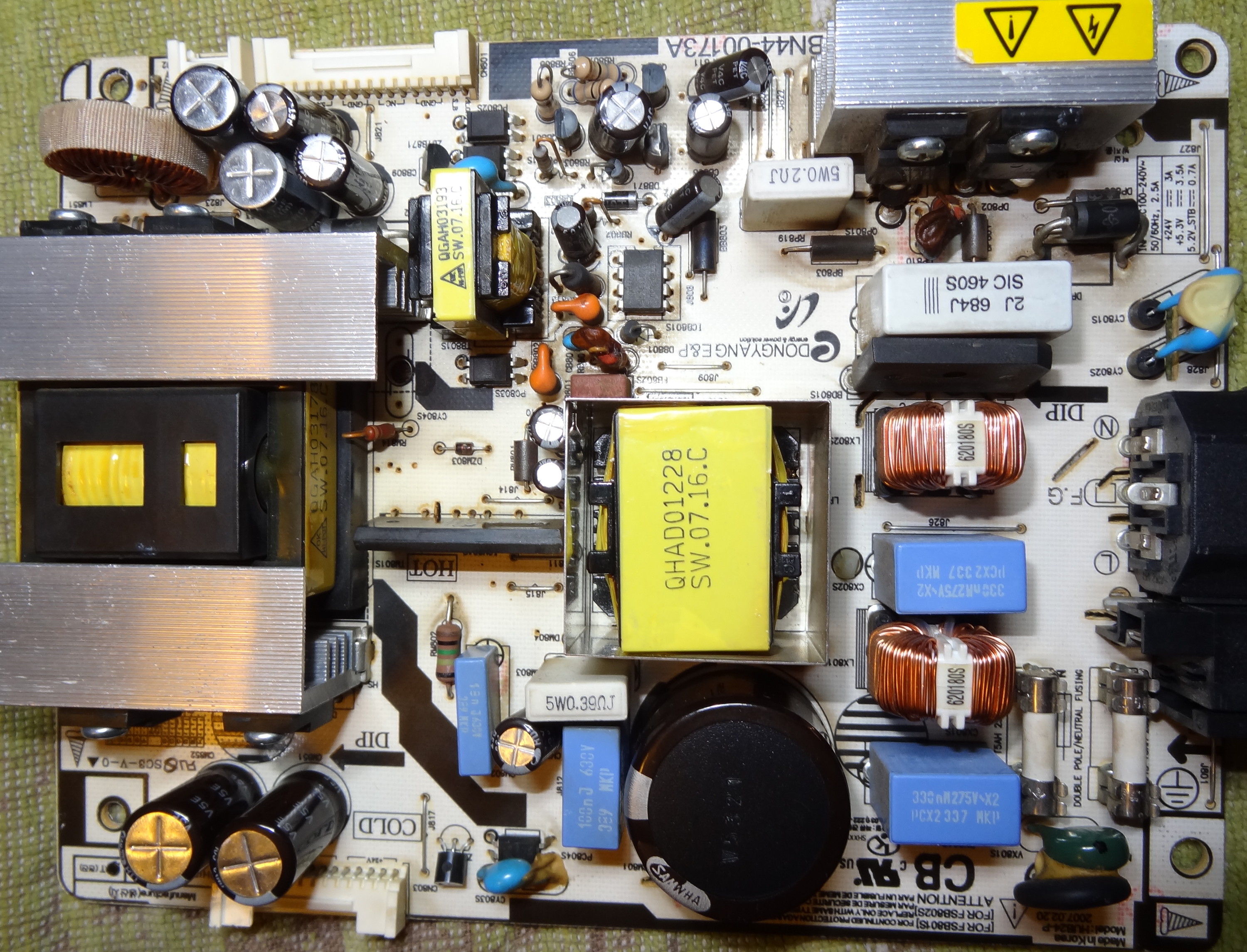

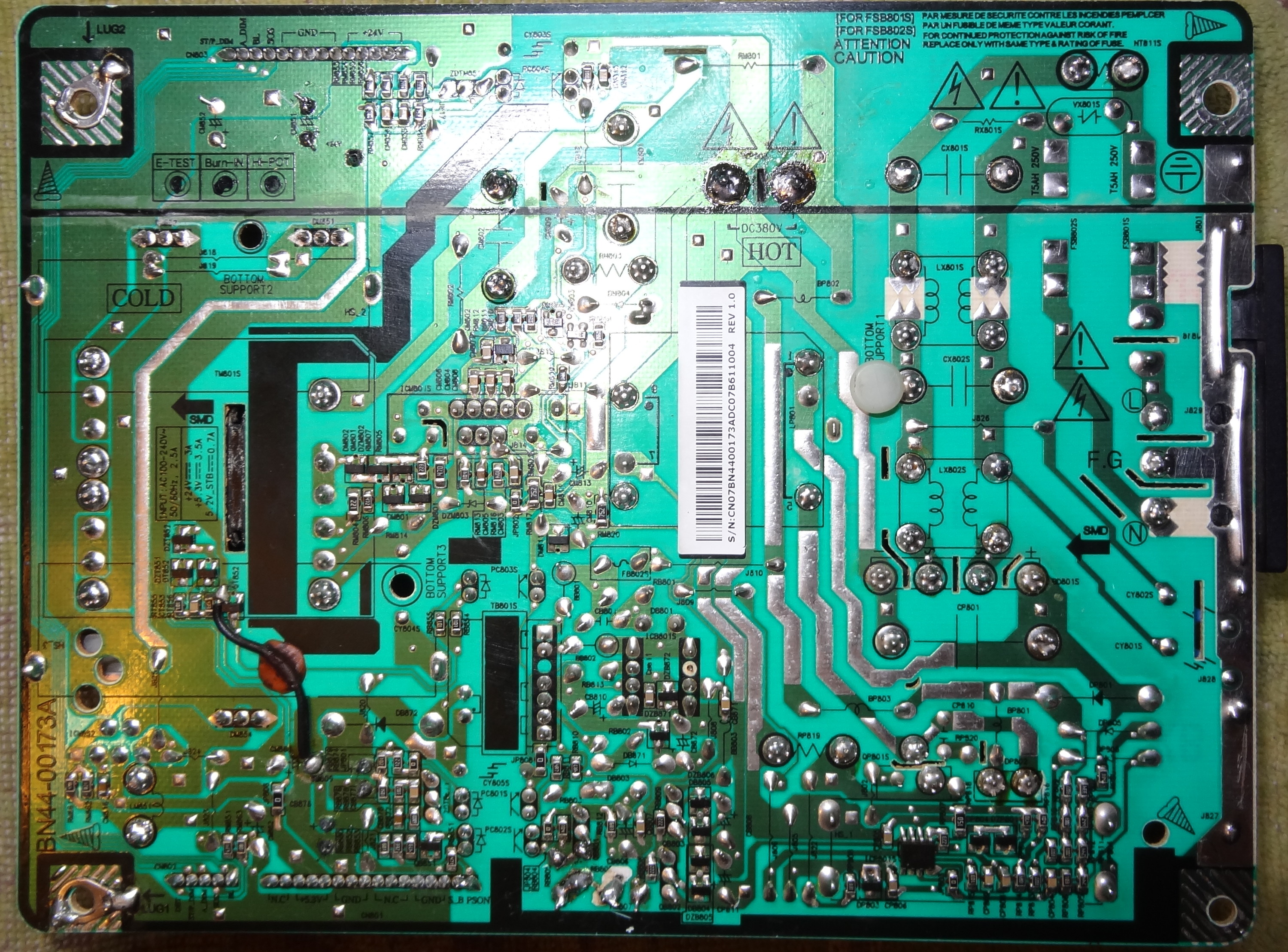

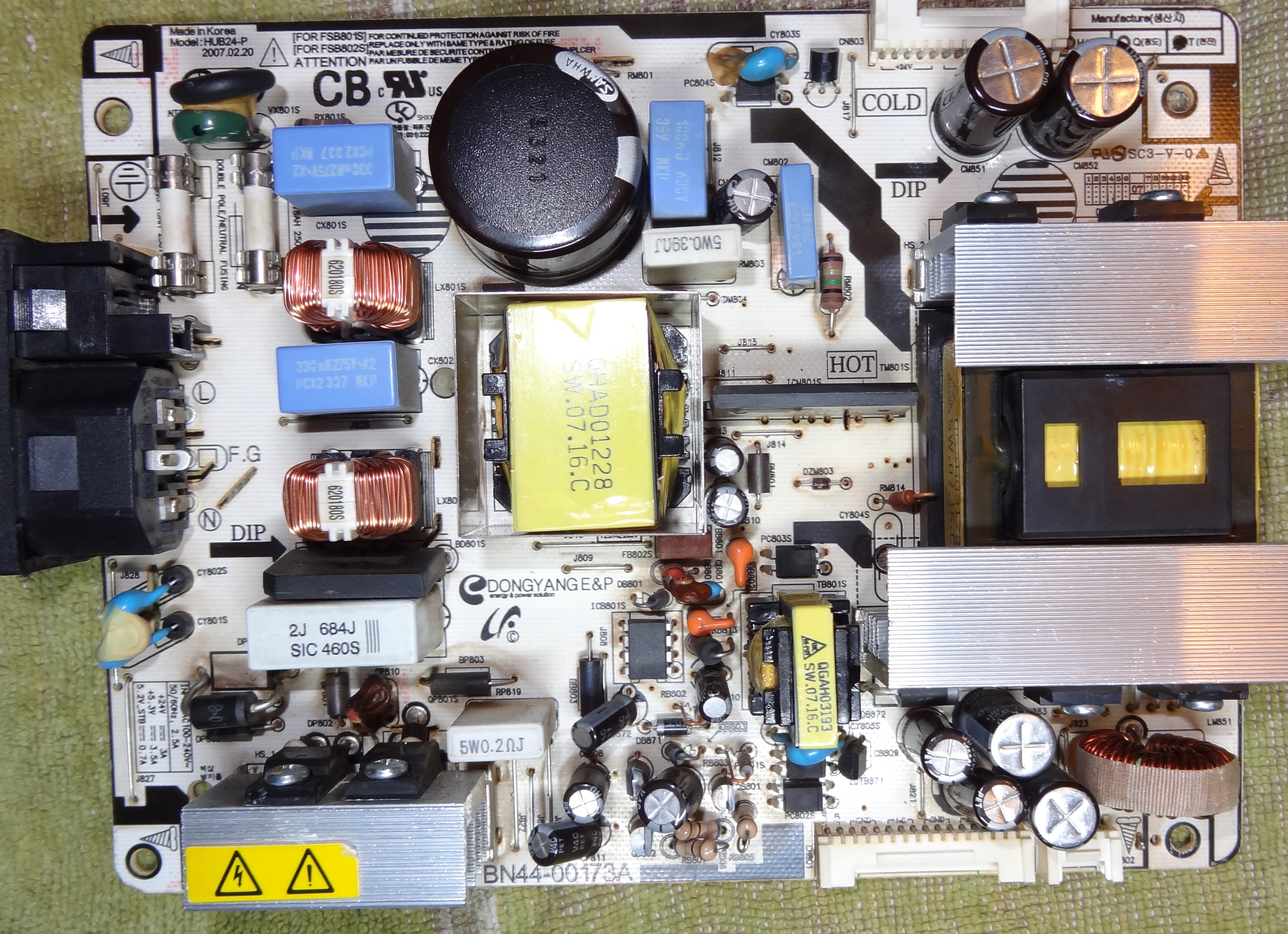

    I guess we need to have a high resolution, straight shot picture of your power supply to start with.
    • IU5ICI
      • Jan 2017
      • 12
      • Italy
      Re: Samsung 245B+ - BN44-00173A - No backlight (24v)

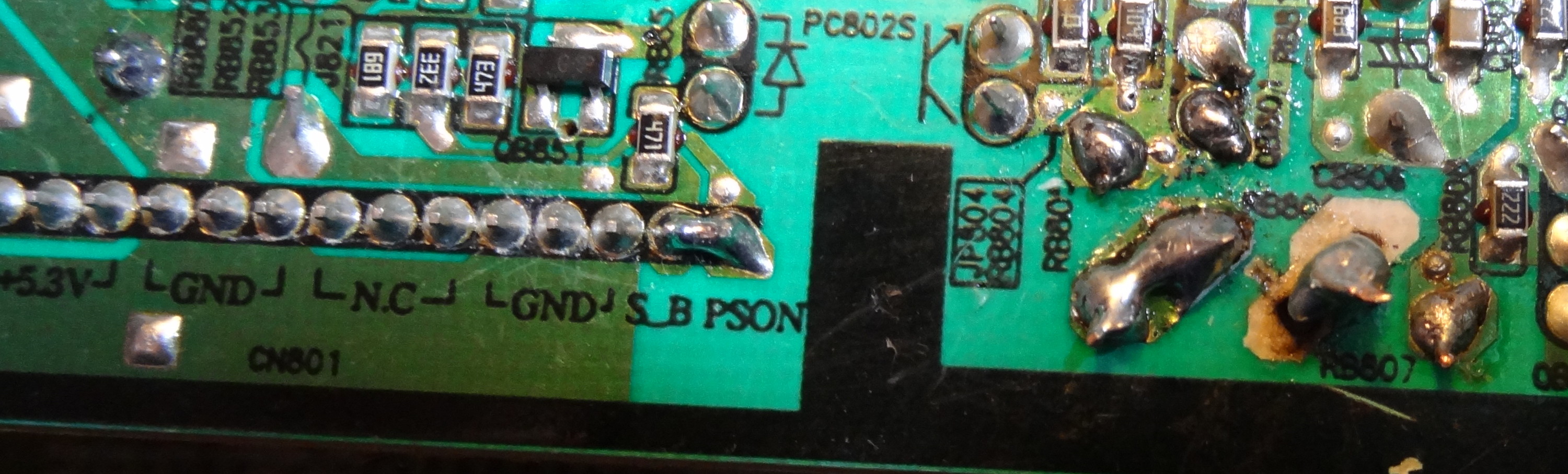

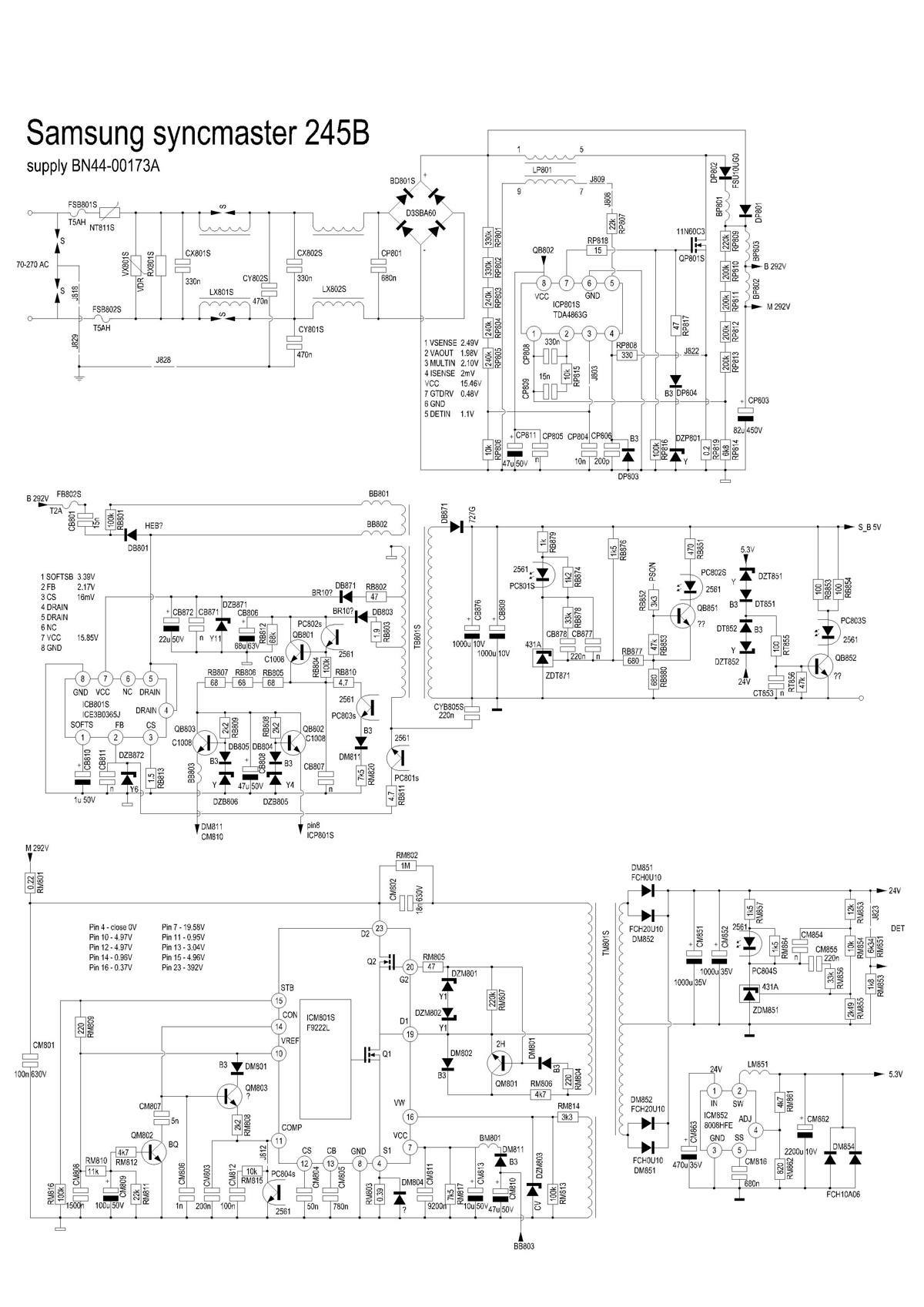

      Here they are. The illumination isn't the best, but you should still see.
      In the last pic, the bridge between S_B and PSON is there just to turn on the power supply.
      The 3 68ohm resistor are soldered badly (they ruined the PCB when they replace them but the solder is solid. They just need to be connected in series. No PCB need it the middle of the joint)
      If you need something else, just let me know. Thanks

          Picture #3 bottom right. There are 2 large caps next to the inductor. Those look like they run hot, as the sleeve shrunk a little (high ESR). Change them out. I believe it is CM862 and CM863. It should be a 10V 2200uF and a 35V 470uF. Those 2 caps don't look good to me at all.

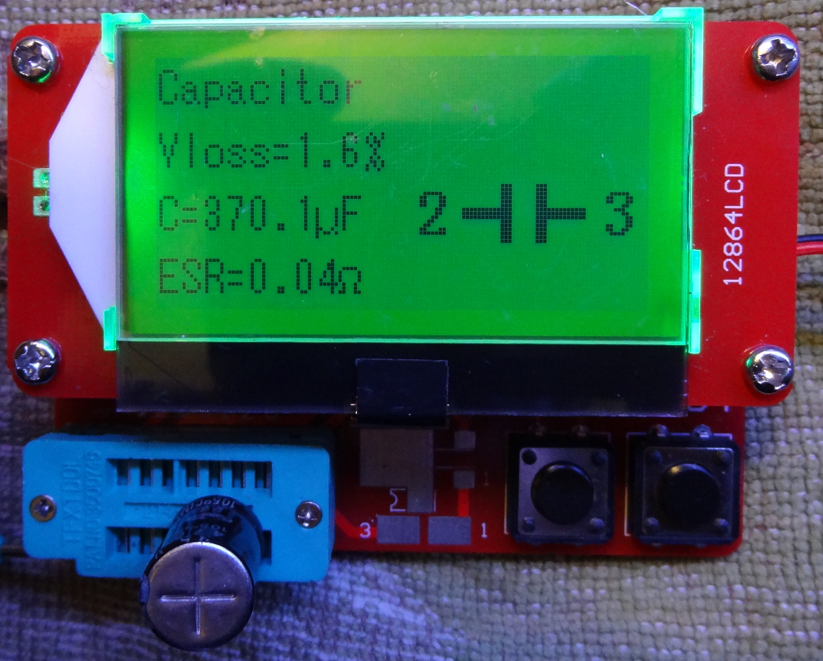

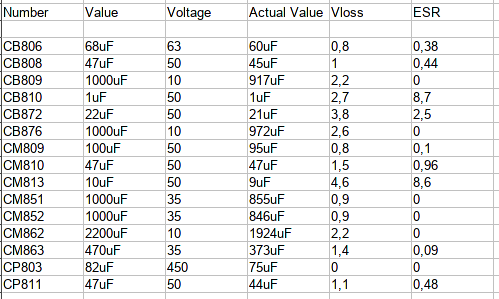

            Cm863 is 377.5uF, Vloss 1.4, 0.04ohm ESR and Cm862 is 1866uF, Vloss 2.2, 0.00 ESR
            Since i should order some new caps, i'm going to replace them all and write if that fixed the problem.
            If not, at least we sure know that caps aren't the problem..
            For now, thanks for the help..

              CM863 is below 10% tolerance (377.5uF vs 470uF) so it is toast. I question your ESR meter at that point, it is not possible to have a 0.04Ohm ESR on that. The shrunken sleeves are a dead give away. Did you check them in or out of the circuit?
              • IU5ICI
                • Jan 2017
                • 12
                • Italy
                My ESR meter is just a cheap chinese component tester.
                But i can tell it isn't good at all.

                    I've removed all elecrolytic caps (to order new) and i read their values.
                    I'm pretty sure the ESR value is completely wrong.
                    At least the capacitance is about the same as two other DMM (different brands), so i "trust" that..

                            So is the SMPS IC801S for the 24V circuit getting the VCC at pin 7 to run?
                            Check the solder joints around QB803 and verify the transistor and the ZENER are OK..

                              IC801S had 0 volt output. So i checked if Vcc was present on pin 6. There wasn't any voltage. I went checking QB802 but it was fine.
