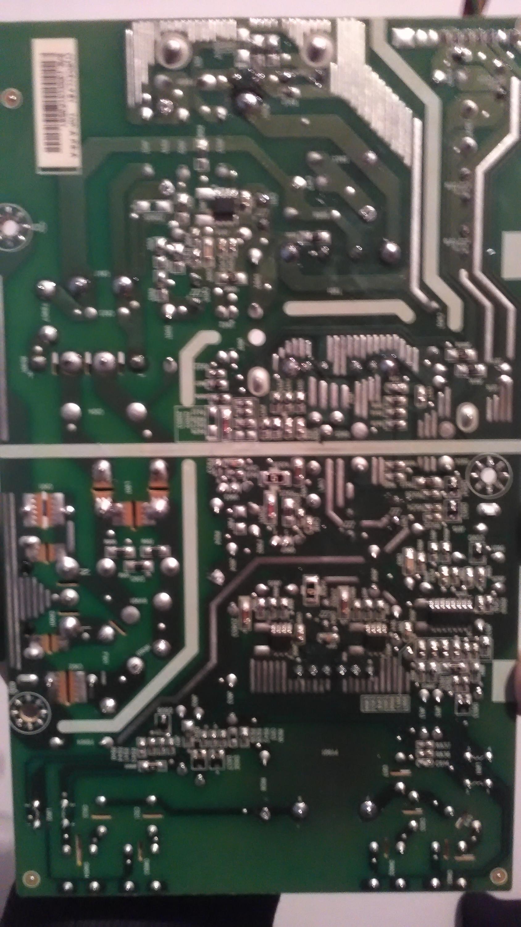

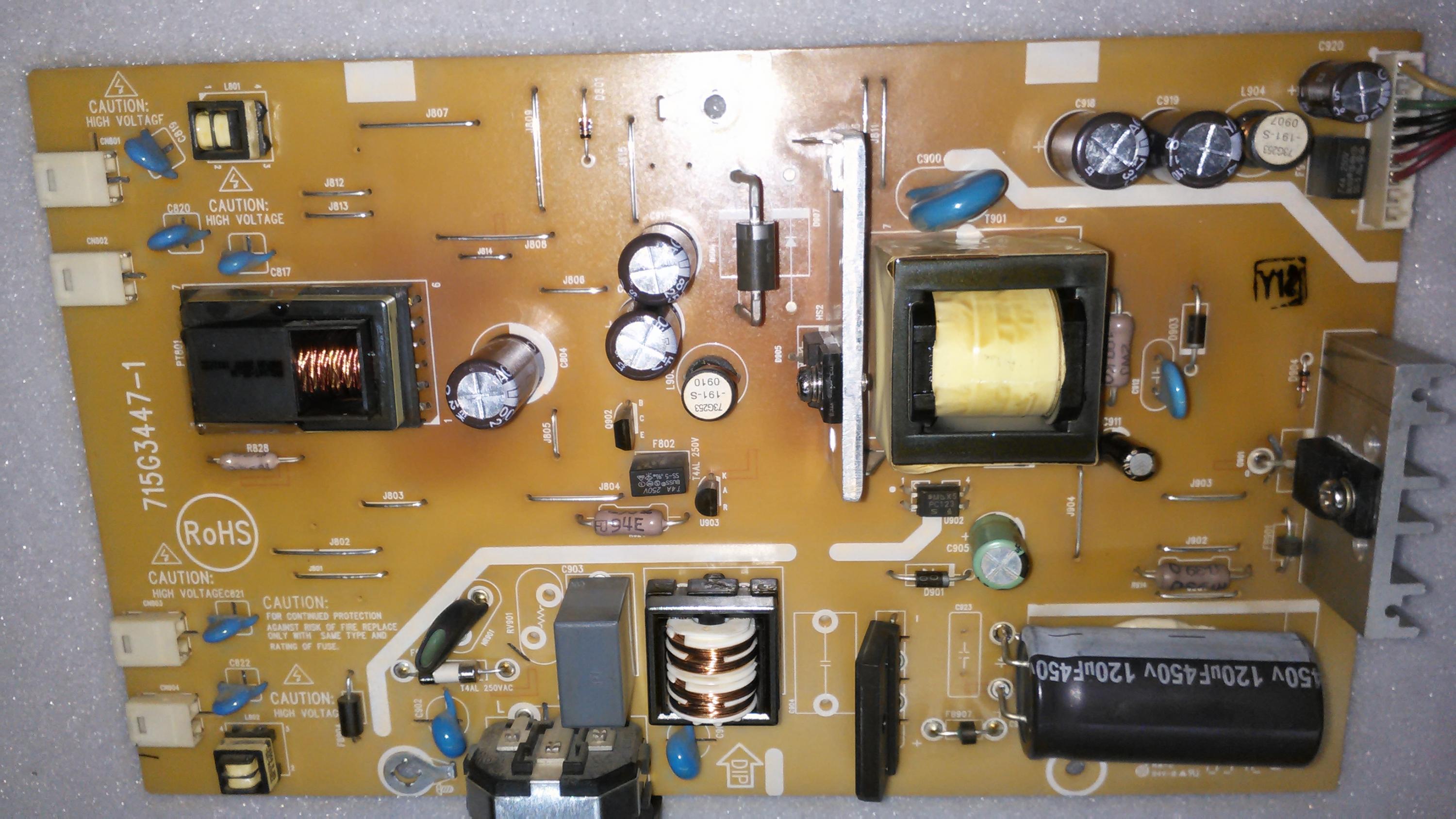

    First of all hello everyone, I have been following this forum for quite long time and I have learned a lot from all of you people and I am very thankful for that.
    I am writing just because I have no idea what to do next.
    So the problem began with CCFL turning off for some reason after a few hours of usage and then started doing this repeatedly. So the picture is still there but no backlight. I opened the monitor and replaced all caps on both VGA and power board. When I tested the monitor again "hours to death" become famous "two seconds to death". I tried my spare CCFLs on these boards and I got the similar problem (some flickering was added to problem, probably because these spare CCFLs were smaller than original ones). After that I tried whole another display with the same two boards. Same result. As a last resort I soldered required cable (power board to VGA board) to another power board I had that works 100%. And the problem is gone. So its not CCFLs, it's not the screen, it's not VGA board it's the power board. I need to fix original one cause the other one can't fit the casing. I replaced the transformer from the working one to the broken one - same result. Replaced the inverter tranformer too - same result. I tested the mosfet - seems okay.
    I also take out the big main cap and tested it, it is perfect. (that is why it looks so away from the board)
    I have no idea what to check next. Any help here will be much appreciated.
    Thank you. ^_^
    (idk why second picture wont rotate)

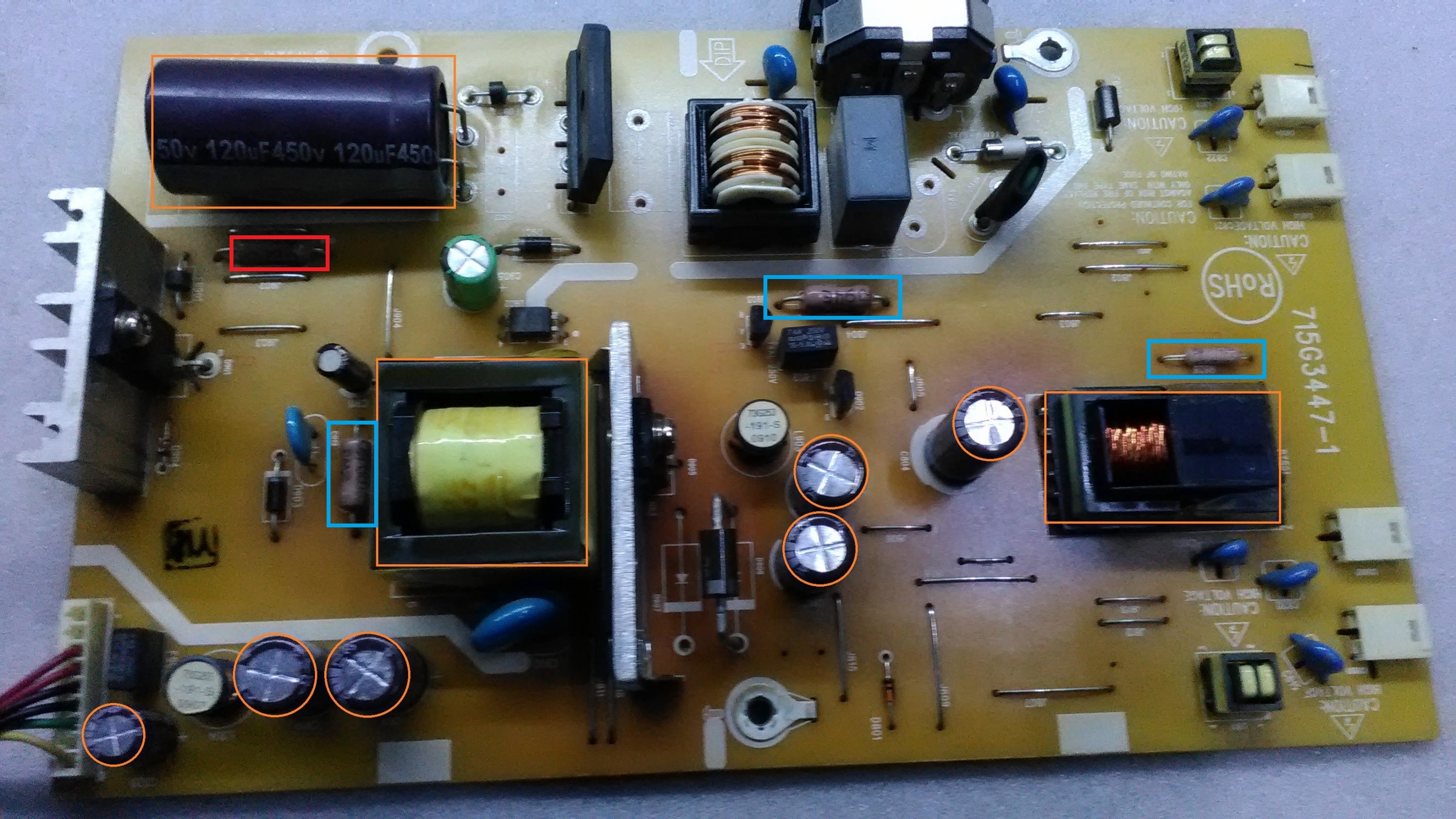

      I guess those are the pink ones,right?
      What values should I get?
      Edit: Oh I see, the values are on the bottom so it cant be read. I will unsolder it in 30mins or so.
      • Morsus
        • Nov 2016
        • 96
        • Serbia
        Re: LG Flatron W2243S-PF two seconds to death
        Okay so I took one pin of each pink resistor out and measured. The ones that I marked blue are perfect, values marked on them are exactly ones I got on my multimeter. The one I marked red I'm not sure since my multimeter can't measure that low resistance. The resistor says "0.39 ohm 2WJ 93U" and a little logo that looks like "HJ".
        Until I get a way to test this resistor (lets say its fine for now) what should I check for next?

          Use a known higher rated resistor in series with the low rated resistor you're testing, subtract the higher resistor from the total to get the smaller resistors approx value.

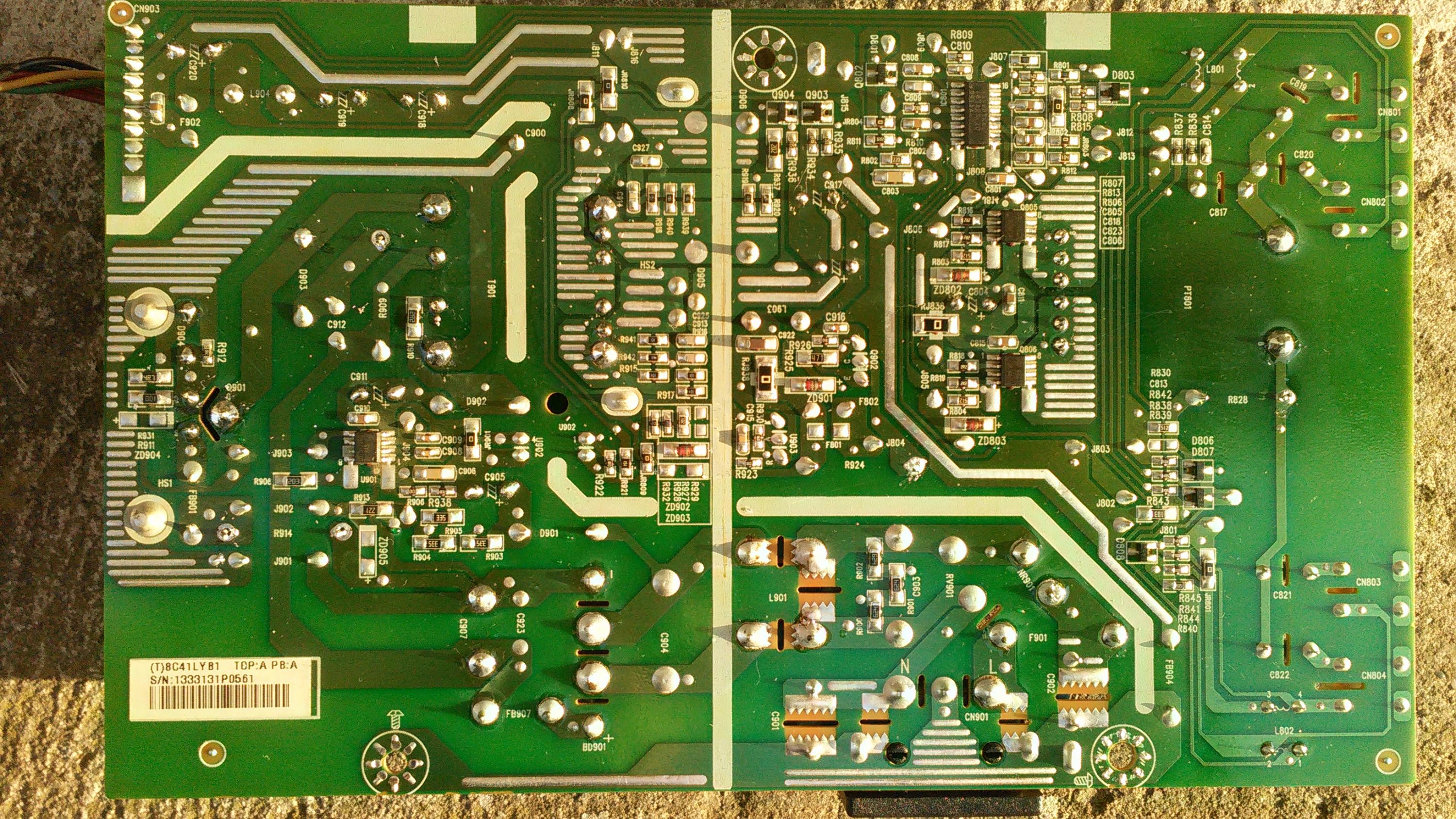

            Likely you will have the feedback circuit at the other side, take a photo of the traces.

              This is the best I can do today :/
              • Morsus
                • Nov 2016
                • 96
                • Serbia
                Okay here it is in better quality. Sorry for double posting.
                The bad looking solders (or no solders at all) are just because of the testing components process witch is not over.

                    Test the two mosfets, Q805 Q806.
                    • Morsus
                      • Nov 2016
                      • 96
                      • Serbia
                      I tested the mosfets. Seemed like Q806 was shortened so I replaced it. Sadly the monitor game me the same result. :/
