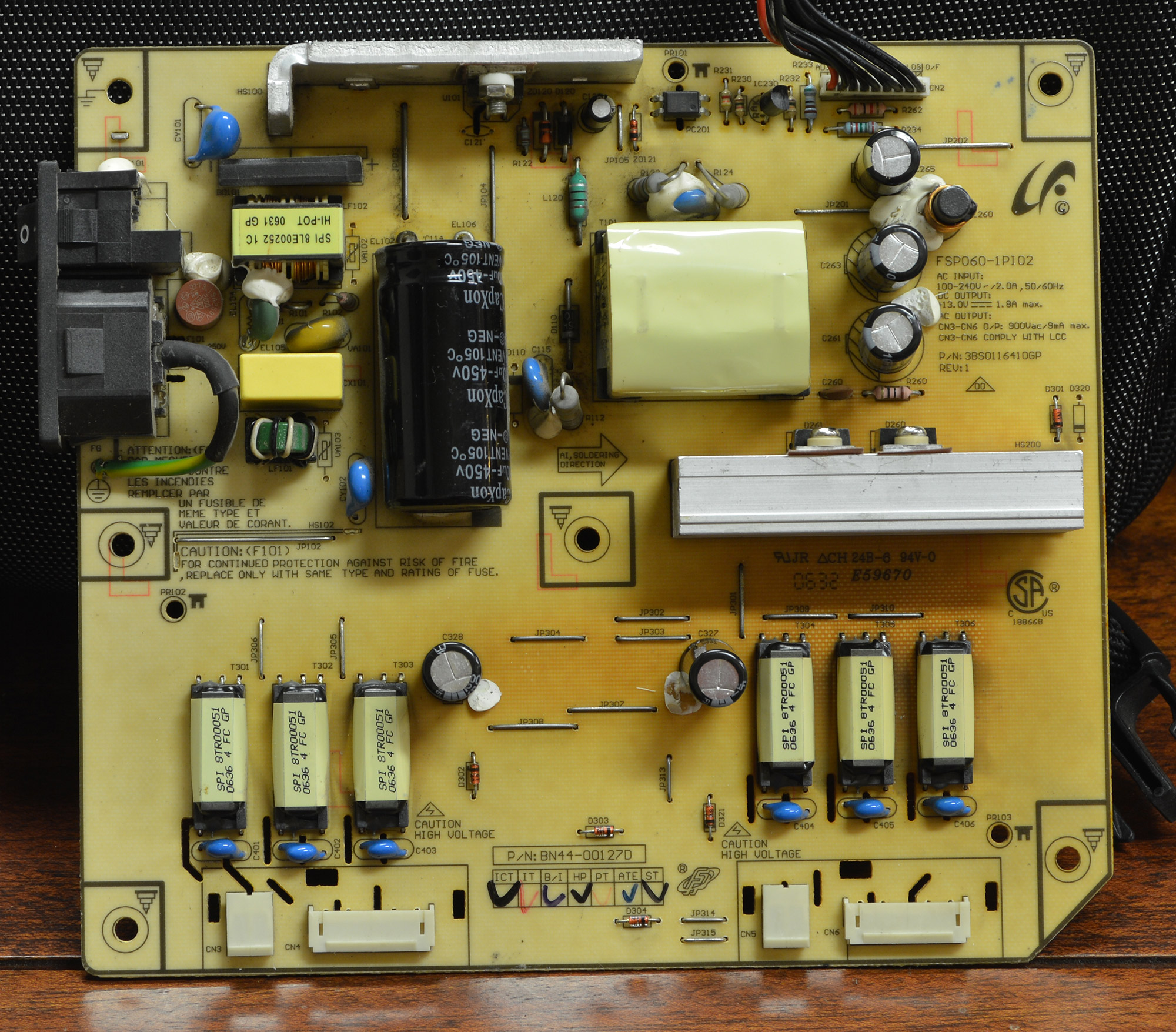

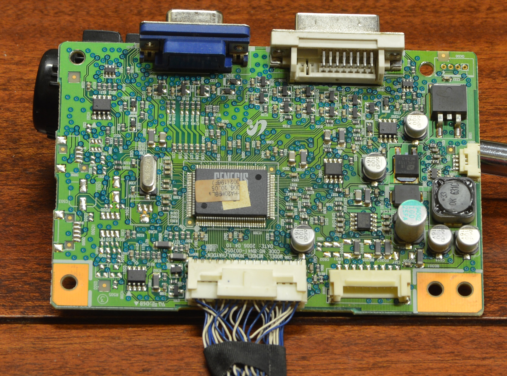

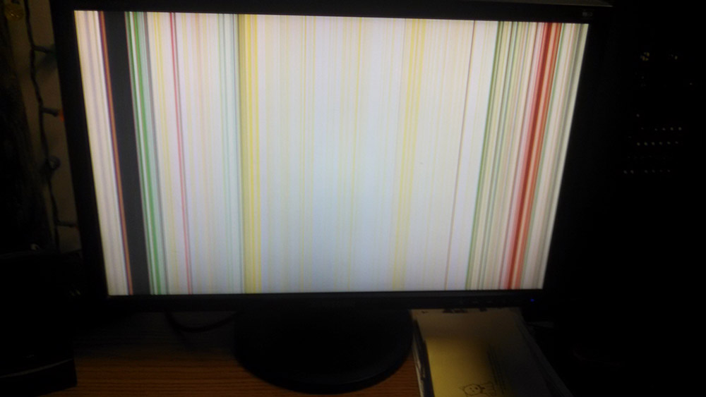

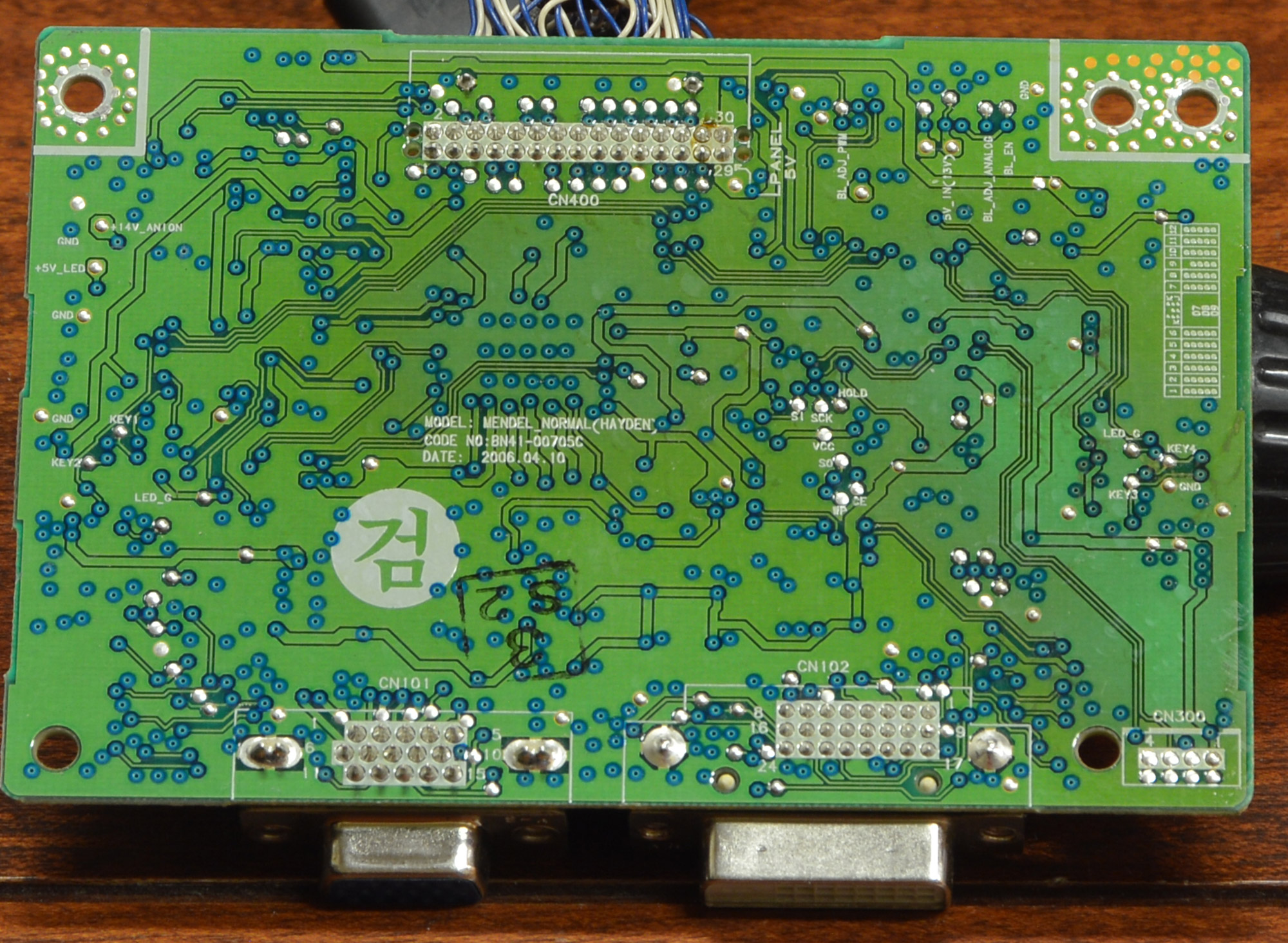

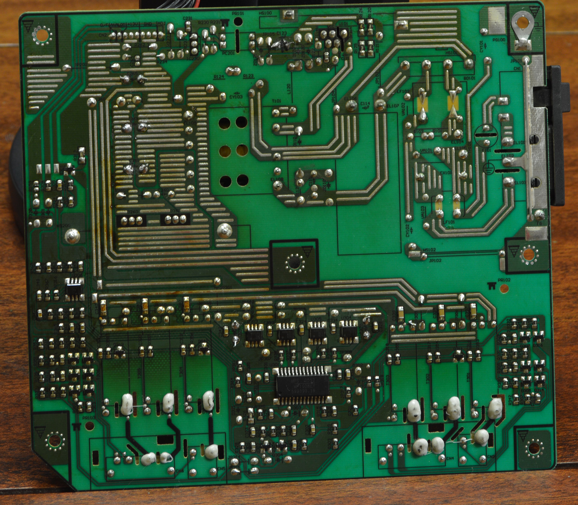

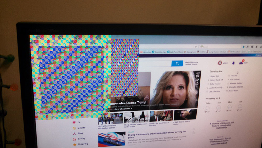

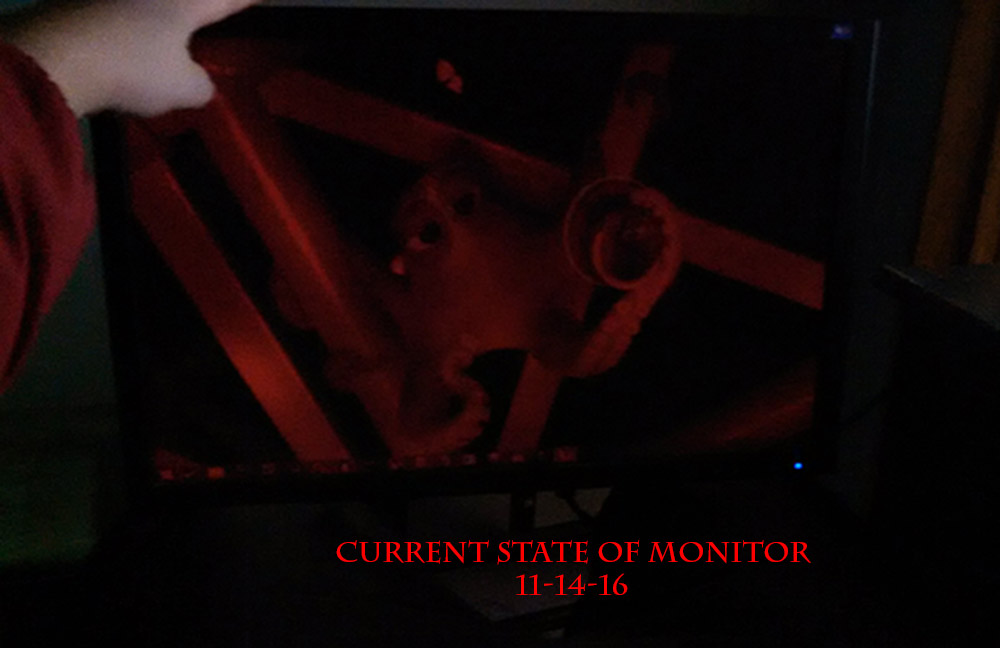

    Hello, I replaced all of the caps and the monitor worked perfect for about a week.
    I made a post earlier regarding a cap replacement here --> https://www.badcaps.net/forum/showthread.php?t=57249
    Then it started having unusual display issues. It would show random colors or suddenly fade into a white screen and when unplugged and plugged back in, it would reset it and go back to normal. However, now the screen is showing as really dark with a red tint to it and unplugging it to "reset" it does not work. Please see photos attached. I have also posted pictures of both the power and video boards.
    Can anyone please share your knowledge and help me troubleshoot this? Thanks!

    Re: Samsung Syncmaster 205bw
    Normally bad caps on the Psu can damage mainboard caps, have you checked the mainboard caps with an esr meter ?

      No I don't have an esr meter. Is there a cheap one you could recommend? Also, I've never replaced anything surface mounted so that will be another learning curve. I hope I'm not in way over my head.

        I can recommend You cheap LCR meter based on ATMega 328 - You can buy it on Aliexpress for about 4-10 US $
