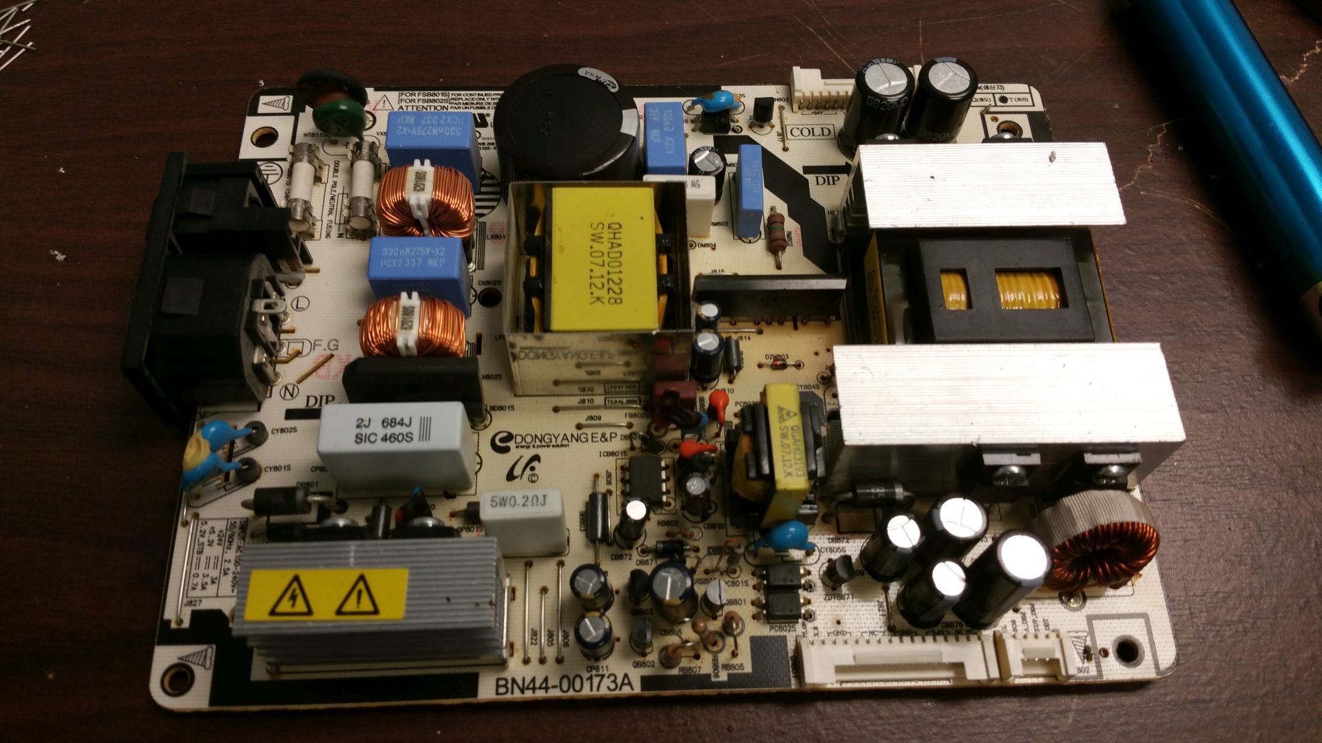

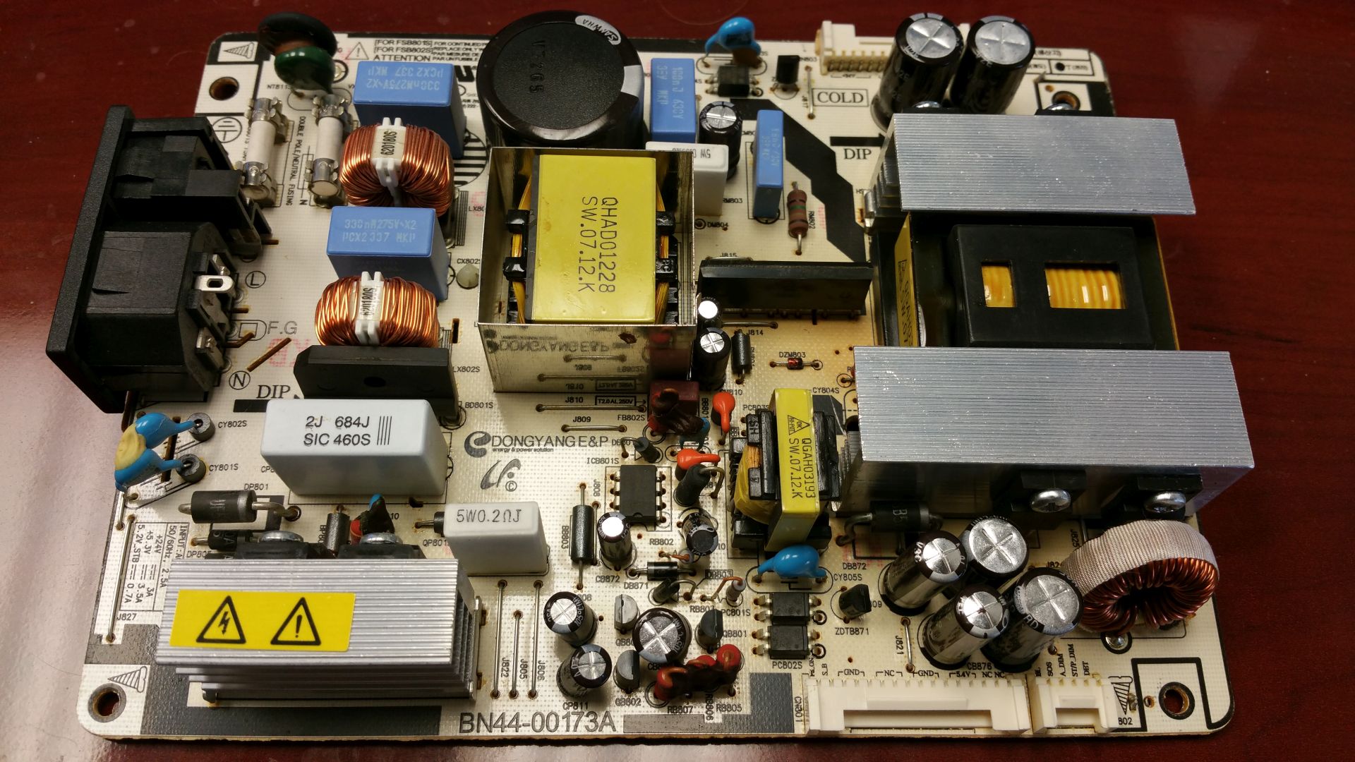

    No question here, just came to give a great big THANKS to all you guys who help out on this forum!
    I found this forum earlier this week when looking for solutions to my problem with my SyncMaster 245BW. A lot of people were having the screen flicker/blank screen problem, but not many people were having the same issue as I was (no power at all, not even the blue LED). Then I came across this thread by Ober, describing the EXACT issue I was having - all the way down to the exact same two capacitors being slightly swollen (CB879 and CB809). I followed along with all the testing that was done in the thread and was convinced that what worked for him would work for me.
    Having very little soldering experience, I did some research here and on YouTube and practiced on some junk boards until I was confident I could handle a cap replacement. I took the advice of many of the veterans and replaced ALL the caps on my power supply rather than just the two I figured were the issue. I also replaced the three resistors that everyone seems to have issues with (RB805, RB806, and RB807). I just finished a little while ago and I'm happy to say that my monitor is working perfectly!
    So THANKS AGAIN!! Particularly to retiredcaps, selldoor, Rtech, budm, and momaka, without whose advice I might not have been able to salvage this monitor. And thanks to all you other guys and gals who volunteer your time to help out people like me!

    Gratuitous before and after photos...
