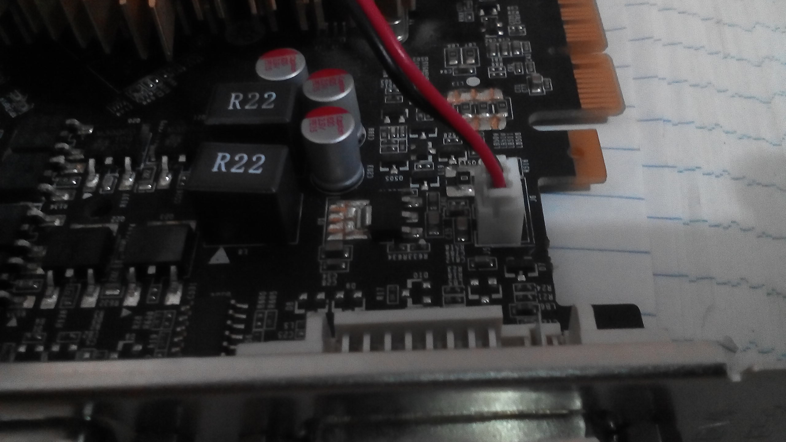

    Guys,
    How can I fix fan issue on Winfast GTS450 ?
    Looks like it's going to spin but stop...
    any fail buck here ?

      • 31247
      Re: Winfast GTS450 fan issue ?
      if you flick it with your finger - does it spin?
        No it's not....I checked the voltage on fan port, it's 11.71V and I've tested the fan with independent supply, it's spinning very well...
        What happened here ?
        Any regulator or diode fail on my VGA board ?? I saw 1 AMS1117 adj which is regulator, close to the fan port...is it the faulty one ?
          sounds like it's going to spin, I can hear it...but not spinning ?
          not enough current ?
          Here's the photo :
            The fan speed is controlled by the video card (usually automaticaly), try using a utility like EVGA Precision or MSI Afterburner to change the speed. If you google "gts450 fan control" you will see some suggestions
              so it will not run on POST ?
              can it be controlled in linux ?
                Why worrying yourself too much ? , take the fan voltage directly from the power supply , or any Fan2 , Fan3 ...etc , on board ..In most cases , it's safer to keep the Fan always working .
