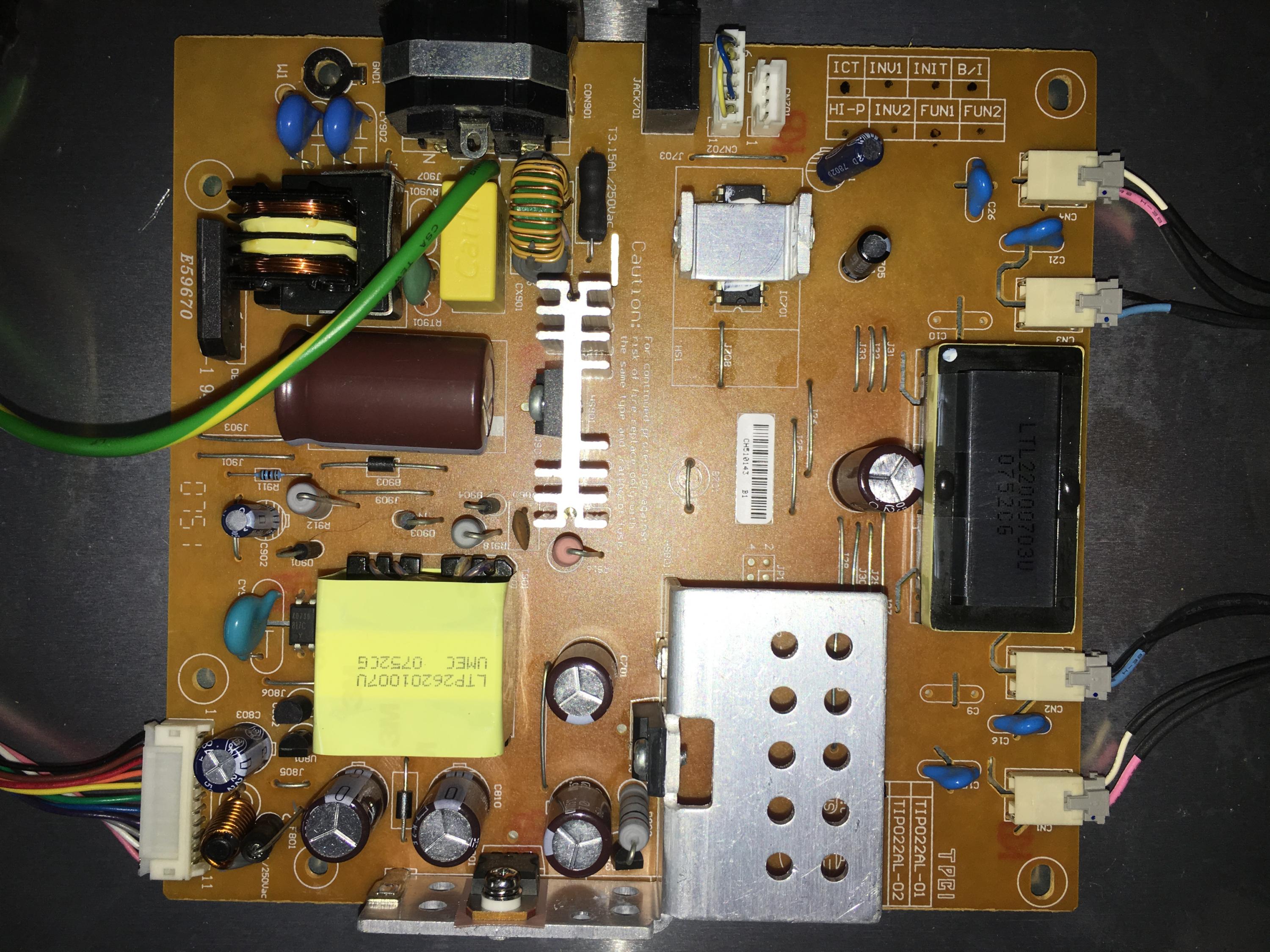

      For now, I'm guessing the action's going to be on this board:

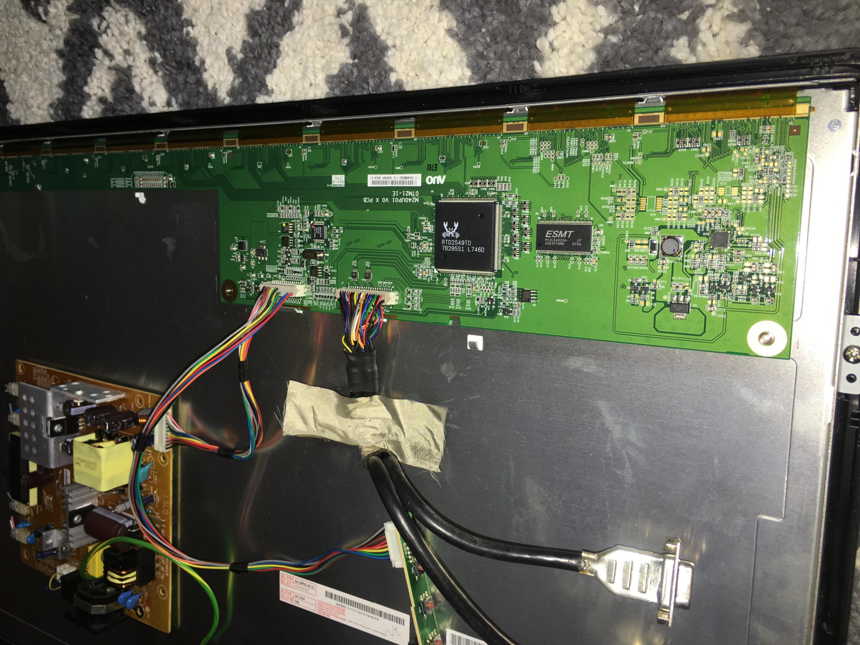

      The only other for-real board is this:

        It may be the lamp problem, inverter problem , or power supply problem.
        I would monitor the DCV between the two legs of that filter cap sitting next to the inverter transformer LTL22000703 to see if it fluctuating a lot or not.
        You can also try heating the caps in the secondary side of the power supply section (bottom left corner of the board) with hair dryer before applying the AC power to the unit to see if it will stay on longer.

            The capacitors may be on the edge of failing, as the lamps start up they may no be puliing full current from the power supply until they are stabilized, but then the cap may not be able to supply full current demand due to high ESR. When cap is heated up the ESR will go down. So you should monitor the DCV on that filter cap by the inverter transformer to see what happens to the dcv when the circuit starts failing after a few minutes.
            And if you put your ears close to top edge and the bottom edge of the LCD panel, do you hear any sizzling sound or smell Ozone.
            The board has no sign of heat damage, the only thing that get hot fast in a few minutes are the lamps.
            But I take it that you already did the good visual inspection of the board for bad connections.

              I soldered a twin-pair onto those cap leads (the one nearest the dark inverter-xfmr you called out on the right midriff of the image, it's 35V/470uF) and monitored as I think you suggested, Bud.
              I had 23V right off, dropping to 17.75V after a few seconds, where it held while the image looked more or less normal (perhaps a bit dim, but livable). About two minutes in, when the CCFLs began going black (three seconds black, then a flash of normal illumination, repeating), I noted that the cap voltage was back to the original 23V for each three seconds of blackness, then would drop for each flash of normal picture (hard to say to what voltage it drops, since it's a DVM and the drop/flash is very brief, that is, well under a second).

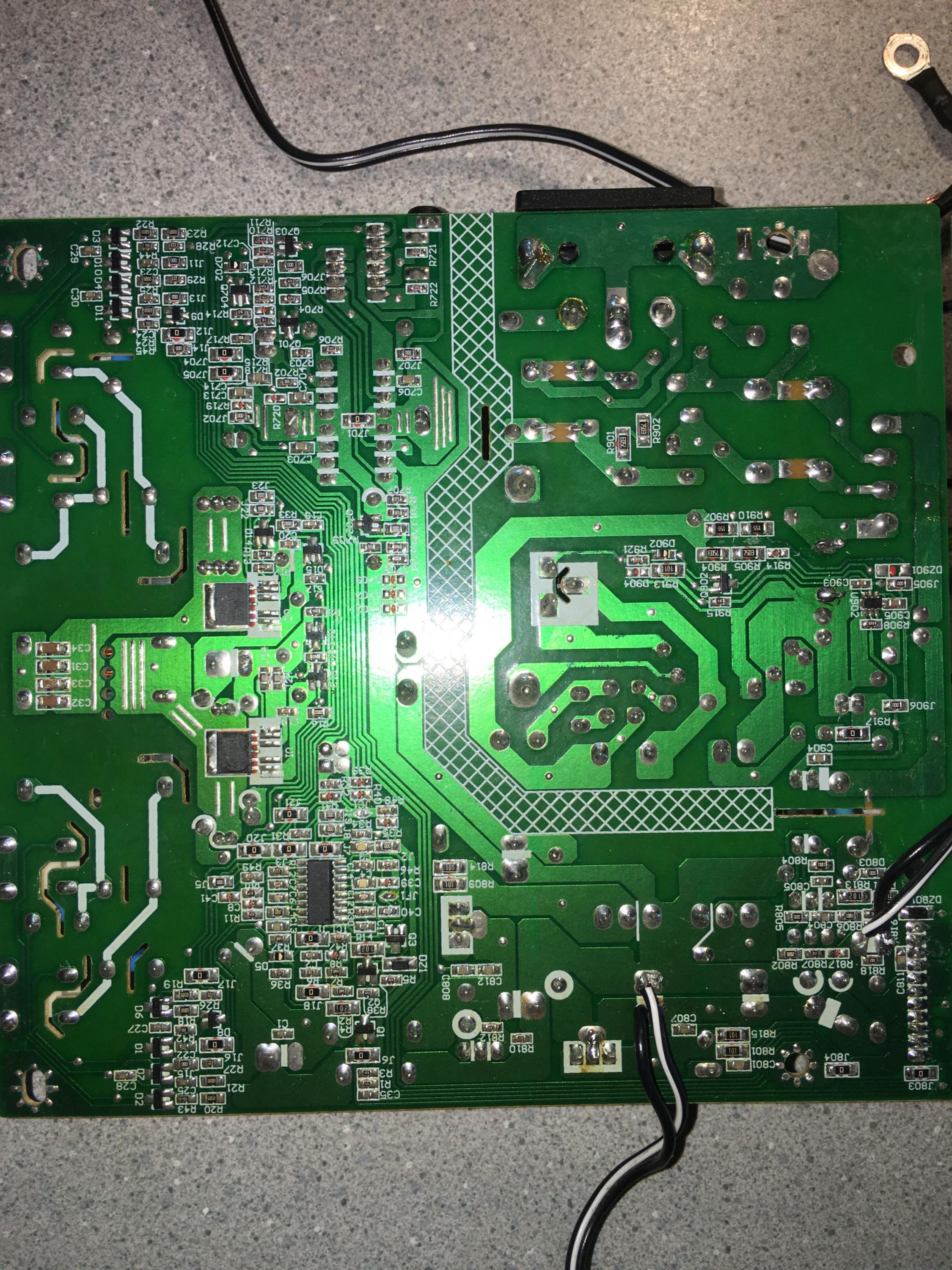

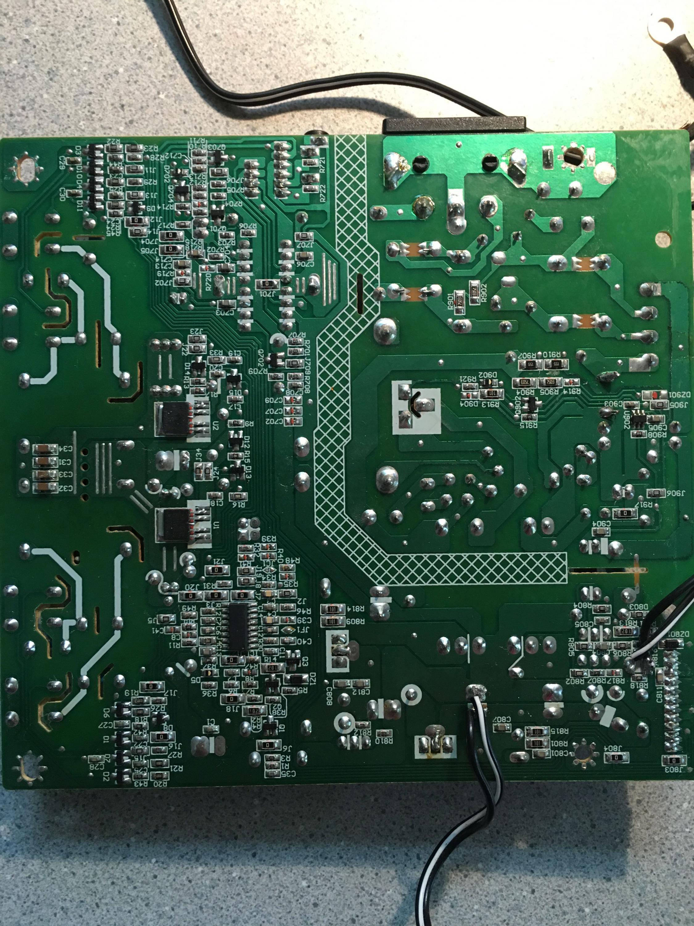

                                Images of the bottom of the Psu ?
                                  Re: two MINUTES on, then off-on, then black...
                                  Sure, hope this helps...shots with and without flash. Orientation is same as component-side PCB shot posted originally.
                                  Cheers - Dave
