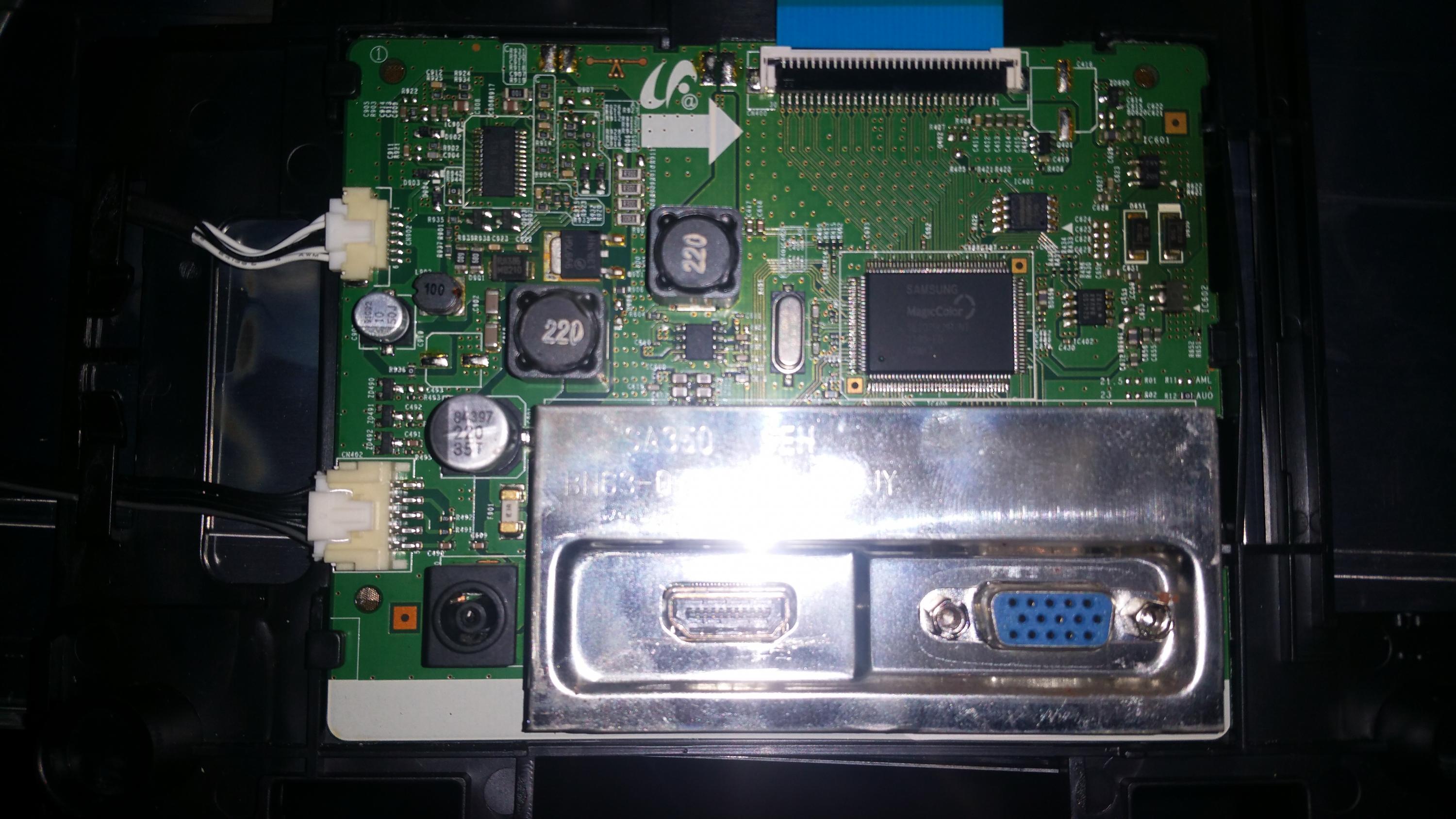

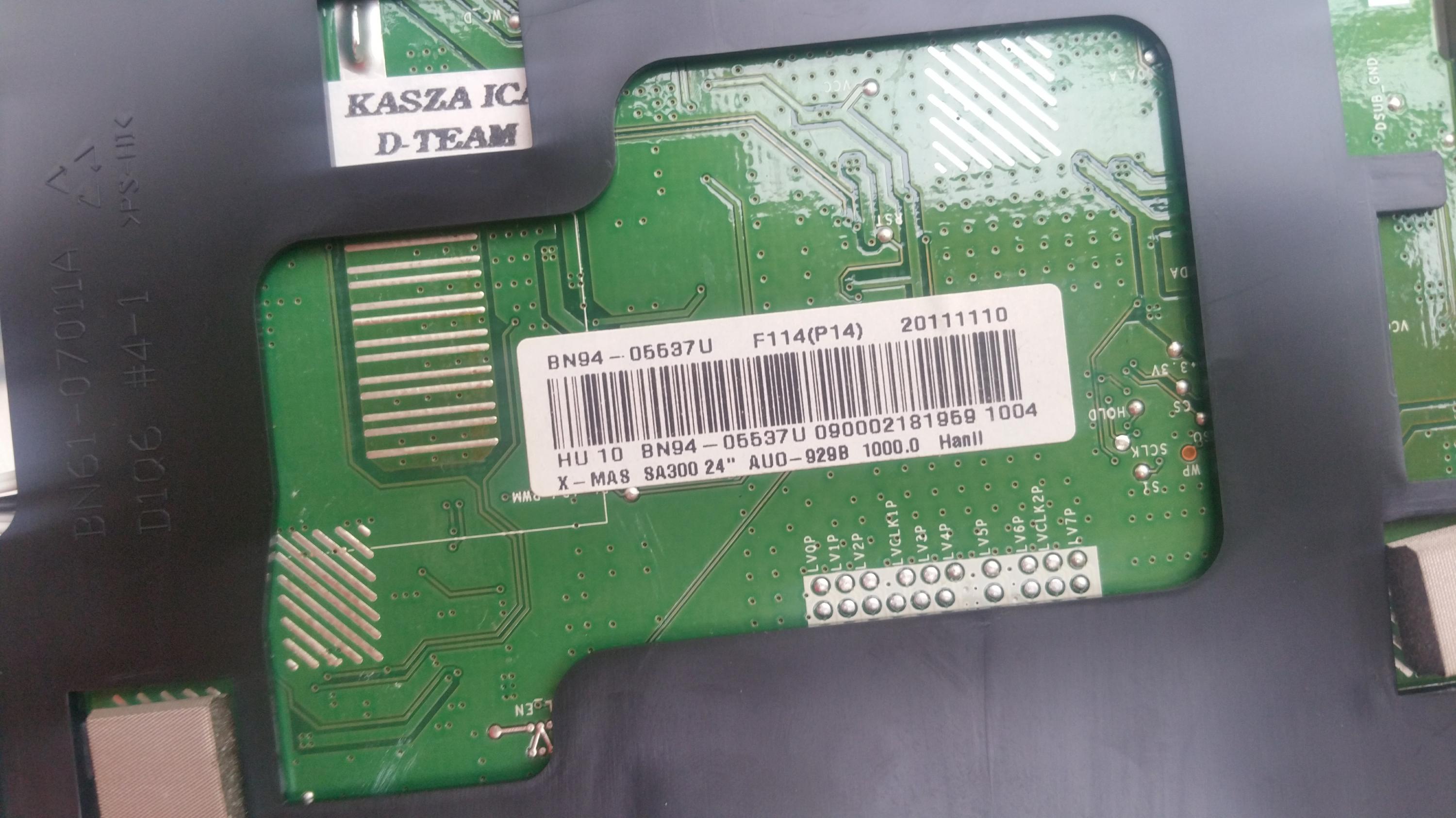

    I have a samsung LS24A300H led monitor about 3 years old only a year out of warranty and the mainboard has died and i can't seem to find one anywhere the part number i require is BN94-06637U does anyone know where i might find one as they are proving to be like rocking horse shit at the moment.

    You may have a bad fuse F901 if you have an ESR meter you can check caps

      Re: Samsung LS24A300H LED Monitor
      How did you determine the main board is bad? Did you check any of the voltage rails?
      I see several inductors. Those are probably for buck regulators. See what voltages you get. Also, what are the symptoms of the monitor?
