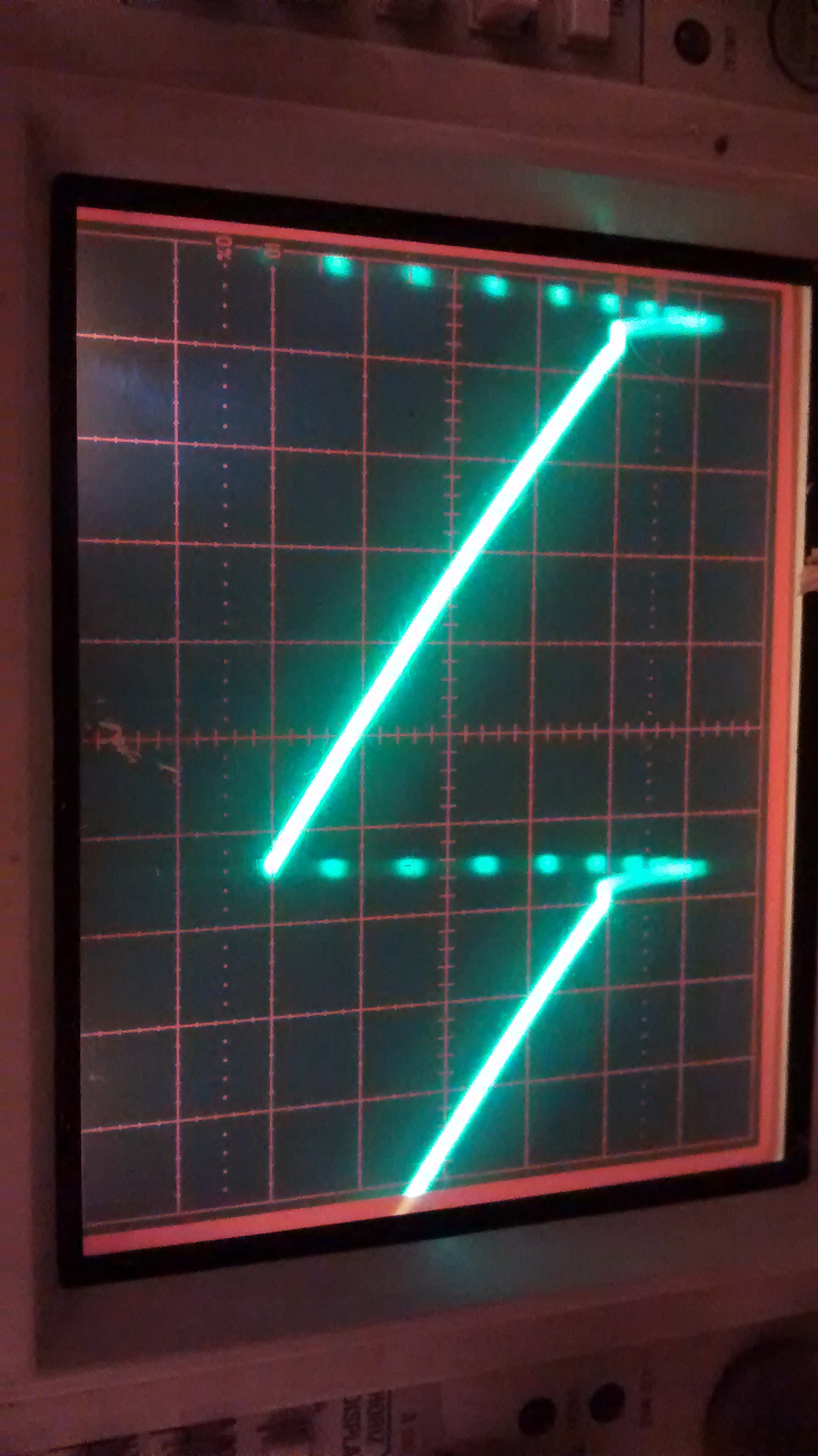

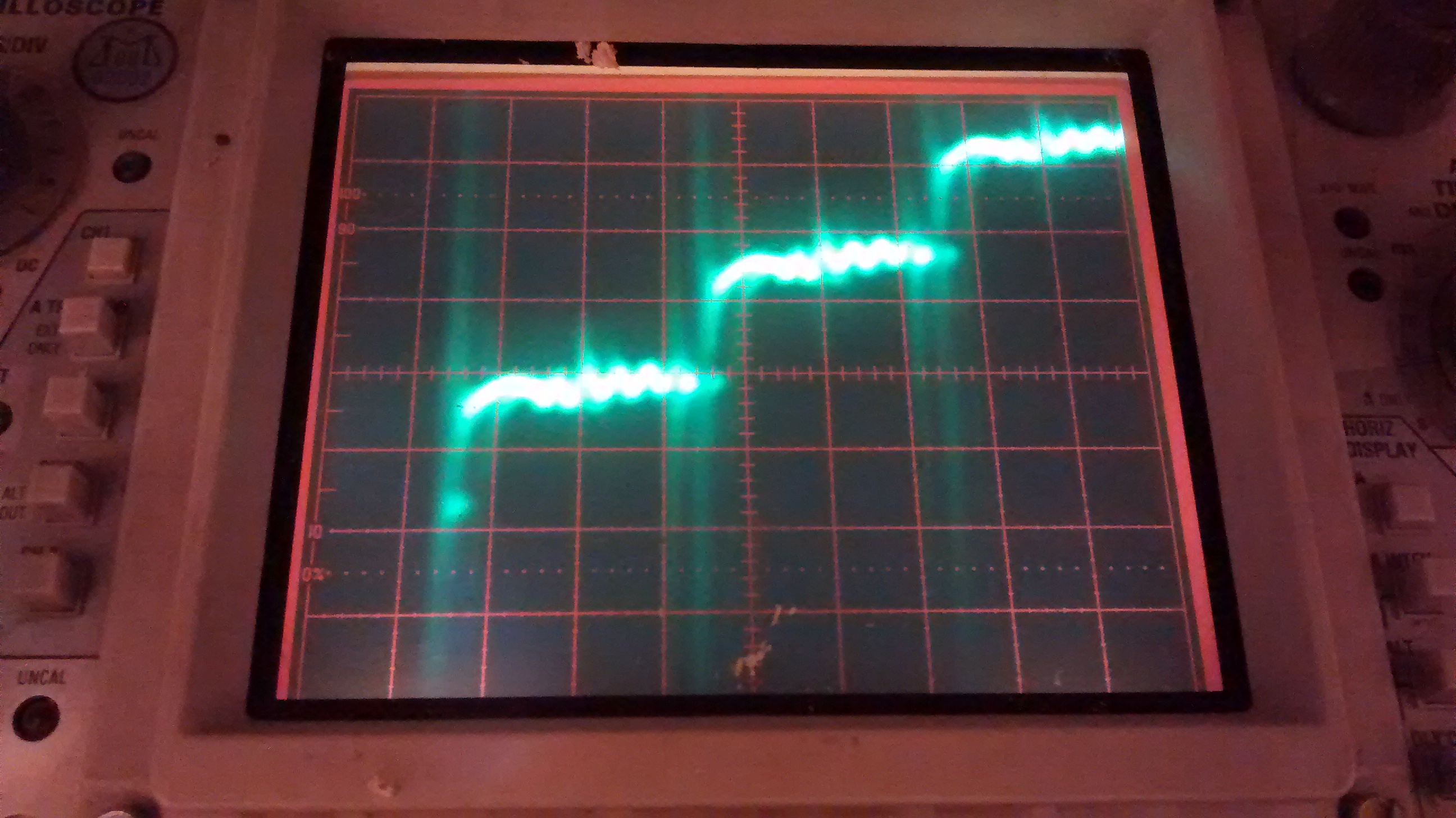

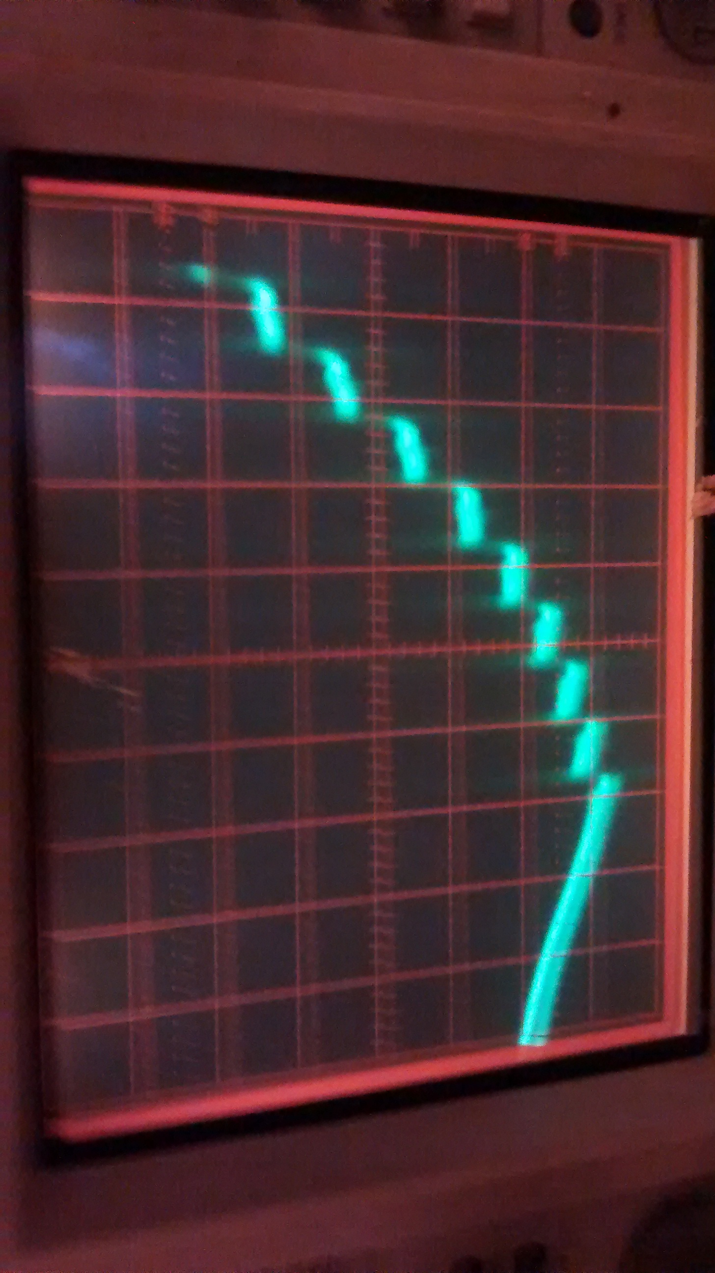

              With the main board on (KEY1 to 3.3V), I get 50mV of ripple on the 5Vdc line. The other lines seem okay.
              On photo 1, there's the voltage line
              On photo 2, the small peak at the highest ripple amplitude is zoomed at 20us/div
              Photo 3 reveals the ~10 MHz harmonic content, provably caused by the digital circuitry.

                Have you found a solution to the problem ? I am not sure the PS is at fault here.
                Can you insert 5V from another source (like a bench power supply) into the main board, (monitor''s PS disconnected) and check again the voltage at the local regulators, memory IC's and if the 5V DC is present at the LVDS (CN400 )cable, pins 1 and 7 ?
