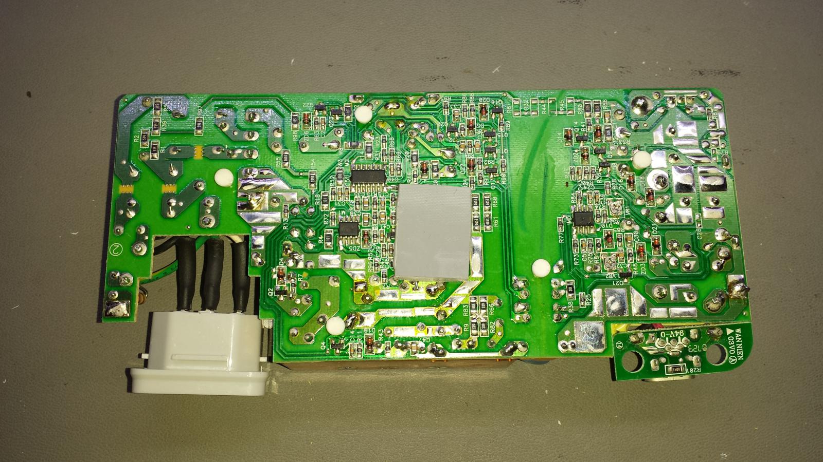

    Got this faulty Apple Cinema display 23" power supply for a few bucks and can't seem to find the main problem with it; hell, am still in the learning phase!
    It's a SMPS with 100-240v, 50/60Hz input and 24,5v 6,1A (150w) output.
    I found a shorted mosfet on the secundary site, the PSMN015.
    Nothing else seems out of the ordinary by look and smell.
    What I've done so far:
    - Changed the shorted mosfet for a similar one --> no change.
    - Checked the main fuse --> still good.
    - Checked the main rectifier --> still good.
    - Checked the voltage on the main filter cap --> 320v.
    - Desoldered and checked the two 11N60C3 mosfets on the primary site for shorts --> still good.
    - Checked the voltage on the primary transformer pins --> 320v on 3/5 pins.
    - Checked all the primary diodes --> still good.
    - Checked the two optocouplers --> still good.
    - Desoldered and checked all electrolytics for capacitance and ESR --> still good.
    - Changed two small startup electrolytics --> no change in Vcc voltage to the TEA1552t IC.
    The primary has two mosfet driver IC's, the 14 pin TEA1552t and the 8 pin L6561D.
    The secundary only has the 8 pin N4300 op-amp / voltage regulator.

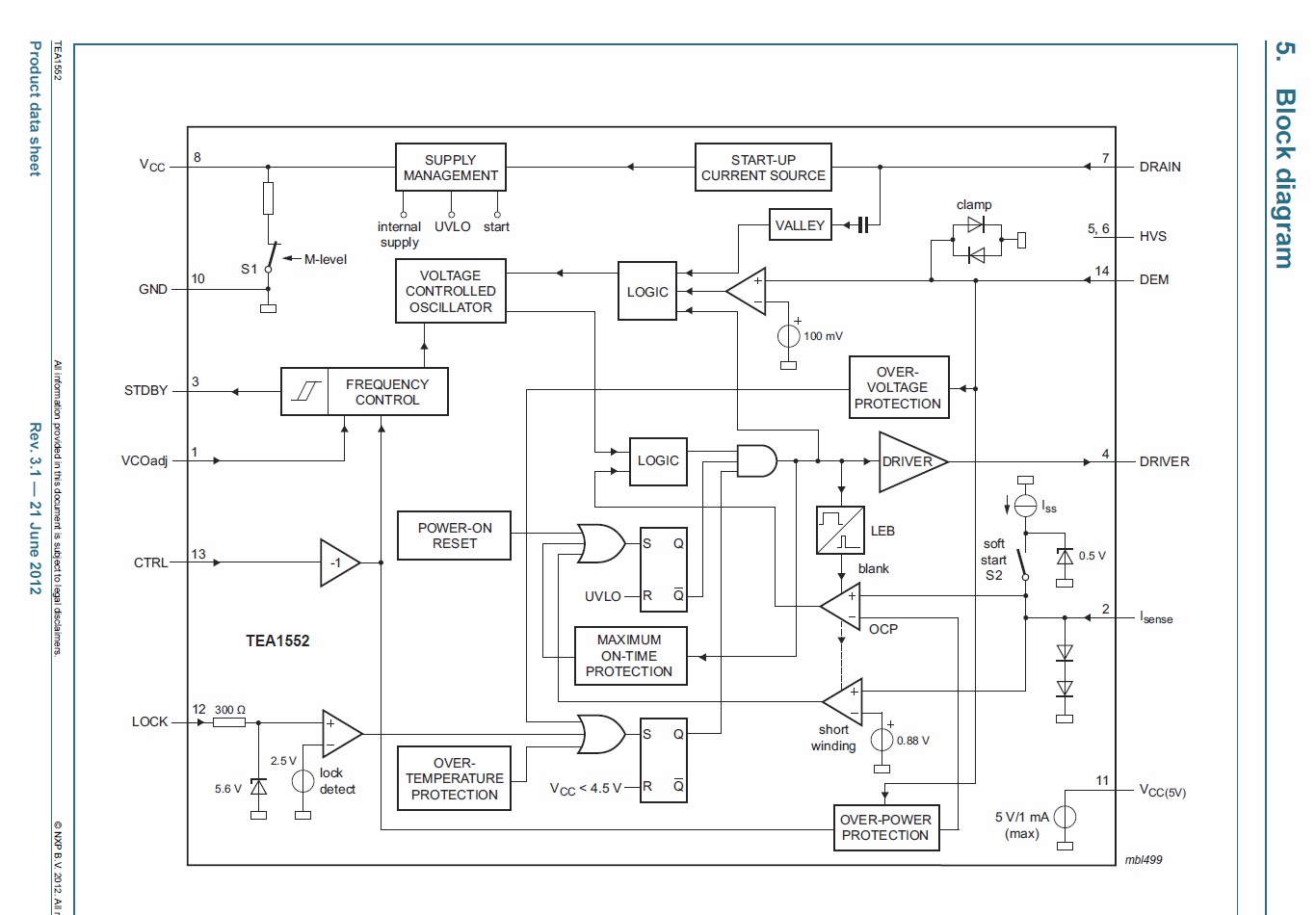

    The TEA1552t has 7.5v on the Vcc pin 8 (too low, has to be at least 11v), 320v on the DRAIN pin 7 and a very fluctuating 0-5v on 5v Vcc output pin 11 (obviously hangs in some kind of startup loop).
    The L6561D has no voltages present on any of the pins.
    The N4300 op-amp / voltage regulator also has no voltages present on any of the pins, because the whole secundary circuit is not getting any voltage.
    My suspicion is that the TEA1552t IC is malfunctioning, hence the low Vcc input of 7.5v. As I understand from the datasheet, especially the block diagram and the text just beneath it, the IC is self sustaining and draws his Vcc from the mains on the DRAIN pin 7; this voltage is internally lowered to the correct voltage by the means of an internal cap (just suspect this, don't know for sure). I'm awaiting a new IC I've ordered to replace it.
    I can't understand why only the mosfet on the secundary site has shorted out and not the mosfets on the primary site; I would guess these guys will catch the first blows, or am I wrong?
    If anyone have any more ideas / suggestions what to check, I'll be happy to hear.
    If better pictures are needed, I'll be happy to post them!

                        I think that is a bit too low. Datasheet says VCC needs to be 11V (typical). Anything below 9.3V could trigger an undervoltage (UVO) lockout.
                        There is likely still a problem elsewhere in the PSU. But still, I would say try what I mentioned in post #4 - insert about 12V on pin 8 (VCC) with external ungrounded power adapter. And have a series incandescent light bulb with PSU mains, in case it tries to do something funny (i.e. if something shorts out).

                          I tried to inject a 11.5v voltage to that pin 8 but I think it blew the IC because now I don't get even the 7.5v anymore, just a few milliVolts. But as I mentioned before, I suspect the Drain pin 7 Mains voltage is feeding the Vcc pin its needed supply voltage because when I lift that pin 8 and measure the voltage on the board there is none, but now something weird, when I then measure the voltage on that pin there is also no voltage present; only when I reattached that pin to the board the 7.5v has come back so I guess the voltage is coming from the chip itself (see picture, on top).
                          Unfortunately, that schematic is not this PSU, it's a similar of one which also uses the TEA1552 and the L6561 IC's together... Pity, was too good to be true because Apple schematics are very rare or you have to pay lots of $$$ for it.
                          BTW: that bulb trick does work good, I got no short whatsoever, bulb stayed off... tried a 60w and 100w bulb.
                            master hoarder
                            • May 2008
                            • 12175
                            • Bulgaria
                            Re: Apple power supply A1098
                            Yes, the way it works is this:
                            When you plug in the power cord, the main cap charges to ~170 - 380 V DC (depending if the PSU has APFC and/or the main voltage in your country). This voltage is travels through the primary winding on the main transformer and so is present on pin 7, Drain, of the TEA1552 IC. The TEA1552 IC uses this voltage to charge the electrolytic cap attached to pin 8, Vcc. Once the voltage goes above 11 V (typical value), the TEA1552 then uses the power stored in that cap to turn ON the main MOSFET in it very quickly (to minimize turn-ON loss). This makes a current flow through the primary winding of the main transformer, which in turn produces a current flow on the main winding on the secondary side and also the auxiliary winding on the primary side. The current from the auxiliary winding usually gets rectified through a diode and then is used to charge that same cap that the TEA1552 charged through the Drain pin.
                            So in essence, once the power supply begins working, the Vcc for the TEA1552 is self-sustained through the primary side auxiliary winding of the main transformer. If there is a problem, however, the voltage and currents going to pins 2, 12, 13, and 14 (Isense, LOCK, CTRL, and DEM) are used to shut down the TEA1552 IC.
                            So the fact that the power supply is not working with an externally-supplied Vcc voltage suggests there is something else wrong with the power supply.
                            Even if that schematic is not the same as your PSU, see if at least some sections match your PSU somewhat closely. But even without it, the main things to check are if there are any short or open-circuited components on the primary and secondary sides - in particular check that the main output voltage rail of the PSU is not shorted to ground. From there, start checking any diodes and transistors and high-power resistors. If there are any SMD ceramic capacitors (these are small tan-colored rectangular components on the solder-side of the PSU), check them as well. They can go short-circuit for no reason sometimes. If in doubt about a component's condition, remove it and test it outside the PSU. Let me know what you find.
