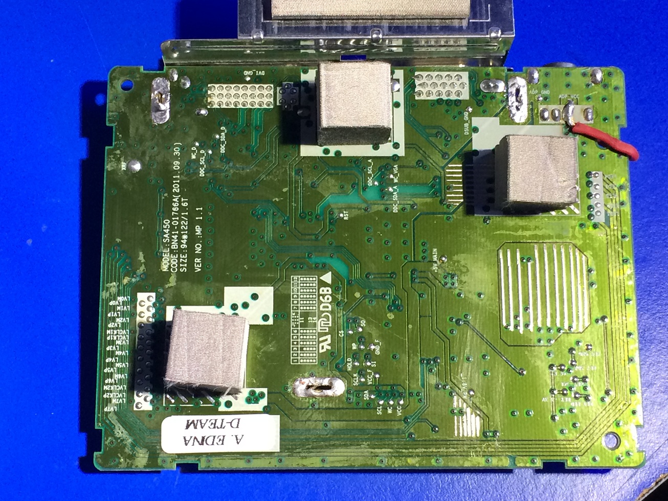

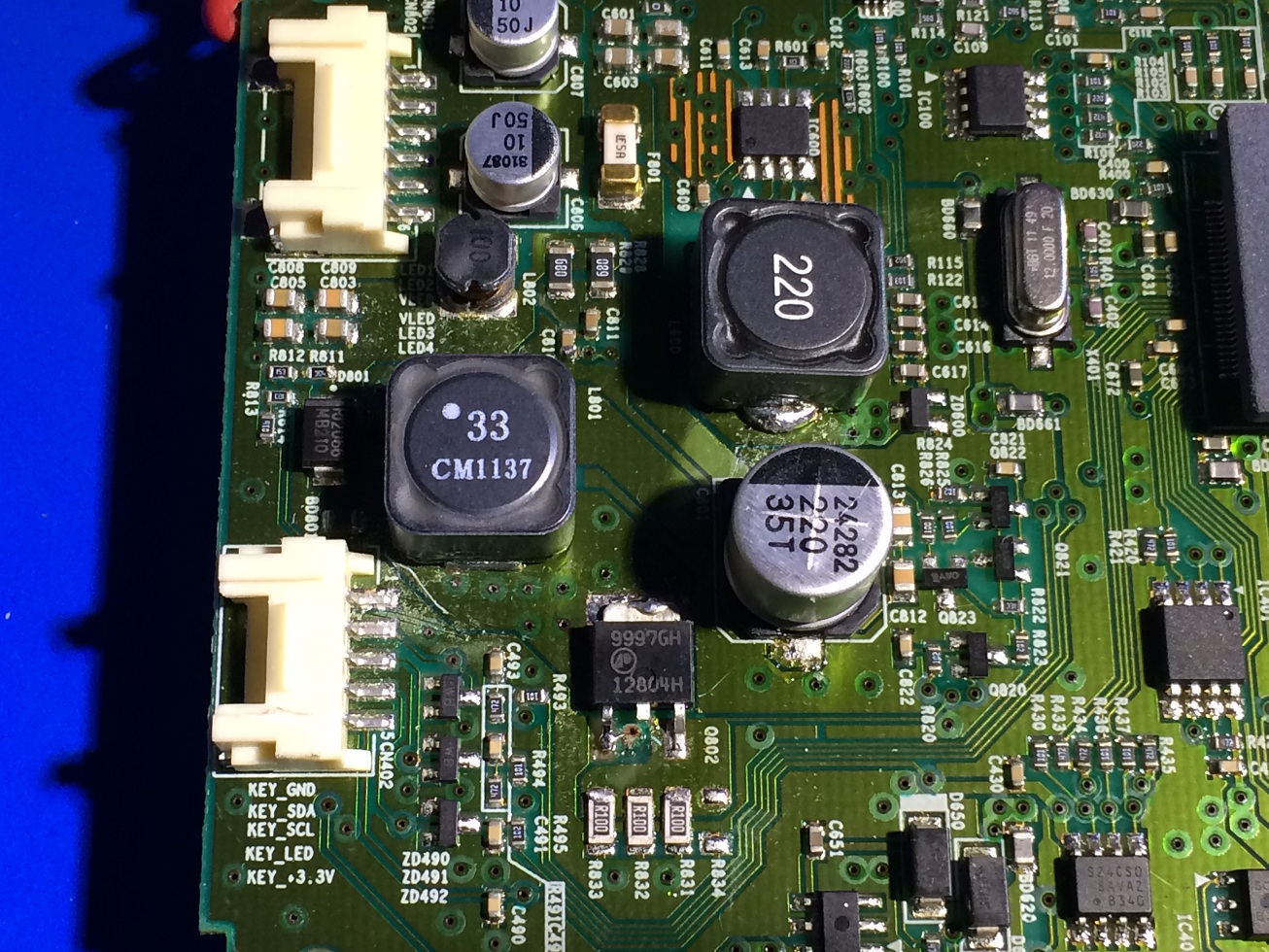

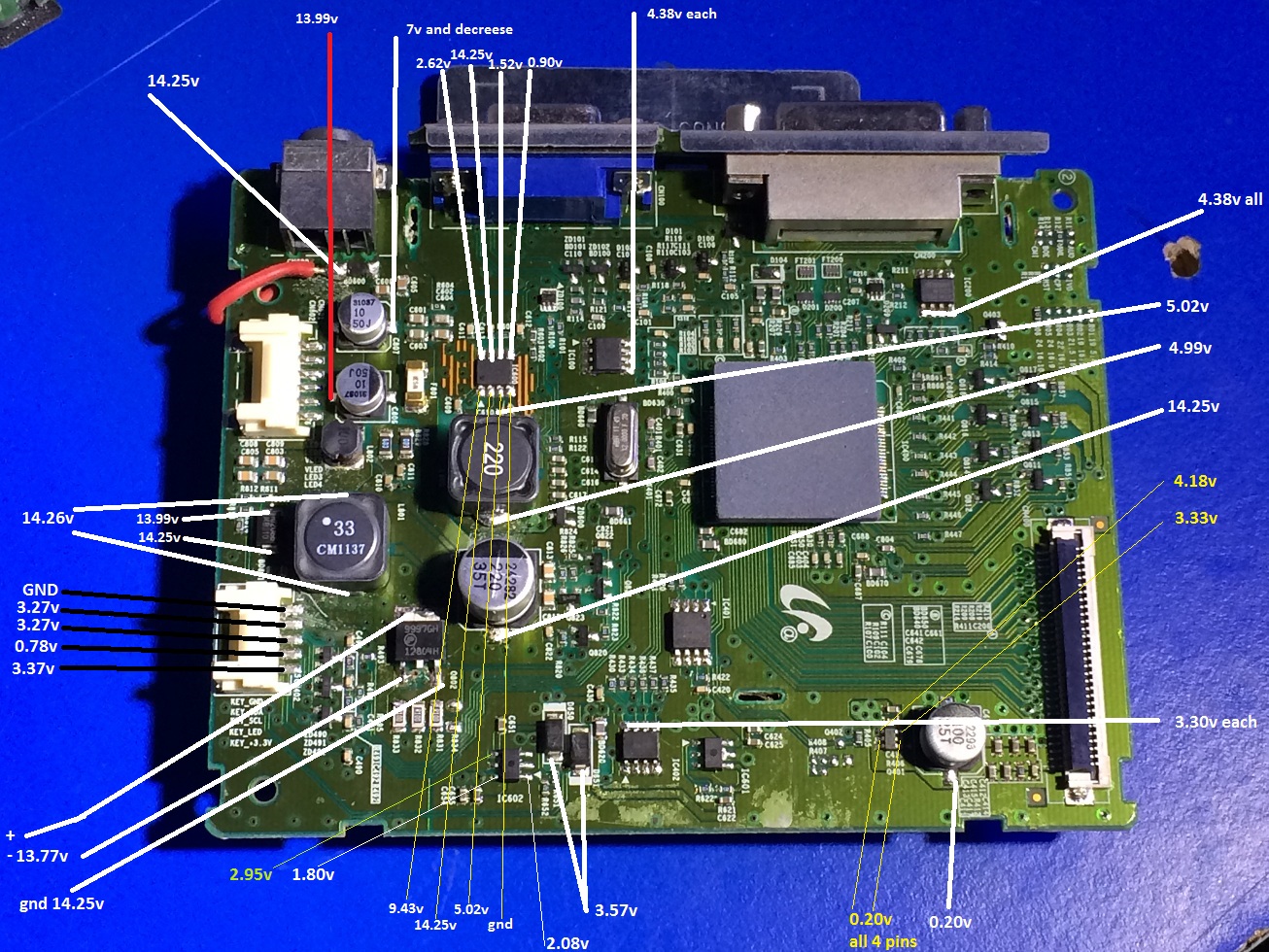

    S24A450BW Samsung Monitor does not work, the LED does not light, no picture, I noticed that they tried to repair. was burned 9997GH, I changed it, its blue LED lit for a second, then no light and change it again 9997GH, but nothing happened.
    - where to find service manual ?
    - may be the problem of re-programmed FLASH MEMORY 25X40BVSIG ?
    Thanks in advance!

    Have you got the correct power supply for it 14v is an odd one?

      I have one original 14v 1.7a, and universal 14v 2a, does not work with any of them.

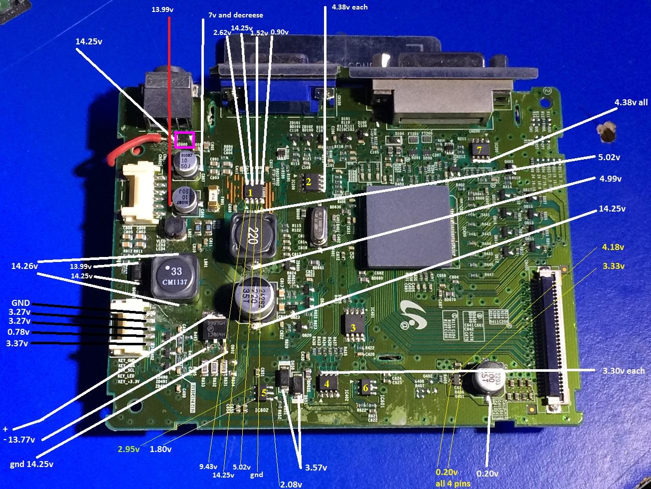

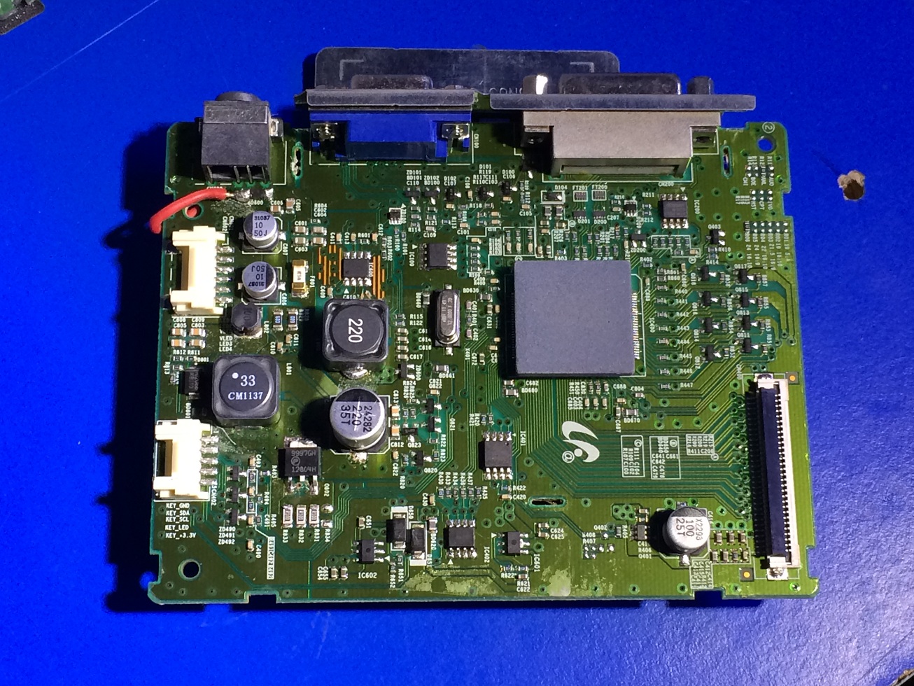

        Is the white fuse ok? What voltage on each side with respect to ground.
        What voltage on the 2 coils (with 100 and 220 on) and what voltage on the 3 caps in PIc2
        What is with the red wire - some sort of repair?

          is just an improvisation, but the board has power, tomorrow make measurements and write on picture all voltages.

            Re: S24A450BW Samsung Monitor does not work ...
            Sort of guessed that but wonder why? Looks like it is connected to the third pin
            on that socket which can only be a few millimeters from where they have soldered the wire to the top of the board.
              hope this help !
                Ok voltage on the top left socket - is that the connector for the led back light?
                In the pink box there should be a ferrite bead - is it still in place?

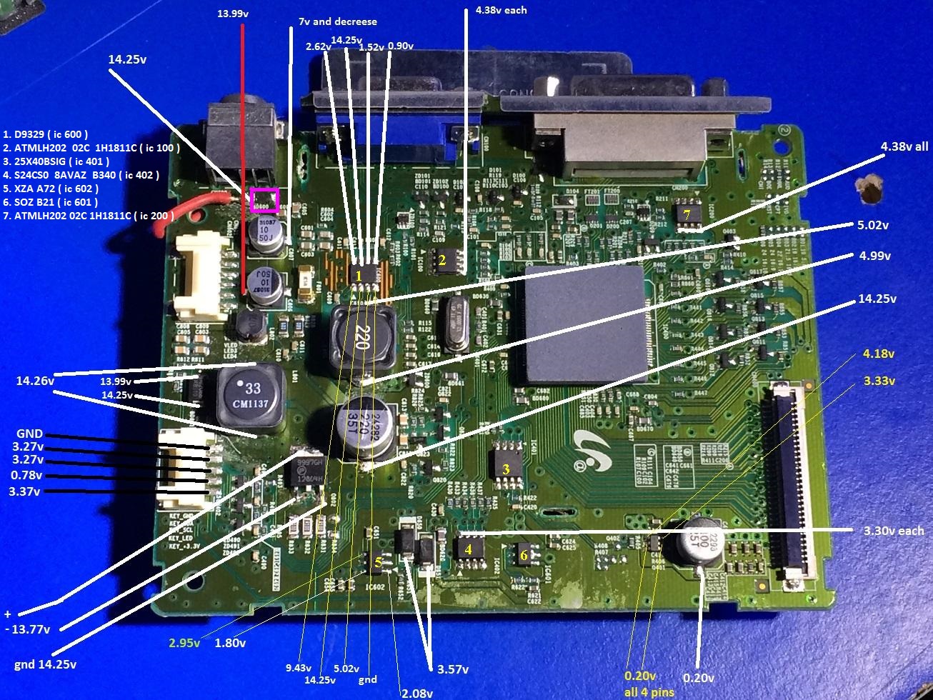

                Can you list some of the part number for the larger ICs - numbered them on pic

                  Hy ,in the pink box is a ferrite bead, is in place.
                  i will edit photo tomorrow with ICs number or model .
                  but i`m sure that 0.20v at one cap in the corner is not good

                    I would agree similarly a cap rated at 50v with 7v falling is not good and if the
                    8 legged ics are mosfets a different voltage on each pin is a worry?

                      i dont know realy , this new models, still working to understand them.
                        list some part number for the larger ICs
