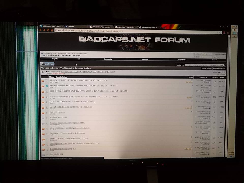

    Acer s273hl bmii
    I bought this monitor off of craglist and the other day I unplugged it to clean water that had spilled on my desk, after I had clean the water, I plug the monitor back in, but it would no longer turn on. I open it up to clean to check what was going on and discovered that it was insanely dirty with cockroach poop (yuck). I clean off the the two boards that are inside the bottom housing, a Button Board and the main board. There was not much on the main, but the button board was gross, but I figured that all this nasty ass fucking poop was causing a short some where and I after I cleaned it all I got power and everything turned on but now my monitor has these lines and a small blackspot.

    Re: Acer s273hl bmii
    Probably need to see pictures of your boards - what did you clean them with should have used isopropyl alcohol. Maybe clean and reseat the lvds cable but the lines may be result of screen damage - sure that no water splashed the front of the screen when on? - it then runs down inside and causes screen damage. Also it looks like one half of the bottom backlight is going dim?
