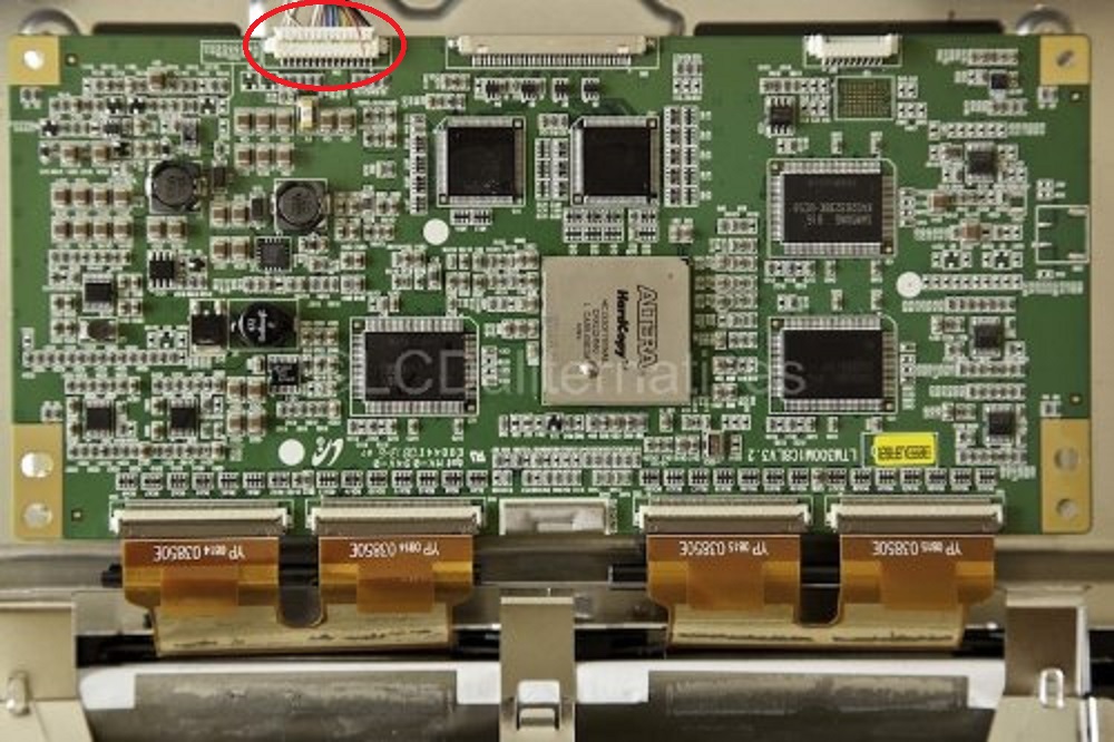

    I've had this monitor couple years. Then suddenly one day, screen just suddenly turned black. Backlight was on, but nothing else. Sometime it came back to life for couple minutes after I computer boot, but always went back to black after awhile.
    I searched for the cause, and found the "oven-guide". Decided to try it, disassembled the monitor, took the tcon board out, wrapped it in folio and cooked for 7 minutes, then put everything back together, and now it's working almost perfectly again.
    While disassembling the monitor, I managed to break the 15-pin data cable connector connecting to tcon board, so while assembling it back together I had to plug some of the wires in "manually". So not sure if everything is connected perfectly there. I tried to search ebay for replacement for that cable, but couldn't find any. What is that cable actually called? Any idea where I can buy a new one?
    Now the monitor starts and works fine, but 1/4 of the leftmost screen is now blueish color. Is this caused by "baking", or could it be faulty connection somewhere?
    Thanks in advance.

    Please post pictures using manage attachments so that they stay with the thread - I have added it EVEN THOUGH IT IS NOT YOUR BOARD.
    If you consider one quarter of the screen is in error and there are four
    ribbon cables at the bottom of the picture. It could be that one of these is just seated incorrectly or may be damaged or the socket may be damaged.
    I would check that out first and post a good clear picture of bothe the
    socket and cable on YOUR machine

      Any info about that 15-pin cable, where can I buy one?

        Is it a solid blue, or does it slightly "flicker"? If it is solid blue, it would rather expect a completely disconnected cable, otherwise your baking operation might not have been fully sucessful. But overall both flicker/solid cases could be badly connected cable or badly connected BGA solder joints.
