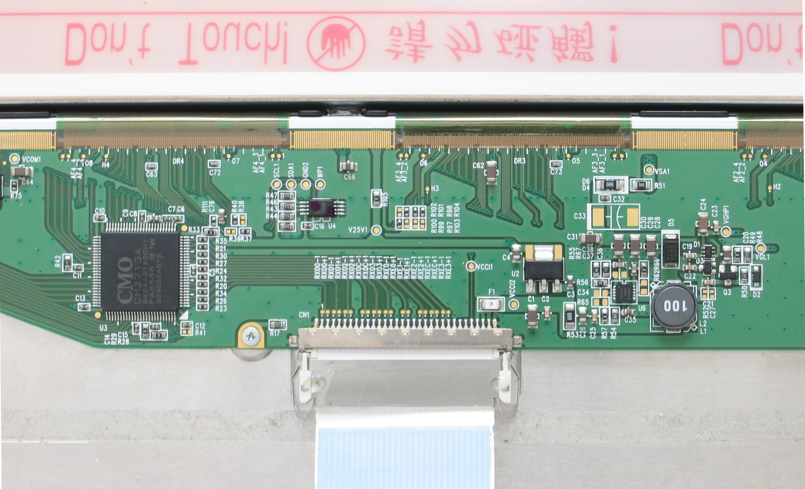

    I wonder if I have accidentally damaged the sensitive panel circuitry during dissassembly/reassembly for the CCFL swapping. I tried to handle the panel very delicately and visual inspection does not reveal cut traces but who knows... The only thing I've done to electronics on purpose is swapping the CCFL inverter, nothing else.

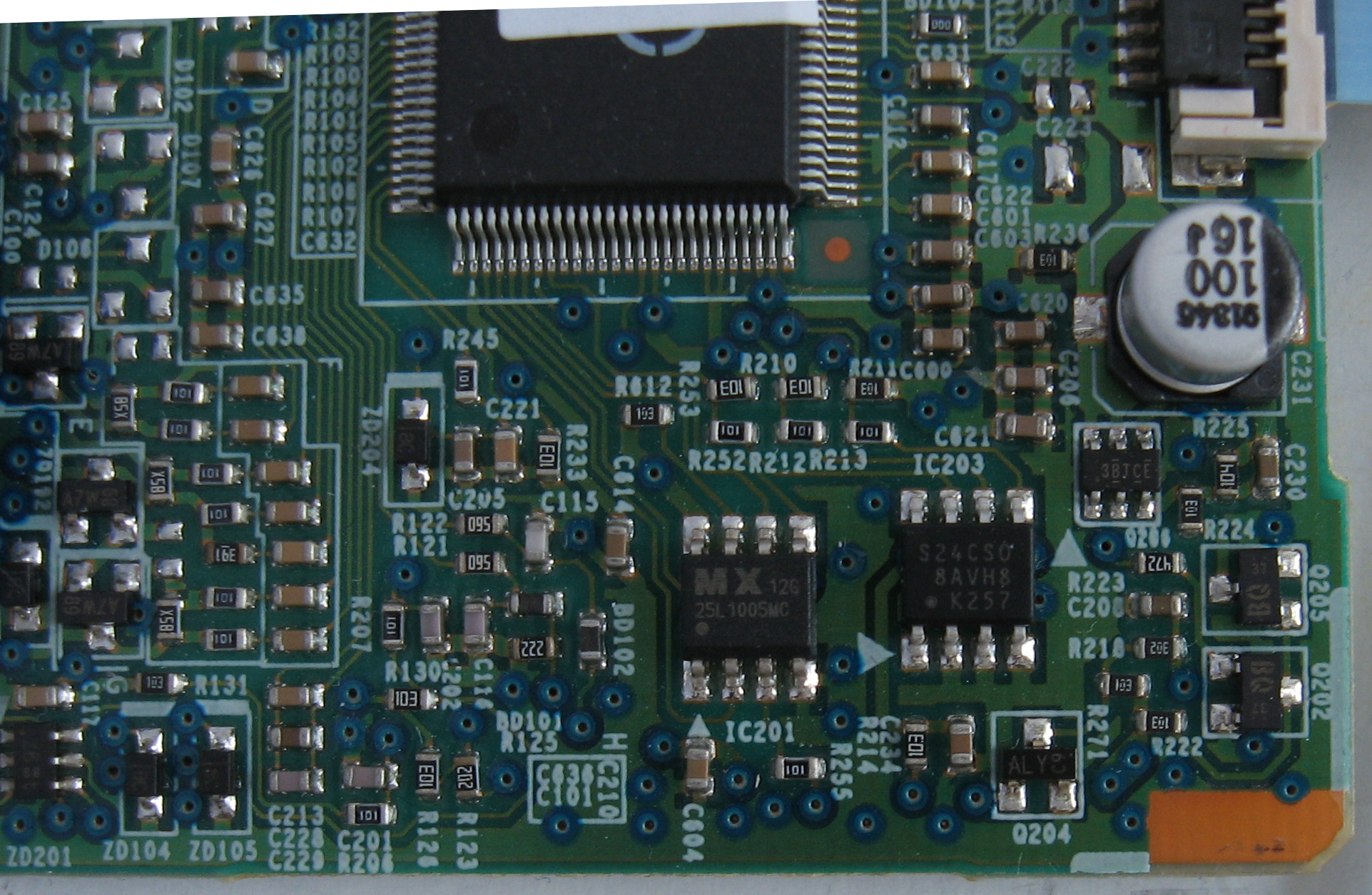

          It is hard to pinpoint the actual location precisely. I rolled a sheet of paper into a "listening cone" and it seemed the sound is coming from somewhere in the area where the flat cable from TCON board connects to the driver board. The 3.3v reg in the driver board was getting unsteady input, so maybe that's it. Using DMM, I then traced that voltage track back to C231 cap in the TCON board and scoped this:
          http://youtu.be/vUMxzhAdye4
          Scope initially on AC setting, HDIV 5ms, VDIV 0.5V. Accelerating oscillation starts around 0:30. In the end I'm switching to DC, and the steady period can be seen to settle around 5 volts. Attached is a pic of the TCON's C231 where, again, this scoping was done. Unfortunately I couldn't find any info about 3BTCE (or 3BJCE?) that apparently outputs to C231, so I didn't trace any further. Not that it matters, I guess, as the oscillation is present through the whole system, also in the high voltage section. For some reason, it just goes all ballistic only if the flat cable between driver and TCON is connected when powered.

            Don't you mean C231 on the scaler\driver board?
            So, the 3BTCE device (looks like Q206?) does what? Powers the TCON\Panel?
            If it's got a problem on its input, then check upstream. What rail does it get power from? Maybe the PSU is oscillating.
