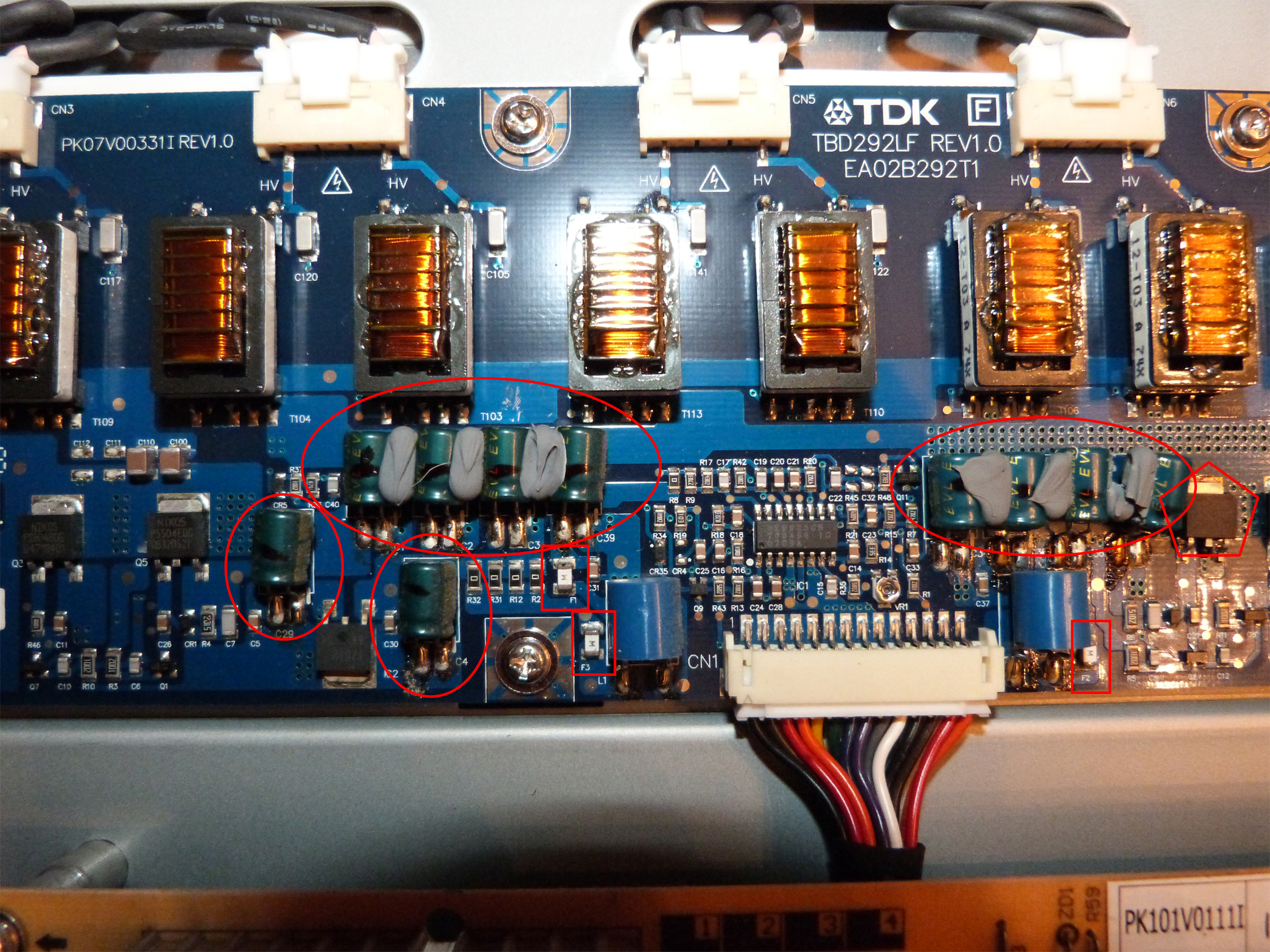

    Working on an Acer AL2416W that seems to have bad caps (at least). I have tested CN1 and all the voltages are correct (24v x5, etc).
    Acer logo briefly shows on power-on then goes black. Image is still being displayed with backlight inoperable.
    In the picture below, the 4 right caps have bulging bottoms while the 6 on the left look fine. BTW, don't mind the epoxy/silicon ripped between the last two caps on the right -- I did that. While testing voltages with the power on, the left caps all get 24v while the right caps get nothing.
    3 fuses found, two on the left and one on the right. The left fuses read 0.4ohms while the right fuse shows OL. However, when I turn the power on the right fuse shows 0.0 instead of OL. Not sure what to make of that.
    Also, the mosfet right next to the right-most capacitor looks to have some sort of leakage coming out of it. I didn't think mosfets had anything to leak, but there is clearly something under the chip??
    Is this pretty typical symptoms for the problem I'm having? I definitely plan on replacing the caps, fuse, and mosfet, but should I go ahead and swap anything else? The other mosfets, fuses, other items?? Thanks!!
    PS, I did read quite a few other threads on this same model but each had slightly different issues, and with different components, than I am having which is why I posted a new thread.

    You can see what is wrong with those caps:
    https://www.badcaps.net/forum/showth...ghlight=al2416
      Re: Acer AL2416W -- Backlight goes out
      You need to check the MOSFET Source to Drain pins for shorts due to having blown fuse for the B+ feeding the MOSFETs. If the filter caps are bad, it will cause lots of AC ripple to mess up the inverter circuit which can run at the wrong frequency which will cause the MOSFETs to run hot and burn out. Bad cap can look normal.
        Thanks! I definitely suspected the caps being the issue. I thought it was odd as well how they have these caps mounted. Never seen caps of this type mounted like that.

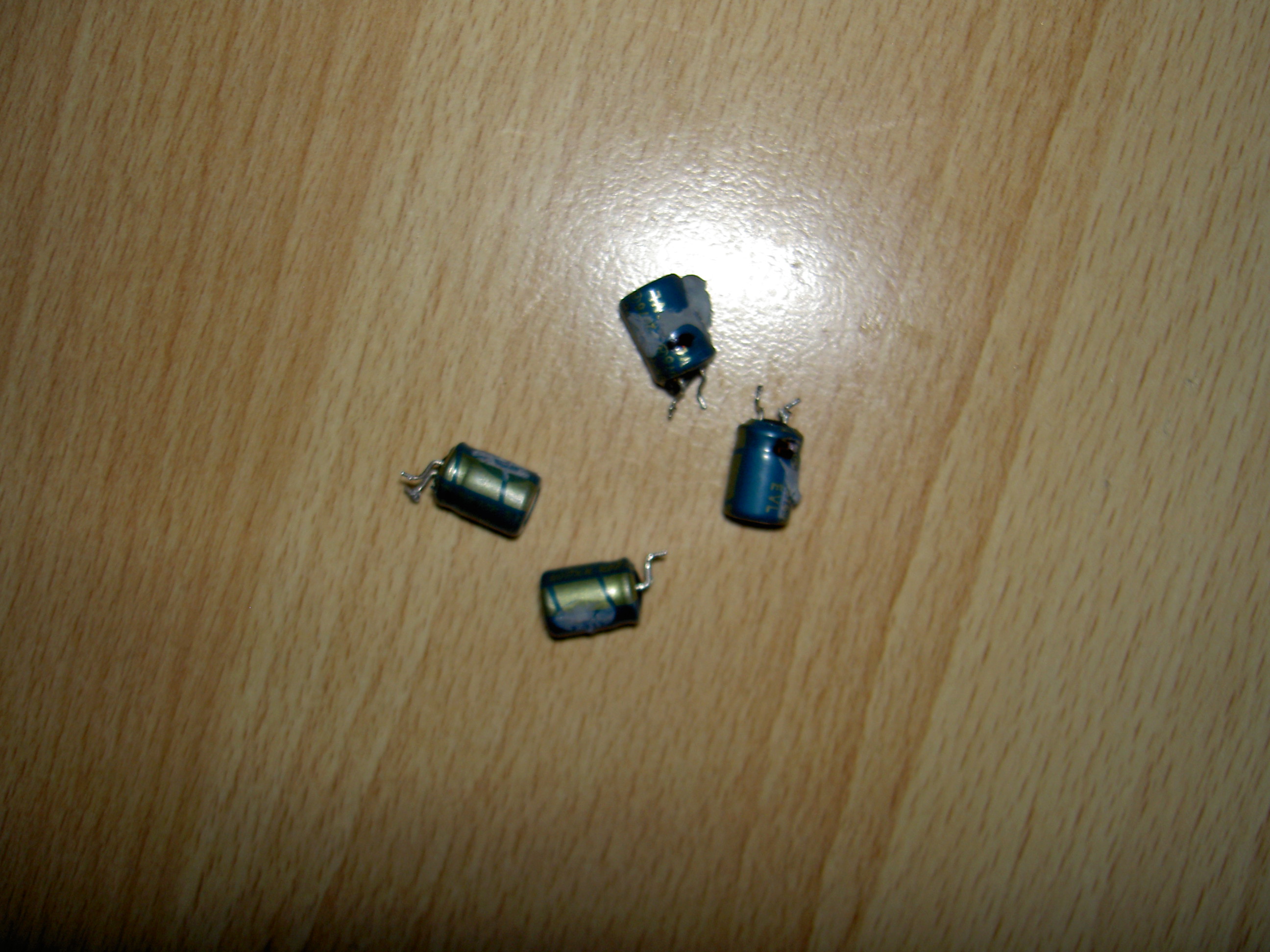

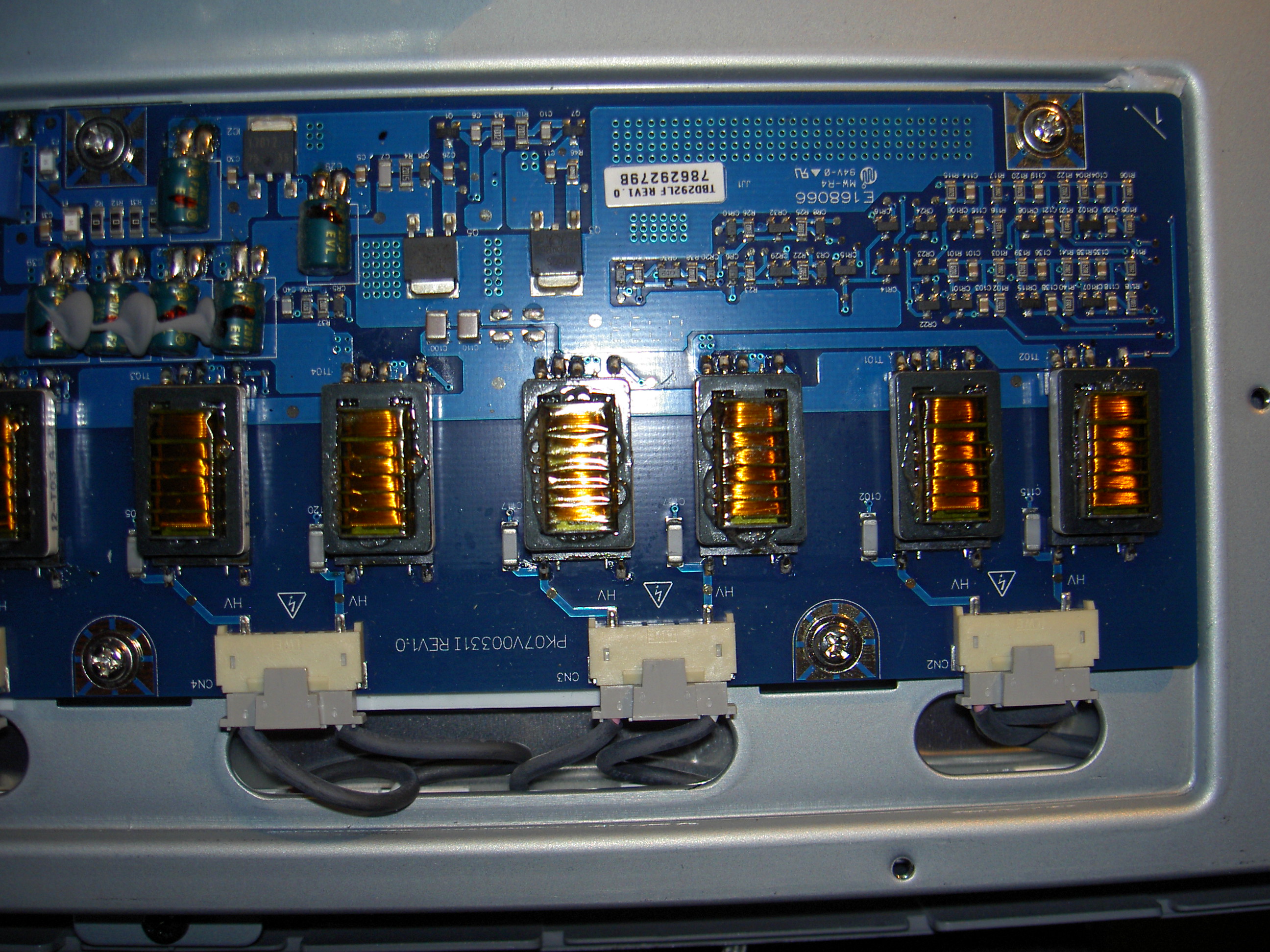

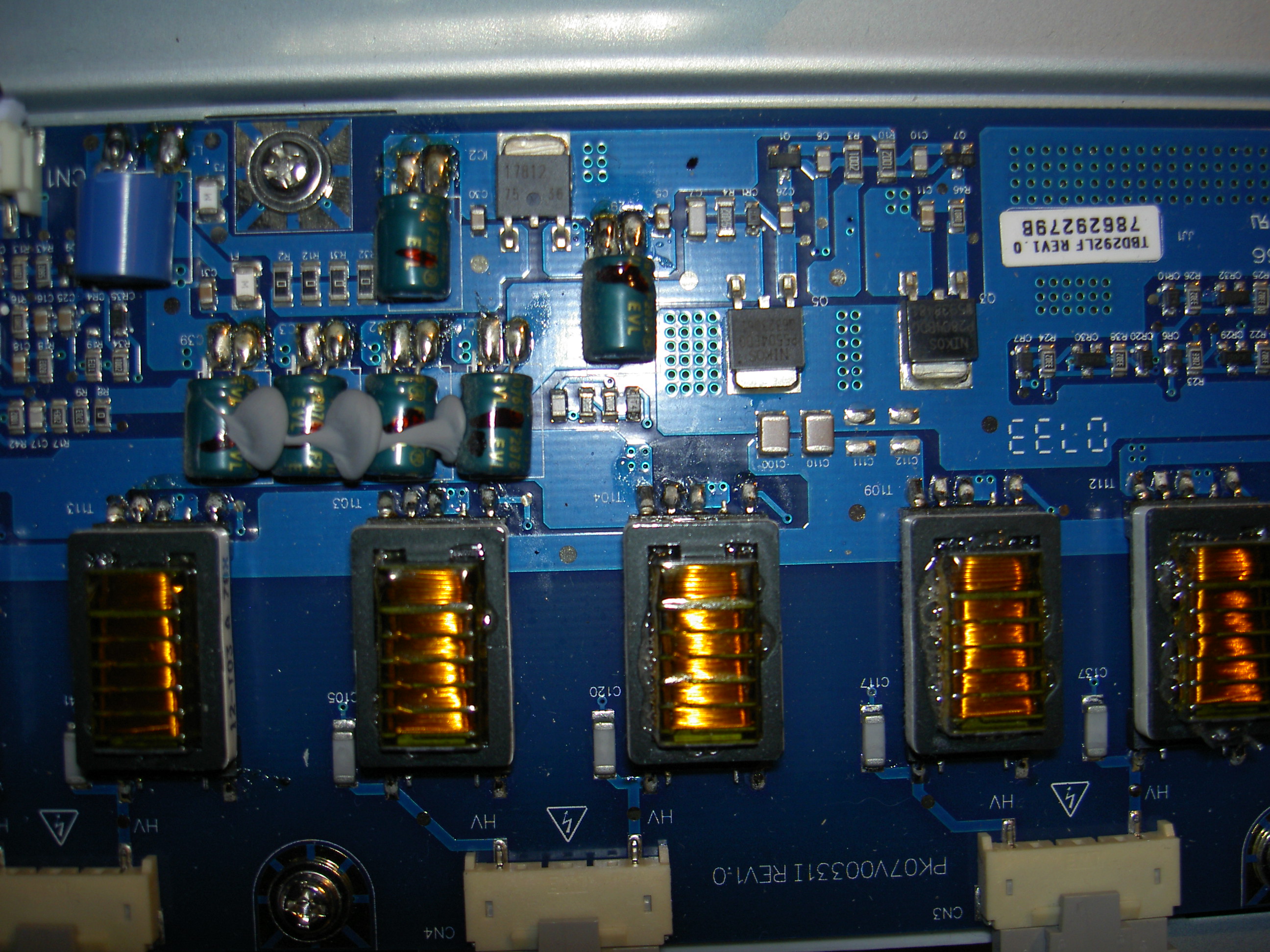

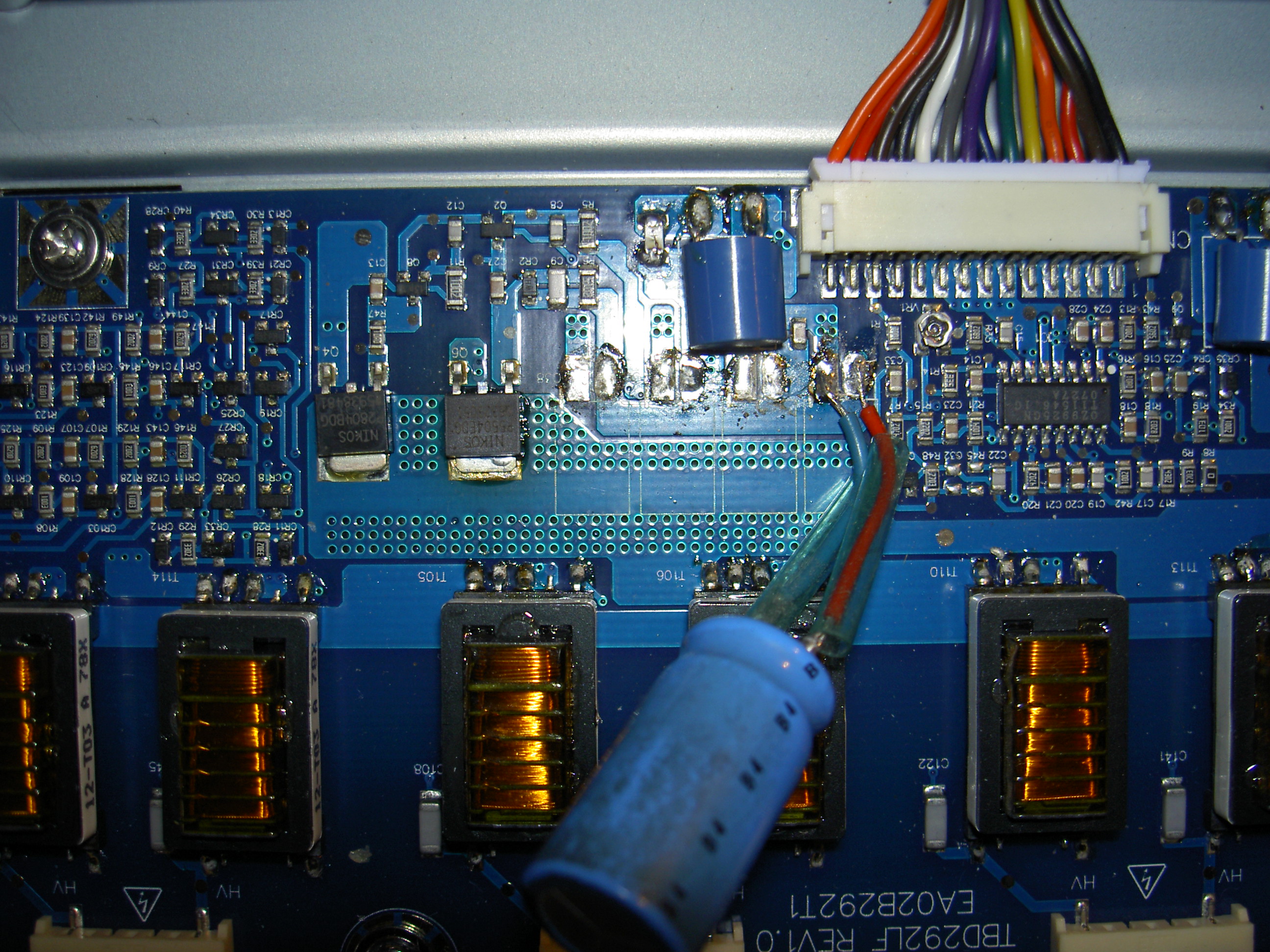

                                Here are some pictures which I was able to make.
                                Thank you for your answers
                                Rogebe
