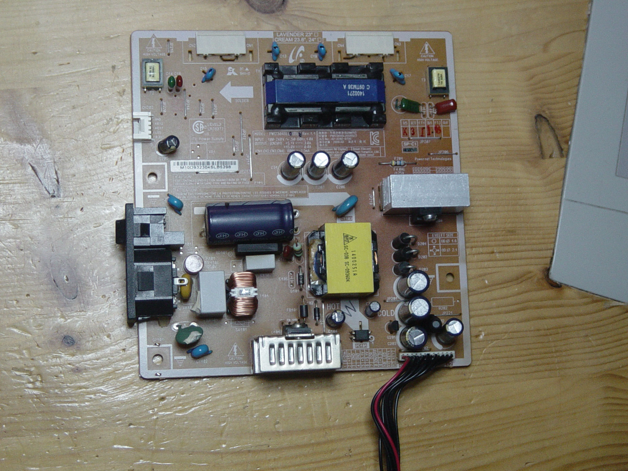

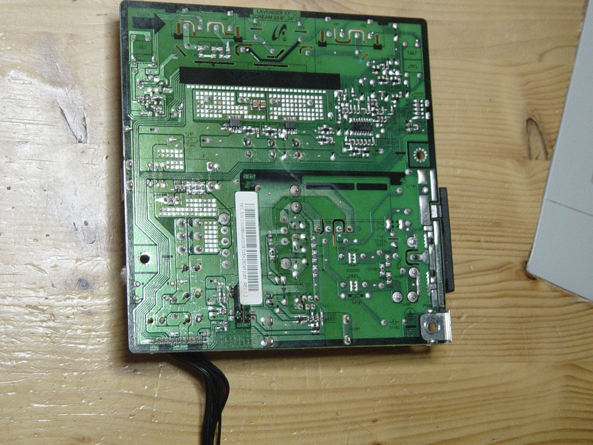

    I have a problem with my Samsung 2494SW which i bought dead already. Before I successfully repaired a Samsung Syncmaster 2333SW by just changing all Low Esr Caps. So i decided to buy another broken one.
    I changed all Caps on this one but it still doesn't work. I searched the net - that's how i found this Forum - and it looks like the next most likely path leads to the inverter.
    I already checked the hight voltage output on this board - there is no one - i guess because it is in standby mode when attached to power only without connection to the control panel.
    Any suggestions were and how to check next?
    See Photos attached.

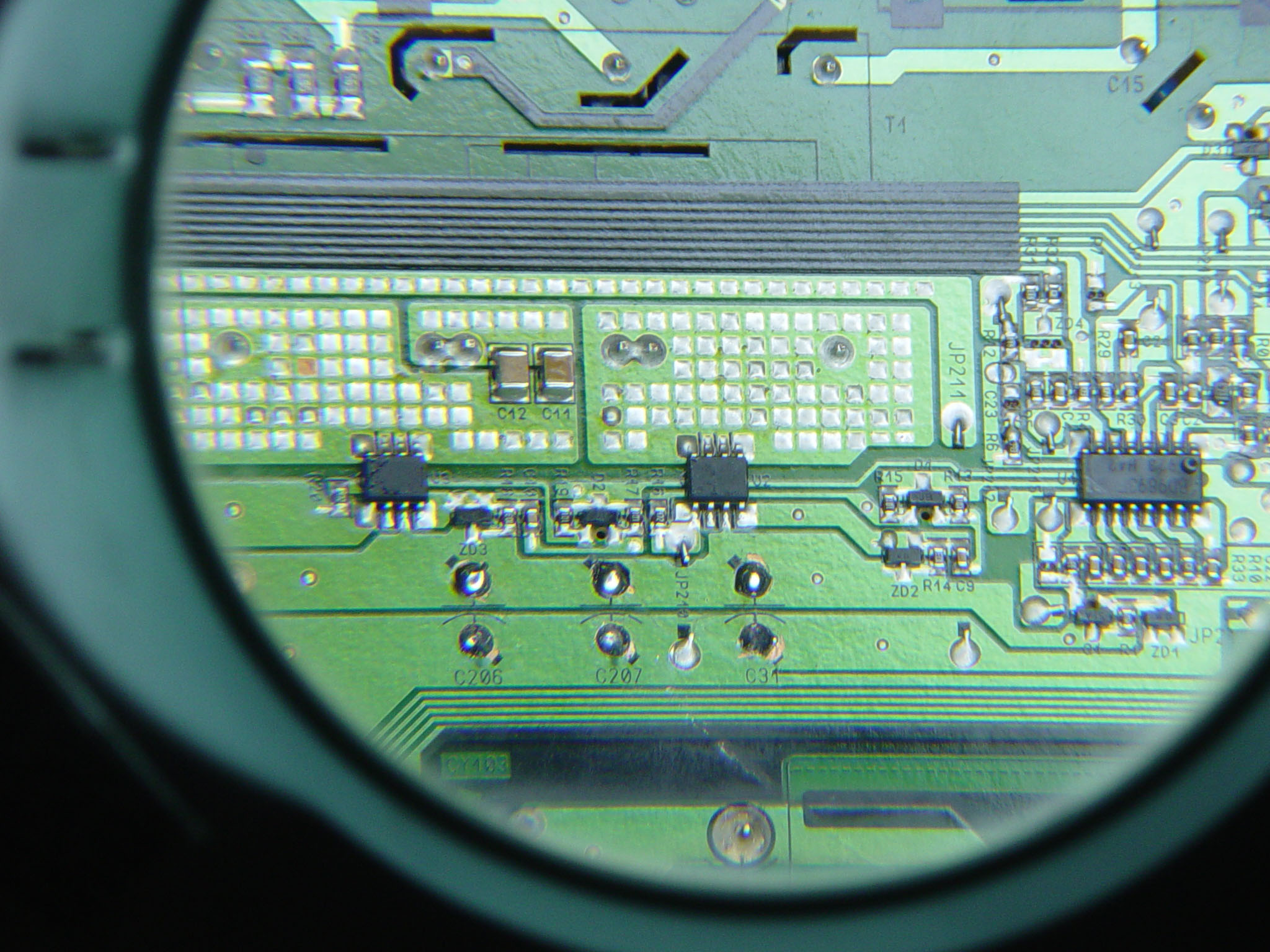

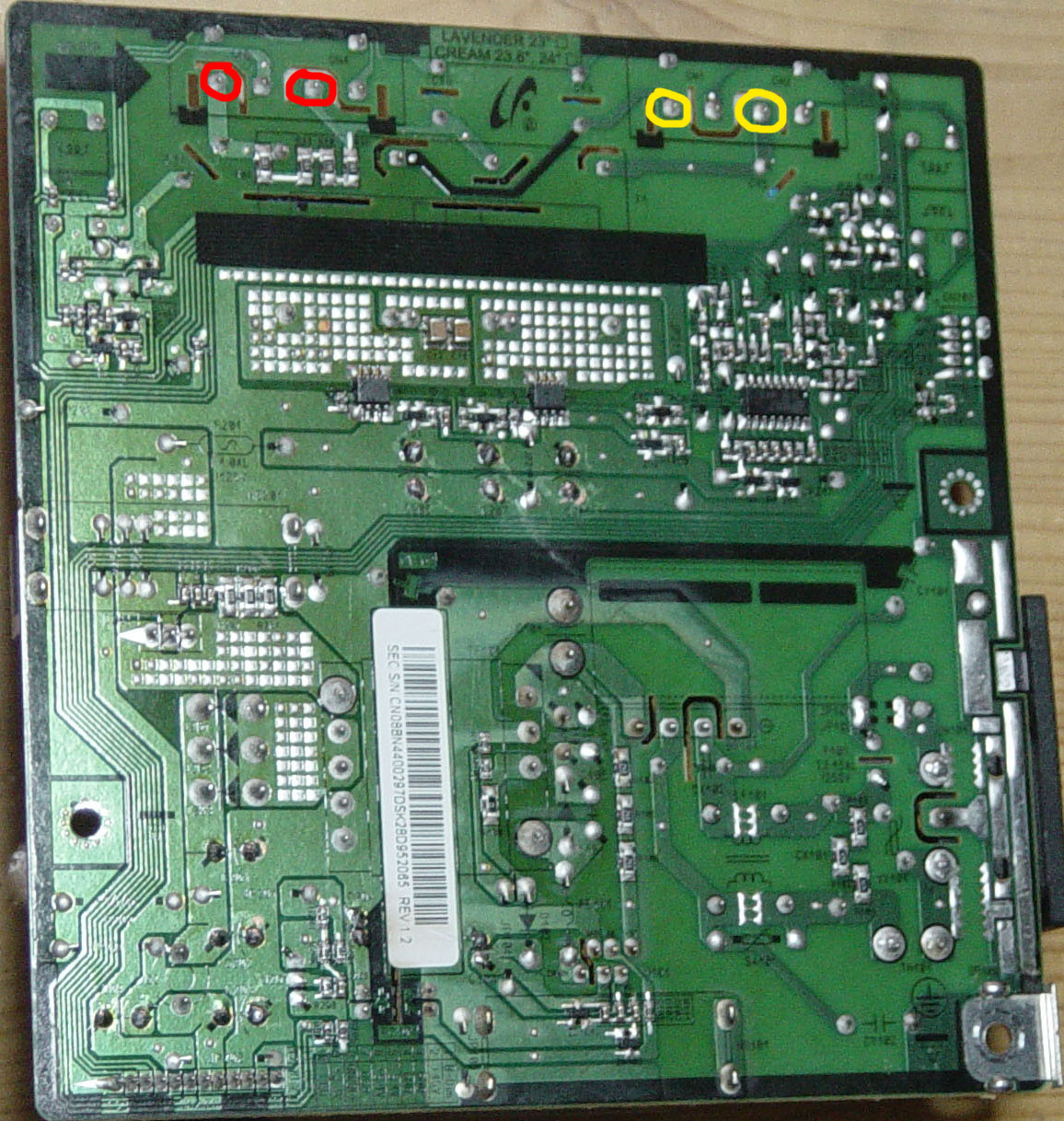

          I checked mine with my multimeter (set to 2M Ohms) and the readings are:
          0.220 between the red circles and 0.222 between the yellow circles
          when i compare this to the answers in the other thread i guess my inverter is ok.
          ...... searching goes on......
          I also ohmed the 4 very small blue ballast caps for the lamps - i couldnt measure any reading on my multimeter even when set to the highest possible 20 M Ohms. Thats what a capacitor should show so i guess these are ok also...
