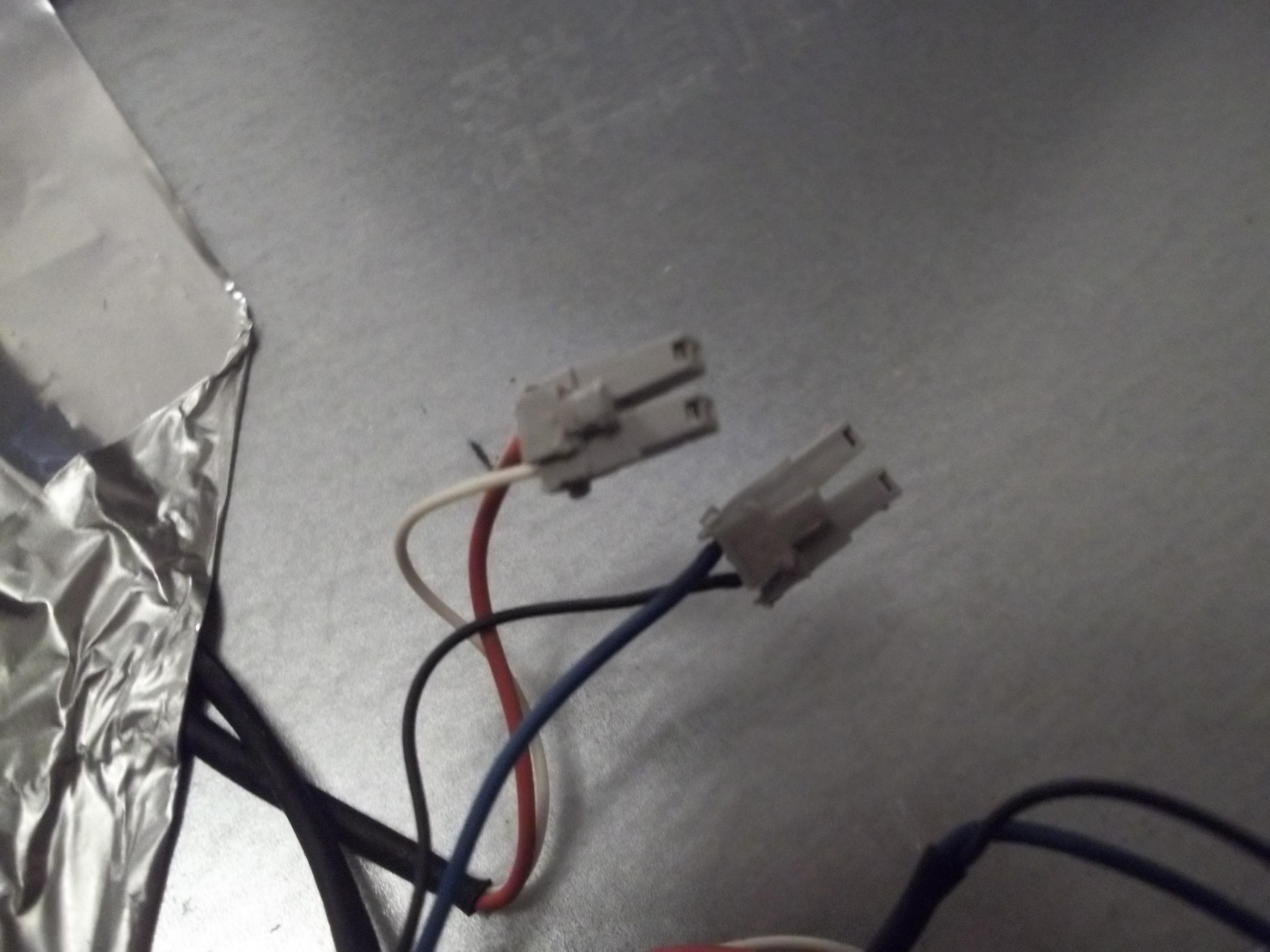

    Hello everyone, my name is Bobby. I have recently had problems with my Gateway 19'' LP1925 HD monitor. When I open up the monitor I see these 4 small 2 pin grey connectors which with one plug the wire is ripped from the connector. I am not sure what type of connector it is and need help in order to identify it so I may buy another. Thank you in advanced.

    They're JST harnasses. The connectors are made by JST and are pretty much standardized by all monitor manufacturers.
    See this page: http://www.ccflwarehouse.com/hivowiandha.html
    Note that you need to use silicone wire, those wires are not basic wires, they're insulated better than regular wires as they carry 700-1400 volts through them.
    The store above is OK to buy from, and you're better off buying the whole connector with wires and everything.
