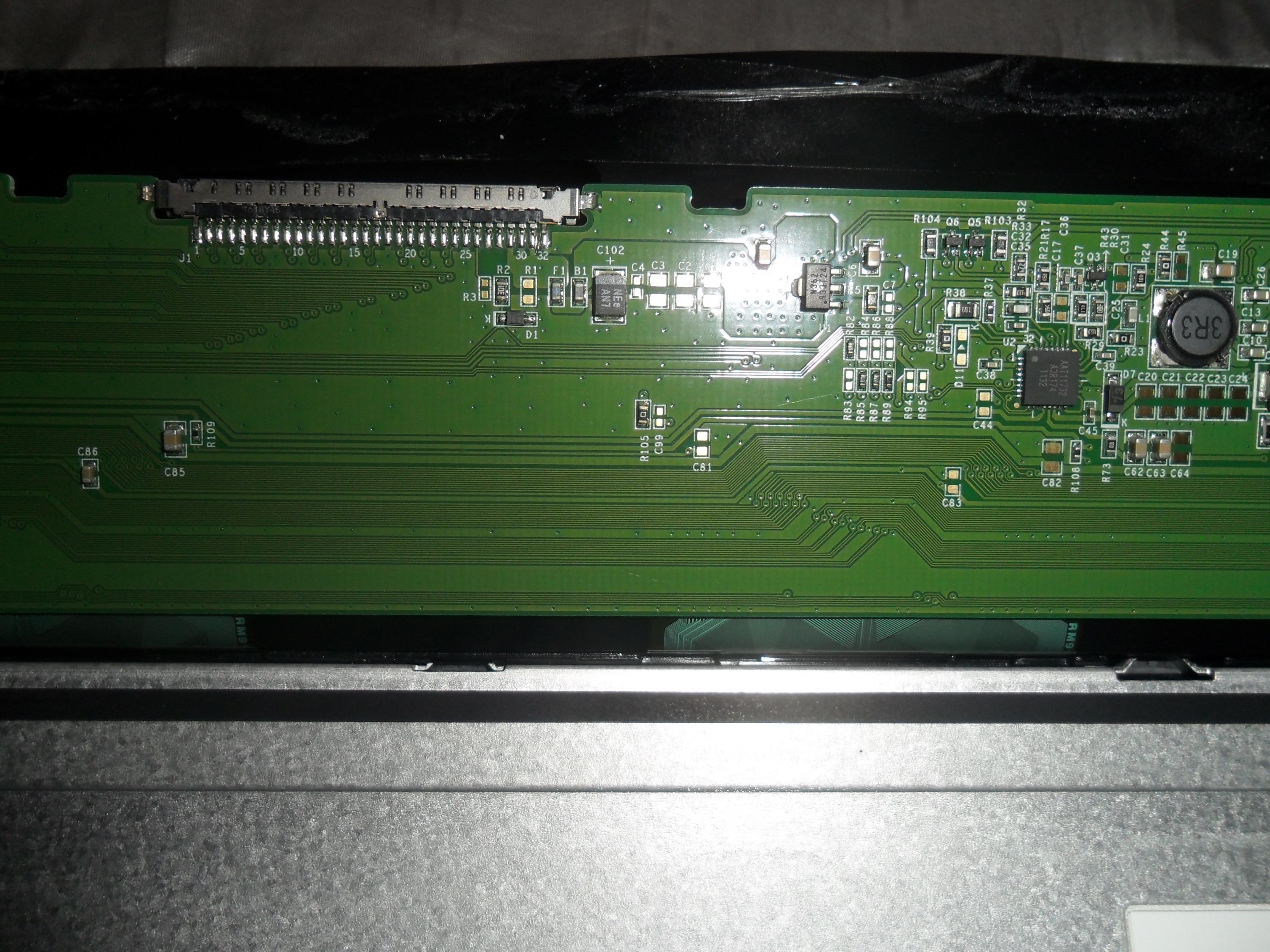

    what type of fuse
    iv posted a pic of the fuse on the benq g2222hdl inverter bd thatis attached to the lcd as the monitor is showing the white screen issue, and from reading a few posts on here the fuse could be the culprit but what type is it apart from smd fuse incase i require replacment ty all.

    There's usually a letter indicator on the fuse. I can't tell if yours has an "O" (letter O) or something else.
    If it is "O", then it's a 2.5A fuse - which should be about right, as fuses for LCD monitor t-con boards are usually rated between 1.5A to 3A.
