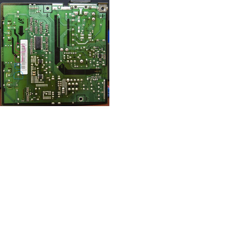

          • Rtech
            • Jul 2010
            • 1095
            Re: Samsung SyncMaster 2443BWX Comes Up, Goes Down and On and On
            On the photo attached check resistance between the two RED marked pins,and then between the BLUE marked pins and advise.Also I suspect from your last paragraph that the problem is the Backlight and/or its wiring that goes to the right lower corner.

              • Rtech
                • Jul 2010
                • 1095
                Then the probability is that either the wiring or the backlight/s associated with that bottom right corner is the cause of the problem.Arrange the Screen so that the both top and bottom sets of Backlights change position, and then see what happens..that should confirm the cause prior to taking the screen apart to get to the lamps
