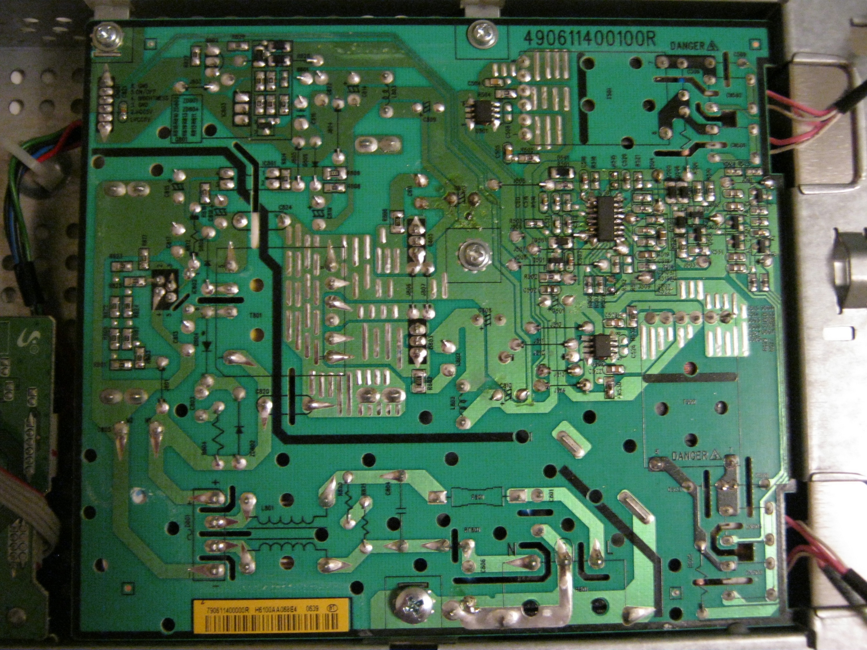

    Samsung Syncmaster 731N - No backlight
    This monitor suddenly lost the backlight one day. When I turn it on, the backlight doesn't even flicker. The screen stays solid black, but I can see the picture with a flashlight. I have no idea what would be causing this. Everything tests good, so I replaced the OZ9938GN. That did not solve the problem, but the voltage readings on each pin of the chip are slightly different.
    Here are the voltage readings I get:
    1. DRV1: 0V
    2. VDDA: 4.9610V when off, 4.9142V when on
    3. Timer: 0V when off, 0.0086V when on
    4. DIM: 0.3431V when off, 0.3421V when on
    5. ISEN: 0V
    6. VSEN: 0.0120V when off, 0.0115V when on
    7. OVPT: 0.3486 when off, 0.3469 when on
    8. ENA: 0.0278V when off, 2.6243V when on
    9. LCT: 0.7345V when off, 0.7269V when on
    10. SSTCMP: 0V
    11. CT: Rapidly changing, between 0V and 0.0060, reaches 0.1-0.15V for a few seconds after being turned on
    12. DRVA: 0V
    There doesn't seem to be anything wrong, but the OZ9938GN isn't driving the MOSFETs.

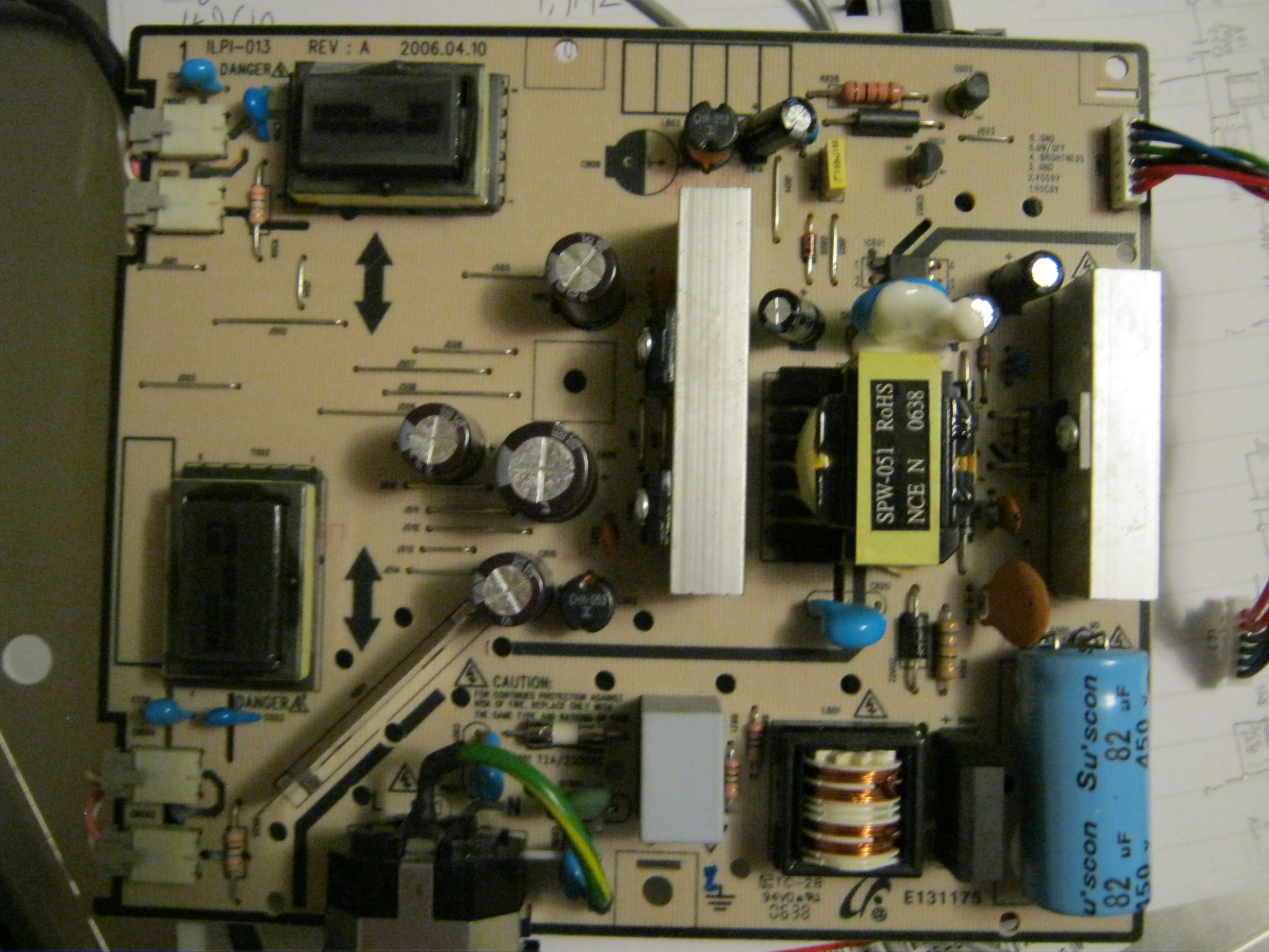

    What voltage do you have at the ON/OFF pin connector between the main and the power supply board? DC reading on C810?

      I get 3.20V at the ON/OFF pin with the monitor turned on. I measured 14.98V across C810, but the multimeter I am using gives unusually high readings under some circumstances.

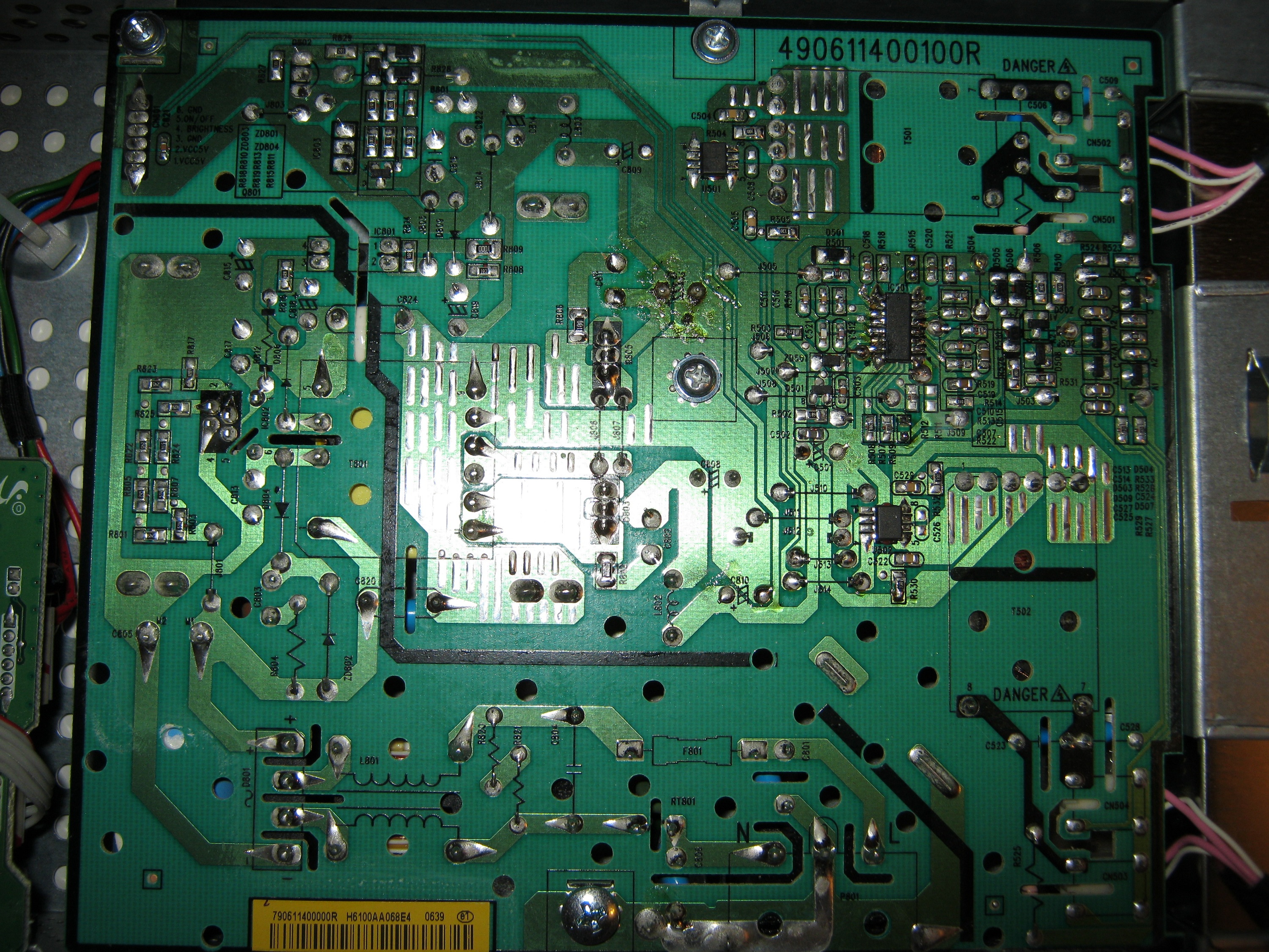

        I found something that might be a problem. R508 (marked 66C) doesn't appear to be connected to anything. It is connected to VDD, but the other end is connected to a trace that goes under the OZ9938. I can't find where this end is connected.

            Based on the board layout and the application circuit in the OZ9938 datasheet, it appears that R508 is connected to pin 13 of the OZ9938. I did notice that the voltage on this pin was close to VDD with the original chip. I tried connecting that resistor to pin 13. It appears that there is a very brief flash when I turn the monitor on. I don't know if this is the backlight trying to come on or just something that occurs when the T-Con and panel receive power and a video signal.
            The voltage on pin 7 (OVPT) seems low. It might be shutting down because of this, but I doubt it. Every component except the OZ9938 and the ceramic caps have been tested. I only checked the resistance across the caps to make sure they weren't shorted, and I don't know their original values anyway.

              I take it you've tested the secondary winding resistance of each inverter transformer?

                There is a difference in resistance on each transformer, but I don't think it is a problem. I don't think all four CCFLs would fail at the same time, but I can't test them right now. The MOSFETs aren't being driven by the OZ9938. It looks like it isn't even trying to light the CCFLs.

                      T501:0.6156K ohms
                      T502:0.6205K ohms
                      I am getting 1.0mVAC and 0.3mVDC at the gates of the MOSFETs when the monitor is turned on and nothing with the power off.
