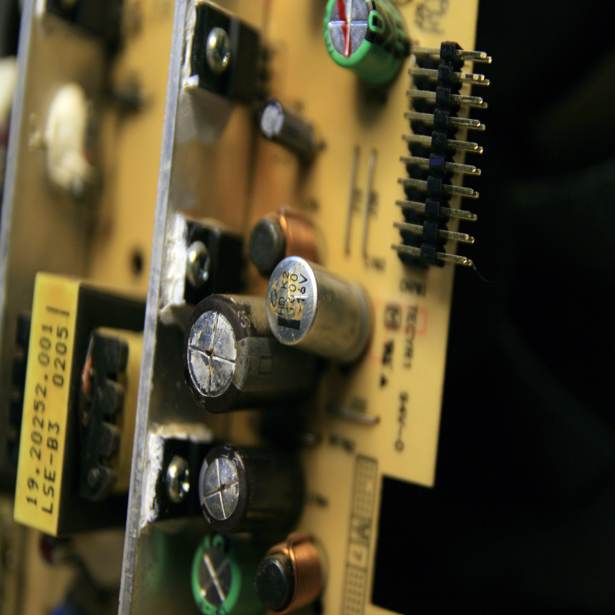

    Has any one seen a capacitor like this silver can with rating on top HD K2 1000 16v I am recapping a NEC Multisync LCD1720M
    I am asumming I can use 1000uf 16v cap but not sure

    It's a Nichicon HD series
    So yes 1000uf 16v

        Be sure to replace those green capacitors too, they are probably 'Lelon'.
        I saw on the web one other failure of Nichicon HD. But, there looks to be some other caps that have popped too (capxon?), so I'm guessing the HD just got too stressed out... either that, or it got too hot.
