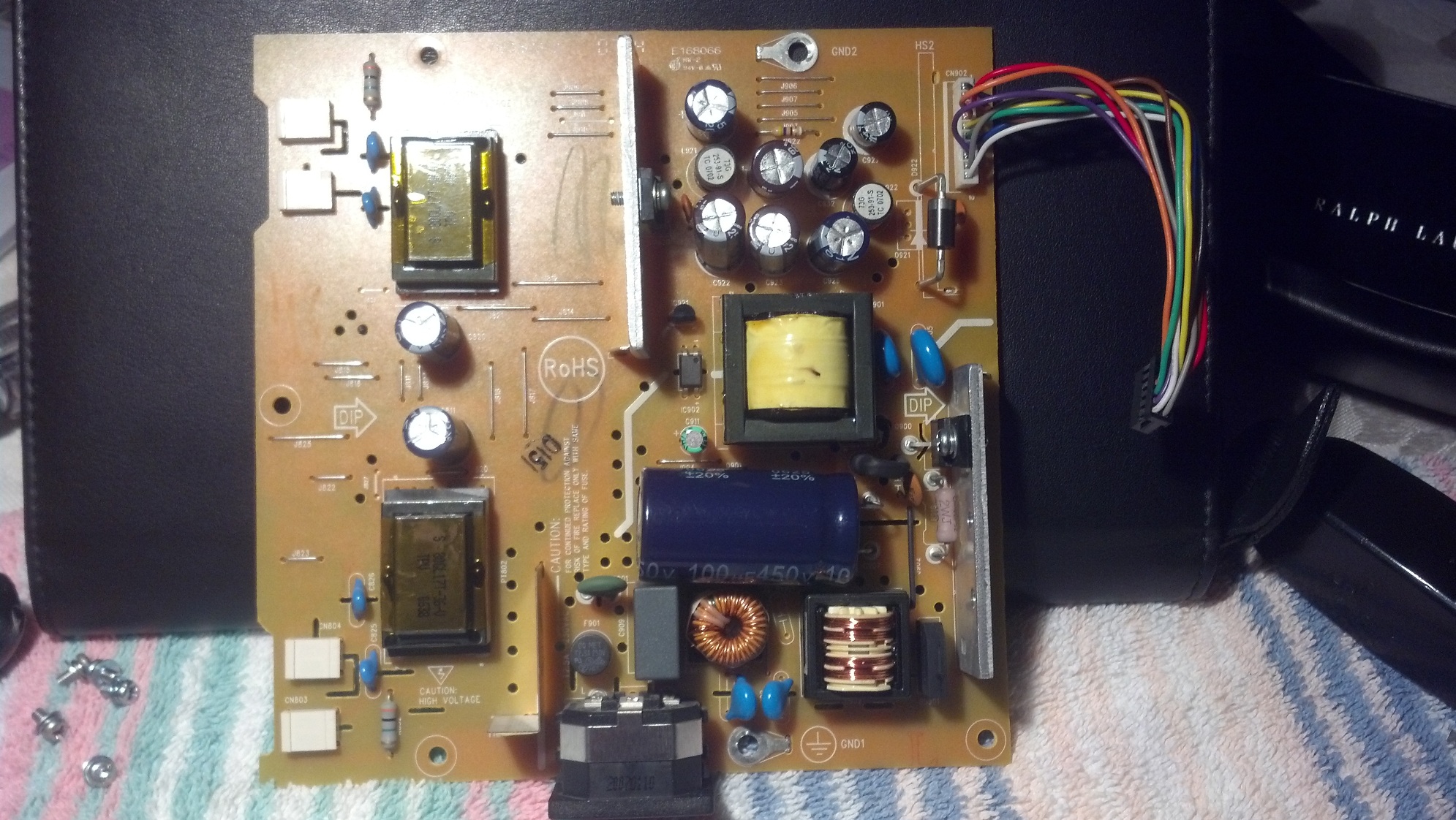

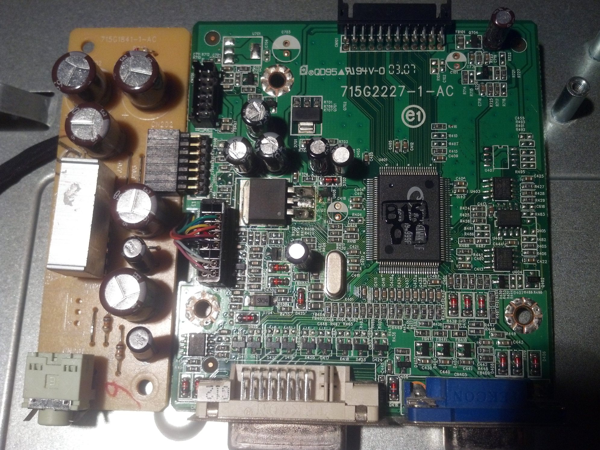

                All the old ones on the power board were Hermei. All the old ones on the audio board are Hermei, and have not been changed yet. The ones on the video board are Rubycon, something with a king's crown symbol, TL, and T3(?). NO cap is visibly defective.
                I got my ESR 70 meter today and measured all the old caps from the power board (715G1823-2), then the ones still mounted on the audio board (715G1841-1-AC) and video board (715G2227-1-AC). The chart in the ESR 70's manual is nowhere even close to the readings in the charts mentioned here, so I do not trust its figures.

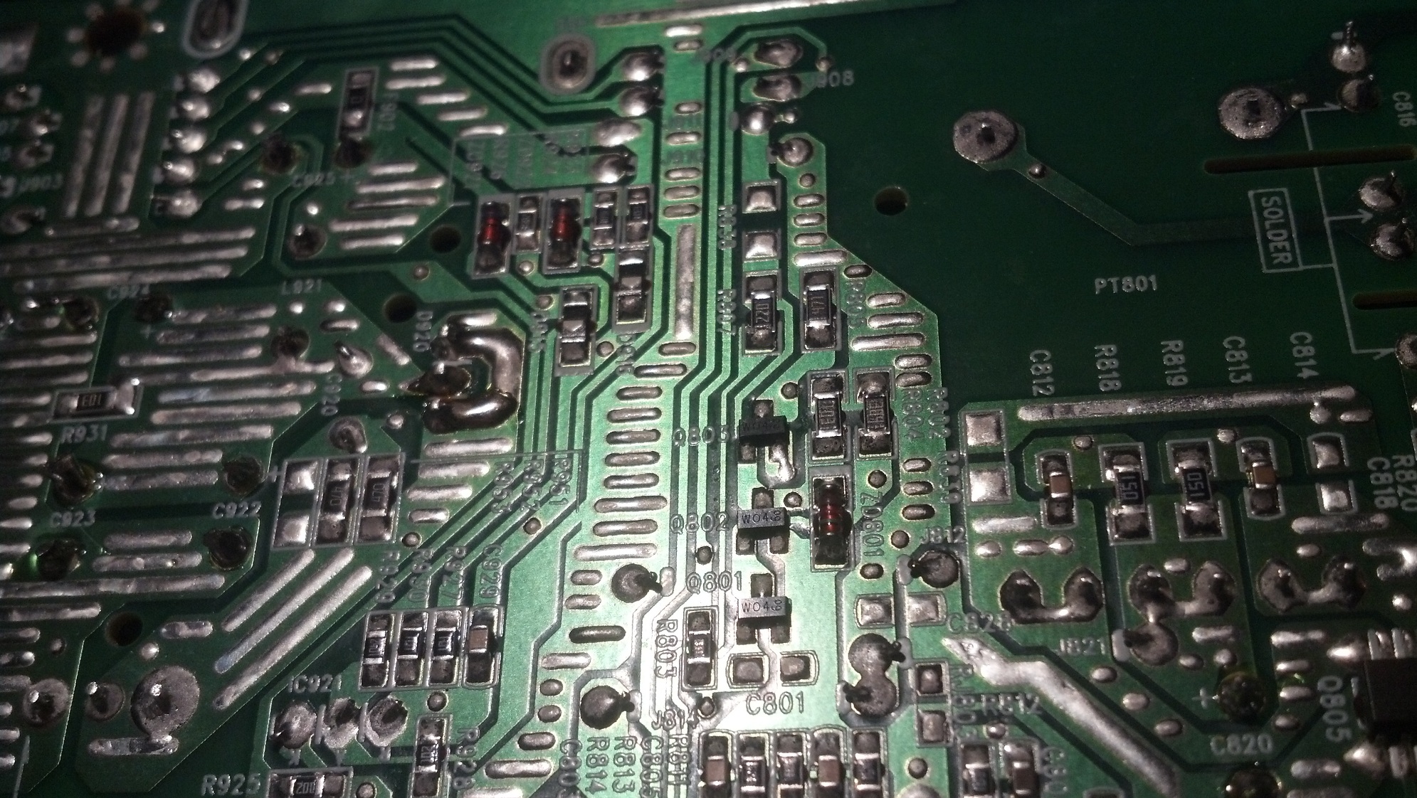

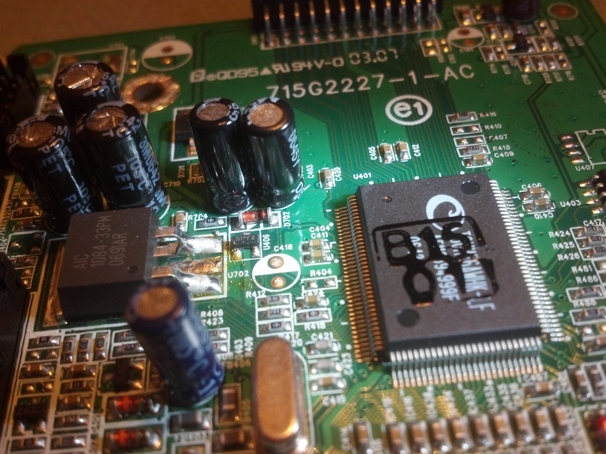

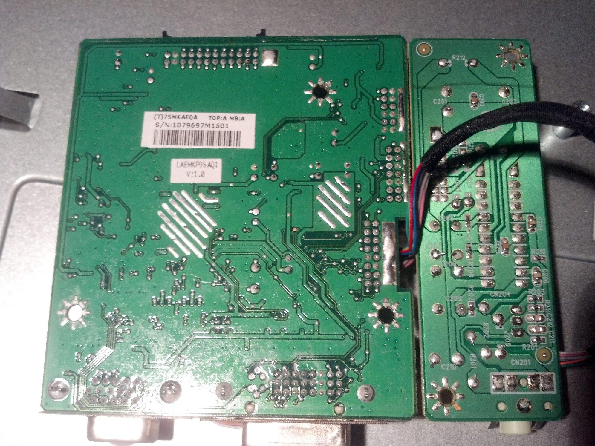

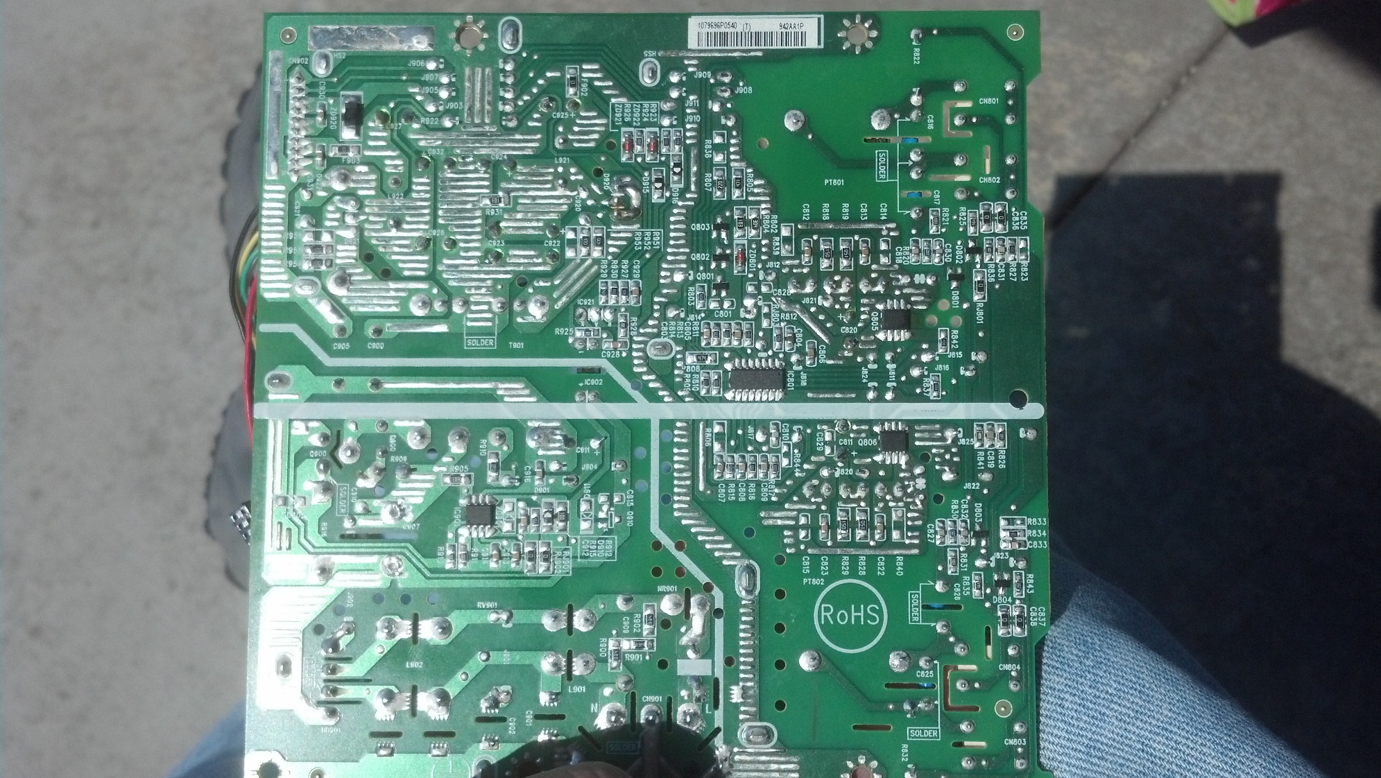

                          Here are some pictures. I think D920 on the back looks odd...the solder looks as though it has melted and is more shiny on on side than the other. It is the diode(?) that is screwed to the big heat sink on the front.
                          The video-connector board has one area that looks odd on the front at U406. There is discoloring of the area.
