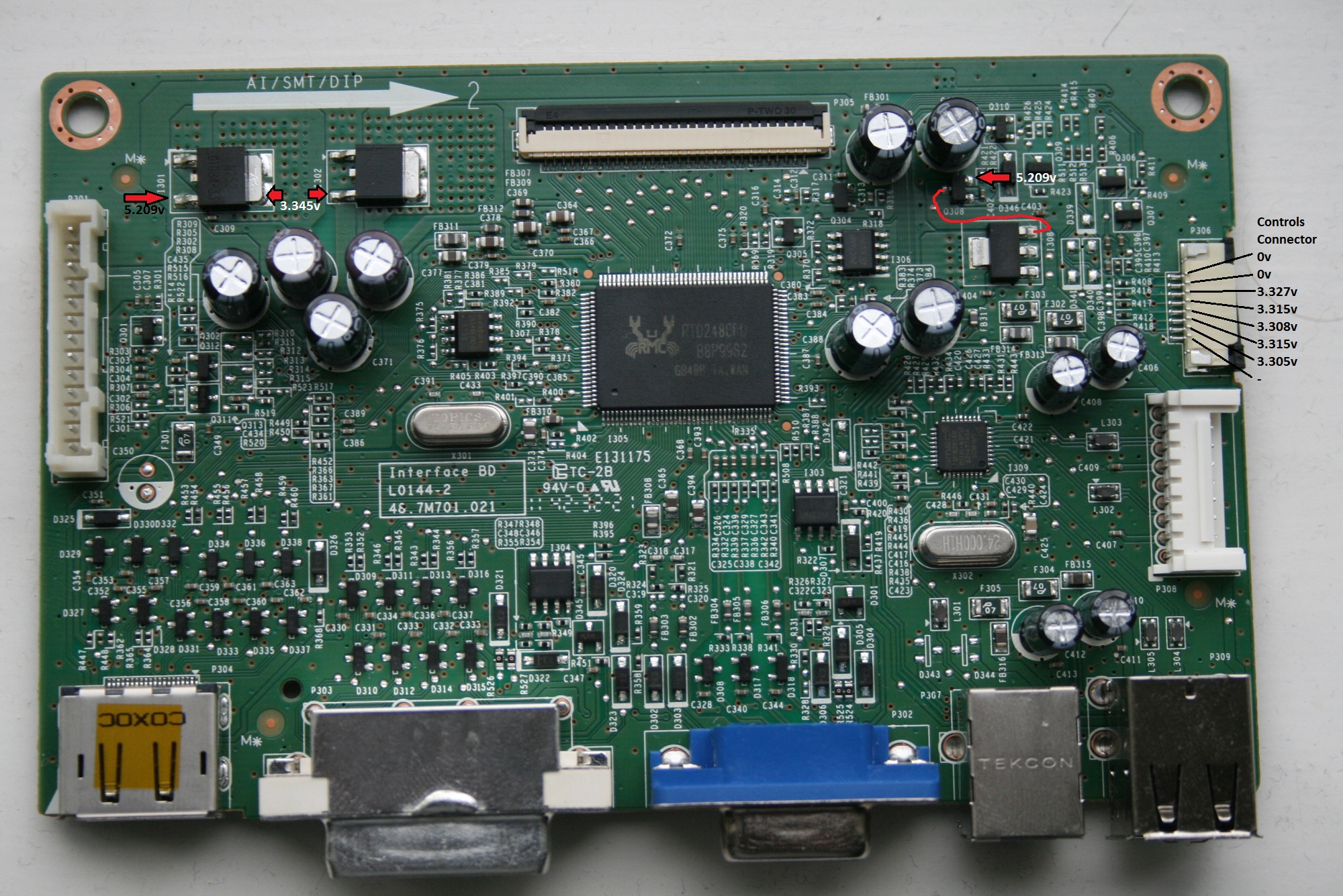

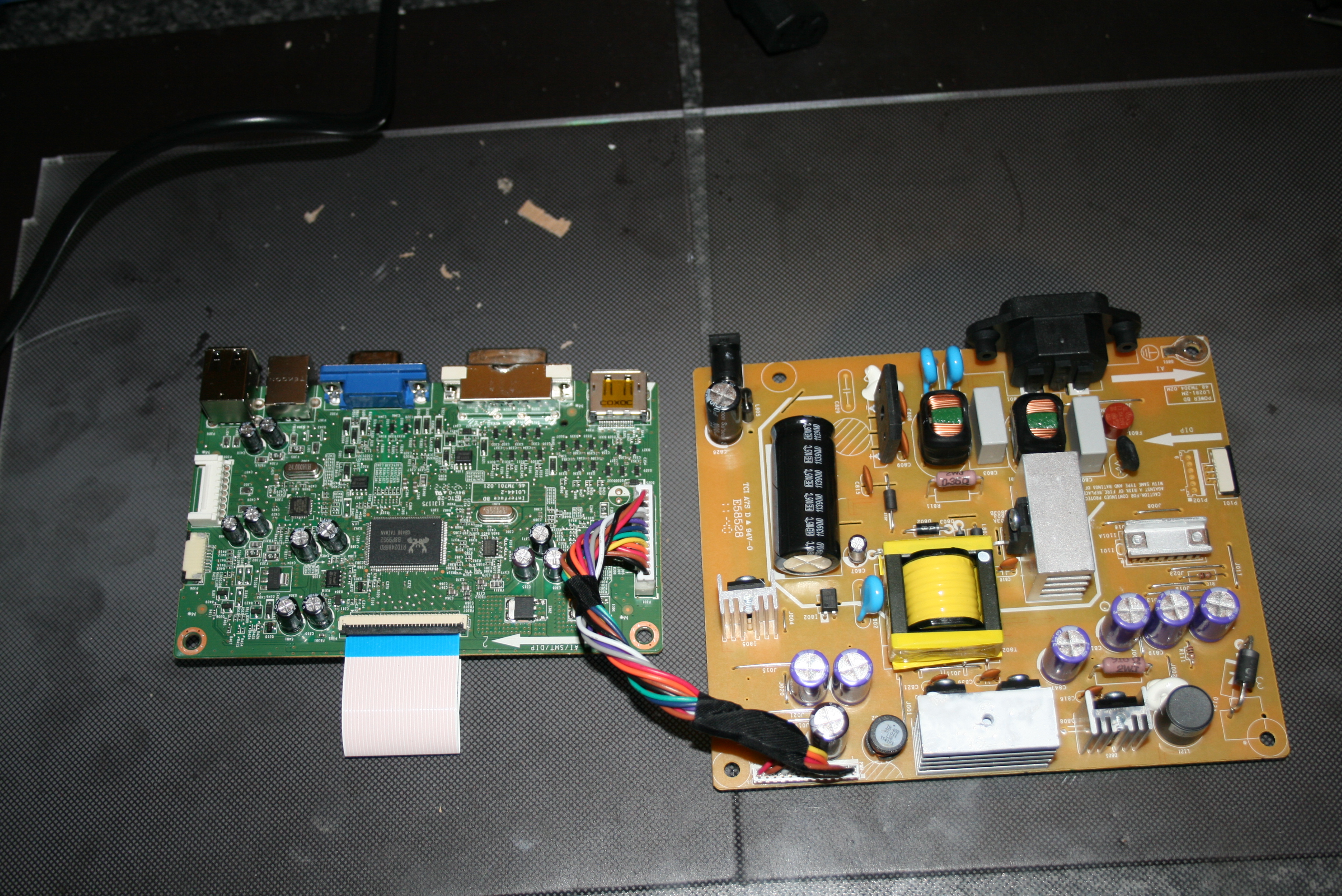

    Got one of these to fix yesterday. I havent looked at an LED one before so I need a little guidance.
    The monitor when plugged in shows no sign of life at all. I have stripped it down and plugged in the power supply and mainboard without having the monitor connected. The big cap is showing 330v and there dows seem to be voltage getting to the mainboard as I quickly tested the voltage regulators. I havent checked to see if they are correct yet which will be my next step.
    Pics are only quick ones and as its dark here I had to use the flash but hopefully they will you give you an idea of what I am working on.

      Re: Dell u2312
      Right...
      I301 = 3.3v
      I302 = 2.1v
      I308 = 0v
      P306 is a ribbon connector that connects to the switch panel. There seems to be 3.3v present on some of those pins.

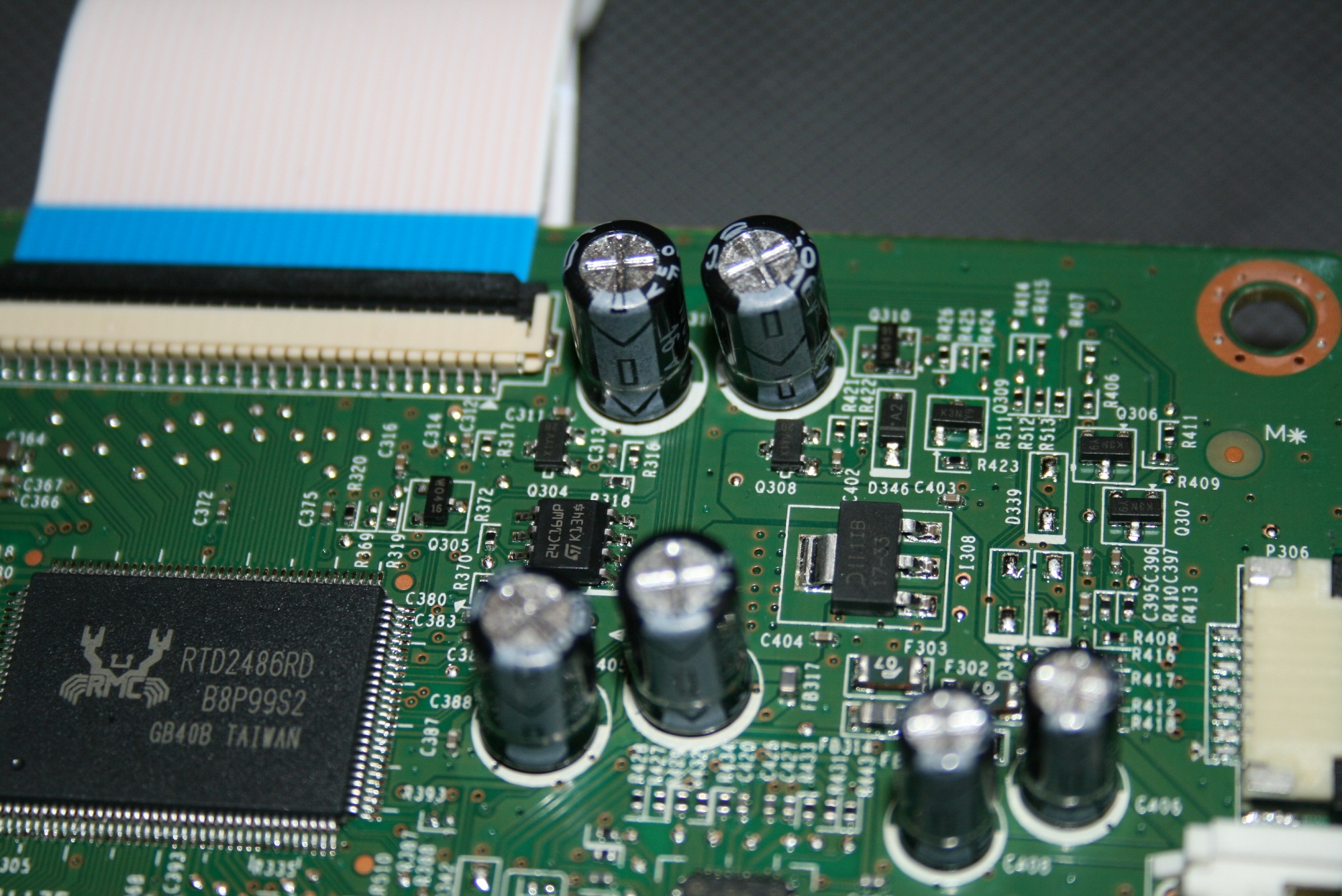

        I308 is a 3.3V output regulator. Are you at least seeing a 5V input for I308?
          Re: Dell u2312
          Im getting nothing at all on any pin of I308. There are a few SMD fuses on the board too which I have been testing none of which are blown so far.

                Re: Dell u2312
                I308- The rightmost leg is the input. Left leg is ground and middle leg (and tab) is the output. Try tracing the input leg to see what's feeding it.

                        Re: Dell u2312
                        Right,
                        I301
                        N252
                        G1084-33
                        Pin 1 = 0v
                        Pin 2 = 3.345v
                        Pin 3 = 5.209v
                        I302
                        GTC
                        LD1117AG
                        12A010HUE
                        Pin 1 = 0v
                        Pin 2 = 1.205v
                        Pin 3 = 3.345v
                        I308
                        Dll1ib
                        17-33
                        Pin 1 = 0v
                        Pin 2 = 0v
                        Pin 3 = 0v
                        On the Fuses. I meant 0.2 Ohms again my mistake.
                        Looking at I308 it seems to be connected to the USB hub which this monitor has. I do recall someone on here mentioning that the monitor wont power up without the usb hub connected?

                              Re: Dell u2312
                              Ok,
                              There were a number of fuses that seemed to be connected to the on board usb ports and the external ones. I checked them both and none were blown. I then reconnected the external usb's and tested for voltage again and still got nothing I also tried a usb stick with a light on in the on board and and external usb and that didn't have any sign off life either.
                              I am now thinking that there should be 5v's kicking about going into the usb's that maybe also fed the third voltage regulator?

                                Re: Dell u2312
                                Right done a little measurements from P802 on the power supply which connects to the signal board.
                                PWM = 2.514v
                                EN = 0v
                                5v = 5.209v
                                5v = 5.209v
                                5v = 5.209v
                                GND = 5.209v
                                GND = 0v
                                5v = 0v
                                ENA = 0.0v
                                EN = 0.102v
                                5v = 5.209v
                                RTNA = 0.008v
                                DET = 0v
                                After looking at the markings and then trying to double check them as it didnt seem right I noticed that they have put the connector on back to front.
                                Has anyone ever seen this before?
