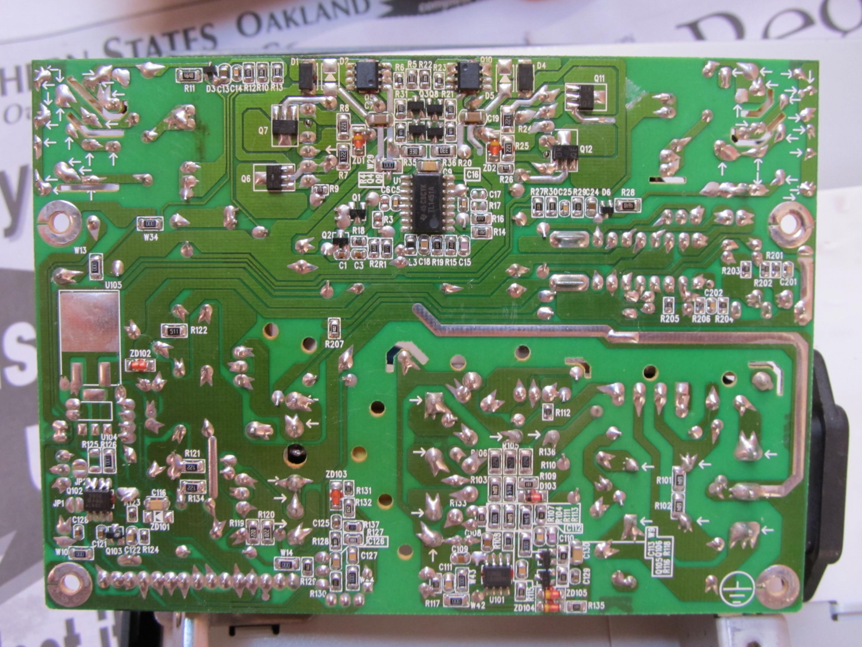

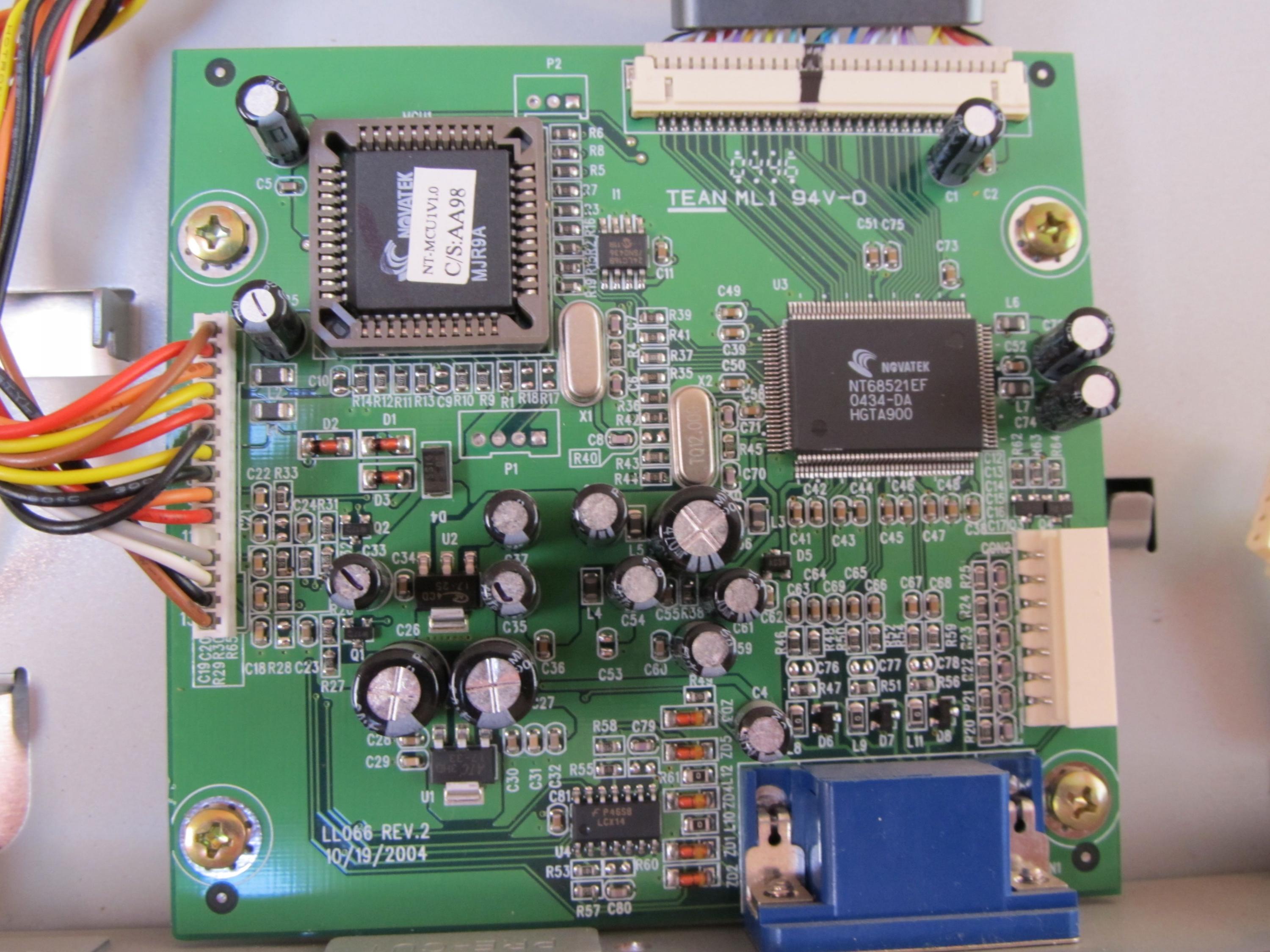

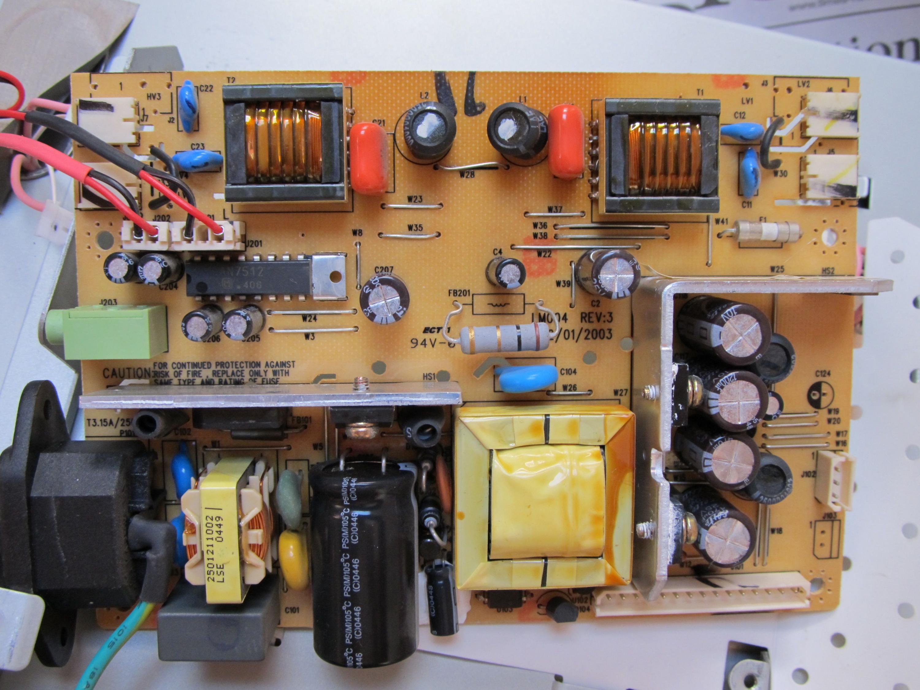

Sceptre Monitor X9G-Komodo VII
  • Tayninh55
    replied
    Re: Sceptre Monitor X9G-Komodo VII
    Ok, I have your voltages Retired: U1 Part #ATC 3HD
    17-33
    Pin #1 = 0.0
    Pin #2 = 3.34
    Pin #3 = 5.05
    U2 Part #4CD
    17-25 It also has a "Large capital C", with
    a "smaller capital AC" inside the
    the Large C, in the upper left side.
    Pin #1 = 0.0
    Pin #2 = 2.52
    Pin #3 = 4.76
    Jet,,,,,,,No. The numbers on the NOVATEK chip are: NT68F633L
    0445-CO
    MJR9A
    Leave a comment:
  • jetadm123
    replied
    Re: Sceptre Monitor X9G-Komodo VII
    In your third photo of your logic board, there are 2 Novatek chips on it. The one of interest is the Novatek controller that's in the brown socket with a paper label over it. Carefully, pull the label back to expose the part number. Is the part number NT68521?
    Leave a comment:
  • Tayninh55
    replied
    Re: Sceptre Monitor X9G-Komodo VII
    Selldoor, Thanks, but I have another monitor hooked up to my computer at the present time and it is working fine, so that eliminates the computer and video card (I think).
    Leave a comment:
  • ben7
    replied
    Re: Sceptre Monitor X9G-Komodo VII
    Have you tried hooking it up to another video source?
    If the problem still persists, Im guessing that there is an issue with the main processing chip, which appears to be connected to the VGA port directly.
    Leave a comment:
  • ratdude747
    replied
    Re: HELP - Sceptre Monitor X9G-Komodo VII
    Moved from General Computer Discussion. Also revised title to remove clutter.
    Leave a comment:
  • retiredcaps
    replied
    Re: HELP - Sceptre Monitor X9G-Komodo VII
    One the main board, there are two voltage regulators: U1 and U2.
    1) Set your multimeter (if manual range) to 20V DC.
    2) Put your black probe on a ground screw. Leave it there the entire time. This is your ground.
    3) Put your red probe on each of the pins, but ignore the "fat" tab. The fat tab is "up" or "north". Number the pins left to right.
    4) You should have 3 readings per regulator.
    5) Report them like so along with the part number (include all lines on the IC) of the IC.
    U1
    AS1117-33
    pin 1 = 0.0
    pin 2 = 3.3
    pin 3 = 5.0
    Also try reseating and cleaning every internal cable.
    Leave a comment:
  • selldoor
    replied
    Re: HELP - Sceptre Monitor X9G-Komodo VII
    Im having an early night so will leave retiredcaps to start you off. I only wanted to say thanks for the really good pictures - there have been some dire ones on here recently.
    Cant see any fuses on the video board - have you checked your PC video card is ouputting correctly and perhaps tried a new cable - pc to monitor.
    Leave a comment:
  • Tayninh55
    replied
    Re: HELP - Sceptre Monitor X9G-Komodo VII
    Yes, I have a meter and know how to read DC voltage,,,as long as I know where point A, and point B are located to do the test, but again, I'm far from a professional. I am attempting to post the front and back of my LM004 board and a pic of the front of the other board (I haven't taken this one loose from the chassis yet). I you do need the back of this one, I'll get a pic of it also. From appearance, I can't see anything that is wrong. the two 470uf caps look normal, as do the 1200uf caps. As a start, do you think I should replace these four caps with new ones, regardless of how they look, as some have recommended? Haven't done anything to the boards yet, waiting for your suggestions. Hope the pics are ok!
    Don
    Leave a comment:
  • Tayninh55
    replied
    Re: HELP - Sceptre Monitor X9G-Komodo VII
    Sorry to hear that about PlainBill,,,,,,,,,,I hope nothing has happened to him!
    Leave a comment:
  • retiredcaps
    replied
    Re: HELP - Sceptre Monitor X9G-Komodo VII
    1) Post clear focused top down pictures of all your boards following my sig file below exactly. We want the picture compositions like so
    https://www.badcaps.net/forum/showpo...94&postcount=1
    2) Do you have a multimeter and know how to measure DC voltage?
    PS. PlainBill has been MIA since April 2012.
    Leave a comment:
  • Tayninh55
    started a topic Sceptre Monitor X9G-Komodo VII
    Sceptre Monitor X9G-Komodo VII
    I have a blinking power light (w/black screen) problem. I was using my computer at the time that this happened, and the monitor went black, the same as if I was shutting the computer down. The screen went black, a white rectangular appeared with the words "No Video", then went completely black again. The only difference between this, and a regular shut down, was that the blue power light was flashing. When I turn the power button off,,,,,and then back on,,,,it goes through the same process, black screen to "no video" message, and then back to black screen with flashing power light. I'm not a repairman, but with the help (and patience) of PlainBill and others, I did manage to repair two LCD TV's in the past. The first thing I did was separate the case and look at the caps, they all look "visually" good, and are "the elite" caps. I already read the posts on "blinking power light" (and read how "elite" PlainBill thinks elite caps are) and "two seconds to black", but not sure where my problem lies. I haven't yet looked at the bottom of the boards nor taken any pictures,,,,,,,that will be my next step. I'm just writing this as a warning to PlainBill that "I'm back" and hoping that you guys can "work your magic again. I'm going to take pics and look at the bottom of the boards tomorrow,,,,,,,in the meantime,,,,,,I'm ALL EARS if you have any suggestions..................I'll try to follow your instructions! Thanks again!
    Don
    HP Elite Elite Slice Elite i5-6500T Specification for Upgrade or Repair
    This specification for the HP Elite Elite Slice can be useful for upgrading or repairing a desktop PC that is not working. As a community we are working through our specifications to add valuable data like the Elite Elite Slice boardview and Elite Elite Slice schematic. Our users have donated over 1 million documents which are being added to the site. This page will be updated soon with additional information. Alternatively you can request additional help from our users directly on the relevant badcaps forum. Please note that we offer no warranties that any specification, datasheet, or download...
    09-12-2024, 03:44 PM
    HP Elite Elite 7200 MT Elite 7200 i5-2400 Specification for Upgrade or Repair
    This specification for the HP Elite Elite 7200 MT can be useful for upgrading or repairing a desktop PC that is not working. As a community we are working through our specifications to add valuable data like the Elite Elite 7200 MT boardview and Elite Elite 7200 MT schematic. Our users have donated over 1 million documents which are being added to the site. This page will be updated soon with additional information. Alternatively you can request additional help from our users directly on the relevant badcaps forum. Please note that we offer no warranties that any specification, datasheet, or download...
    09-12-2024, 03:44 PM
    HP Elite Elite Slice Elite i5-6500T Specification for Upgrade or Repair
    This specification for the HP Elite Elite Slice can be useful for upgrading or repairing a desktop PC that is not working. As a community we are working through our specifications to add valuable data like the Elite Elite Slice boardview and Elite Elite Slice schematic. Our users have donated over 1 million documents which are being added to the site. This page will be updated soon with additional information. Alternatively you can request additional help from our users directly on the relevant badcaps forum. Please note that we offer no warranties that any specification, datasheet, or download...
    09-12-2024, 03:44 PM
    HP Compaq Elite Compaq 8000 Elite Convertible Minitower PC (ENERGY STAR) Compaq Elite 8000 E5500 Specification for Upgrade or Repair
    This specification for the HP Compaq Elite Compaq 8000 Elite Convertible Minitower PC (ENERGY STAR) can be useful for upgrading or repairing a desktop PC that is not working. As a community we are working through our specifications to add valuable data like the Compaq Elite Compaq 8000 Elite Convertible Minitower PC (ENERGY STAR) boardview and Compaq Elite Compaq 8000 Elite Convertible Minitower PC (ENERGY STAR) schematic. Our users have donated over 1 million documents which are being added to the site. This page will be updated soon with additional information. Alternatively you can request...
    09-12-2024, 03:44 PM
    HP Elite Elite Slice Elite i3-6100T Specification for Upgrade or Repair
    This specification for the HP Elite Elite Slice can be useful for upgrading or repairing a desktop PC that is not working. As a community we are working through our specifications to add valuable data like the Elite Elite Slice boardview and Elite Elite Slice schematic. Our users have donated over 1 million documents which are being added to the site. This page will be updated soon with additional information. Alternatively you can request additional help from our users directly on the relevant badcaps forum. Please note that we offer no warranties that any specification, datasheet, or download...
    09-12-2024, 03:44 PM
