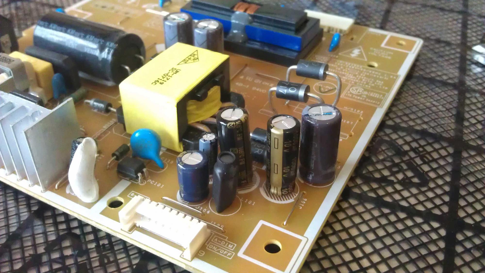

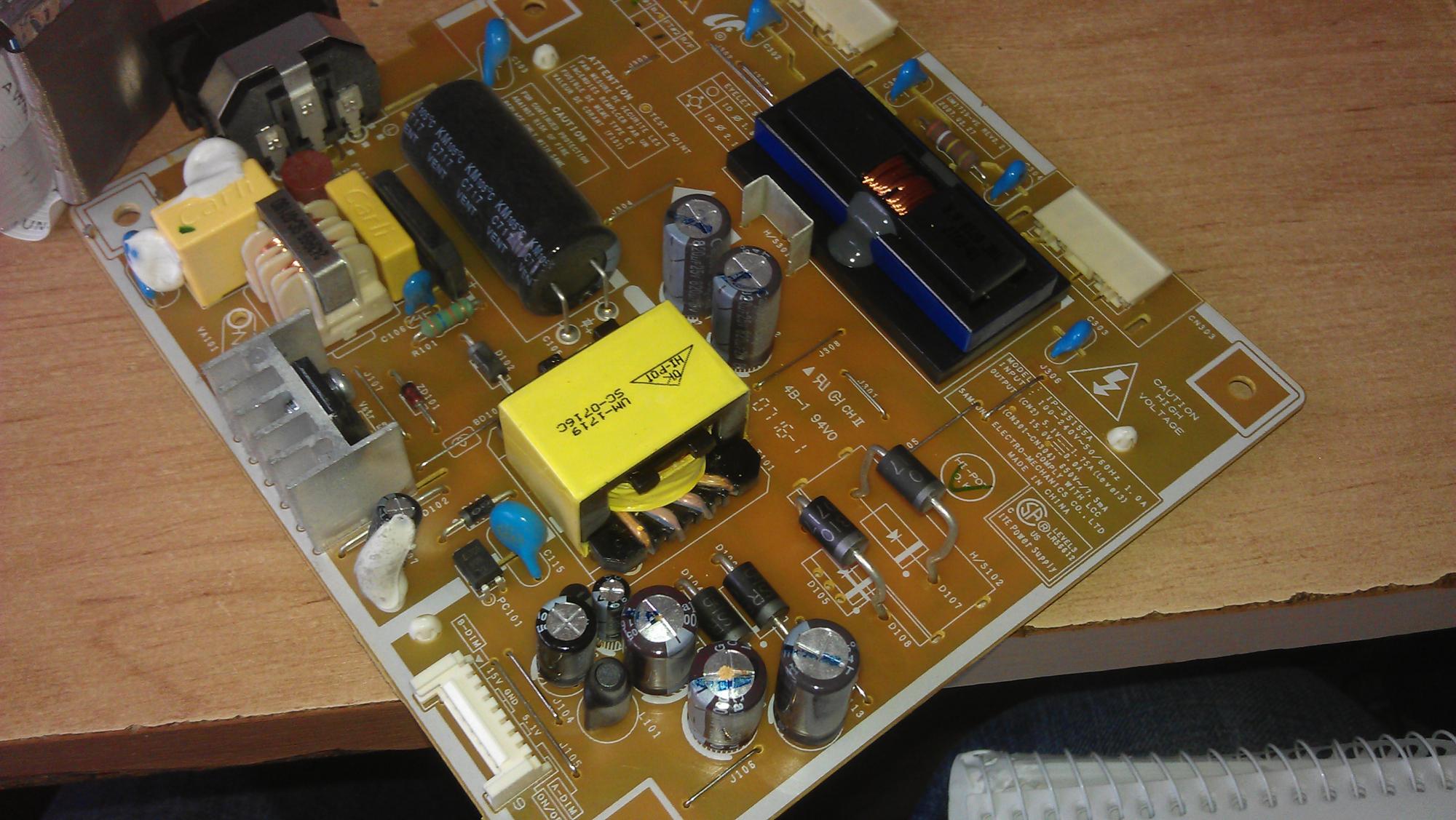

    Hi Guys,
    First off let me say this is a brilliant website. I dabble in PC repairs and this has been a wonderful source of information at times with regards to the "capacitor plague".
    Anyway, onto my issue. I have a Samsung 931BW monitor which is taking longer and longer before it displays any image (either on the DVI input or the VGA). This morning it took about 30 minutes before I could use it. The power light continues to blink and I can hear some high-pitched noise.
    The date of manufacture on the monitor in July 2007.

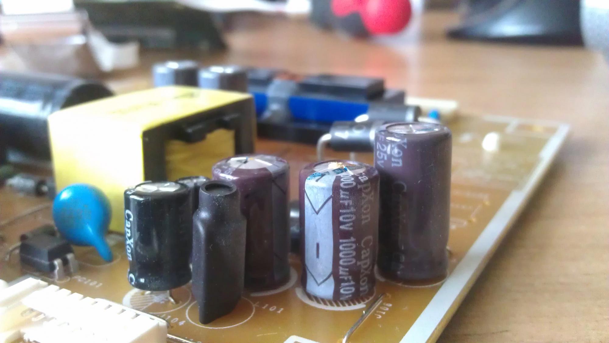

    I've just taken the monitor apart and found a couple of bulging CapXon capacitors (photos attached).
    I plan on swapping out as many of the CapXon capacitors as possible. I am aware of the H&S risks.
    Do you agree these could be the cause of the issue?
    If I do swap them out, what manufacturer should I choose (Rubycon / Panasonic)? The bulging caps are 1000uf 10V. Should these be replaced like for like, or can I go for 1000uf 16V? I'll be looking at caps that are good up to 105C.
    Thanks,

    Yes, bad caps are probably the reason for the long startup. With the exception of the large 450V cap, replace ALL the Capxon caps as ones that are not bulged can still be bad.
    You can use Panasonic series FC/FM/FR, or Rubycon ZL/ZLH series for replacements.
    You can increase to 16V, but the caps may be physically larger and may not fit correctly if the caps are clustered closely together.

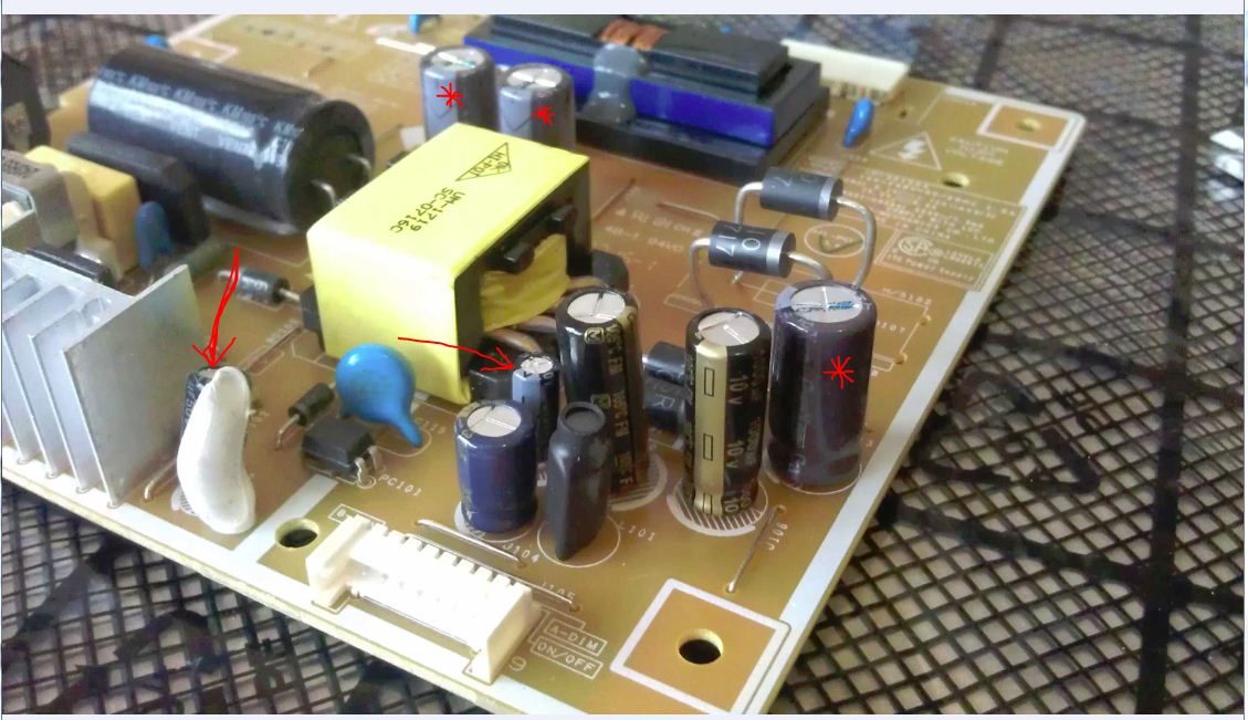

                    Just to let you know I replaced the caps (330uf 10V & 1000uf 10V) yesterday. Put the board back in the monitor and it worked!
                    The 820uf 25V caps will be replaced later this week - RS didn't have them in the required height (20mm) when I ordered the others.
                    Photo attached of the new caps (Panasonic).

                      Good work! In many cases, it's usually the 820's that are the first to fail. You can go higher height wise as long as it clears the steel cover that fits over the power supply.

                          There are two other small electrolytic caps visible in those photos. Replace those also, and others elsewhere on the board.

                            If you mean the two I've highlighted with arrows, then yes these will get done when I replace the 820's next week (highlighted with a *).
