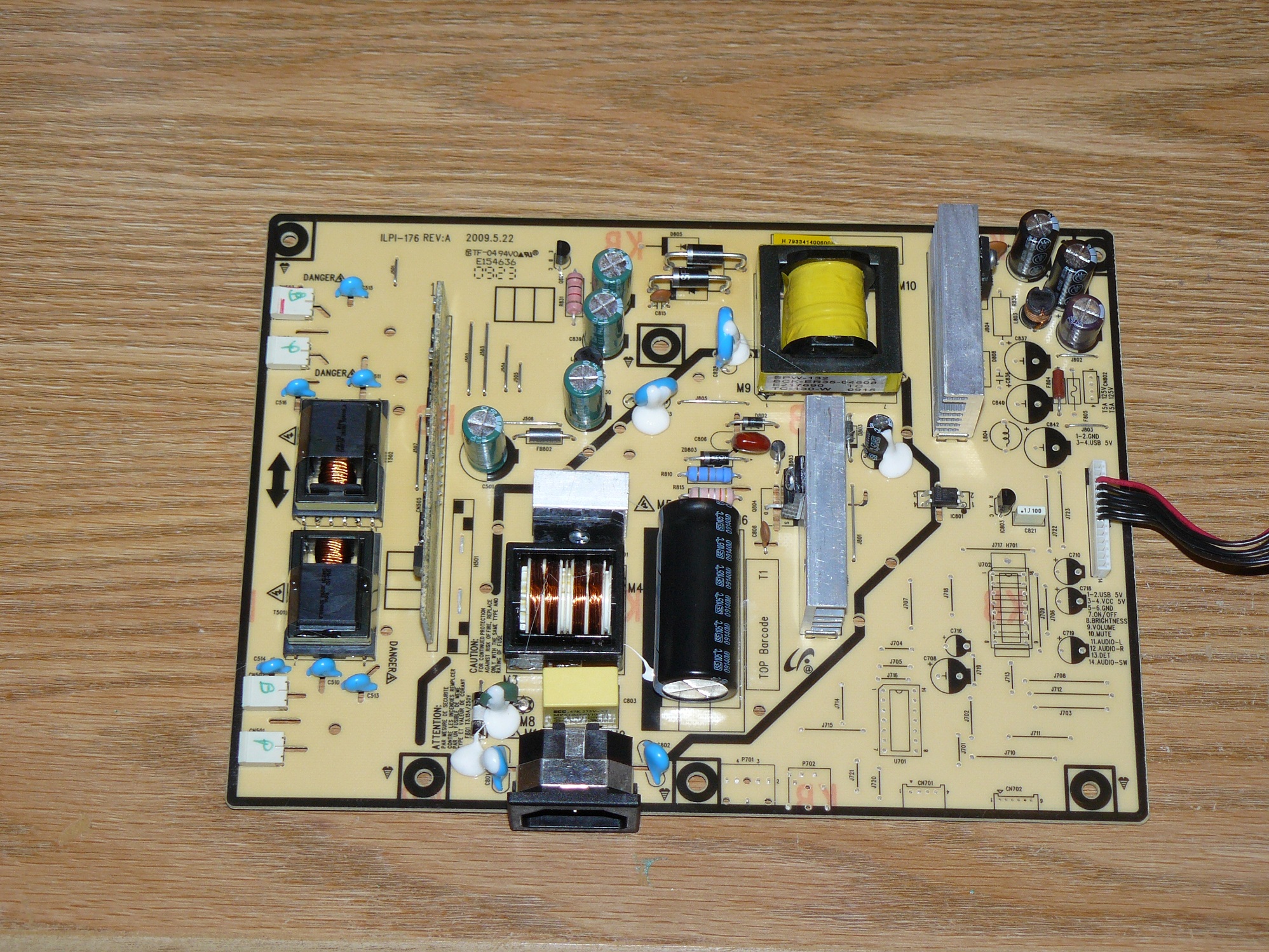

    The caps on the power supply are a mixed bag of :
    Su'scon SG & SH series
    Samxon GK series
    Lelon RZD series

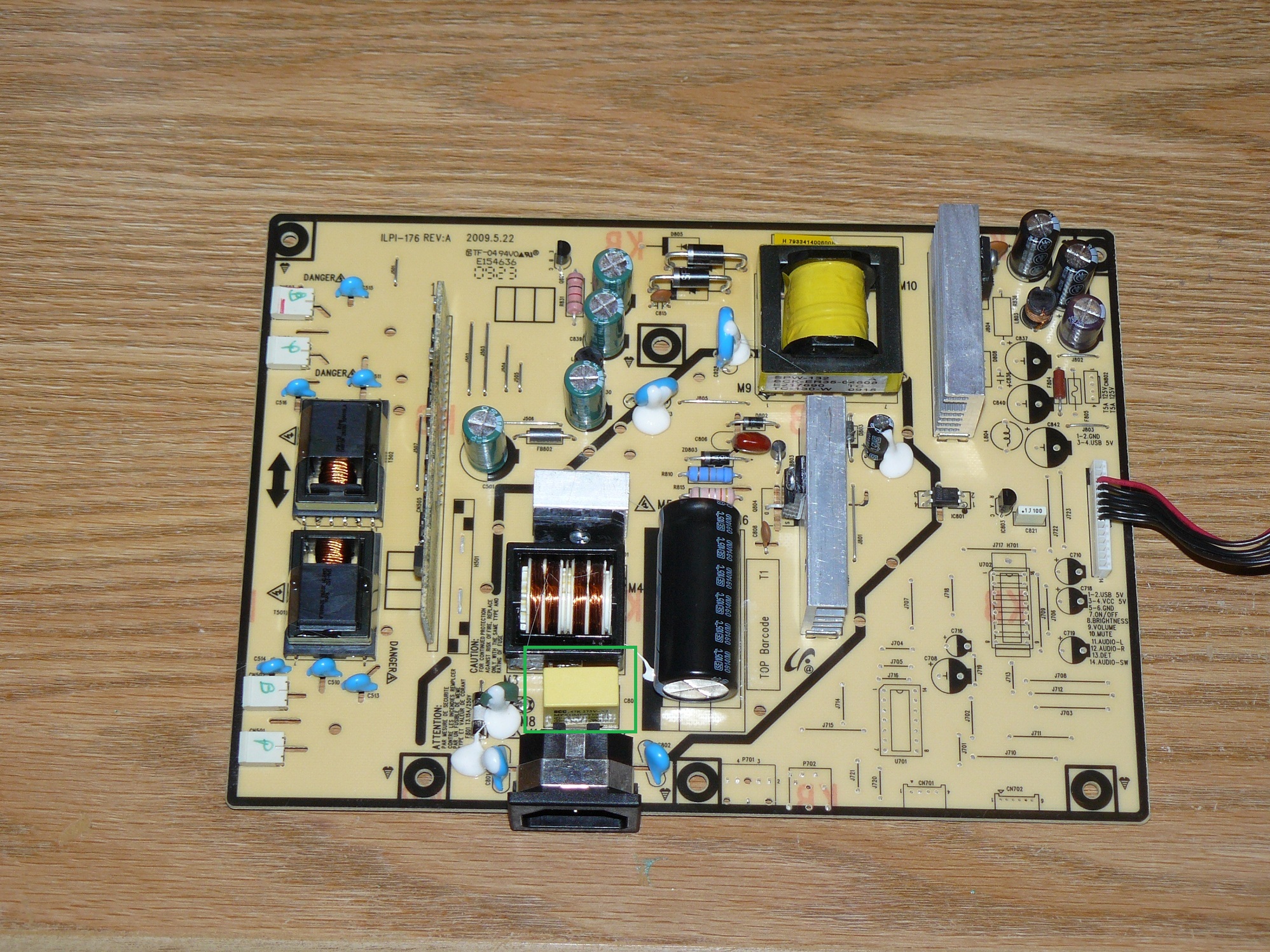

      Is the filter cap the yellow box directly behind the power outlet? If it is, i'm only getting 72.5 - 74.6 with the monitor on (hooked up to test computer)and its doing its usual backlight on/off. I'm also only getting 153.9 - 159.9 on the large capacitor. Is it not suppossed to be higher when the power supply is hooked up and working (showing a picture)? In the 400 volt range? The filter cap is a 275v btw.
        Re: Samsung Syncmaster 2333SW Flickering
        I referred to the filter caps on the logic board. There should be a bunch of DC filter caps on the logic board.
        That yellow cap is on the hot side (LINE VOLTAGE) it should have 120Vac on its two legs, be careful on the hot side of the board!
        I f the AC feeding the monitor is 120vAC, then the DC on that cap should be 120 x 1.414 = 169VDC.

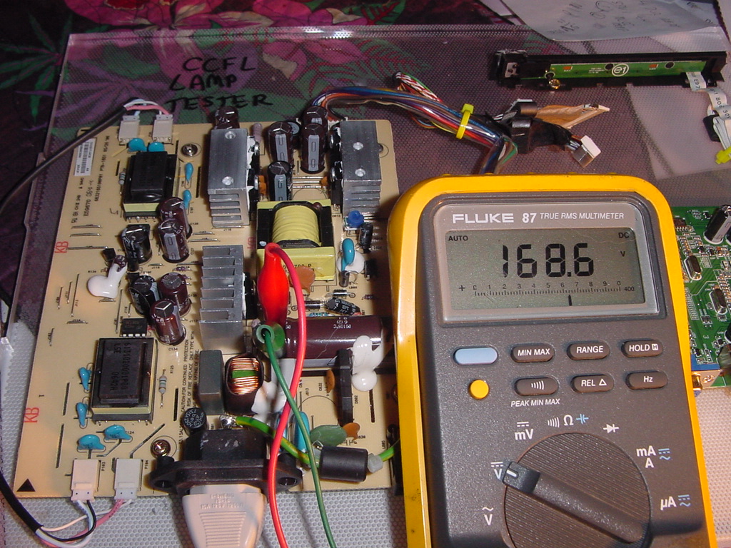

            If the large electrolytic (lying on its side) filter cap is 275V, then it implies there is no PFC involved. PFC can boost the voltage to greater than 300V DC which means the large filter cap should be 400V or higher.
            If you are getting fluctuating voltage of 153.9 to 159.9V DC, then the large filter cap could be bad without bloating. It should be a solid 170V DC if your AC is 120V AC. On the mega Samsung 245BW thread a fluctuating large filter cap was responsible for flickering on the screen as found by user Aruba.
            edit: You can measure the DC voltage on the bridge rectifier to see if the voltage is stable or not.
              The 275 is the yellow cap i put a square around.
              If you are getting fluctuating voltage of 153.9 to 159.9V DC, then the large filter cap could be bad without bloating. It should be a solid 170V DC if your AC is 120V AC. On the mega Samsung 245BW thread a fluctuating large filter cap was responsible for flickering on the screen as found by user Aruba..
              Its not bouncing around but more 153 with the backlight on and 159.9 backlight off. Its almost like the backlight is pulling the voltage down from load. I did try to read the mega thread but never made it that far (my eyes and brain weren't cooperating )
              I checked the bridge rectifier and i'm getting the same result as the large cap, 153 backlight on and 159 backlight off.
              There is what looks like a couple voltage regulators by the inverter transformers. I haven't googled the numbers on them to see and i also haven't checked the voltages on them yet.
                Put your meter in AC volt mode and take a reading of the voltage on that large cap again, I want to know what the AC ripple is on that cap.
                          What Iam trying to find out is the AC voltage on that large DC main filter cap in the hot side of the power supply, so when you put the meter on AC mode, then put the two probes of the meter on the two legs of that large cap, it should show some AC reading since the rectified DC will not be PURE DC, it will always have some AC component riding on top of the DC voltage. Using the true RMS meter, I do not expect the AC value to be more than 5~10% of the DC reading with load, see the pictures.
                          AS you can see, when the monitor is not on (but still plugged into the outlet) you can see that the AC ripple is in millivolt range, and less than 5% when the monitor is on with the lamps lit.
                          This test will not work on the DC side of the switching power supply since most DMM cannot read AC with anything higher than 10KHz, most are made for AC 60Hz reading.
                          I use this in the field when I do not have a scope handy with me.

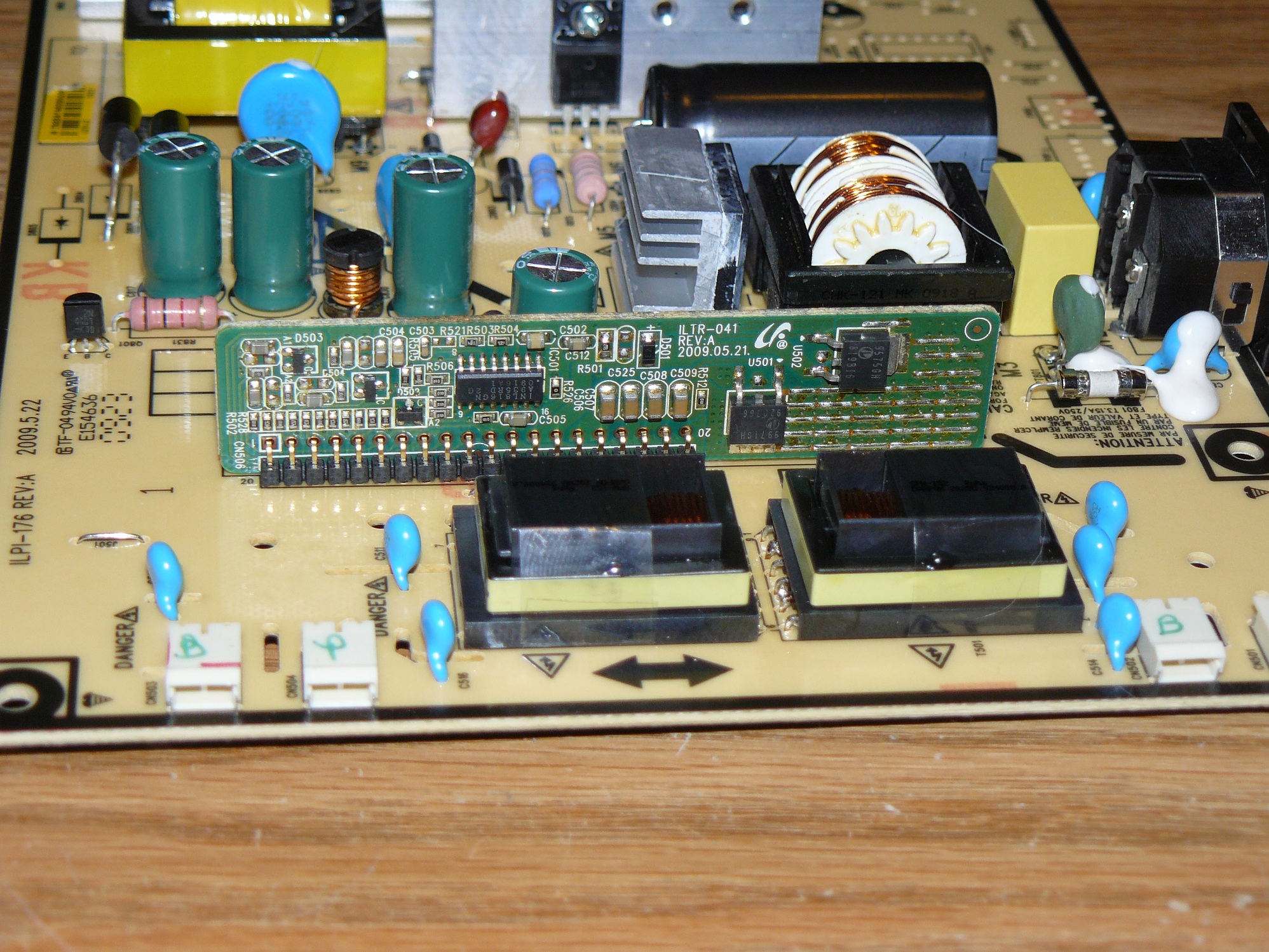

                            My meter doesn't have an ac millivolt function. I recapped the entire power supply including the big one and the backlights now stay on solid but i'm not getting an image in regular windows. If i use the keyboard and shut the computer down blindly i get a brief flash of the shutdown screen. If i restart the computer in safe mode i can get an image but it is grainy at the bottom around the task bar but the grainy image comes and goes. I'm thinking it has to be something in the mainboard now but i don't know which direction to go other than finding a used good ebay board.

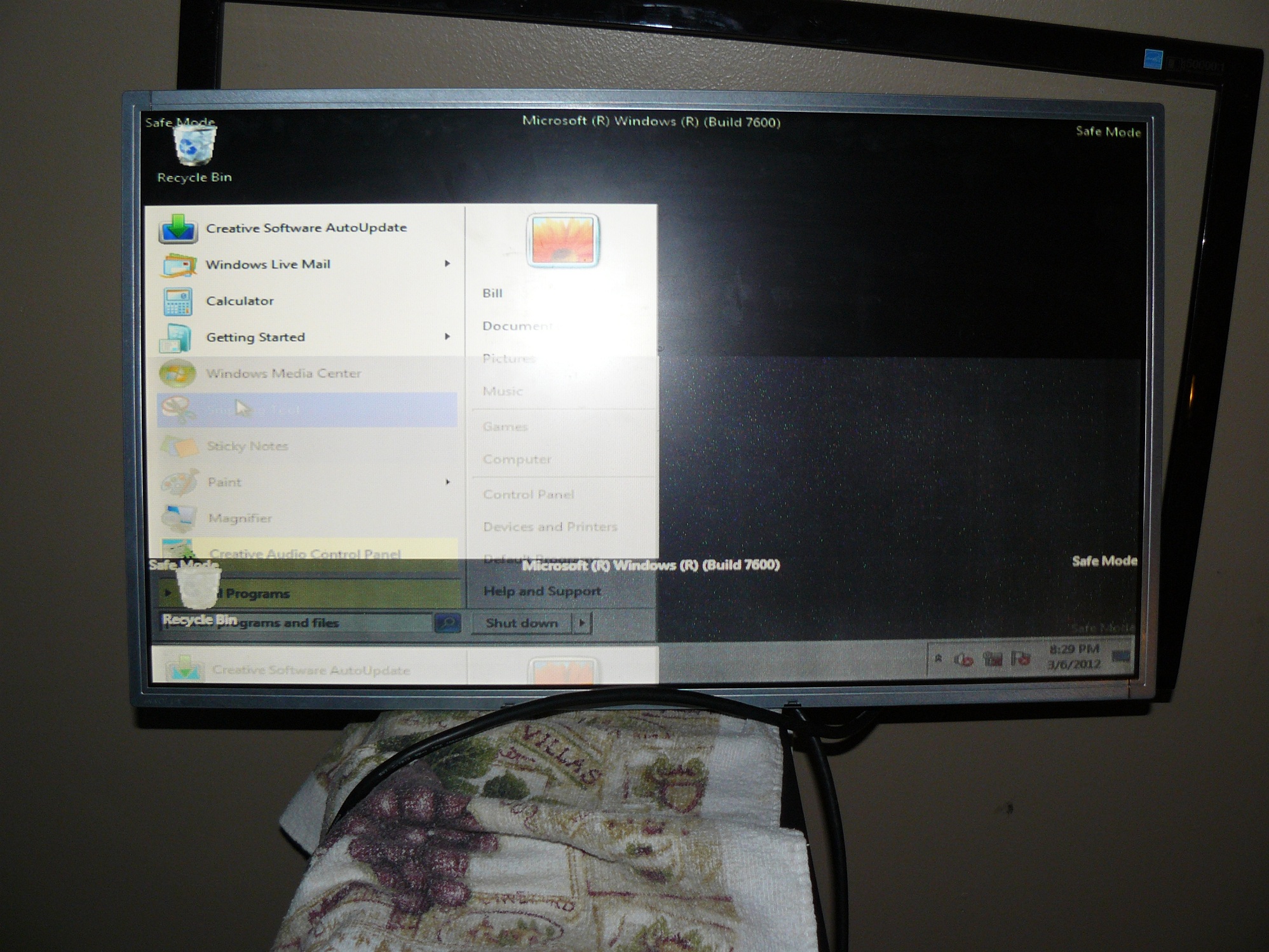

                                      I finally did get the monitor to display an image in windows (not safe mode). There are some random sparklies that come and go and i can also see some horizontal noise flashing randomly. When the screen saver kicks in it is really slow. So now it maybe something in the tcon.

                                        I uploaded a you tube video for what it is doing. When the screen washes out is when i move the mouse for the screen saver to stop and the desktop to appear. What i'm wondering if it seems like a main board issue or the tcon.
                                        http://www.youtube.com/watch?v=nTGtaLpefmA
