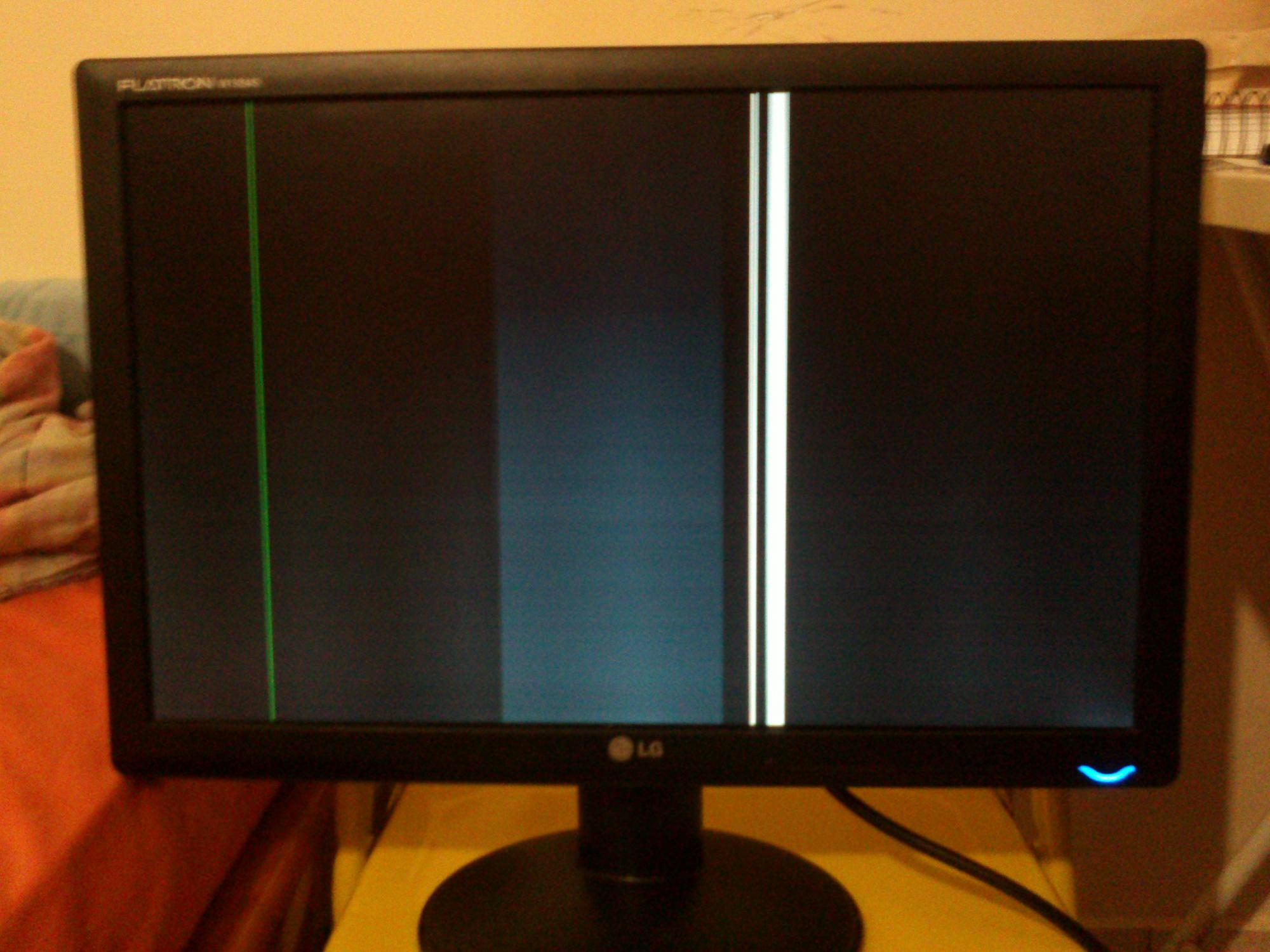

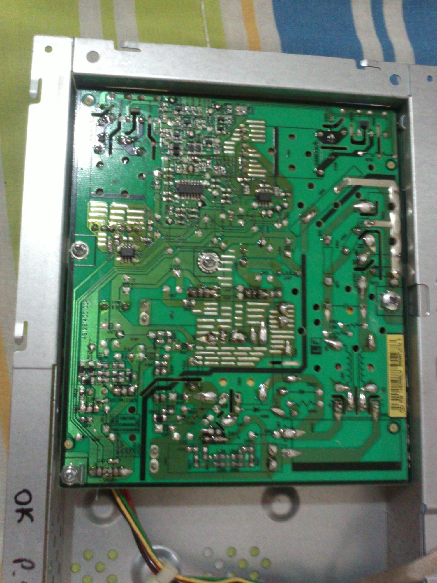

    Hello guys!
    I need a little help here...

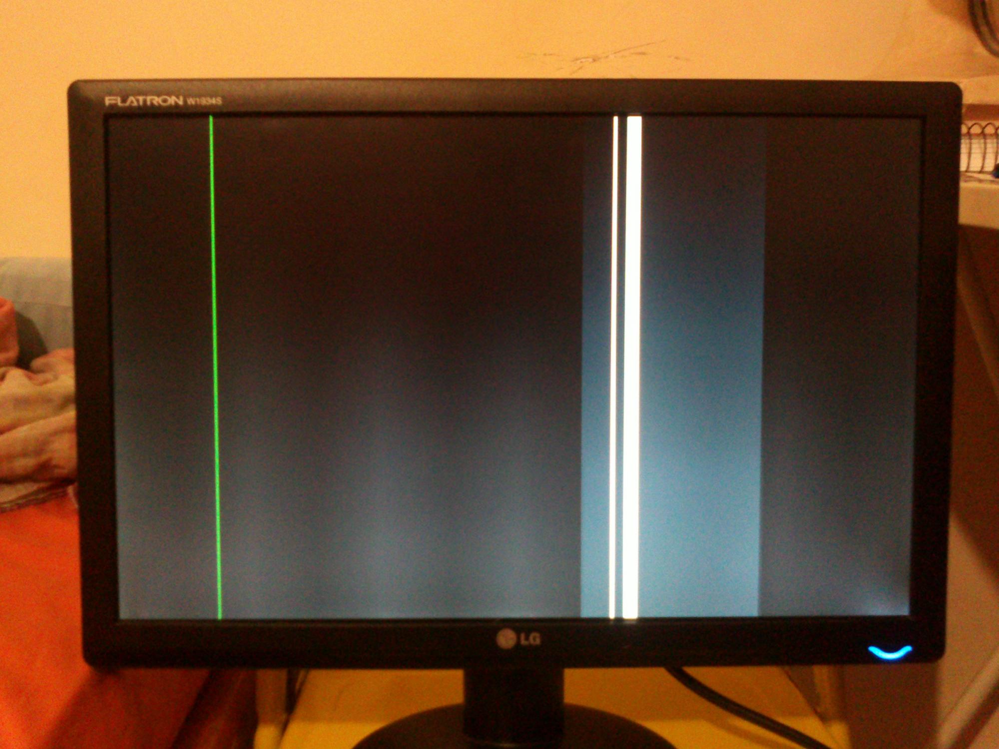

    Got this display from a friend of mine, because it wasn't working anymore, he was experiencing the "2 seconds to black" error so he bought a new LED display.
    When I got home with the monitor and opened it to see what could be the cause of the problem. Of course couldn't see anything, totally newbie here.
    After closing the case and testing it I got the same trouble but had another one, the display was totally white with two stripes in the right. One of them is thin, the other one a little bit bigger.
    The display gets brighter two seconds but then it goes darker, but I still can see the stripes!
    So, what can I do to fix these problems?
    Thank you!
    ps: I'm gonna attach a picture I took from the display.

    There are multiple flat ribbon cable that run across the top of the LCD panel. You probably damaged some of them when you either took the cover off or when you were putting it back on, which is what is causing the 2 verticle strips. This damage is not repairable.
      Re: LG Flatron W1934S
      All I can do is throw it away?
        You could still try and get it working and put up with the stripes. Or if you have an interest in repairing monitors it is one to practice on.
        If you want to try take it to bits again and post clear pictures of the
        front and back of the logic board and the power board - try not to pull
        on cables to the panel and dont press on the back of the panel where the
        ribbon cable attaches. Do you have a soldering iron and a multimeter.

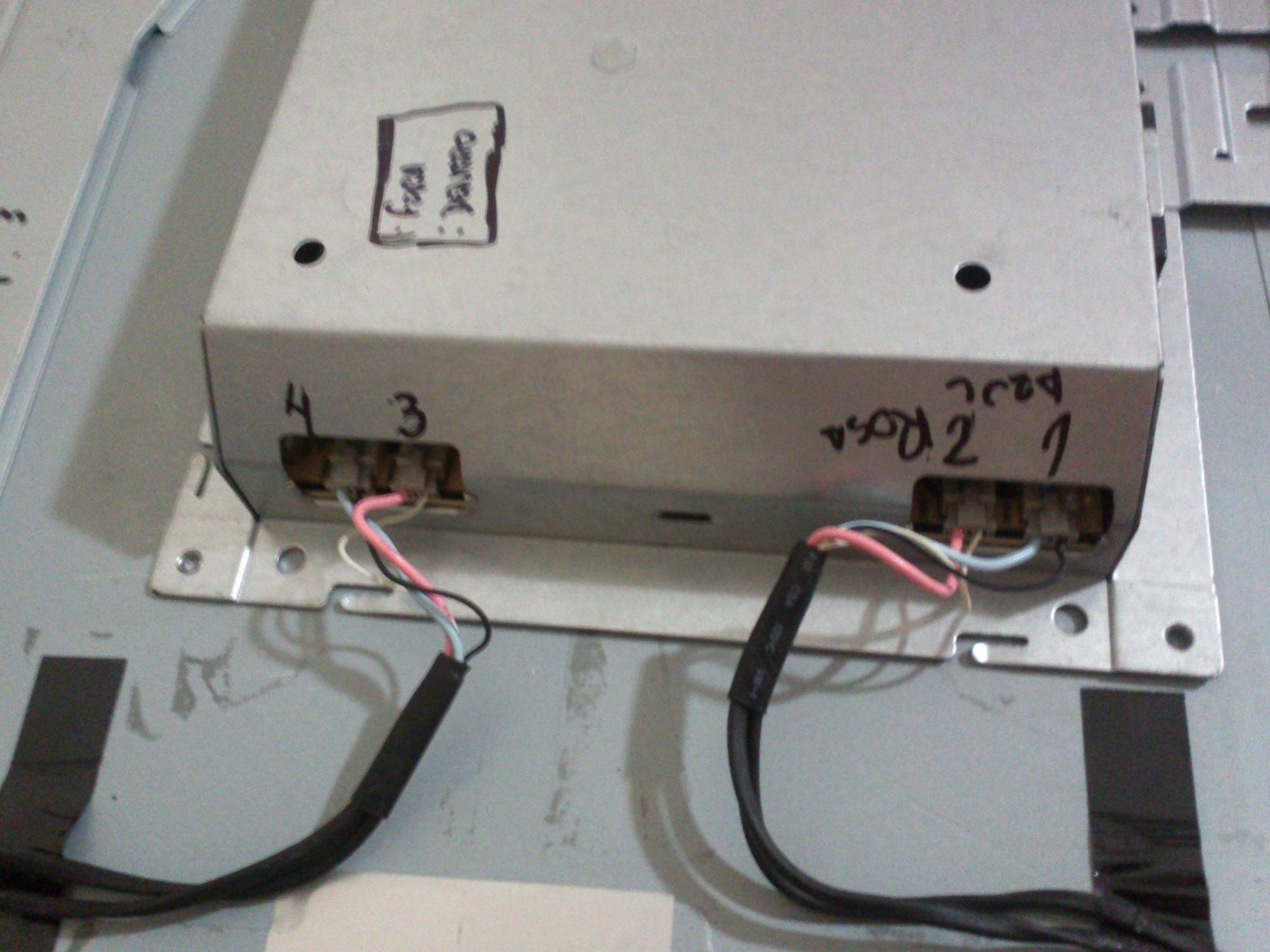

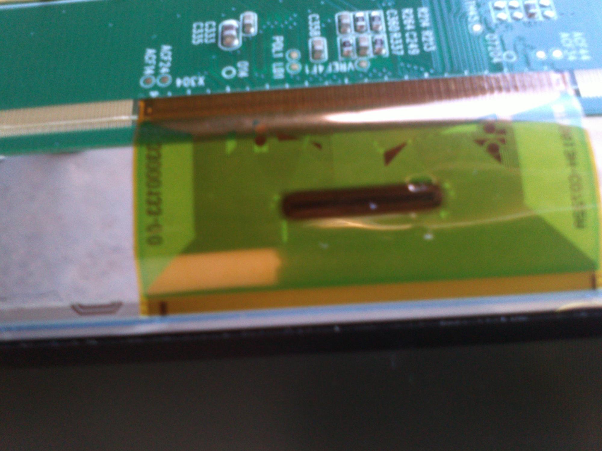

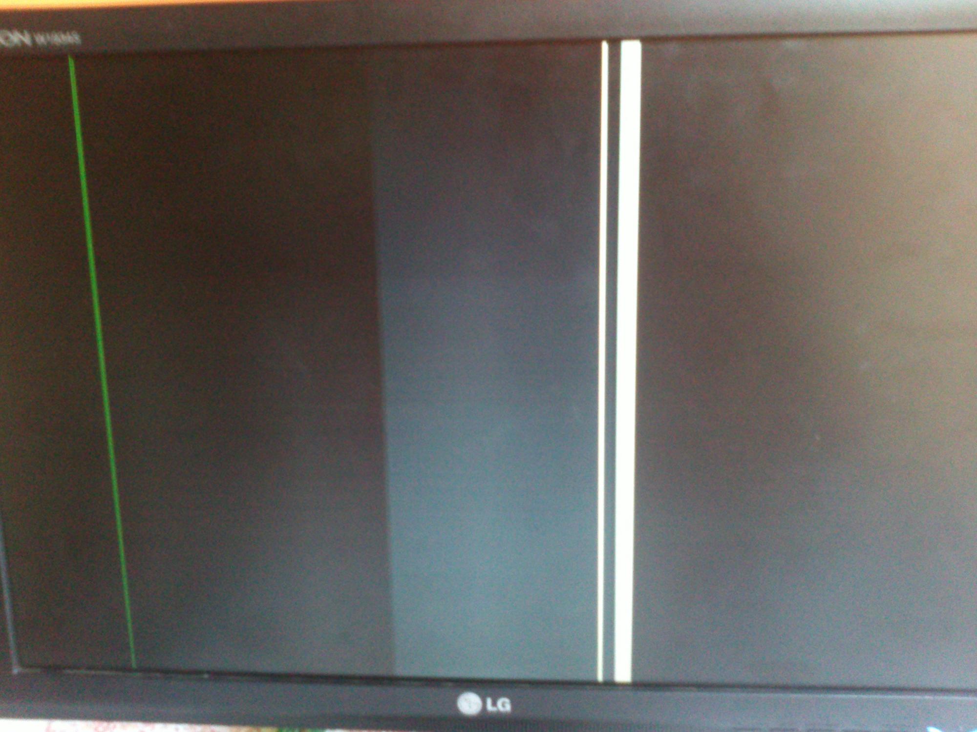

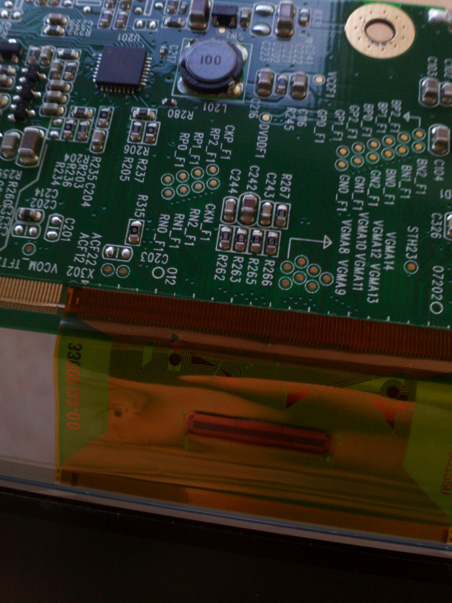

          Took some other pictures, I just dissassembled it to take a look at the ribbon cables, looks like I damaged two of them :/
          Oh, when I assembled it back I got another screen... no white screen any more, now it's black with other colors.
          Attached pictures follow.

            Hi this is going to be difficult if not to say impossible!! especially as we dont know if the damage already done to the panel/cable will prevent it from displaying.
            I will give you some ideas of what to do and what you need then you can start over or try and sell for parts.
            First if you click on "Search" in the bar above and enter W1934S. it will give you a list of threads on this forum relating to this monitor.
            If you read them it will show you what pictures are needed and what tests you can do- Remember you are dealing with Lethal Voltages here so extreme care required. There is probably enough info within them to get the set going as far as it is able but you can always come back for clarification on what you dont understand.
            When you took the picture with the black screen white and green stripe did you have a source connected- eg computer
            Multimeter = http://www.ebay.co.uk/itm/New-LCD-Di...item3a6e4b842e
            As an example this is the cheapest on ebay but they dont post to Brazil. It is cheap and not really recommended but obviously better than nothing. You may know it as a voltmeter. You will need to measure Resistance and Voltage as a bare minimum.

              I suppose the first error I got with this monitor was "2 seconds to black"... After reading a little I did know that it was a malfunction in one of the lamps. Maybe a problem with the solding... I think I can handle it, it is basic.
              But after a deep look I could see that my ribbon cables were damaged... probably it was my fault, when closing the case. And, as said here, I think it is impossible to fix that, unless I buy other display and install it is the old case, so this would fix my two issues.
              Also, I connected the monitor to my computer and the screen had the same look... black with some stripes.
              Now, what do I do? Buy other monitor or just replace the screen?

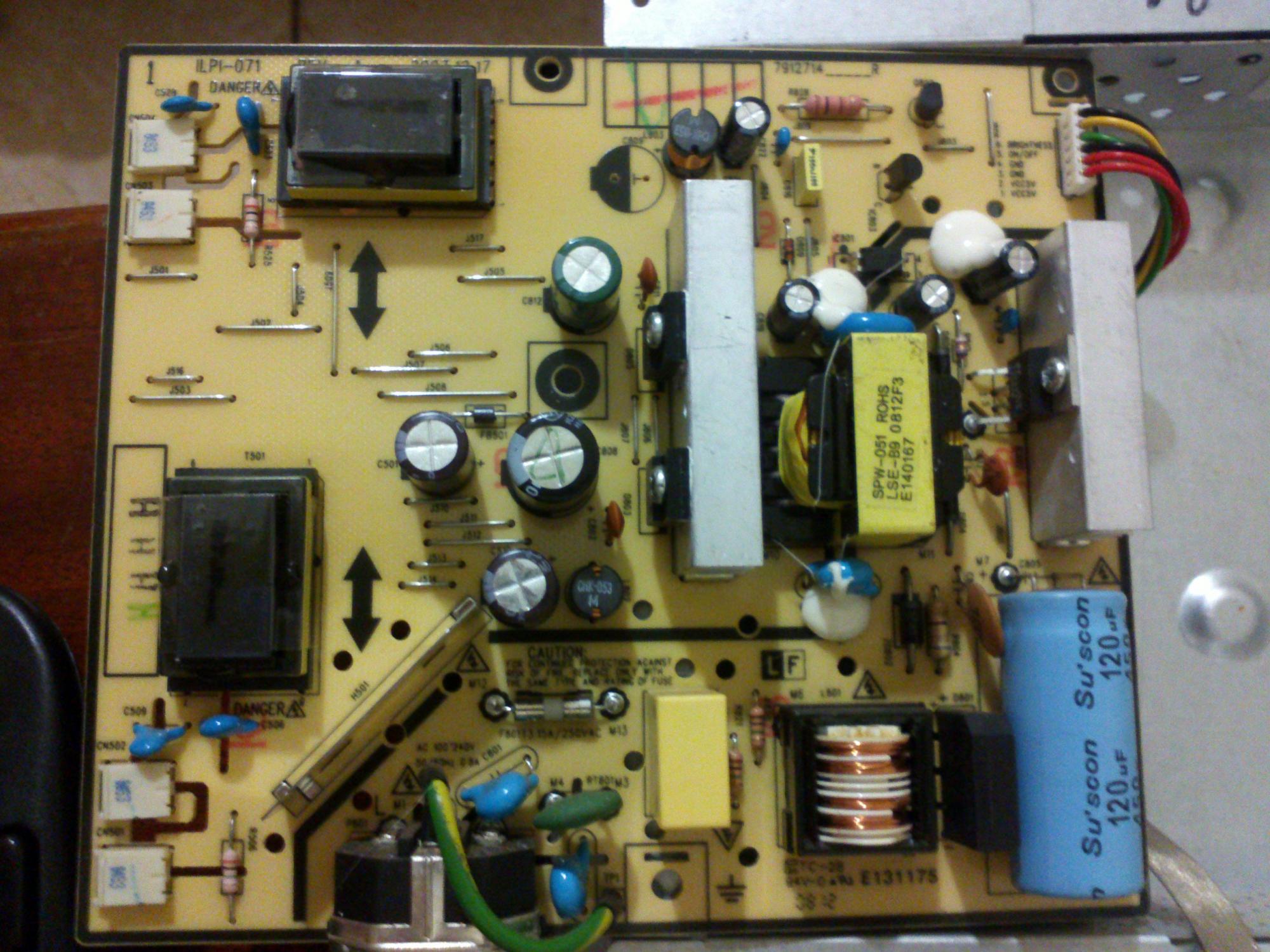

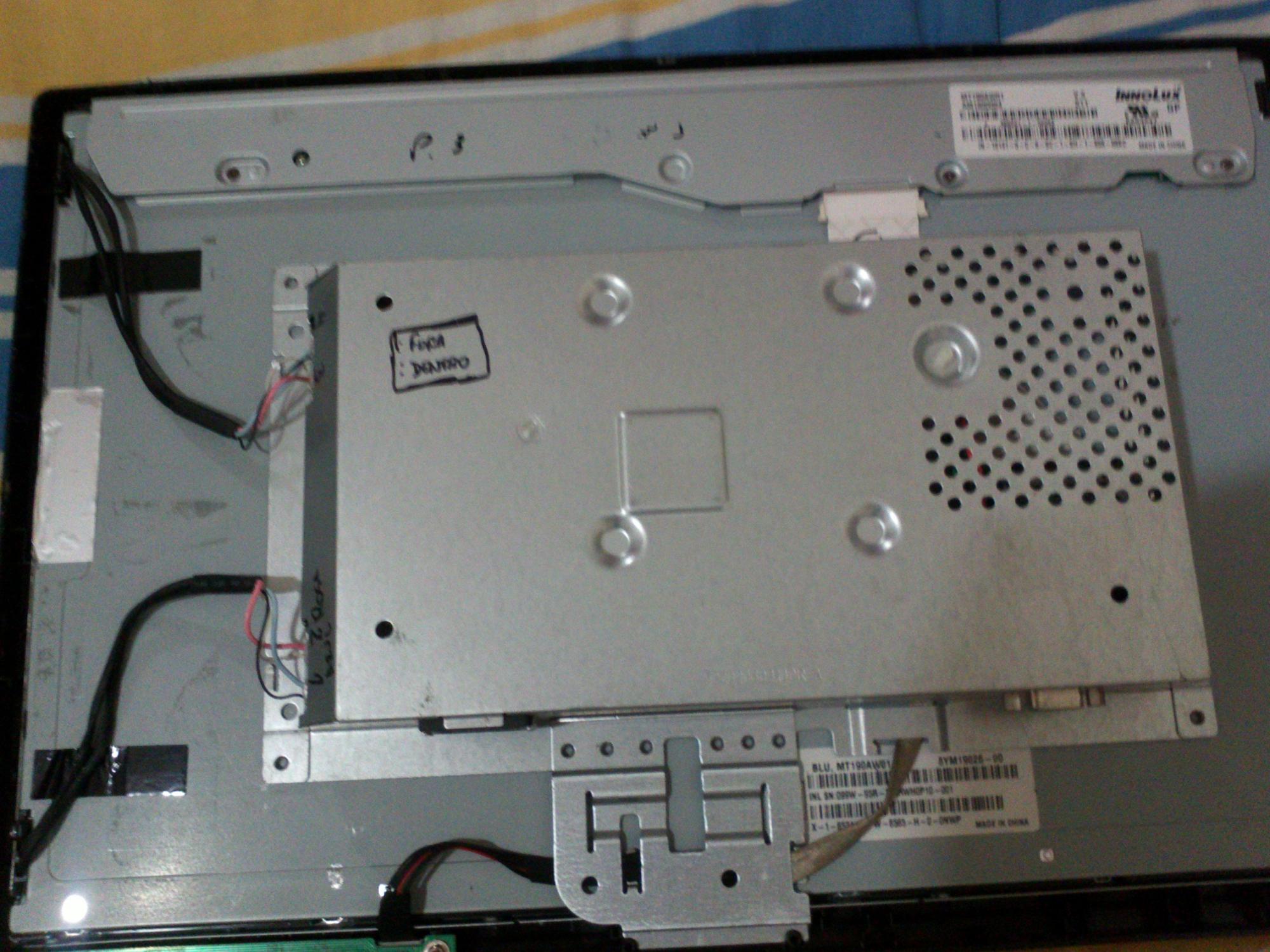

                        Took some pictures of my monitor, boards and stuff, take a look and tell me what you see!
                        It's a shame I can't replace the screen with these other models, since I couldn't find the model MT190AW01 for sell online in brazilian stores...
                        I'll run some tests later and post pictures here, too!

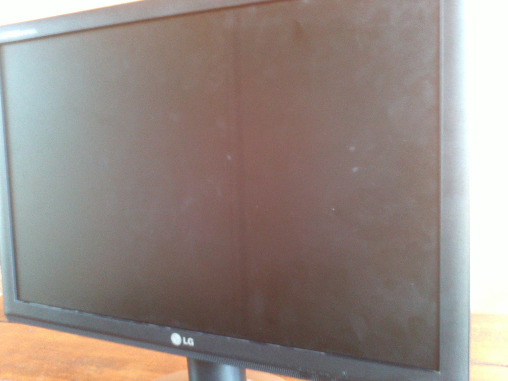

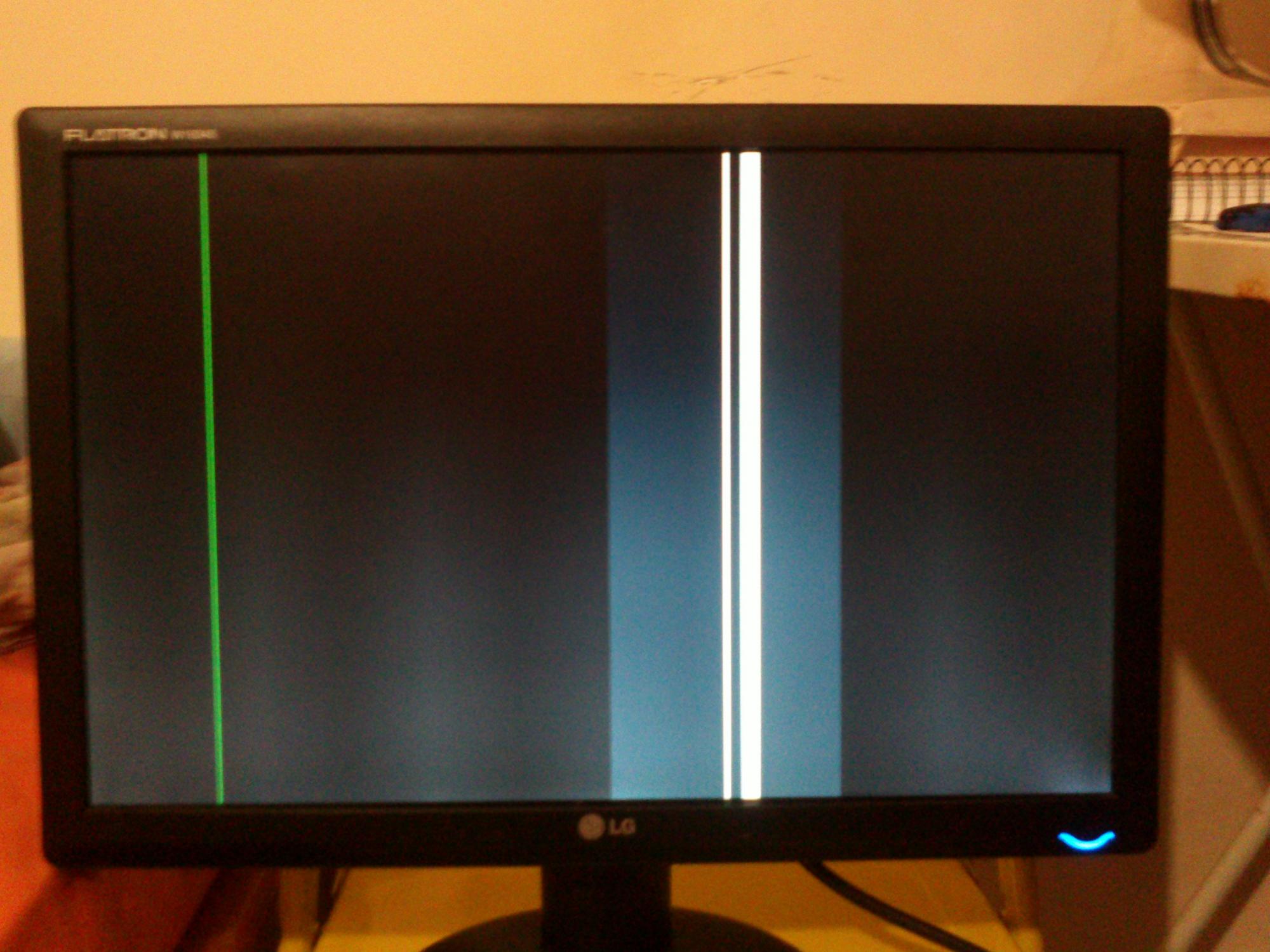

                          First of all, sorry for double post, but I couldn't find the "edit" button... I may be very tired.

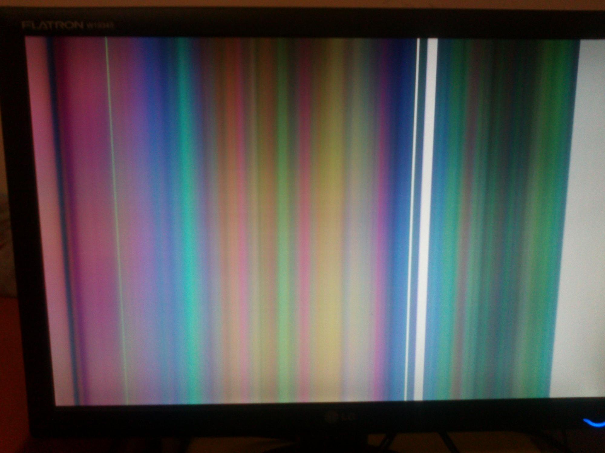

                          Anyway... Did a test right now with the monitor. I can say it surprised me, I'll tell you why...
                          A while ago I opened it to take pictures of the board to post here, left it open and went to web. I assembled it, turned on and realized that there is one stripe that moves vertically in my screen, geezz, that's something, it has to be a light!
                          Also the screen had a different behavior this time. It was black after two seconds, but after a while it turned on again and was gone only 40 seconds later... Before it didn't stand 5 seconds at all!
                          Took some pictures of the screen for you to notice the vertically moving stripe (if you know what causes it, don't know, if it's good or bad... whatever, tell me! )

                            The photos of the boards are not really clear enough. In particular we need to be able to see the back of the board clear enough to see the black numbers. There has been some soldering done do you know what that was for? Not much more can be suggested until you can get use of a multimeter. Something else that would be of use would be another panel- doesnt have to be working apart from a backlight ccfl. Blue moving stripe - not a clue - "if its movin it aint dead" "a very cold giraffe going past a window at night"
                            Did you try this yet:Set up your pc with a vivid picture you can easily recognise then hook it up to this monitor -when the screen goes black can you see the computer image by shining a flashlight on it.

                                Yes, I tried this, and that's what I got after puting this image on screen (attachment)

                                  Very Colourful - I suspect the panel is totally shot.
                                  I assume this was only on screen for less than a minute?
                                  Im still not sure if you have tried or understood the bit with the torch.
                                  Again I am presuming that within 1 minute the screen goes black all over?
                                  At that point the backlights have switched off because the monitor system has detected a fault - could be lots of things - ccfl- wiring - fuse- transistor.
                                  BUT your computer doesnt know that there is a fault and continues to send the picture.
                                  IF the video part of your monitor is still working it transmits this picture to the panel.
                                  You cant see it because you can only see it if the screen is backlit, but it may still be there.
                                  By shining a torch or other light source onto the screen it is sometimes possible to
                                  see the image very faintly as the torch provides some lighting. It doesnt alway work
                                  and you can try different lights and different angles and with the room in darkness.

                                    It was on screen al the time it was on... then I had 2 sec to black, the same image came over again seconds later and last almos a minute on... then the screen went black again.
                                    I tried the trick with the torch...
                                    What I got was: when the screen went black I shined a torch to that and could see the image, very very very dark, but it didn't last long, I could only see this for 2 or 3 seconds, then the entire screen went dark...
                                    That's all I got.

                                      Totally shot = it will never work properly.
                                      How long is all the time it was on? 1 min, 5 min or what
                                      Hopefully you had the computer set to be always on ie not screen off after 1minute

                                        All the time it was on mean all the time the screen had some backlight on it... when it disappeared I turned off the monitor. Guess it last one minute.
                                        Should I leave it plugged longer?
                                        Yes, always on ie is set here...
