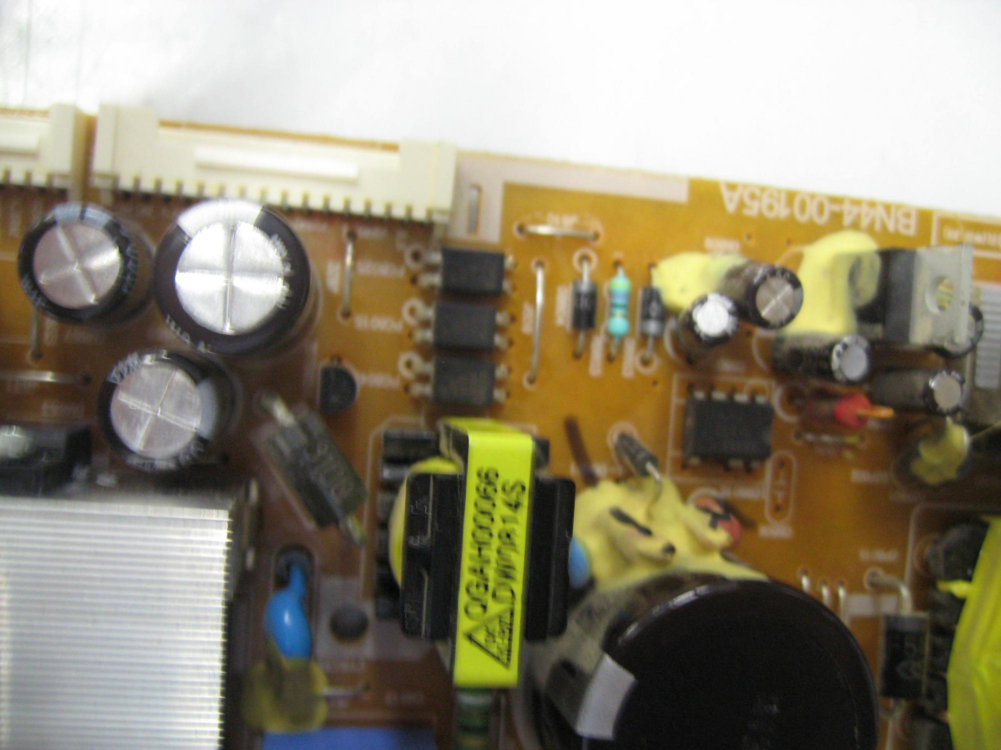

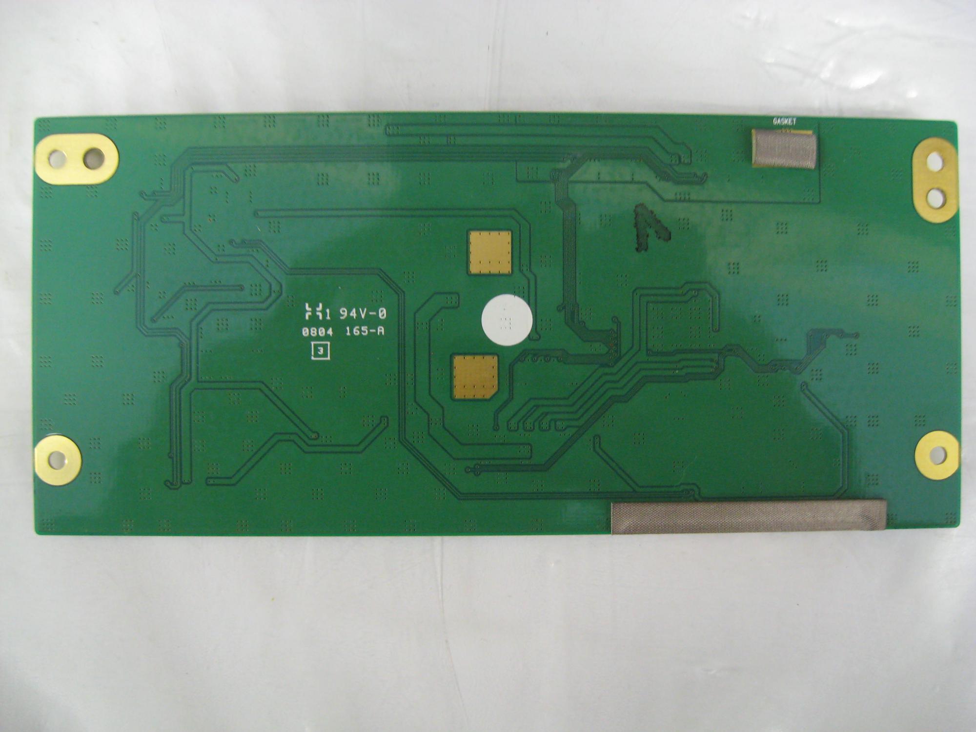

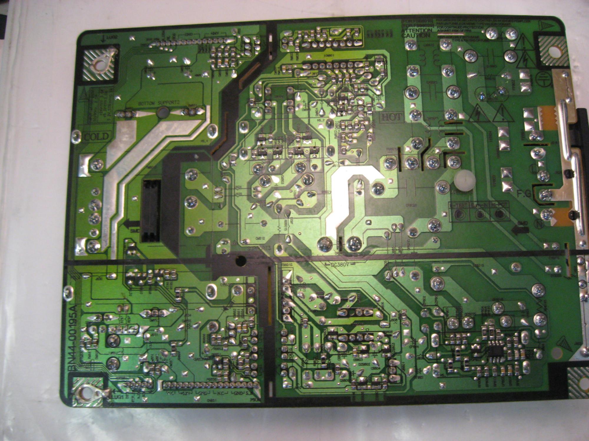

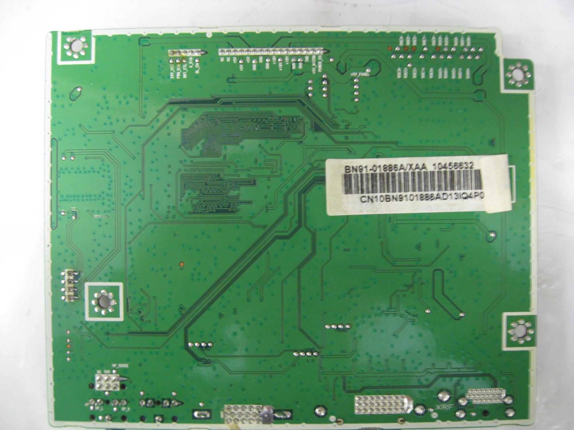

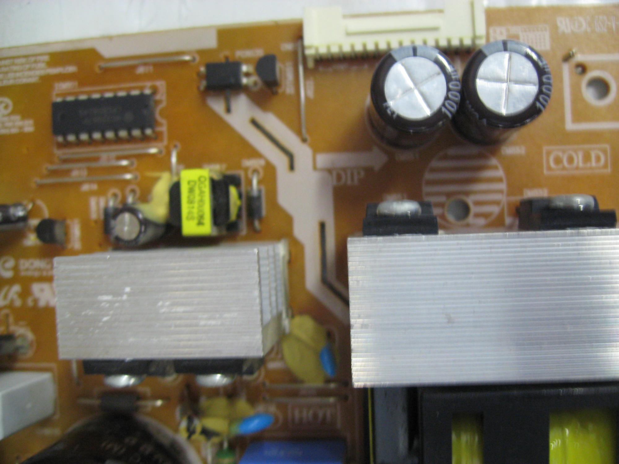

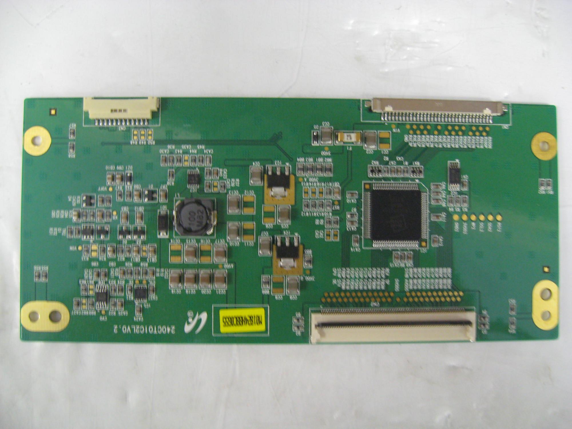

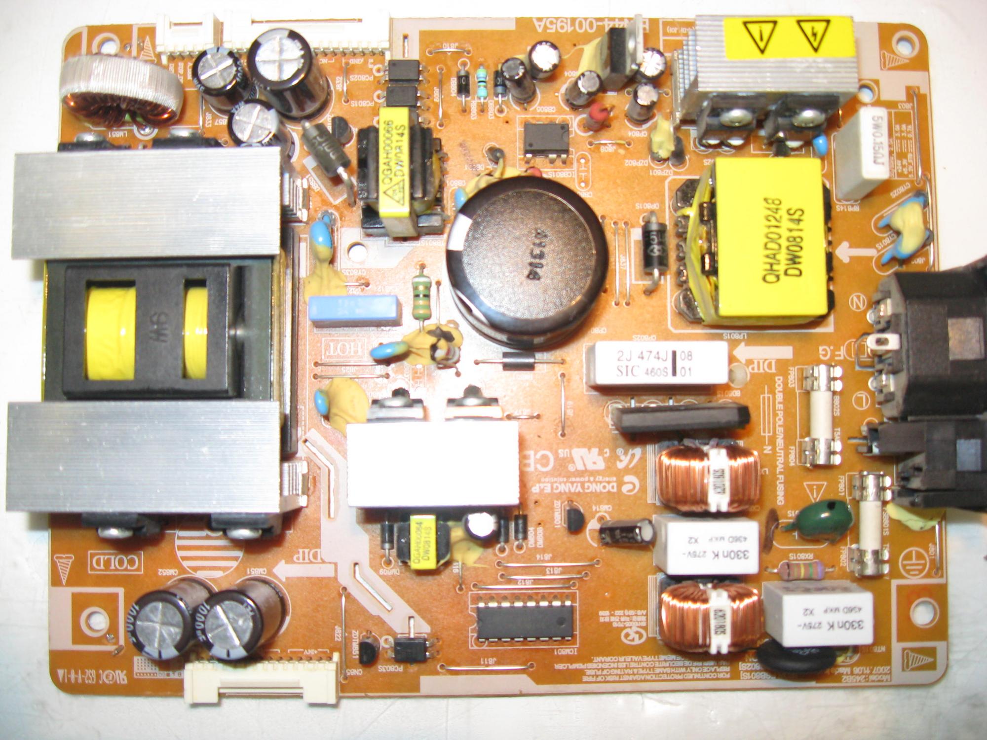

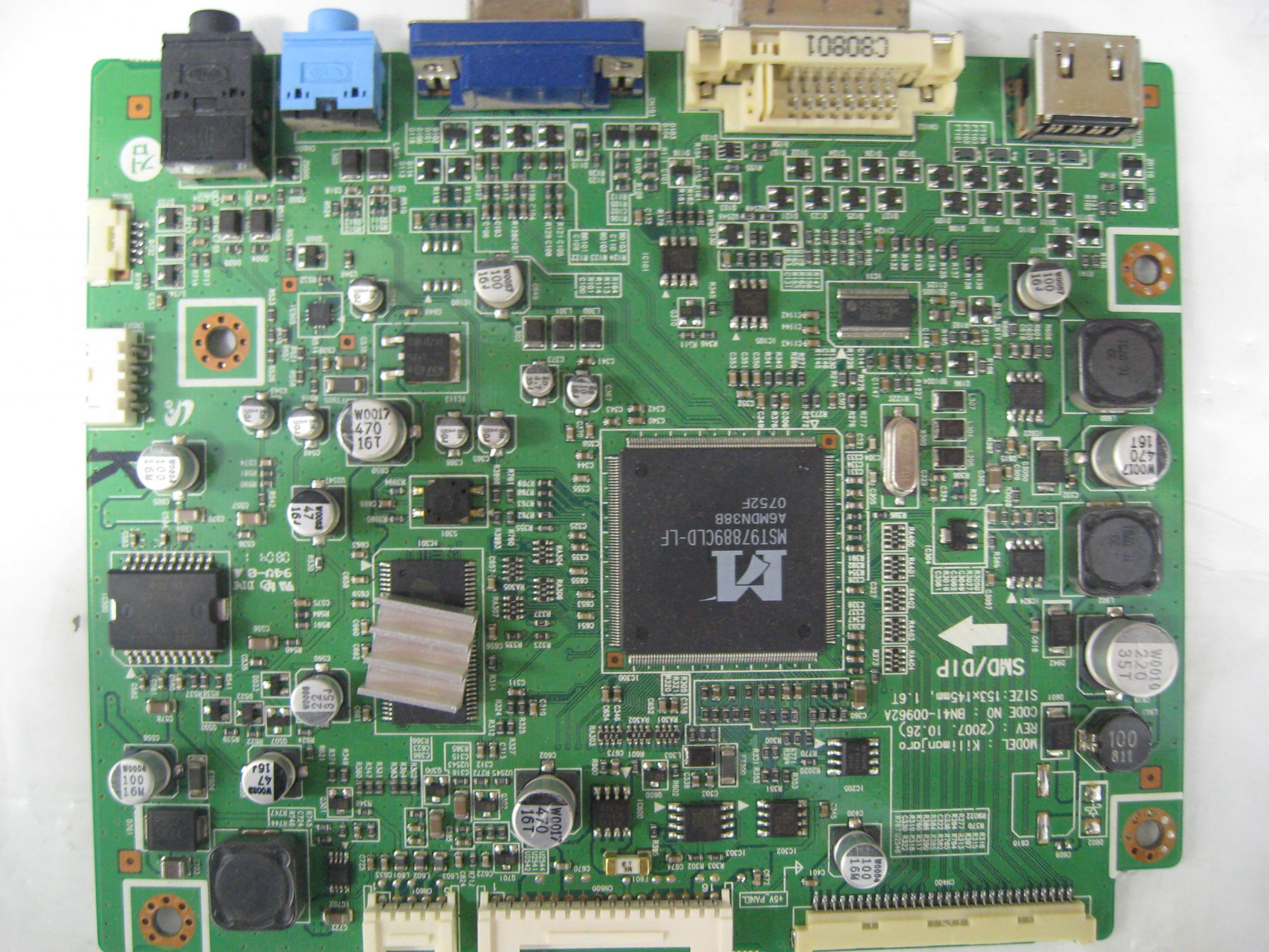

    Disconnect the main/logic board and see if you get stable 5V standby power first.
    Good focused top down pictures of all your boards help us help you. See my sig file below and follow the instructions exactly.
    --- begin sig file ---
    --- end sig file ---
      Re: Samsung 2493hm blue light blinking

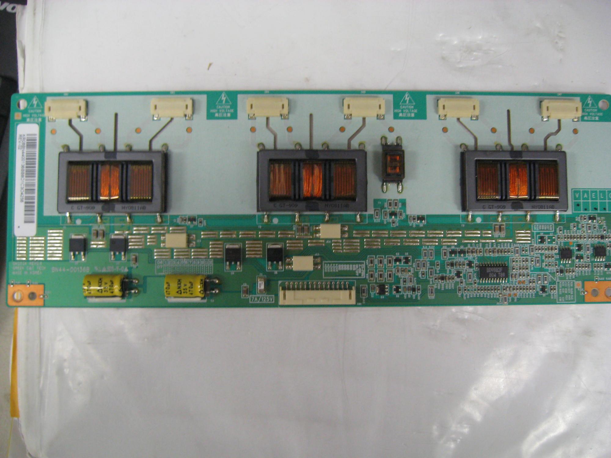

      ok so i was not able to test but will be able to later today
      here are the pics
        ok so i tested what i think is the right pin
        pic with arrow provided
        and i got a steady 5.22v

          Okay, reconnect the main board. Is the corresponding 5V standby pin on the main board steady at 5.22V DC?
            no it drops down to something around 4 volts then i also hear a shock like sound come from the power board synced with the voltage drop
              I can think of 2 possibilities although there could be more.
              1) The standby 5V is failing under normal load.
              2) Something on the main board is shorted and drawing too much current for the 5V standby rail to deliver.

                i believe its the first due to the strange noise coming from the power board but what should be done next im kinda new to this

                  Go to Radio Shack and buy the two-pack of #47 lamp 272-1110. Hook one between the 5V output and ground of the power supply. If the power supply puts out a steady 5 volts, the problem is the signal board.
