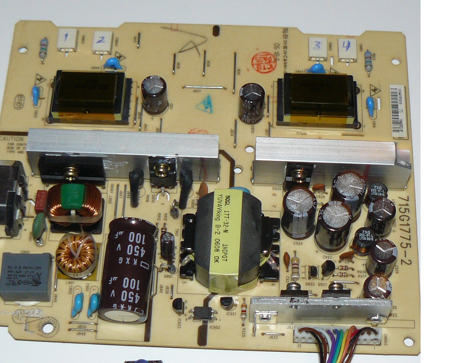

    Dell 1907FPc 2 seconds to black.
    I resoldered the 2 inverter transformers but it didn't help.
    The capacitors appear to be united chemicon ky series (kxg for the big one).
    Tested the fuses and they all check out ok
    Tested the Q900 mosfet and i'm not getting anything under 30ohms.
    Lastly i used a test monitor with a cracked screen but working ccfl's and i'm still getting 2 seconds to black.
    Is there anything else to check?

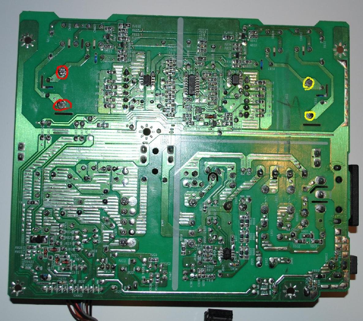

    Measure the resistance of the secondary transformers. One is circled in red and other in yellow (pins 7 and 8). Report both measurements. If they are good, they should be within 3% of each other.

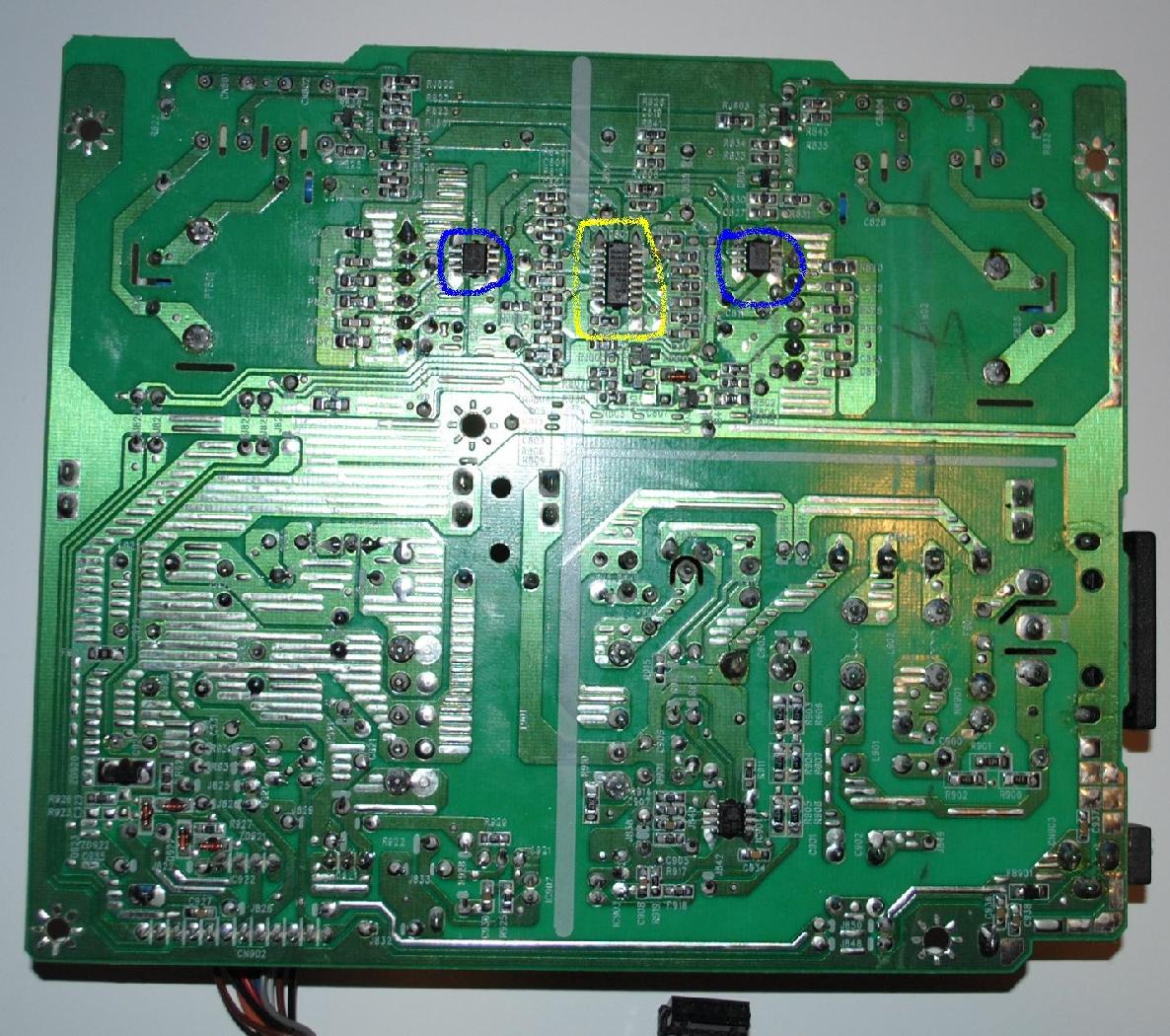

      The 2 mosfets in the inverter section are on the backside sandwiching the inverter pwm IC (Q801). Check those for shorts.

          The mosfets are circled in blue. The pwm IC is in yellow.
          What is the part number of Q801?

            Here are the readings for the mosfets circled in blue
            1-1 0L
            1-2 29.4 Kohm
            1-3 0L
            1-4 4.18 Mohm
            2-1 0L
            2-2 24.86 Mohm
            2-3 0L
            2-4 11.06 Mohm
            3-1 0L
            3-2 6.53 Mohm
            3-3 0L
            3-4 3.83 Mohm
            4-1 0L
            4-2 24.54 Kohm
            4-3 0L
            4-4 9.46 Mohm
            And the other.....
            1-1 0L
            1-2 24.17 Kohm
            1-3 0L
            1-4 12.16 Mohm
            2-1 0L
            2-2 8.85 Mohm
            2-3 0L
            2-4 6.45 Mohm
            3-1 0L
            3-2 4.91 Mohm
            3-3 0L
            3-4 23.24 Kohm
            4-1 0L
            4-2 12.87 Mohm
            4-3 0L
            4-4 9.38 Mohm

              The mosfets in blue might be 8 pin (hard to tell from the photo). Look at the part number and find its datasheet.
              Here is how I measure multipin mosfets for shorts.
              From
              https://www.badcaps.net/forum/showpo...4&postcount=19
              Some mosfets are more than 3 pins. To test those, identify the part number and search for its datasheet. Once you find the datasheet, the pins will be designated source (S), gate (G), and drain (D). It will probably be documented as S1, S2, G1, G2, D1, D2.
              Simply test
              a) black on pin S1- red on pin G1 - record ohms
              b) black on pin S1- red on pin D1 - record ohms
              c) black on pin G1- red on pin D1 - record ohms
              Repeat for the "2" pins. That is S2-G2, S2-D2, G2-D2.
              Note: a shorted mosfet would likely cause a very brief flash of the backlight or no backlight.
              Here is a case study.
              https://www.badcaps.net/forum/showthread.php?t=17659

                Sorry, I meant IC801 (on the back). It looks like a 16 pin IC.
                    The IC801 numbers are:
                    0Z9938GN
                    A627R2 3G
                    0614B
                    the 2 mosfet numbers are:
                    9945N
                    AAF60
                    Here are my readings
                    S1-G1 17.37 M ohm
                    S1-D1 3.67 K ohm
                    G1-D1 0L
                    S2-G2 17.42 M ohm
                    S2-D2 1.077 K ohm
                    G2-D2 0L
                    And the other one:
                    S1-G1 17.35 M ohm
                    S1-D1 1.070 K ohm
                    G1-D1 0L
                    S2-G2 17.23 M ohm
                    S2-D2 1.061 K ohm
                    G2-D2 0L
                    • retiredcaps
                      • Apr 2010
                      • 9271
                      Re: Dell 1907FPc 2 seconds to black
                      Your mosfets are good.

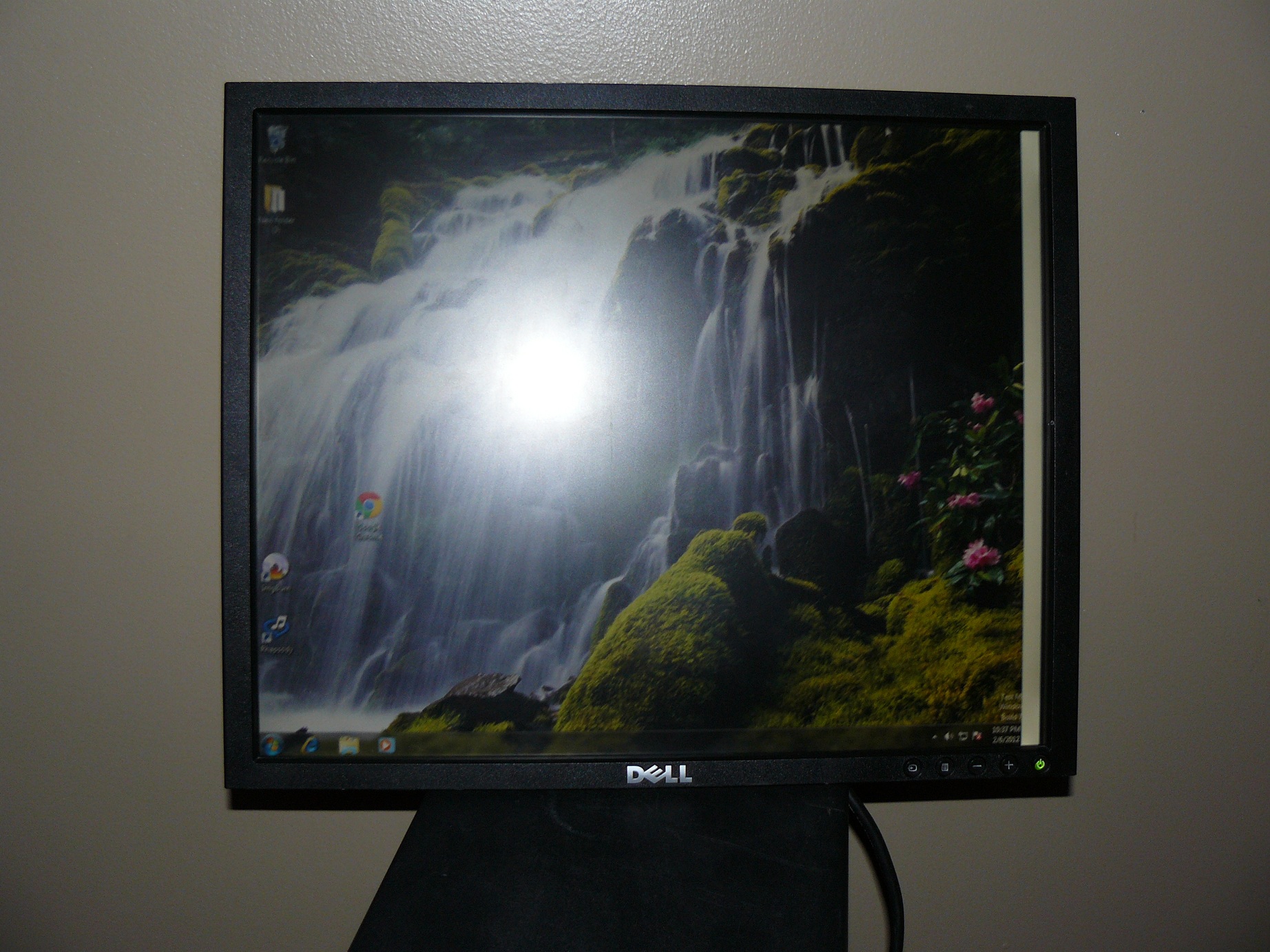

                            I'm getting a hiss on the one of the bulbs. I guess i'll be disassembling the screen

                                It was a bad tube but now i'm getting a white stripe at the one side. Auto adjusting the monitor did help a little bit. I rechecked the connectors but i'm not seeing any pins that are bent. The lvds connector to the screen is secure. Would a tab bond cause this issue. I don't think i damaged them but anything is possible.
                                • retiredcaps
                                  • Apr 2010
                                  • 9271
                                  Those tab bonds are very fragile. It is possible that 2 or 3 came unwelded from the glass which would explain the stripe. If I recall correctly, my stripe was black.
