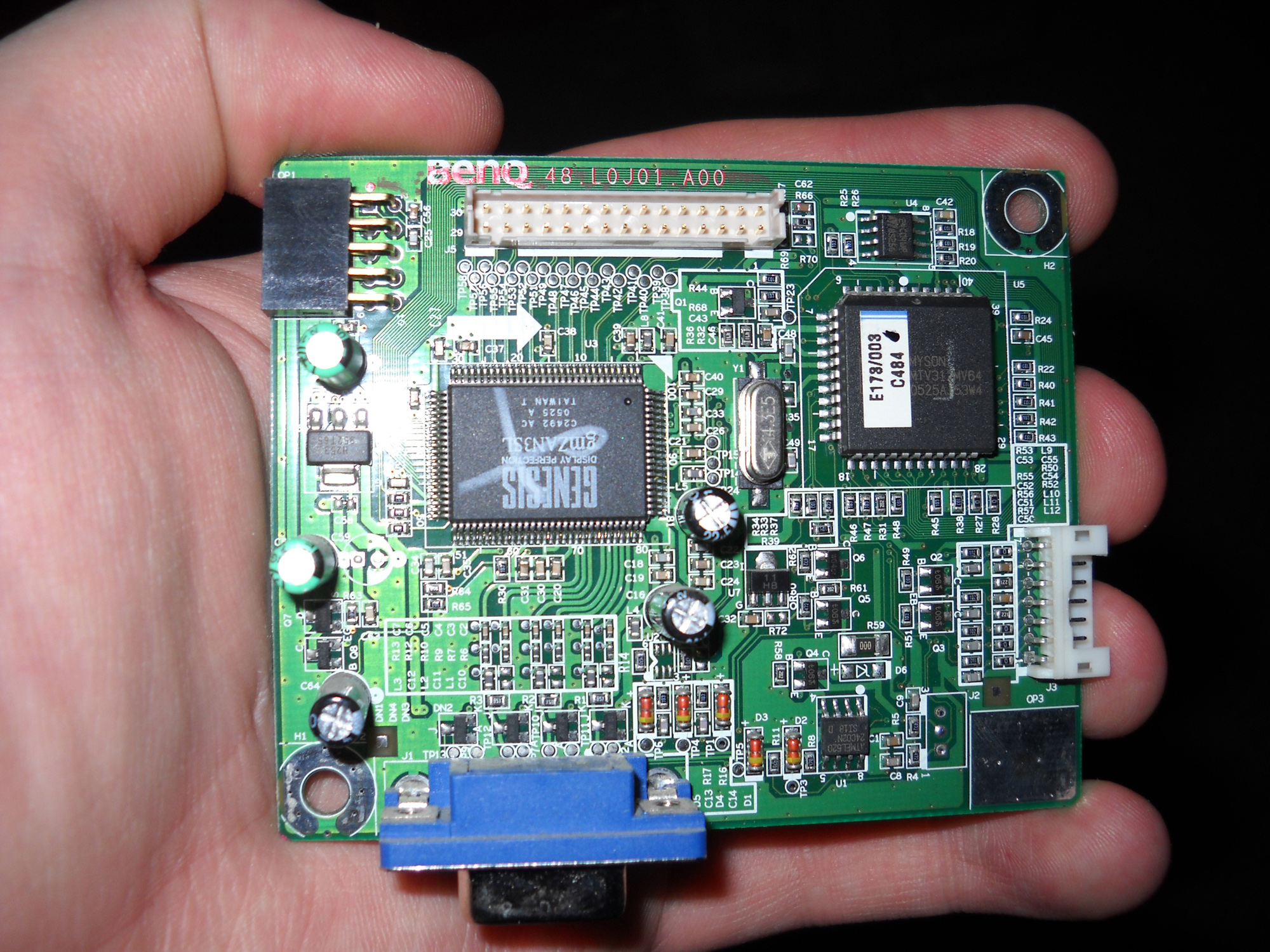

    Dell E172FPb/173FPb 17" monitor. screen + pwr led blinking
    The monitor is a Dell E172FPb/173FPb 17" (has both E172 and E173 on the back...).
    The problem is that it doesn't work, when plugged in and turned on it just blinks once every second or so, and the power LED blinks along with the screen. As if it's constantly restarting itself.
    The other problem, is that I've searched these forums, and when I find the same monitor, it appears to have a different board...
    I'm a newbie to working on monitors, so any help would be appreciated.

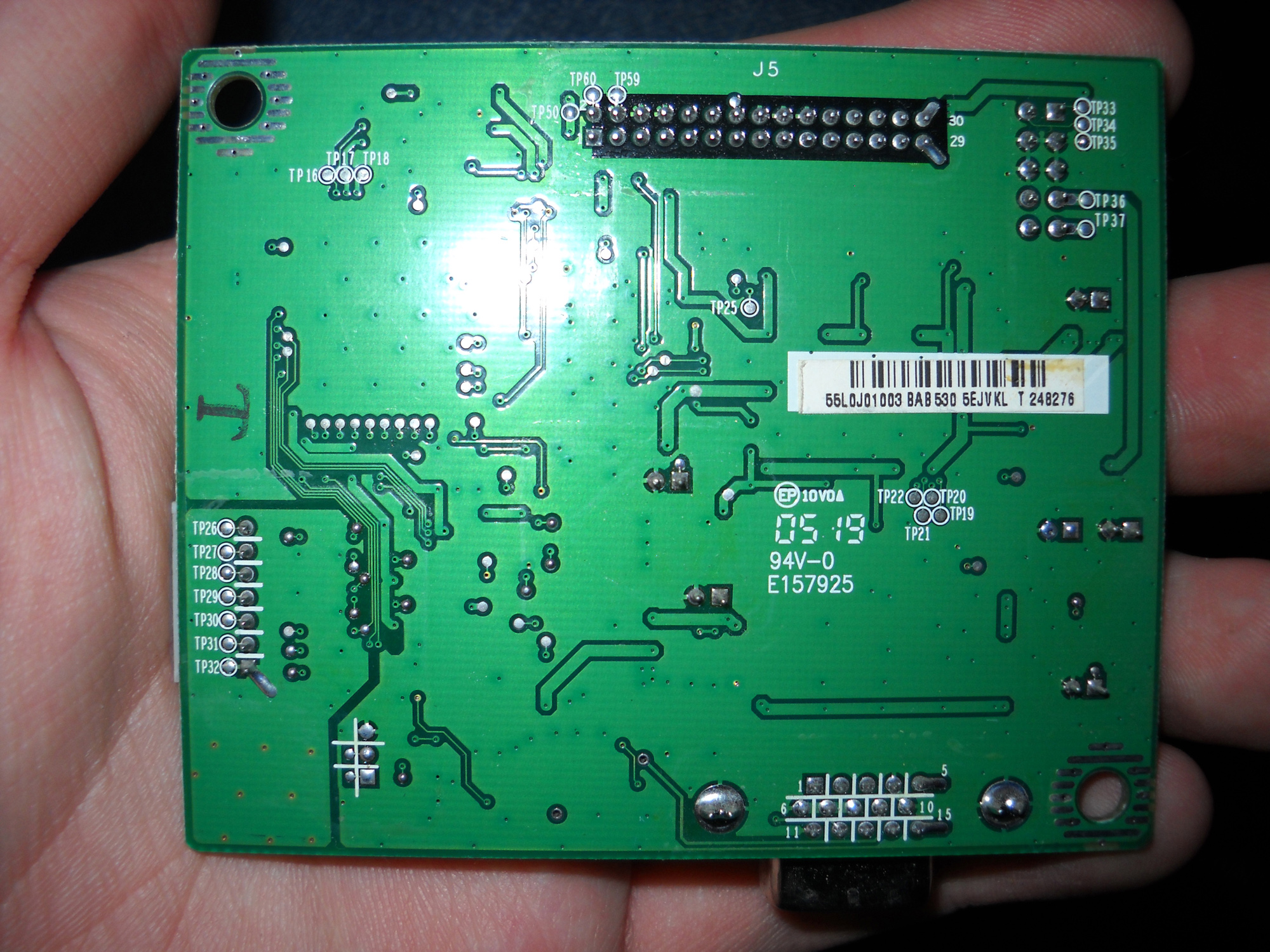

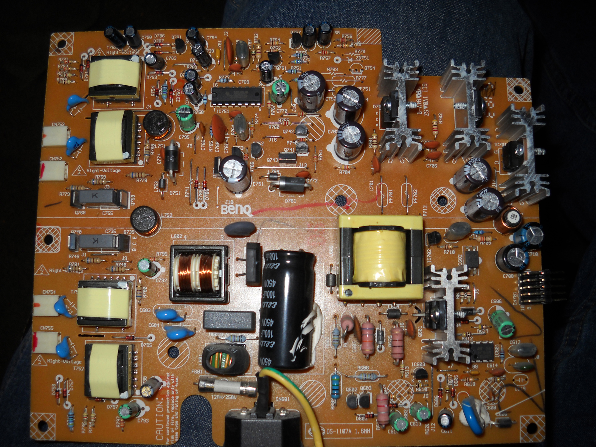

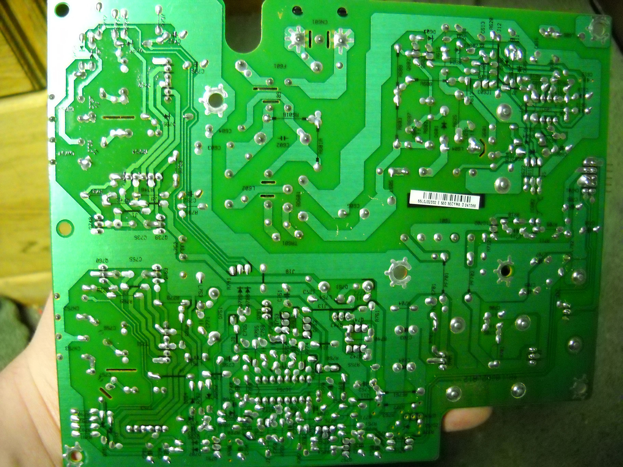

      Re: Dell E172FPb/173FPb 17" monitor. screen + pwr led blinking
      Ah, I see. Max size 2 MB. What's listed in the attachments upload section is incorrect "jpg 3.81 MB 2000 2000"
      Hope these are good, had to reduce the quality to make them under 2 MB... lol
        Excellent pictures, The classic cause of these symptoms are transistor pairs Q739-740 and Q759-760. Check these for shorts. If any of a pair are shorted replace both. Also resolder the transformer leads and the leads on caps C735 and C755. And check Q781? (between C763 and C794) and it's mate to the left of C751 for shorts.
          There's a gent selling repair kits on ebay for your board for a good price. He's sold over 1400 of them, which should tell you something! Also, remember to resolder all the pins of the 4 small yellow inverter transformers.
            I have this 173FPb .. originally it would turn on for 2 seconds, and then blank, power LED on.
            I got a similar replacement kit from ebay, replacing all 6 transistors : FU9024N x2, 2SC5707 x4
            But now after a few days after replacing them, I get the screen & LED blinking.
            edit: well, now the 173FPb is on & working. It only started to flash after I 'woke up' my PC. After being unplugged for a some mins, its working now.
