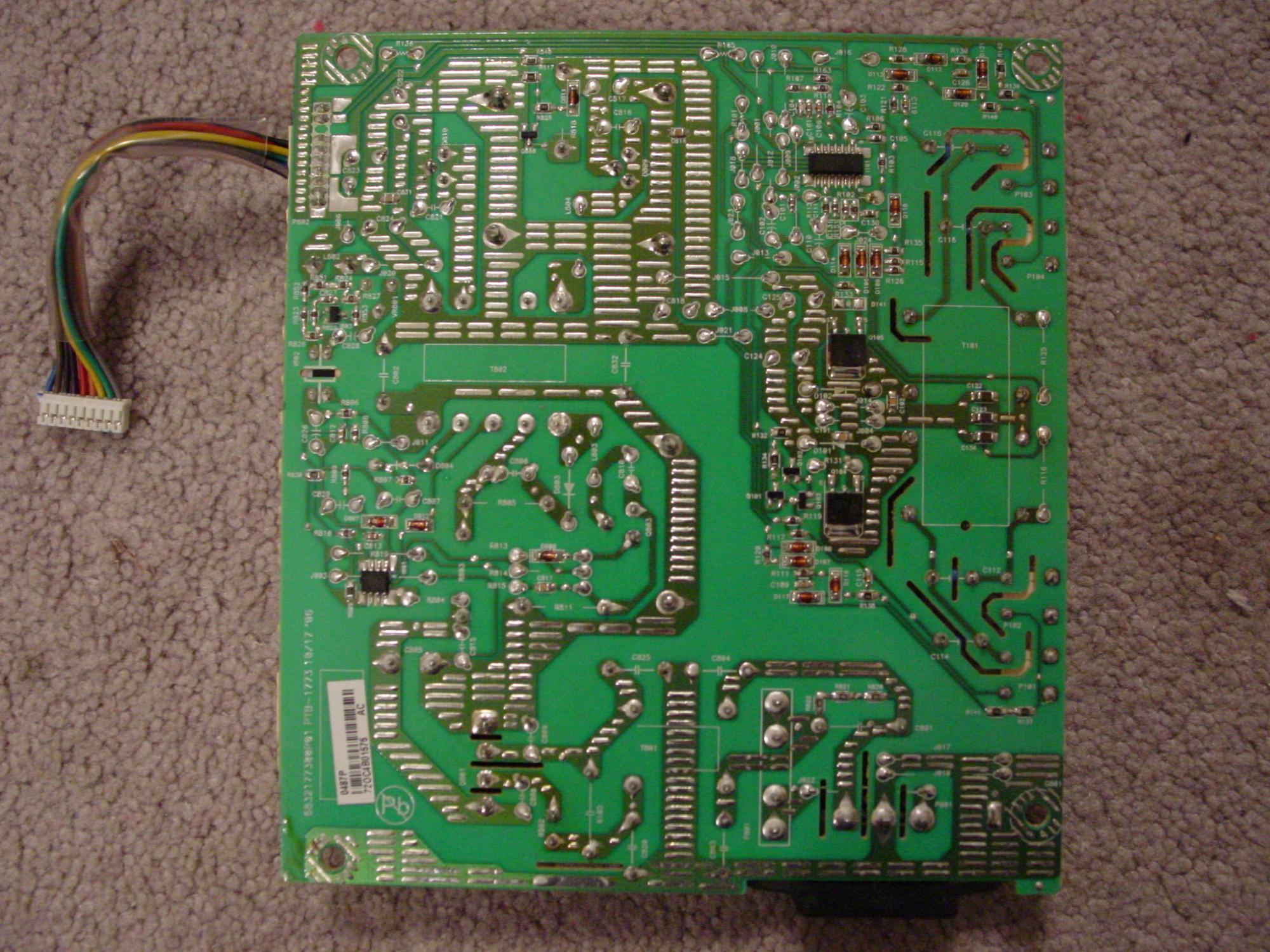

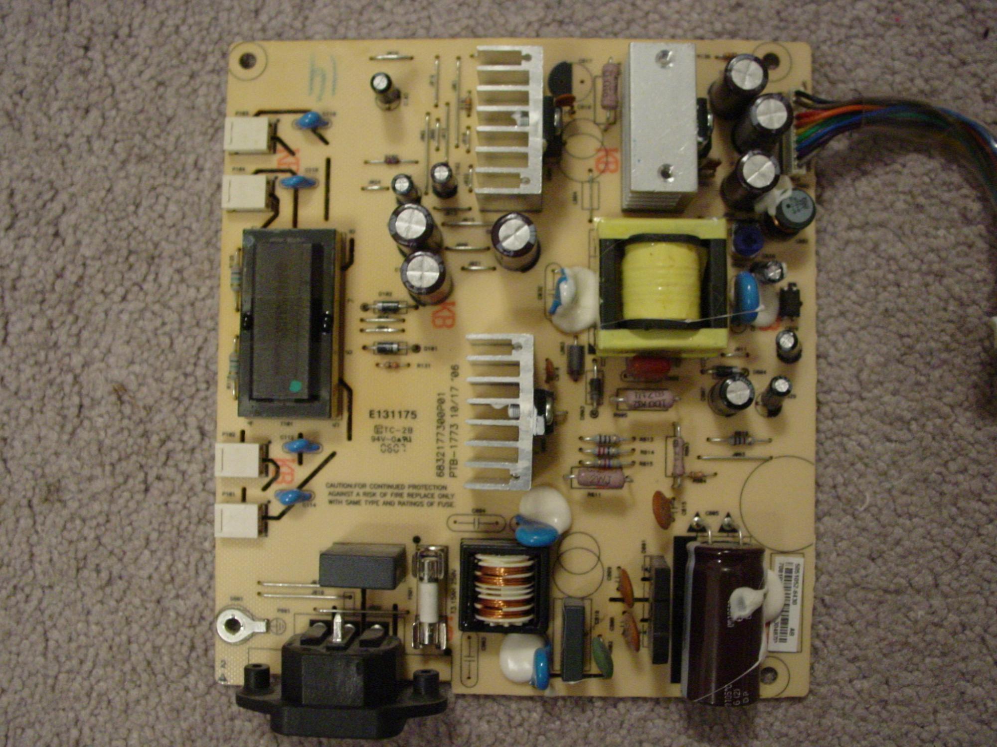

                I took some pictures of the power / inverter board and they are included.
                The system works with two of the original ccfl's and two of my spare ccfl's. When I plug in the two new ccfl's, the system exhibits two seconds to black. Sometimes I can get the system to stay on with just one of the new ccfl's plugged in along with one of the spare ccfl's. I have tried the two new ccfl's in both sets of the plugs for the ccfl's.

                Do these measurements appear to show that transformer is not functioning properly? If so, does it make sense that it works with the spare ccfl's installed?
                • alexanna
                  • Mar 2010
                  • 1346
                  Re: HP w1907 - 2 seconds to black
                  There is an Ohm reading missing,
                  the secondary's usually run somewhere between 500 and 1500 ohms, you may want to clean the pins and retest.The secondary pins are most likely the pins at the outside edge of the transformer,they should be paired on opposite sides of the transformer.
                  Are you still hearing the sizzling noise?
