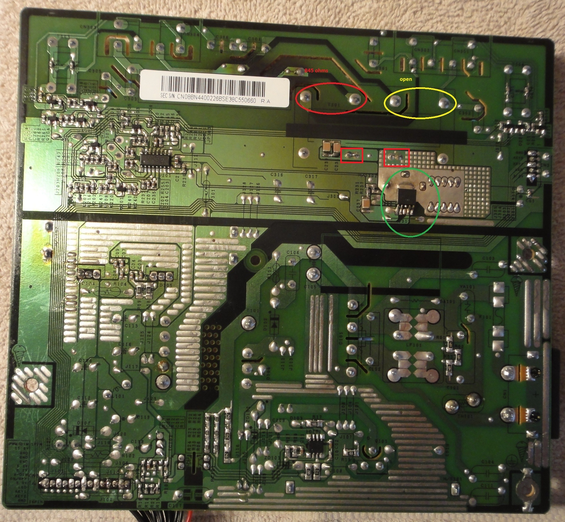

    As to the transformer, is this the one? Will check first out of circuit of course.

      De3rcr has one of the best pics I have seen. This is the 1.5%.
      https://www.badcaps.net/forum/attach...0&d=1290283049

        Re: Samsung T260
        http://www.ebay.com/itm/TM-10160-Inv...item3f0ac3e1d9
        Yes. 99.9% feedback and auction even lists Samsung T260. And yes, test it out of circuit to verify the part is good first.
        It will probably take 2 to 3 weeks to arrive from Hong Kong though. lcdparts.net has it, but you are paying $21.99 + shipping.

          Re: Samsung T260
          While I'm at it, I'm thinking of changing R301 to something a bit beefier. Perhaps 2W. A good idea?
          I don't know enough to say yes or no. Maybe PlainBill or someone else with some more insight can give you the pros and cons.

            Re: Samsung T260
            The story of my life...

              Re: Samsung T260
              Maybe it's just me or the angle but it looks like one of those yellow 1000uF started to swell up. Maybe even the 820uF close to it.
              Anyway... looks like a bad transformer so you're on the right track.
              It's more expensive but you could also go for a complete board - new ones are listed on eBay for around 57$. Just search for the board code, ip-54155a
              http://www.ebay.com/sch/?_kw=ip-5415...&_stpos=&gbr=1
              Could also use this as a way to determine resistor bar codes or other things when yours are burned up but generally the ebay pictures are not that high quality to see the text on parts.

                Re: Samsung T260
                OK, inverter transformer confirmed bad. Thanks all. Will get parts and reassemble and report back.
                Thanks mariushm for the suggestion of ordering a new board. You're probably right, that's the best way to go, but then again this is a hobby for me, and it just doesn't have the adventure of putting it back together piece by piece...

                    Re: Samsung T260
                    Ordinarily I wouldn't bother replacing the resistor, but I am curious as to why it got so hot. It's obviously tied into the inverter output voltage.
                    Here are some rather extreme assumptions. Assuming you are dropping 2000 volts across R301, with the 390K value, that's 10 watts. The actual voltage is probably lower, so guessing it's about 1400 volts peak, or 1000 volts rms. That still gives 2.5 watts.
                    Yeah, definitely go with something beefier. My assumptions are probably way off the mark, but it's not going to cost much to buy the higher power resistor.

                      Re: Samsung T260
                      I've been thinking that I may have found the cause for the transformer failing, and want to see if this resonates with anyone. When taking out the transformer last night, I was working on the two sets of pins spaced closely to each other (see little red boxes in annotated photo) and one set of pins were bridged with solder, and the other set is not. I'm thinking that they should both be bridged with solder. Has anyone who has replaced a transformer recall if this should indeed be the case?

                        Re: Samsung T260
                        I have replaced 2 inverter transformer before. One on a T240 & another on a 2233sw. If i recalled correctly, it does not matter whether both the set of pins are bridged or not bridged with solder because the 2 pins close together are actually linking to each other.

                            Re: Samsung T260
                            From the picture at
                            http://www.lcdparts.net/TransformerD...ProductID=3696
                            the two middle pins are primaries and should have a resistance of less than 1.0 ohms.

                                        And we have success! A big thank you to all who helped. A combination of a new inverter transformer, new caps and a new resistor did the trick. I'm already scanning Craigslist for another project.
                                        In the meantime, I want to see how many hours are currently on this T260. Does anyone know how I can access the service screen / menu?
                                        Thanks in advance.
